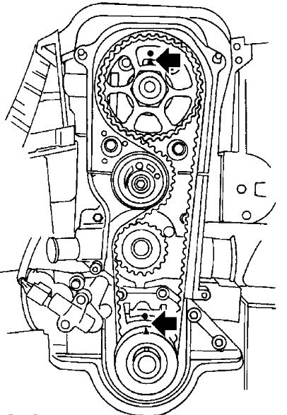

RIESE619SD
Engine Mechanical problem
2000 Ford Focus 4 cyl Front Wheel Drive Manual
The vehicle stalled and will not start. It has spark, cranks strong, and when spraying carb cleaner into throttle body it still won't start so I'm leaning away from it being a fuel issue. I am stumped. How can you test the crankshaft position sensor and camshaft position sensor.

BRIEN P
  • 19 POSTS
Cranks but no start. getting fire injectors pulse, no codes and the timing belt is not broken. 125 compression, tries to start but wont, but after cranking plugs are black sooty, but not wet with fuel.
Apr 4, 2017 at 1:56 PM (Merged)
HMAC300
  • CERTIFIED EXPERT
  • 48,601 POSTS
if timing belt was replaced make sure it is correctly timed. see picture then try resetting security system. See link.
