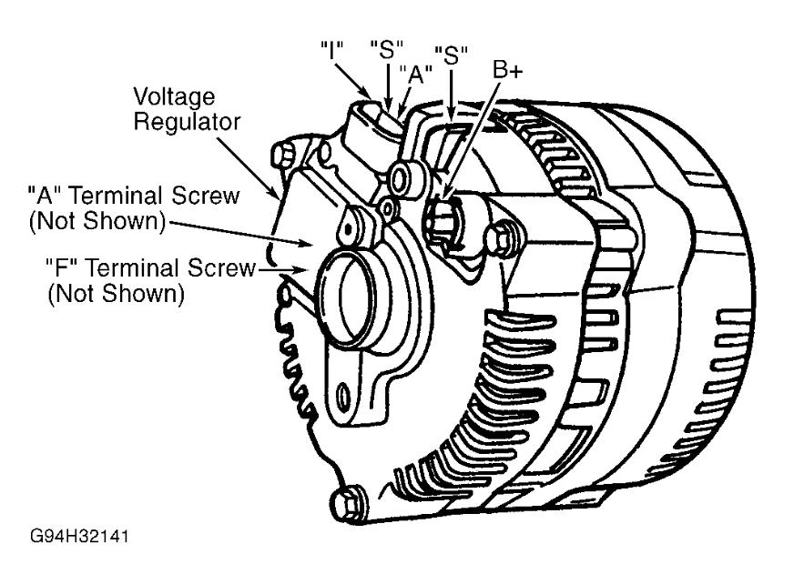

How much does it cost to replace the regulator in the alternator? They were saying that they were going to charge me almost 500$ for a brand new alternator, and I really don't have that kind of money.
Apr 4, 2017 at 6:59 AM
(Merged)
it's all one assembly if you are mechanically inclined check with an autoparts and see how much it is and replace it your self. It should be on the site here on how to repair, might be a video
(Merged)
I have a brother who is mechanically inclined, he wants to ask if the alternator is internally in the engine? and is the alternator is external in my engine because of the year?

the alternator is external but the regulator is internal and probably soldered inside. he should be able to see it if he looks under the hood.Disconnect negative battery cable. Remove accessory drive belt. Remove power steering pipe support brackets from exhaust manifold. Remove 3 nuts and exhaust manifold heat shield. Raise and support vehicle. Disconnect electrical connectors from generator. Remove lower generator mounting bolt. Lower vehicle. Remove wire harness clip from generator mounting bracket, 2 mounting bolts and generator from vehicle. To install, reverse removal procedure. Tighten fasteners to specification.
print this part as it shows how to take it off. unless this is a 2.0L Ztec engine. pictured is a typical alternator
