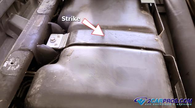

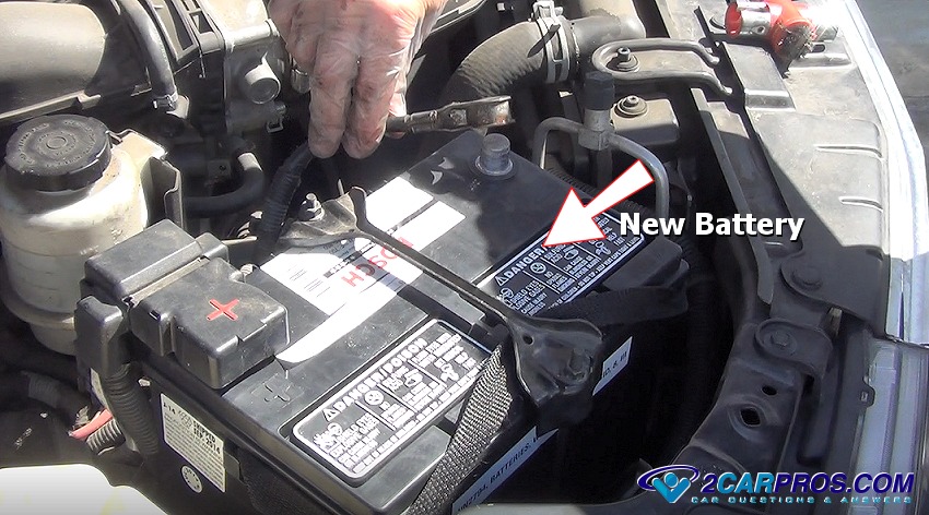

1. Poor Battery Connection: Raise the hood to located the battery, it should be either a the right or left front or right rear of the engine compartment. Some cars will have the battery in the trunk or under the rear seat. Once located and while wearing gloves/protective eyewear inspect the positive battery cable terminal for corrosion and try to move it. If the terminal is corroded or loose, this can be the problem. To repair the issue clean or tighten the battery cables, repeat this process for the negative cable. (Do not pound/strike on the battery with a shoe or other means). Wash your hands immediately anytime you work with a battery.
Clean battery post terminal

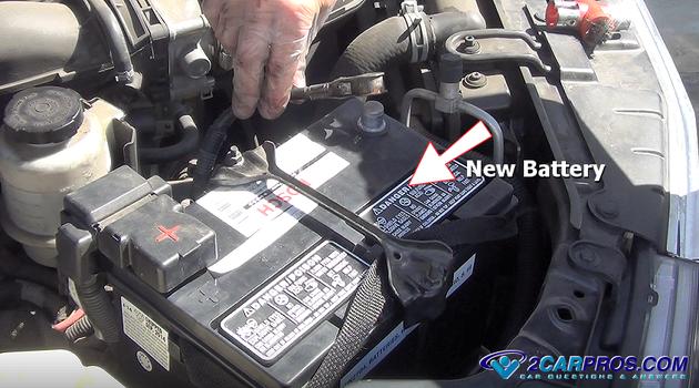

2. Weak/Old Battery: This issue will present itself when you notice the dash lights will not come on, or the dash lights go out when the key is turned, or the starter is producing a machine ticking or ratcheting kind of sound. It is common for the battery to go bad every four to five years, this is an easy repair which can be done with everyday tools. Please use our battery replacement guide, you can get a new battery from the local auto parts store such as AutoZone.
New car battery

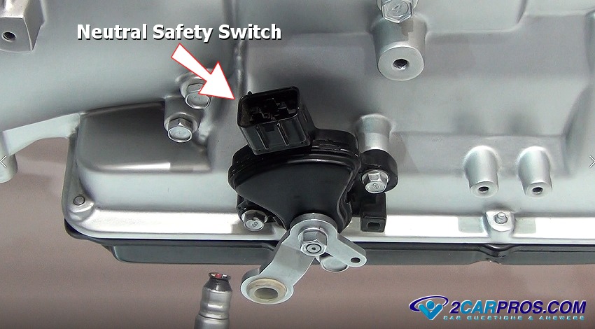

3. Neutral Safety Switch: This applies to automatic, manual, or paddle shift transmission cars. The neutral safety sensor/switch feeds data to the engine computer (PCM) and will allow the engine to crank over and start and run safely. To check this, turn the ignition switch/system on, then move the gear selector to the natural gear or position and then try to start the engine. If the engine starts, you know the neutral safety switch has gone bad and needs replacement. For standard transmission cars pump the clutch pedal down five times, holding it down on the last while making sure the floor mat is not under the pedal. If the engine starts the neutral safety sensor needs to be adjusted or replaced.
