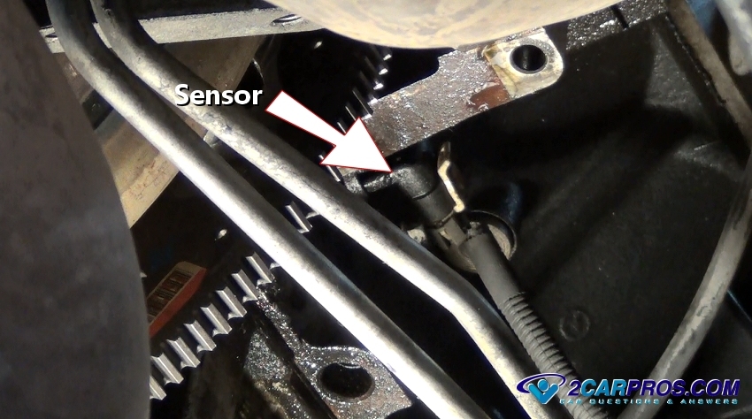

3. Electrical Connector Release
An electrical connector will be held to the sensor using a plastic clip which you much push down or pull outward to release, gently wiggle the connector loose from the sensor. Sometimes this connector can be a little stuck due to the weather pack seal which helps keep water out that can cause corrosion at the sensor terminals. Once the connector is removed check it for rust and clean or replace the pigtail if needed, this problem alone will cause the engine to stall or not start at all.

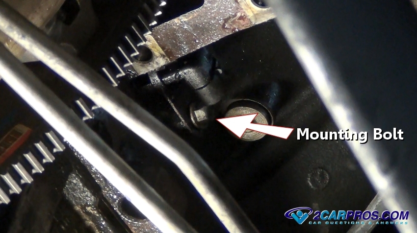

4. Crankshaft Sensor Removal
Most crankshaft sensors will have just one mount bolt which will typically be 10mm in wrench size. Use a small wrench or socket to remove the bolt by turning it counterclockwise and place to the side for safe keeping. Use a small pick or standard screwdriver to wedge under the sensor mounting tab to pry it loose.
Bock Mounted Sensors Only:
Removing the crank sensor can be a little difficult because they get stuck. Be careful not to apply to much pressure because these sensors have a long stem and have been known to break off leaving a part of the sensor inside the block. When this happens sometimes you will have the option of pushing the broken piece inward so it falls into the oil pan where it will stay, or you can remove the oil pan to remove the broken piece. Once the sensor is loose, firmly grasp it and with a twisting motion pull it from the engine block.

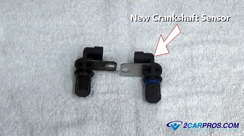

5. New Crank Position Sensor Installation
  • Wipe off any oil the old sensor has on it so you can clearly see any design changes the new sensor might have. Slight design updates are common when installing new sensors such as mounting tabs. One thing that "cant" be different is the length of the sensor stem because if the stem is too long it will contact the crankshaft, and if it is too short it will not read correctly.
  • Use a shop towel to clean the position sensor port hole to ensure a proper seal to the new sensor O ring. Motor oil will be present at this port so do not spray carburetor cleaner inside the port. You can spray cleaner on the shop towel to aid the cleaning process, (if applicable).
  • Position the new crank sensor squarely into the sensor port hole and firmly push it into place while aligning the mounting plate hole to the threaded bolt hole in the block or mounting bracket.
  • Use a small amount of clean engine oil or WD40 to lubricate the O ring seal to avoid damage to the seal which will cause an oil leak, (if applicable).
  • Insert the mounting bolt and thread it in by hand by turning it clockwise to avoid cross threading and gently tighten.
  • Apply a thin layer of dielectric grease to the sensor’s electrical connector to prevent corrosion and facilitate a secure connection. Push the electrical connector into place while listening for a click telling you the connector is successfully installed and ready for operation.
