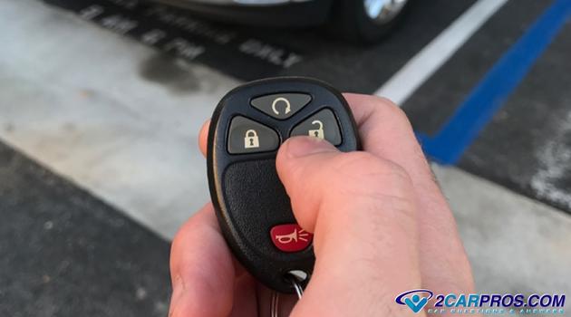

Step 2: Activate the Key Fob
Many manufactures will not allow the car to start when the panic button has been pushed. Hold down the panic button for five seconds to reset the immobilizer.
key fob panic button
Next, push the lock button two times and wait ten feet away from the car for ten minutes.
key fob lock button
Then hit the unlock button on the fob twice this should deactivate the security system which should be accompanied by exterior lights flashing or an audible horn beep.
key fob unlock button
Each of these steps should be followed by the cancellation of the security light. If this light is blinking while you are trying to crank and start the engine the system is not reset.

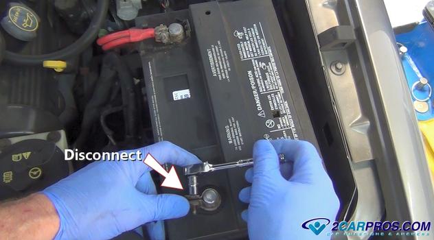

Step 5: Disconnect Battery
Sometimes the anti theft system can out of sync due to a voltage spike or an operational error. Start by removing the battery's negative cable and leave it disconnected for five minutes then reconnect the battery. This will allow the security system to perform a hard reboot and reset the alarm protocol to help the immobilizer start working in the proper sequence.
