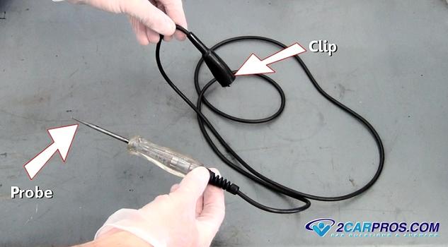

A test light is a simple device that can tell you if power or ground is present at a particular circuit or fuse. The test light consists of a sharp probe, indicator light bulb and a wire lead with a clip. This tool is easy to use and is reasonably priced on Amazon (about $20.00 US) and pertains to all 12 volt systems. EV's use a 12 volt system to run everything but the main drive motor, and most have a conventional 12 volt battery including Tesla.

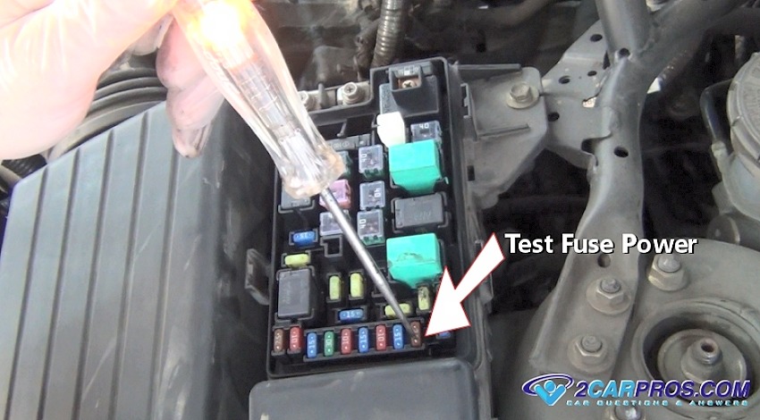

A popular use of a test light is to check for power and the condition of the fuses in the fuse panel or power distribution center (PDC), this should be the first check when a particular accessory such as door locks, lighting or power windows are not working. If you need the locations of a fuse or electrical item such as a fuel pump relay you can ask the 2CarPros community to supply the information (free), or consult an online resource such as AllData DIY (pay).
Once the test light is properly grounded (negative side of the battery or any solid metal part), touch each side of the fuse, both sides should light up which is telling you both the fuse is good, and there is power present in the fuse panel. Note: Any solid metal part of the vehicle such as the frame, engine, radiator core support is grounded naturally as part of the electrical systems design.

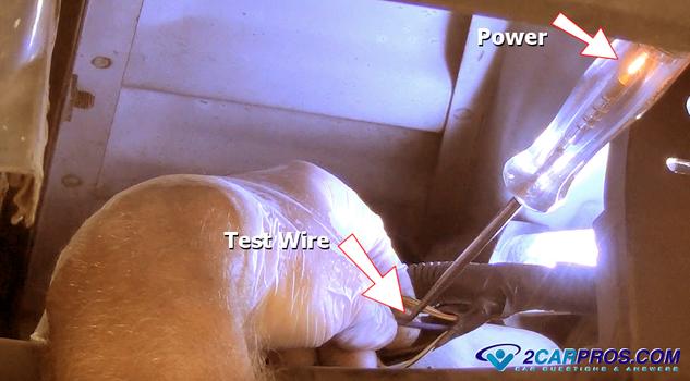

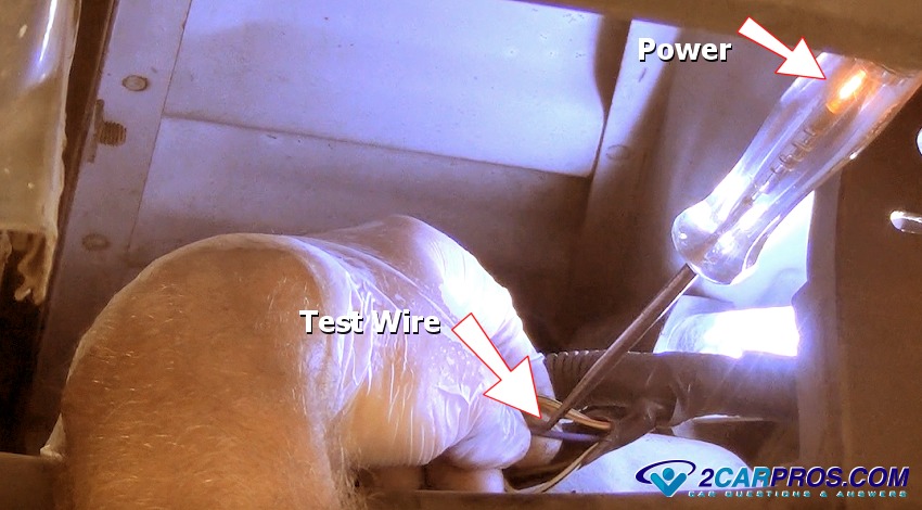

Here a mechanic is testing the power feed to the fuel pump from under the vehicle, with the test light grounded the sharp point is pushed through the wire insulation to contact the internal wire. This is done by locating the wiring harness headed to the fuel tank and while using a wiring diagram provided by our expert to confirm the color of the wire, in this case blue, if power is present as in this case the fuel pump motor is bad.

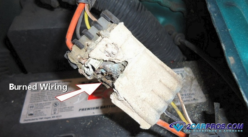

When power tests okay at the fuse yet power is not present at a particular accessory such as the cooling fan, a test light can trace the problem down through the wiring harness to find a melted or bad connection.
burned wiring

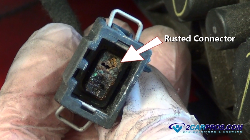

This electrical connector tested good while probing the wires before the connector, it wasn't until the technician removed the connector was the problem discovered.
