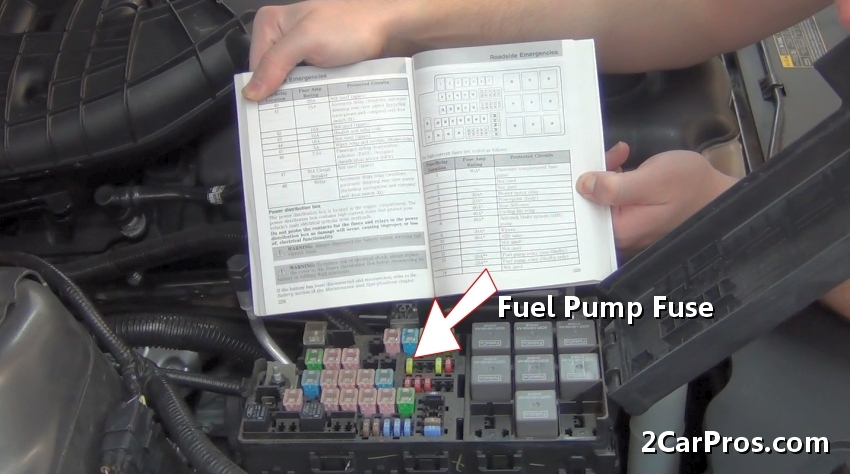

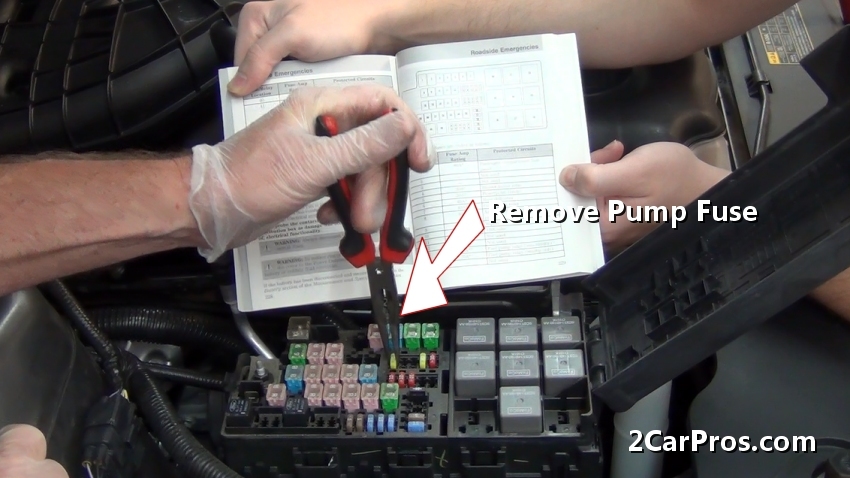

Step 2 - When checking for a misfire while the engine is still running, the fuel pump must be disabled to avoid accidental ignition discharge. Using the owners manual identify the fuse location.
fuel pump fuse
Step 3 - Once the fuse is located use needle nose pliers or a fuse removal tool to remove the fuel pump fuse from the power distribution center (PDC.)
removing fuel pump fuse

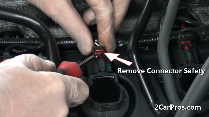

Step 4 - Remove the safety from the coil electrical connector (red.) Some cars are not equipped with this feature.
remove ignition coil safety

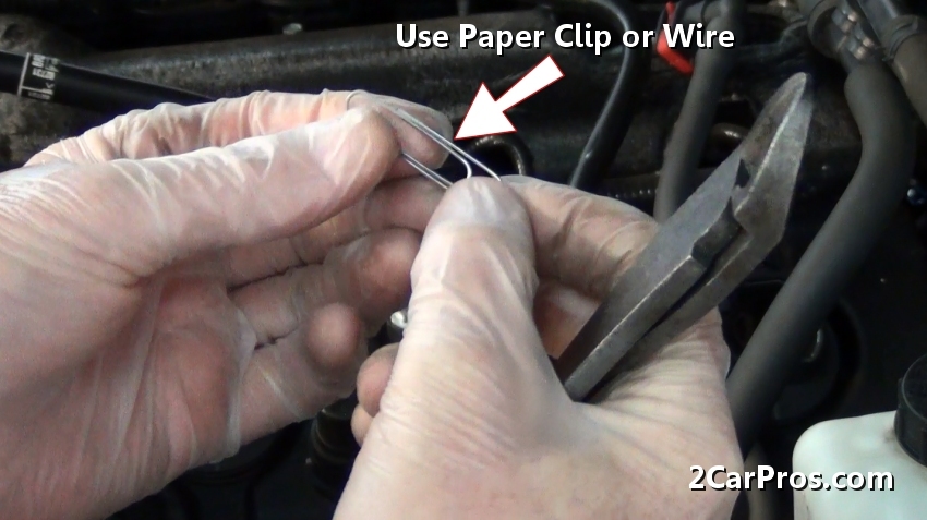

Step 7 - Because these terminals are small in size, sometimes a paperclip or small wire can be inserted into the connector terminals which makes testing easier.
connector test terminals
Step 8 - After cutting the paperclip or wire, insert a piece into each terminal, do not allow the wires to contact each other, this could cause damage to the computer.

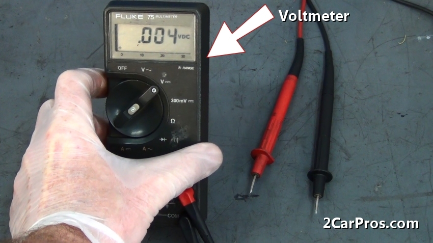

Step 9 - Once both terminals have been prepared, use a voltmeter set to the DC voltage setting. Also install alligator clips to the leads to ensure a good connection.
voltmeter

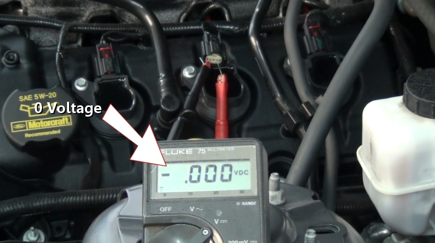

Step 11 - After connecting the leads, turn the ignition key to the "ON" position without cranking the engine. The voltage observed should be 0.
0 voltage

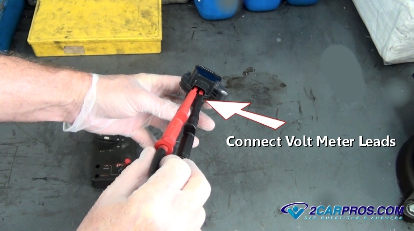

Step 18 - With the coil removed, attach the voltmeter leads to either coil terminal ( small wire connector.)
connect voltmeter
Step 19 - Once the volt meter is connected obtain the reading provided, if this ignition coil was bad the reading would much higher.
coil ohms reading

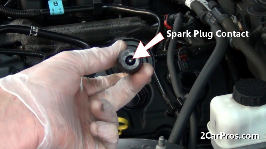

Step 20 - After reconnecting the ignition coil to the wiring harness, observe the electrical contact which contacts the spark plug.
spark plug contact

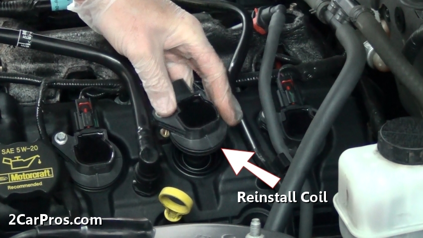

Step 24 - After replacement or testing is complete, gently reinstall the coil into the spark plug well.
reinstall coil

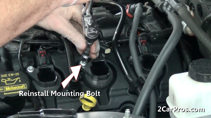

Step 25 - Once the coil is in position, install the coil mounting bolt and tighten.
reinstall coil mounting bolt

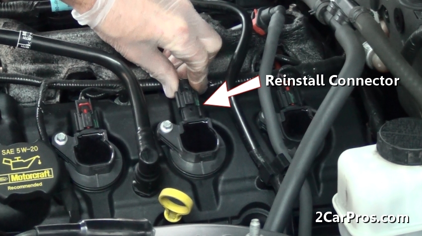

Step 26 - After tightening the coil mounting bolt, reconnect the electrical connector onto the ignition coil. Once the job is complete, start the engine to check coil operation. If the check engine or service engine soon light is illuminated use a code reader to check for codes and reset the system.
reinstall connector
