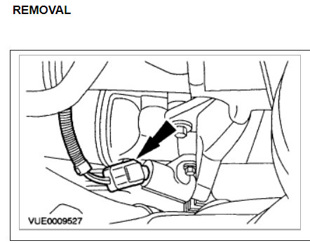

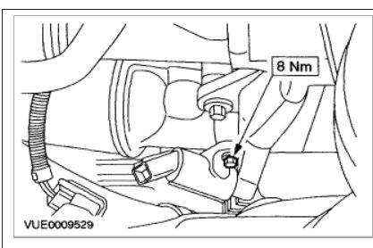

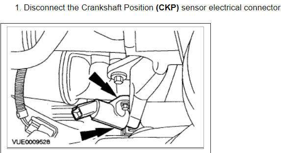

It sounds like you have a classic crankshaft angle sensor that has gone out here is a guide to help you see what you are in for when doing the job.

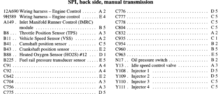

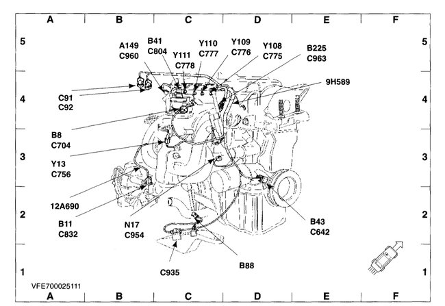

Here is the location for your car for the crankshaft sensor.
Cheers
Mar 20, 2010 at 12:26 PM
DAVENMILY
Yep you hit it on the money I got a new sensor for $45.83 and installed it which was a snap. Thanks for the tip this site rocks.
