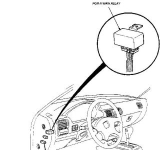

TERTUL
  • 1994 HONDA ACCORD
  • 4 CYL
  • FWD
  • 12,600 MILES
A couple weeks ago I jumped into my car and took off, maybe acouple blocks down my car just dies out.I had a full tank of gas.I thought it was the fuel pump so I changed it out, but still nothing.A few times before all this happened there were times when I would start my car and it would die out right away.I would have to turn off the key and try again until it started. Now it wont start at all. Please help me cuz I need my car for work. Thank you very much!

F4I_GUY
  • 3,302 POSTS
Check the vehicle for strong spark (blue/white spark) and proper fuel pressure. About 38psi.

TERTUL
First of all thank u for ur help. Um do u by any chance know what color it is? Cuz after I got ur msg I went under da dash and I saw 2 of them, one was all black and the other was green and I think gray.
Tuesday, September 29th, 2020 AT 1:03 PM (Merged)
KHLOW2008
  • 41,814 POSTS
Hi tertul,
The PGM-FI main relay is Gray color with an 7 pin connector.
https://www.2carpros.com/forum/automotive_pictures/192750_PGMFIRelay93Accord_2.jpg
