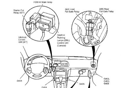

It is quite common for the main relay to have intermittent failure. When the engine won't start, check the fuel pressure when turning the ignition on (pump will only operate for 2 seconds on) or try cranking the engine.

Hi I have a 1994 honda accord. The car runs great except for the occasional refusal to start. The engine will turn over but no ignition. This is the exception to the rule. When this happens I wait a couple of minutes and it fires up no problem. Is this an easy fix?
Sep 29, 2020 at 6:00 AM (Merged)
KHLOW2008
  • 41,812 POSTS
Hi davidabb1, Quite often the problem is caused by an intermittently failing PGM-FI main relay. Resoldering the relay joints would solve the problem.
https://images.2carpros.com/forum/automotive_pictures/192750_PGMFIRelay95Accord_8.jpg

Have the main relay checked. Quite often this relay fails intermittently and when it occurs, the fuel pump is not activated.

The PGM-FI main relay is the most common cause of this. Remove the relay and resoldering the circuit board should solve the problem.
http://www.youtube.com/watch?v=0F2OsgXmshI
Check out the link.
