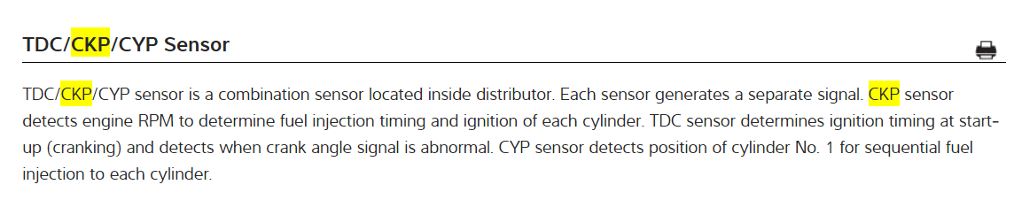

Yes, a broken timing belt would cause a vehicle not to start. In your vehicle's case it wouldn't start nor would the fuel injectors work or the spark plugs. I have included a description of the Crankshaft Position Sensor in the diagrams down below. I have also included a few links down below for you to go to.
and
Please go to these links and the information I have included in the diagrams down below for you and get back to us with what you find out.

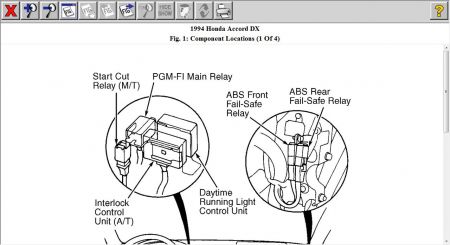

Hi Blonde80, If the non starting is due to fuel issues, then the PGM-FI main relay is the likely culprit. Remove the relay and resolder the ciruit board to see if it helps.
https://images.2carpros.com/forum/automotive_pictures/192750_PGMFIRelay95Accord_4.jpg

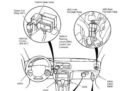

NO1TIRE
i have a 1994 honda accord that came in my shop that will not start. customer said it was fuel pump but after testing fuel pump was working and pressure was good . when it came in it was also firing but now it will not fire. tried new distributor & coil with no luck. have tested wires as much as i can with chilton book. am lost do you have any suggestions
Sep 29, 2020 at 5:56 AM (Merged)
  • 75,988 POSTS
Inspect and test the PGM-FI main relay
NO1TIRE
have two books one is just for location of relays and sensor does not show this in either. could you tell me location thanks
  • 75,988 POSTS
PGM-FI Main Relay Behind left side of dash
https://images.2carpros.com/forum/automotive_pictures/12900_pgmfi_4.jpg
