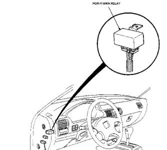

TERTUL
a couple weeks ago i jumped into my car and took off,maybe acouple blocks down my car just dies out.i had a full tank of gas.i thought it was the fuel pump so i changed it out, but still nothing.a few times before all this happened there were times when i would start my car and it would die out right away.i would have to turn off the key and try again until it started.now it wont start at all. please help me cuz i need my car for work. thank you very much!!
Sep 29, 2020 at 6:03 AM (Merged)
F4I_GUY
  • 3,302 POSTS
Check the vehicle for strong spark (blue/white spark) and proper fuel pressure. About 38psi.
TERTUL
first of all thank u for ur help. um do u by any chance know what color it is? cuz after i got ur msg i went under da dash and i saw 2 of them, one was all black and the other was green and i think gray.
KHLOW2008
  • 41,812 POSTS
Hi tertul, The PGM-FI main relay is Gray color with an 7 pin connector.
https://images.2carpros.com/forum/automotive_pictures/192750_PGMFIRelay93Accord_2.jpg

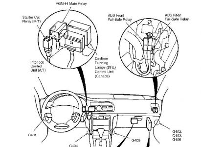

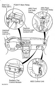

DWR6659
The car runs fine but in the last six months after the car has been running and the engine is hot the car wont restart. The engine turns over and tries to start but will not start. If I leave the car out in the hot sun, same story. I took it to the first mechanic and he replaced the distributor. No luck. The second mechanic said it was the fuel pump and replaced it. No luck. Once the car cools down or is in the shade for a couple of hours, it starts fine and runs fine. No one can seem to figure this one out.
Sep 29, 2020 at 6:05 AM (Merged)
BMRFIXIT
  • 19,053 POSTS
i would suspect and check PGM - Fi main relay located behid left side of dash
https://images.2carpros.com/forum/automotive_pictures/99387_Graphic1_533.jpg
SERVICE WRITER
  • 9,123 POSTS
Sounds like a main relay.
Main relay is located under the dash on the drivers side below the steering wheel. It powers the fuel pump and sends 12 volts to the positive side of the injectors.If this is at fault you wont have 12 volts at the injectors or the fuel pump will be inoperative. So the pump replacement is more understandable, sort of.
These accords also have had problems with distributor bearings so the distributer may have also been an issue. If the vehicle does not have an injector pulse or spark the distributor is probably the cause. There are three coils inside the distributor(crank, TDC, and coil)and a igniter. All known to fail. These can be tested for an ac voltage when cranking. The spec is between .5 to 1.5 volts. If you have an oscilliscope you can test it with more accurate results. You can also test the igniter with a logic probe by testing for an ac pulse coming out of the ecm and into the igniter. Then test for a pulse coming out of the igniter. If it has a pulse coming in and not one on the output then the igniter is bad.
I know you replaced it, but may have been a good idea anyways.
