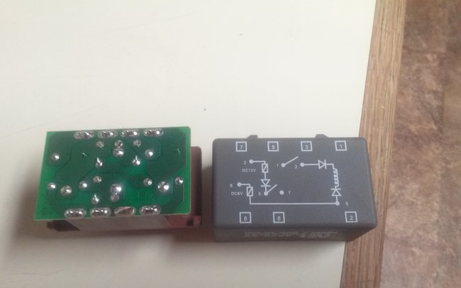

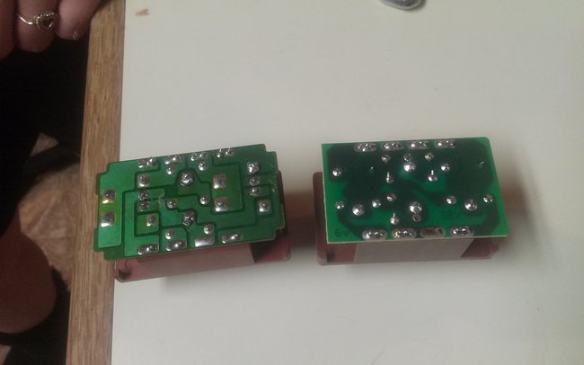

When replacing main relay and new didn't work I got to looking at the two and they are quite different inside. There are not as many soldering points on new one and some don't have solder on them at all

New relay is first pic. In second pic new one is on right old on left

Check the pgi main relay and don't worry abou tthem being soldered different it may be another type of relay like the wrong one. The pgm relay is under dash lh side that runs fuel pump also check fuses under hood#33 supplies fuel pump /pgm relay finally take ignition module to auto parts have t hem check it for being bad. Also check primary /secondary resistance of coil all that stuff is onour repair site here if you don't know how to do that. I already gave answer for code 14 which I won't repeat.
