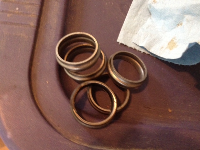

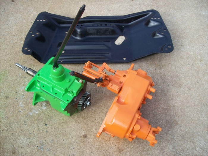

The 1/2'' to 3/4'' drive works great. That 3/4'' square is huge. It'll take a lot to strip through it.

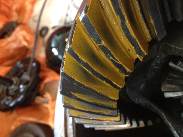

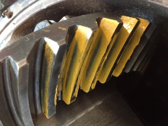

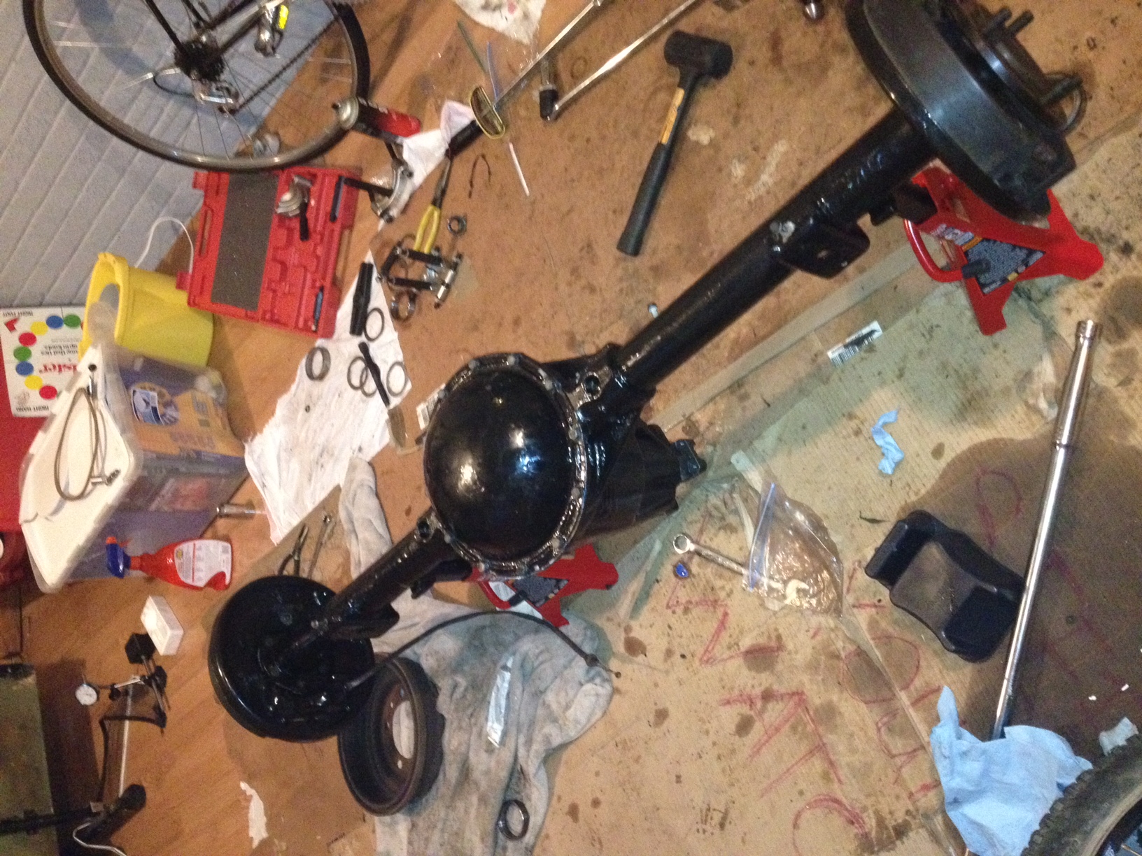

Good news! I've got the correct shims (to the best of my knowledge). Pictures bellow show the final gear marks, dead center. Or. Close enough. And a pic of the pile of used crush sleeves it took to get me there. As soon as my new yoke and crush sleeve comes in I'll be ready to tighten things down for the last time. Thank goodness. I can see the light at the end of the tunnel.

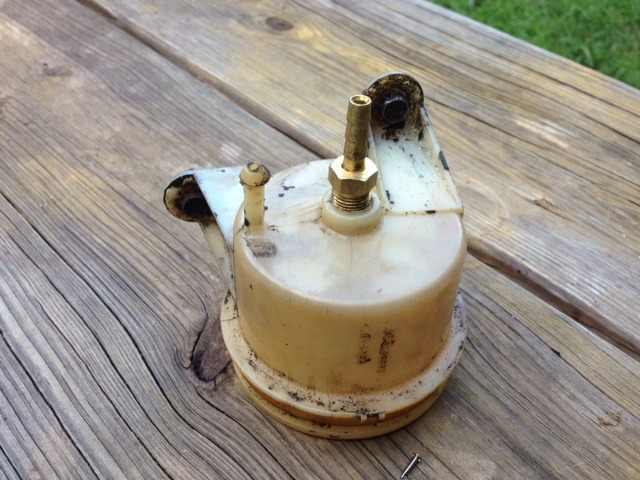

Last pic is of the liquid check valve's brand new barbed hose fitting. Your method worked like a charm.

SO. YOU'LL BE ABLE TO TAKE ME FOR A NICE QUIET RIDE SOON?
WEAR PATTERN IS PERFECT!
FILLER UP WITH 85W-90 OR 80W-90 AFTER YOU GET IT BACK ON
IS THERE ANYTHING YOU HAVE ASKED THAT I FAILED TO ANSWER?
YOU HAVE SAVED YOURSELF A BUNDLE. NOT TO MENTION THE TASK HAS BEEN DONE CORRECTLY AND TO PERFECTION, YOU WILL SELDOM FIND SOMEONE WHO WILL TAKE THE TIME TO DO IT BY THE BOOK, AND MAKE IT OPERATE AND LAST, AS IT SHOULD

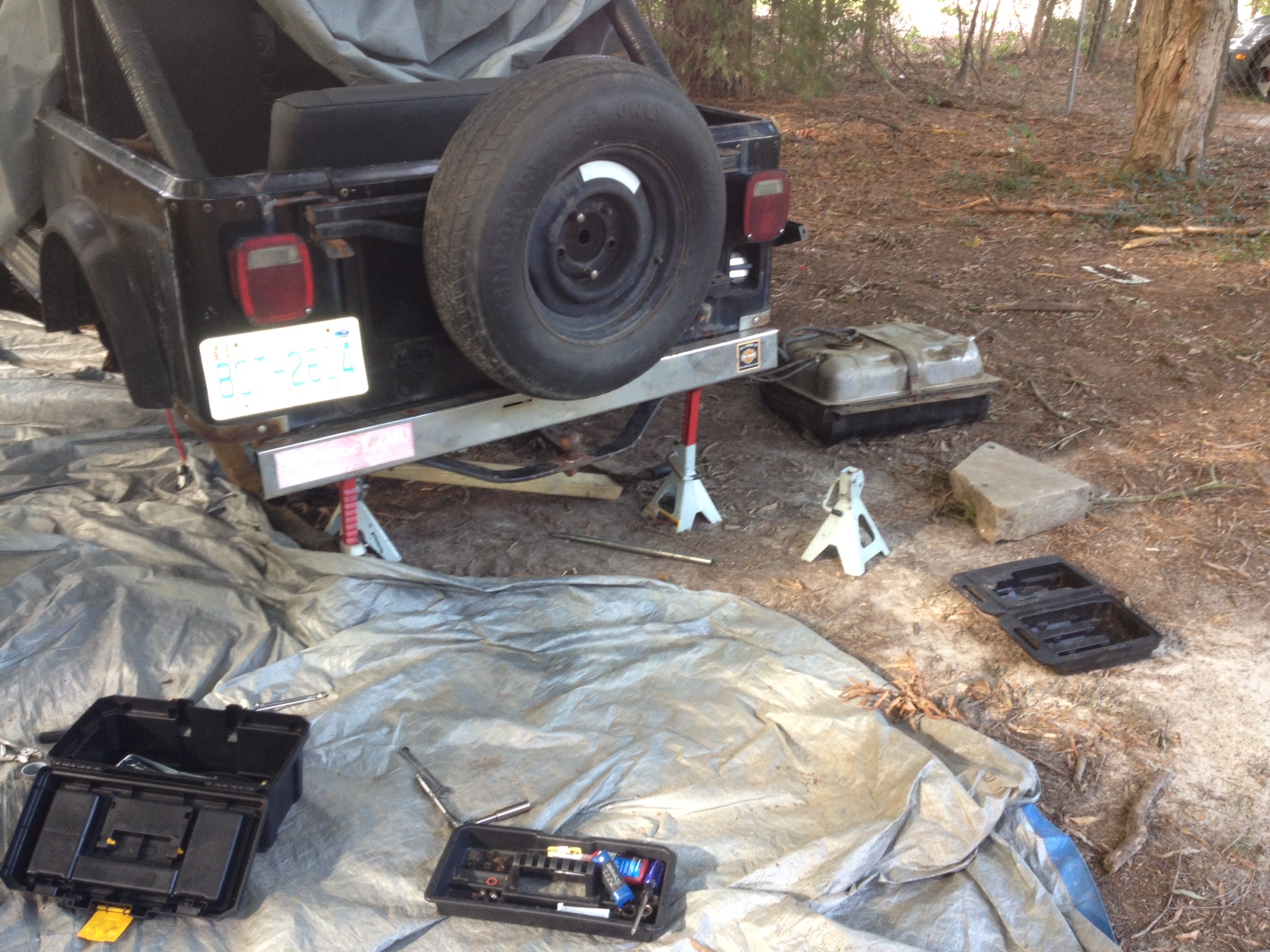

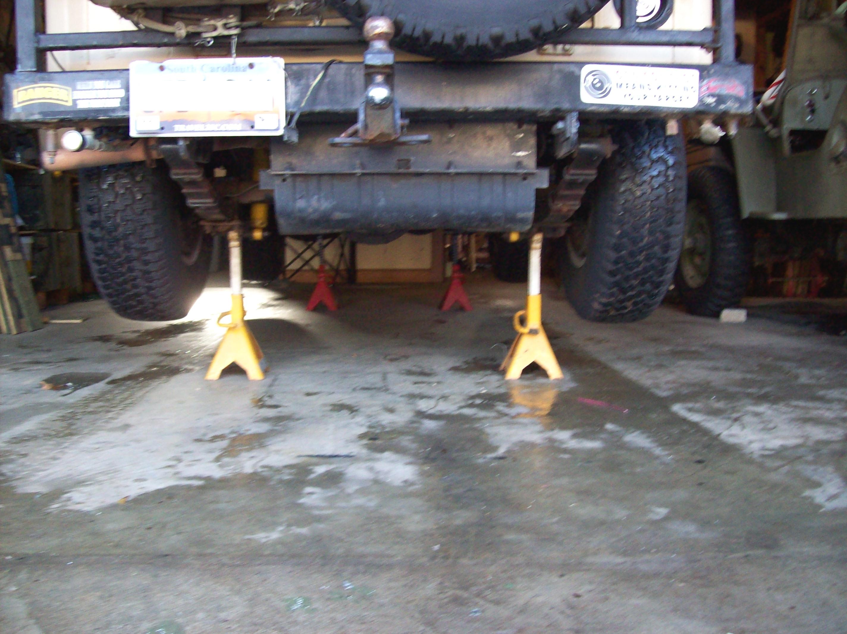

Had a busy day today! Dropped the gas tank, checked for leaks, and put it back in. Putting that sucker back in was quite a challenge. Good news - no leaks other than that liquid check valve. Bad news - there was no reason to drop the tank. The hoses all looked great except for the ones going to the check valve and roll over valve. Either way, I'll take the peace of mind.
Removed the bottom cover to the t-case. No problems, looked clean. Replaced the gasket and bolted it back in. Put a little bit of RTV in. Going to let that harden up before I put more oil again. Made more work for myself a second time, but again, those extra hours of work are worth the peace of mind. Pic is halfway through the gas tank overhaul. Gas tank is on right side of jeep. Rough work.

MAY BE I'M TOO LATE
THE TANK NORMALLY RUSTS OUT (MEGA PIN HOLES) UNDER THE PLASTIC COVERS WHERE SAND AND DIRT GETS TRAPPED UNDER IT, THEN IT GETS WET AND STAYS THAT WAY A WHILE
ON OTHER JEEPS I'VE HAD AND OTHERS I'VE HELPED ON, WE SPRAYED/BRUSHED THE TANK WITH RUST RESTORER/TRANSFORMER STUFF AND THEN COATED THEM WITH UNDERCOATING

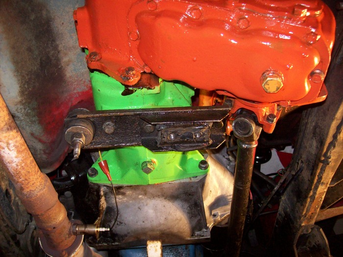

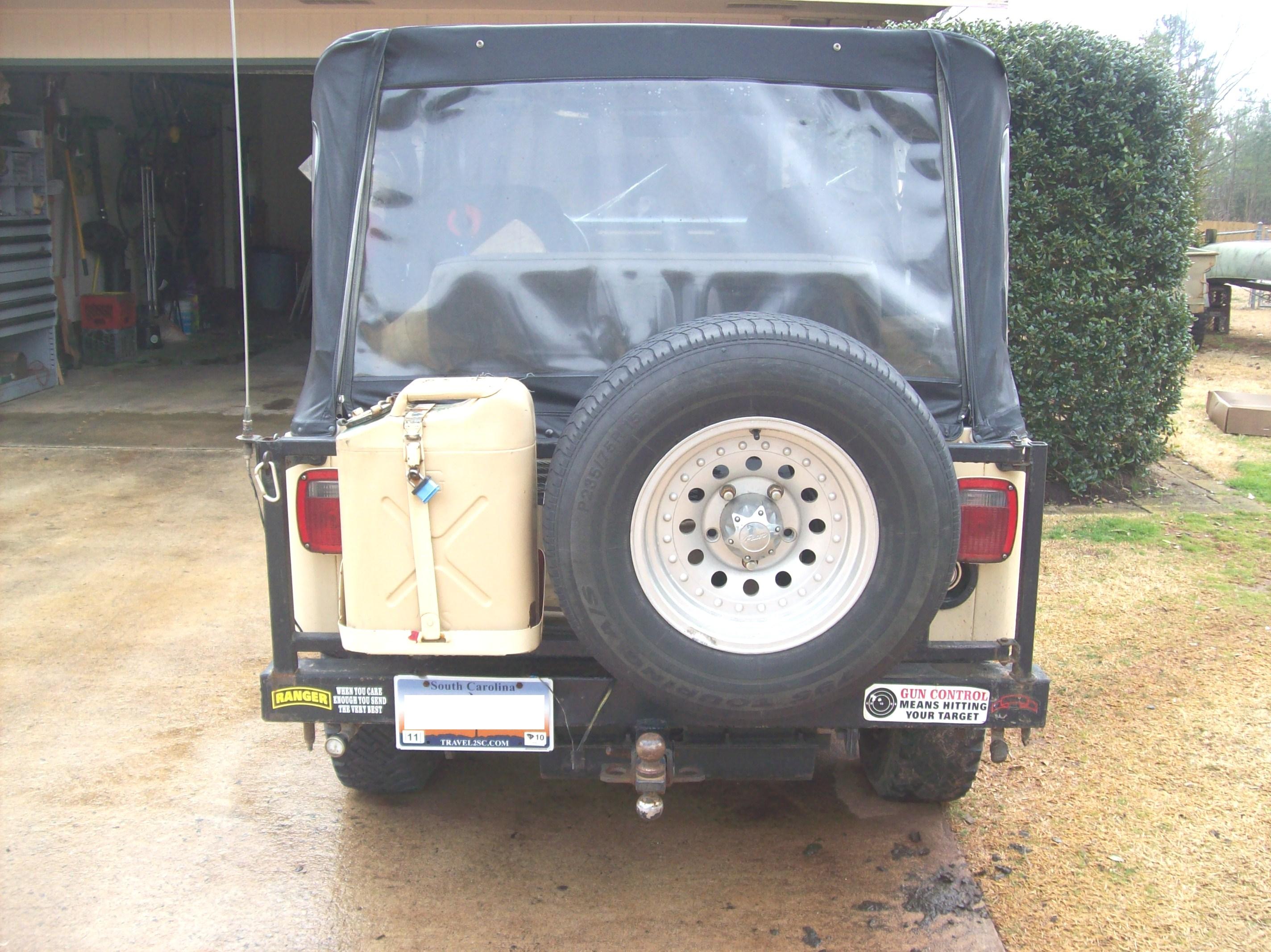

I USED TO DRIVE 70 MILES A DAY BACK AND FORTH TO WORK, THEN "MY OWN DRIVING", I GOT TIRED OF FILLING UP EVERY DAY WITH THE 15 GALLON TANK. I OPTED TO GET THE 21 GALLON POLYETHYLENE (TOPPED OFF, IT REALLY HOLDS 22 GALLONS!)
I REALLY LIKE IT---IMPROVED RANGE IS NICE!
WHEN I WAS IN THE ARMY, I ALWAYS HAD TO MAKE A FUEL STOP SOMEWHERE BETWEEN SAVANNAH, GA (HUNTER ARMY AIRFIELD) AND MY HOMETOWN NEAR GREENVILLE, SC. IT ALWAYS MADE ME FEEL LIKE I WAS WASTING TIME WHILE TRYING TO GET HOME ON FURLOUGH, WHEN IT TOOK ME AN ADDITIONAL 30 MINUTES TO GET OFF THE INTERSTATE AND FIND A GAS STATION!
LAST YEAR I MADE THE SAME TRIP (1987 WAS THE LAST TIME), TO GO SEE A RANGER BUDDY......FELT SO GOOD TO ARRIVE IN SAVANNAH, WITH FUEL TO SPARE, WITH NO STOPS ALONG THE WAY.
I'M NOT A HERMIT, I DO TRAVEL IN MY JEEP UP THIS WAY, IT'S JUST THAT THIS TRIP REALLY HIT HOME, WITH THE OVER-SIZED TANK
THE ONLY DRAWBACK I SEE WITH THE BIG TANK, IS THAT IT RIDES LOWER THAN THE 15 GALLON TANK, EXTREME 4X4ing, ESPECIALLY IF IT'S ROCKY TERRAIN IS YOU MAY SMACK IT AROUND MORE, OR IT MIGHT DRAG OR HANG YOU UP. I HAD MY FEEL OF ALL OF THAT WITH MY 1ST THREE CJ 5s. I STILL WILL GO 4 WHEELING, USUALLY THRU NECESSITY OR EXPLORING, BUT THE "TRASHING OF MY JEEP" IS NO LONGER PART OF THE PROGRAM!
THE POLYETHYLENE TANK IS STILL PROTECTED WITH THE ORIGINAL TANK'S SKID PLATE, THE NEW TANK COMES WITH EXTENSIONS WHICH ALLOW IT TO HANG A FEW INCHES LOWER
NOW, WITH A "NORMAL" FULL FUEL LOAD, I HAVE 22 GALLONS IN THE TANK, AND 5 MORE GALLONS IN MY GERRY CAN ON THE BACK
THE ONLY PROBLEMS WITH DRIVE SHAFT VIBRATIONS I HAVE EXPERIENCED IS "BAD U-JOINTS" AND "SIDE TO SIDE PLAY" IN THE "WORN" TELESCOPIC PART OF THE SHAFT......DON'T WORRY--BE HAPPY!

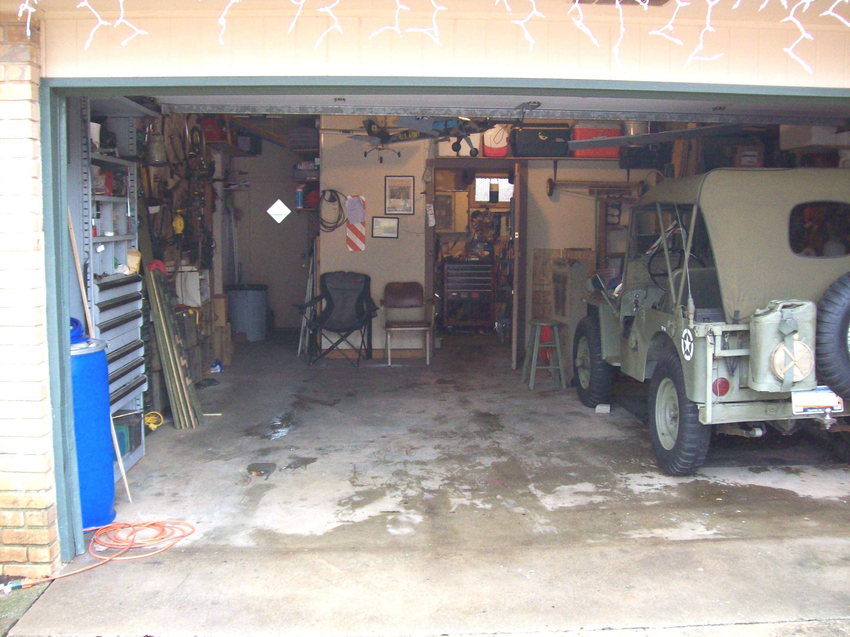

I'M GLAD THAT 7 YEARS AGO I BOUGHT US A HOUSE....COMPLETE WITH A 2 CAR GARAGE......I FEEL FOR YOU, I DID IT YOUR WAY FOR 24 YEARS
YOU JUST DON'T KNOW HOW MANY TIMES I THOUGHT ABOUT ONE OF THESE AND A KEROSENE HEATER SUITABLE FOR THIS SIZE
http://www.superiorportablebuildings.com/fabric-covers/portable-garages-for-sale-one-car-shelter-king.htm

You don't know how bad I want a garage. Tried to find one for the next house I'm moving into, but can't afford the extra rent. At least this next house has a paved driveway. Won't be wallowing around in the dirt anymore.

WHAT YOKE?
WHAT'S WRONG WITH THE OTHER ONE?
E.T.A. FOR THE ONE YOU ORDERED?

It's the yoke that I broke a bolt off inside of. The upgraded u-bolt yoke. Probably could have just fixed it easy, but I found a good deal. Turns out it shipped yesterday and should be in tomorrow. Hopefully will be driving her by Saturday.
Funny story, ran into a guy at Advance the other day who had sheared three of his bolt and strap bolts off in his yoke going to his pinion in his 95' wrangler. He was asking a rep there how to take off the pinion yoke, and the poor rep had no idea. He overheard me mention to someone I had a CJ, and he asked me about it. Got to explain to him about preload and all that jazz. I told him to look up how to change out a pinion oil seal if he wanted to remove his yoke. Kind of fun to yammer on about preoloading bearings while the advance autopart cashier's eyes glaze over (not that you'd ever do that though, medic).
