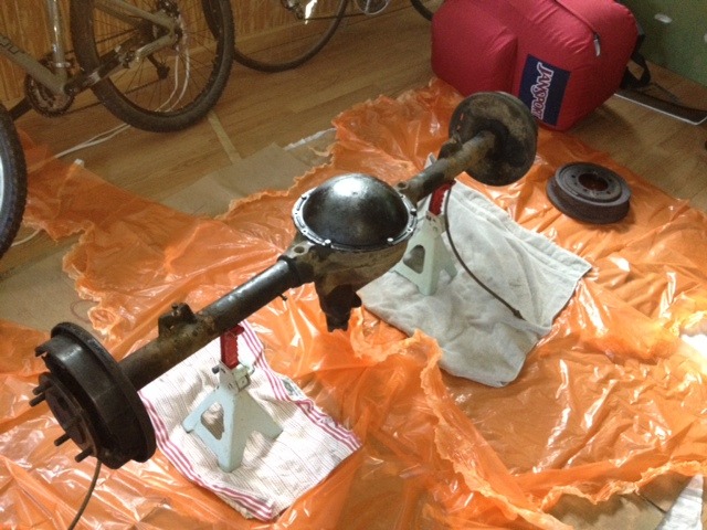

Well, I suppose it's about time something broke again. I'm getting a metallic rubbing noise at low to mid speeds. It changes frequency/pitch when I rotate the steering wheel, and it goes away when I brake.
You guessed it. Time to overhaul the braking system. I think the rubbing is just the little metal warning pins telling me that I need to replace the brake pads. However, the shoes (and probably the drums) on the rear need to be replaced as well. Last time I tried bleeding the brakes, I couldn't get the bleeder screws out of the calipers on the front disc brakes because that whole assembly was rusted up like the titanic. So there is still a little air in the brake lines. Not the safest way to operate a jeep. I figure I should just give the whole system a restore. Might as well change the oil and rotate tires too while I'm at it.
I'll post pics and keep you updated when I start. Step one is just taking the wheels off and having a look-see. I'll post preliminary pics soon.

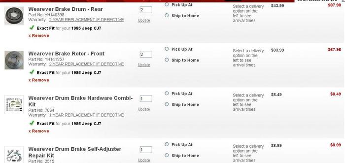

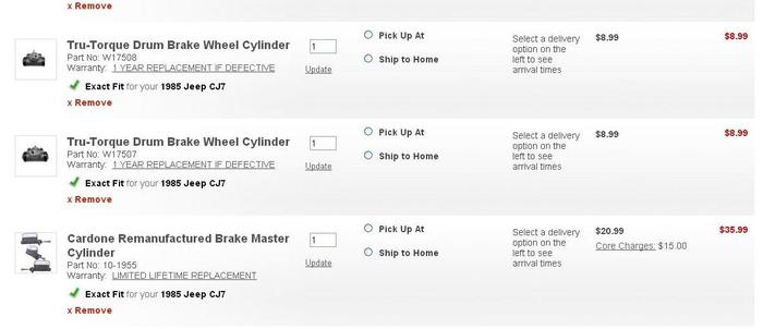

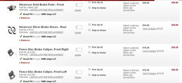

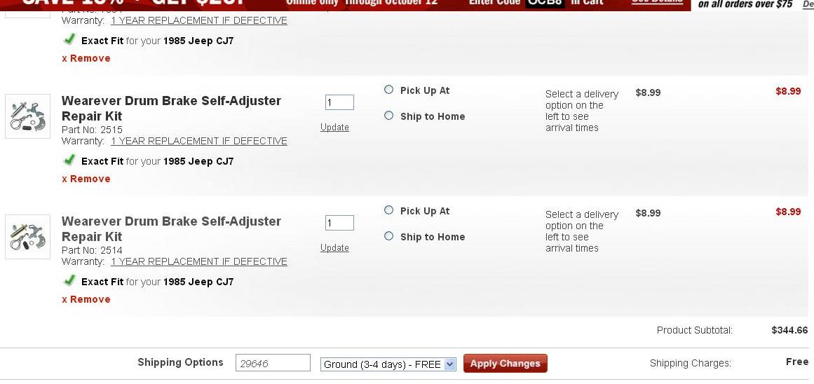

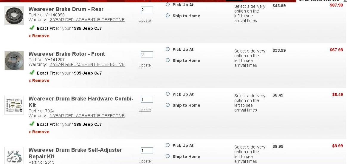

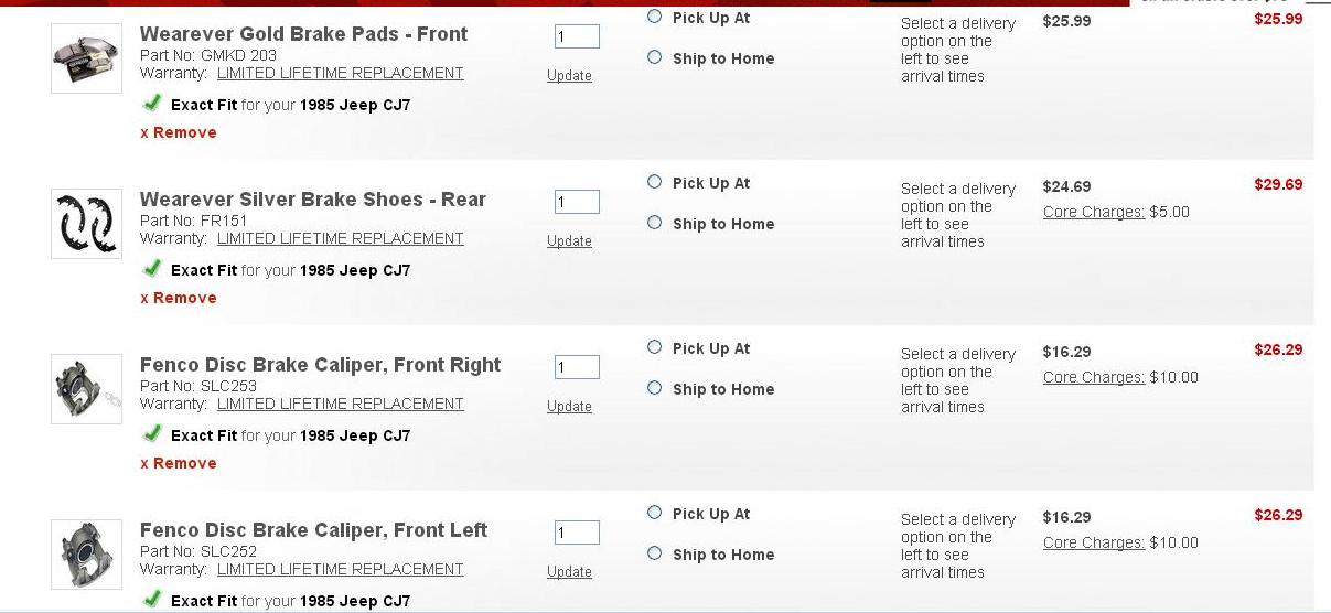

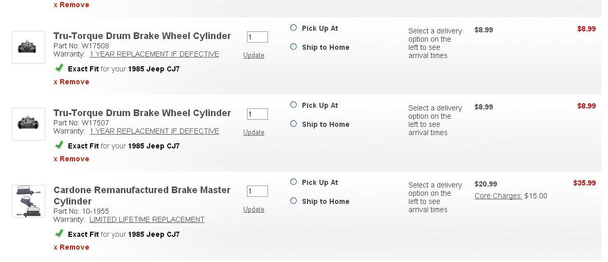

MAKE ME A LIST OFF ALL YOU WANT
DON'T BUY NUTHIN' YET!!!....LET ME SHOW YOU THE $$$ SAVING TECHNIQUE
GIVEN???---SHOES / HARDWARE (SPRINGS--SELF ADJUSTERS--ETC)/ PADS/ L CALIPER/ R CALIPER/L WHEEL CYLINDER/ R WHEEL CYLINDER/ MASTER CYLINDER/ 2 LARGE CONTAINERS OF DOT 4 BRAKE FLUID
POSSIBLE NEW DRUMS AND ROTORS?????????.....ARE YOURS TURNABLE?
LIST ANYTHING ELSE YOU MIGHT NEED---SUBTRACT WHAT YOU DON'T NEED
ALL THE ABOVE ARE ITEMS (THIS IS EVERYTHING I CAN THINK OF---FOR BOTH SIDES)
THE TOTAL RIGHT NOW IS...........$344.66
IF YOU DROP STUFF LIKE THE DRUMS AND ROTORS IT WILL BE LESS
AS IT STANDS NOW......WE MAY CAN SAVE $40 PER HUNDRED.....THAT'S $120 KNOCKED OFF OF THE $344
WANNA KNOW MORE?....MAYBE I ALREADY HAVE??? (I DID SORTA SKIM THRU YOUR POST AND DID NOT SEE IT)
GET YOUR LIST TOGETHER....REPORT BACK....WE'LL MAKE THE CHANGES AND GO FROM THERE!
RIGHT NOW, I HAVE ALL OF YOUR ITEMS IN A SHOPPING CART...I PICKED OUT DECENT PARTS (NOT NECESSARILY THE MOST EXPENSIVE)
WAITIN' ON YOU
THE MEDIC
Oct 8, 2012 at 7:02 PM
HANG EM HI
  • 71 POSTS
That's a darn good deal. I'm in the process of moving...finally. (I'll have a car port too, no more working on tarp covered dirt!) Once I get settled I'll jack her up and take a look and see what's needed. May not need drums, but probably everything else. Driving her yesterday (i know i know probably shouldn't with the brakes like this but couldn't help it), but the brake peddle would pop and make a noise every time I had to brake relatively hard which was every time I pulled up to a light. I think the rotors/calipers/pads are toast.
Oct 9, 2012 at 7:53 AM
CJ MEDEVAC
  • 11,004 POSTS
TIME FOR YOU TO DO SOME ADDING/ ARRANGING
THE IDEA (WITH NEW DRUMS) IS TO ARRANGE THIS INTO 3 SEPARATE ORDERS--BARELY OVER $100 EACH....IF A FOURTH ONE IS NEEDED, SO BE IT...WE'LL (YOU'LL) SAVE ON IT TOO!
I THINK THE DRUMS ARE COUPLED TOGETHER AS 1 ITEM....SPLIT THEM UP IF YOU NEED TO, TO GET THE ORDERS "JUST OVER" THE $100 MARK
IN ORDER DO GET IT ALL ON HERE...I MADE 4 "SCREEN SHOTS" EVERYTHING THAT SHOULD SHOW, DOES SHOW IN THE SHOTS
THIS IS FROM ADVANCE AUTO----"FABU" IS STILL THE PERFECT PROMO TO DO THIS...YOU GOTTA USE IT FOR EACH ORDER!
OK---HERE'S HOW IT WORKS.....SEE MY 7th AND 8th ANSWER IN THIS POST
http://www.2carpros.com/questions/1977-jeep-cj7-front-wheel-wont-into-4-low
I HAVE DONE THIS 3 TIMES IN THE LAST 3 WEEKS MYSELF---4 OTHER FRIEND DID IT TOO----ALONG WITH SEVERAL OTHER PEOPLE I TOLD AT THE STORE.....I HAVE SAVED $120 ALTOGETHER.......THE CODE DOES NOT WORK ON OIL PRODUCTS
NOW GET TO WORK---LET ME KNOW WHAT YOU COME UP WITH
TH LAST SHOT REFLECTS "REGULAR PRICE" IF EVERYTHING WAS BOUGHT IN ONE ORDER

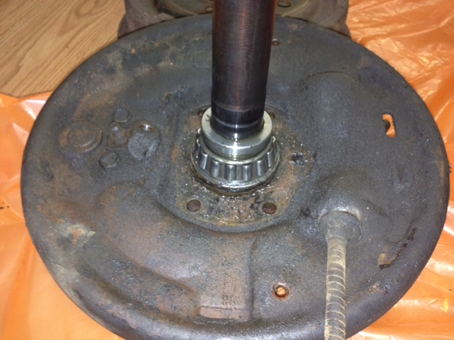

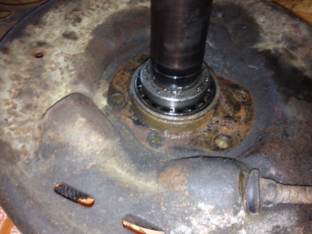

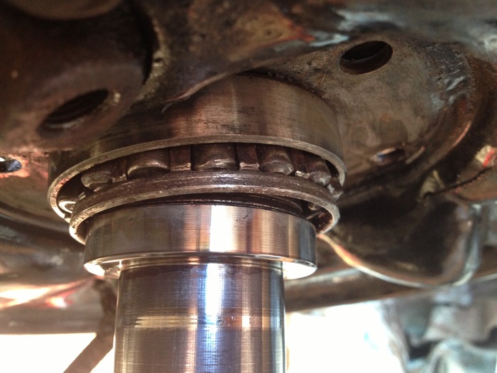

Hey Medic,
It's been a while, I know, but I finally got the brakes all shiny and new. However, that grinding sound didn't go away. While I was replacing the rear drum brake components, I noticed that the passenger side axle shaft had about a quarter inch of play back and forth. In other words, I could grab the shaft and pull it in and out just a hair. When I had it yanked all the way out, the bearings didn't roll very smoothly. They didn't roll all that smoothly with the shaft pushed back in either. I pulled the brake backing plate off and sure enough, the bearing was toast. Either it was a POS bearing or we didn't install it correctly. I knew that a flawless axle rebuild was too good to be true. Picture of the bearing below. Note the ridge that has been ground into the bottom part of the bearing. Hence the grinding sound. Reordering another set of bearings.
Think I installed it backwards? Hope you had a good Christmas season.

WE HAD THE--- "WHICH WAY DO THE BEARINGS GO" -- DISCUSSION BEFORE----I LOOKED BACK THRU THE POST.......I THINK I SCANNED AND SENT YOU THE "MOSIER" (sp) INSTRUCTION SHEET FOR THE ONES I STILL HAVE IN THE BOX, ALONG WITH ALL NEW SEALS, AND AN EXTRA SET OF BEARINGS (BOUGHT LONG AGO [MAYBE 1994], NEVER INSTALLED)---THE AXLES ALONE WERE ABOUT $500

Hang in there brother. You'll find that right job.
My bearings didn't look as bad as that guy's, but they could have gotten that bad if I had kept driving on them. Starting to make me think that either I have a bad set of axle shafts, or a bad axle tube. I found the original installation instructions for my set of axle shafts here.
http://www.quadratec.com/Assets/Installation/36659.pdf
Looks like we installed the bearings the right way. However, I didn't check that the bearings had the correct clearance pocking out of the axle housing. Methinks that's the problem. I hope it is. Sure is a lot better than ordering a brand new axle and having to do the whole darn thing over again. I called up Quadratec, and they're shipping me a set of bearings for free since they're still under the warranty. Once they get here, I'll check and see if they have the right clearance. In the meantime, I'll go ahead and see if I have a bent axle housing. That's not hard to do. Attach two meter sticks on either end of the tube and measure the distance between each side. The original manufacturers book gives the tolerances they're supposed to have.
If the new bearings don't have the right clearance, I'll buy a set of shims. Superior axle and gear's AMC 20 article said that this was a lot easier than grinding down the bearing like it recommends in the crown guide. If the tube is straight, the bearing clearance is set, and there is STILL end play, I'll just buy a new set of axle shafts.
And if that doesn't work!? Then I guess I'm buying a new set of Dana 40's. Hope it doesn't come to that. I'll keep you posted.

THE 1ST SET I EVER BOUGHT---FROM?????----BACK IN ABOUT '85?
HAD ONE PIECE ROLLER BEARINGS, NOT TAPERED ONES......I NEVER HAD A PROBLEM, THIS WAS BEFORE "THE NET", SOLD THAT JEEP A FEW YEARS LATER........HEARD THRU THE GRAPEVINE, OTHERS (NOT THE JEEP I HAD PREVIOUSLY) HAD LOST THE REAR WHEEL AND AXLE, WHEN THE ROLLERS SHELLED OUT.........LOOKS LIKE IT WOULDA MADE A HECK OF A RACKET, LONG BEFORE IT COME OUT........SOME PEOPLE DON'T CARE, DRIVE IT ANYWAY, DESPITE OF THE "SCREAMS FOR HELP" GENERATING FROM THE REAR
THIS COULD BE THE REASON THE DESIGN IS NOW USING TAPERED BEARINGS
I'M NOT "MR. ON TOP OF EVERYTHING"---I'M NOT FACTORY TRAINED OR NONE OF THAT GOOD STUFF!......I TRY TO HELP ALL I CAN THRU MY OWN EXPERIENCES....I DO ATTEMPT TO LEARN ALL I CAN, USUALLY FROM NECESSITY, OR EVEN WHILE AIDING SOMEONE ELSE......NOT FROM SEARCHING ALL OVER AND SOAKING IT IN, LIKE IT WAS A HOBBY!.....................I DON'T RECKON MANY CAN SAY THEY HAVE HAD A CJ FOR A PRIMARY DRIVER.....THEIR WHOLE LIFE!
BEAR WITH ME ON SOME OF THIS STUFF
THE "MOSER" SET I STILL HAVE IN THE BOX, HAS TAPERED BEARINGS AND PRESS ON COLLARS.....THEY ARE AT MY M.OTHER'S HOUSE, IN MY STORAGE BUILDING....I'D PROBABLY HAVE TO LOOK AT 'EM TO SEE HOW THE BEARINGS GET PRELOADED (AS YOU KNOW WITH THE DIFF, CORRECT PRELOAD IS IMPORTANT)
TO SAVE ME A SEARCH (I RECKON YOU COULD CALL ME A EMAIL HOARDER, IN MY INBOX)--GO TO "MESSAGES" AND GIMME YOUR EMAIL AGAIN
NOW---ACTUALLY LUBING THE BEARINGS (ALL WHEEL BEARINGS AND ANY OTHER ONES THAT REQUIRE GREASE)----ALL BUT 90 WEIGHT LUBRICATED ONES (INTERNAL TRANNY/ TRANSFER CASE/ DIFF ARE EXCLUDED)
