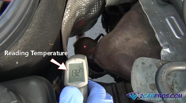

2. Infrared Temperature Meter: For this test you may need to raise the car in the air to get access to the catalytic converter. So, start with the car on level ground after you have driven your car around the block a few times to heat up the exhaust system. This will make the testing more accurate, when the catalytic converter is cold the chemical reaction is diminished, wear protective gloves, clothing and eyewear.
Point an infrared temperature meter at the inlet pipe as it enters the catalytic converter. If the cat is made directly into the exhaust manifold, measure the top of the canister or the upper portion while avoiding the manifold itself and take a temperature reading.
temperature reading catalytic converter inlet
Next, do the same test at the outlet tube of the catalytic converter, the temperature should be hotter by about 20% showing the chemical reaction is working, if the temperature is colder, (as in this example) the cat is bad, (For best results have the engine running).
catalytic converter testing outgoing temperature

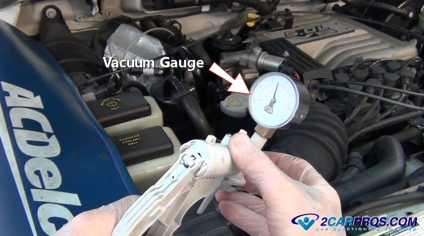

6. Vacuum Gauge Rebound Test: Attach a vacuum gauge to a vacuum port on the intake manifold system. You may need to remove the vacuum feed line to the EVAP system or another component temporarily. Start the engine and allow it to idle as you observe the intake vacuum reading which should be between 18 to 22 inches of mercury (inHg). Have a helper snap the throttle, (push down and quickly release), there should be a brief drop in vacuum as the throttle is opened, but it should return to baseline pressure almost instantly, if this reading takes longer than a few seconds to recover the cat is plugged.
7. Partial Clog: Keep the engine at about 2,500 RPM and watch the vacuum gauge, if the reading is low, or continues to drop this is a good indication there is blockage in the converter and replacement is required.
