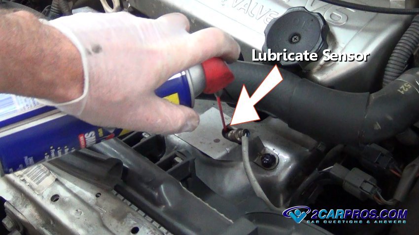

 Before beginning, park the car on level ground and allow to cool, block the tires to prevent the vehicle from moving. Lift the car with a floor jack in the manufacturers recommend position, use jack stands to secure the car. Oxygen sensors are located in the exhaust system so be careful of hot components, wear protective clothing, gloves and eye wear. Before the oxygen sensor should be removed apply a light penetrating oil such as WD40 to help prevent thread and sensor damage.
lube o2 sensor

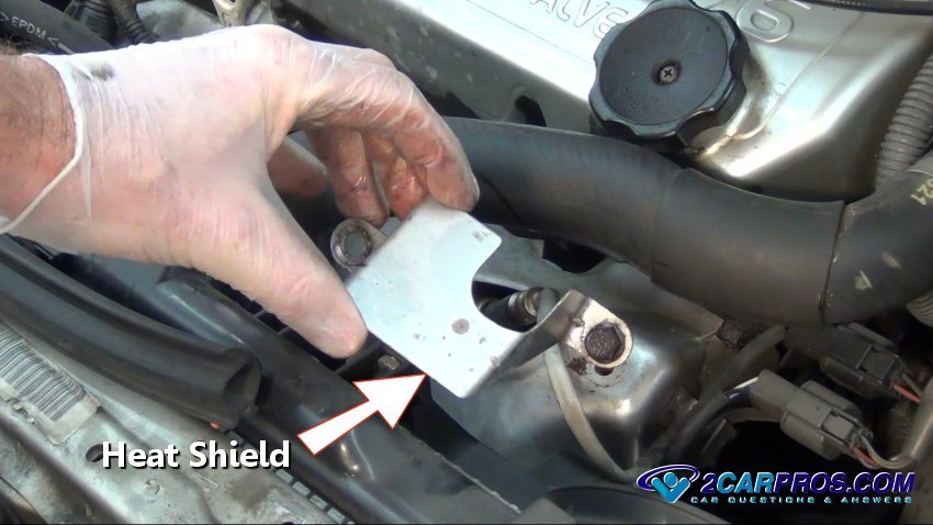

Some sensors are equipped with a heat shield that must be removed before the sensor removal, this is performed by removing any mounting bolts.
oxygen sesnor heat shield removal

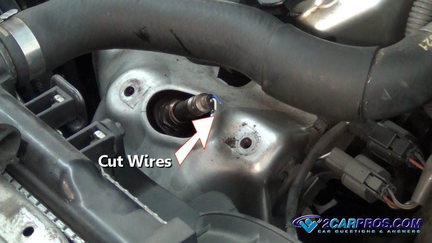

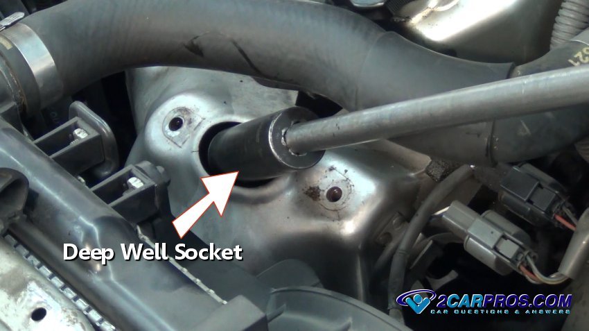

Because most of us do not have a sensor removal tool, cut the sensor wires to ease the removal, a regular wrench will also work if the wires need to be left intact.
cutt wires o2 sensor
By using a regular socket it minimizes potential damage to the sensor body and the threads, this technique helps avoid stripping the old sensor upon removal.
o2 sensor removal socket

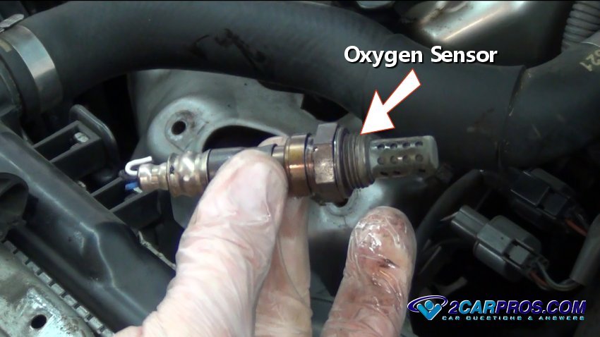

Once the old sensor has been removed, inspect the threads for damage which is common with these sensors.
oxygen sensor

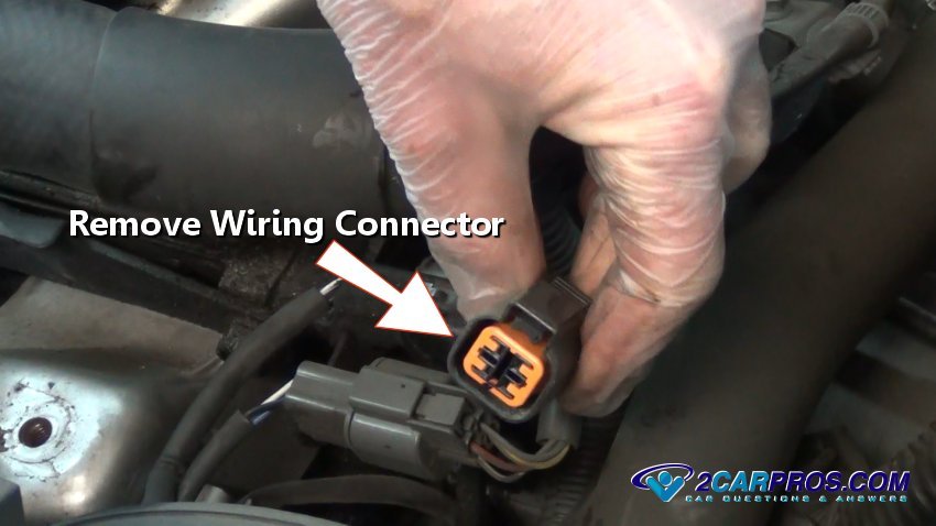

Locate and disconnect the wiring connector, this step should be done before removing the sensor if the wiring is still attached.
o2 sensor connector

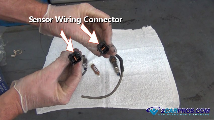

Its important that the wiring harness connectors are exactly the same, each sensor is unique to it's position and is located in the system by its connector configuration. Some replacement sensors have a universal electrical connector that must be configured to the wiring of the old sensor.
oxygen sensor wiring connectors

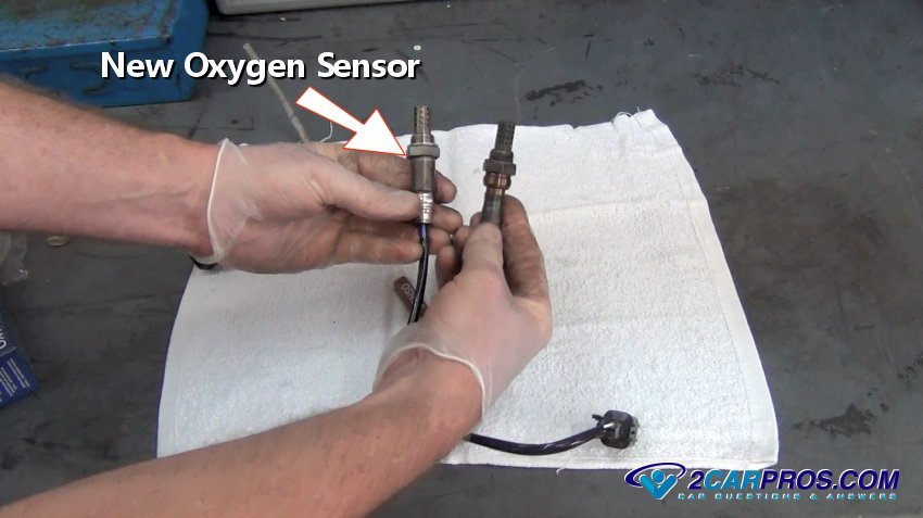

Compare the new sensor to the old sensor to ensure a proper installation.
new oxygen sensor

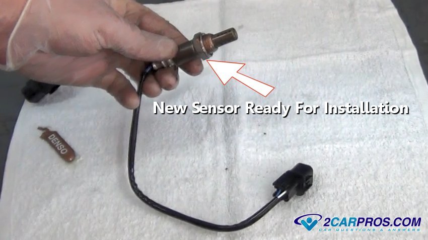

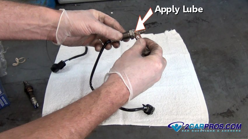

Most new oxygen sensor manufacturer's include a small amount of anti-seize lubricant to help condition the mounting threads.
lube oxygen sensor
After lubricating the threads and comparing the wiring harness connector the sensor is ready for installation.
new oxygen sensor

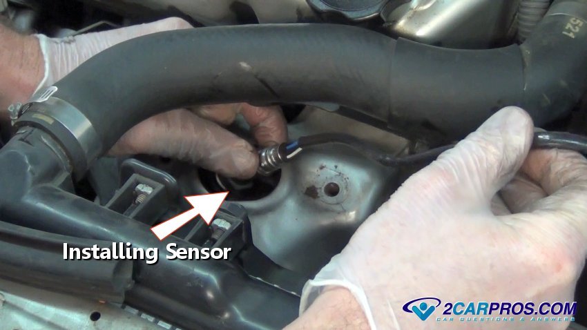

Use a small wire brush to help clean the threaded port to ensure a proper seal of the new sensor. Gently install the new oxygen sensor by hand while keeping the wiring and connector free from bends.
installing oxygen sensor

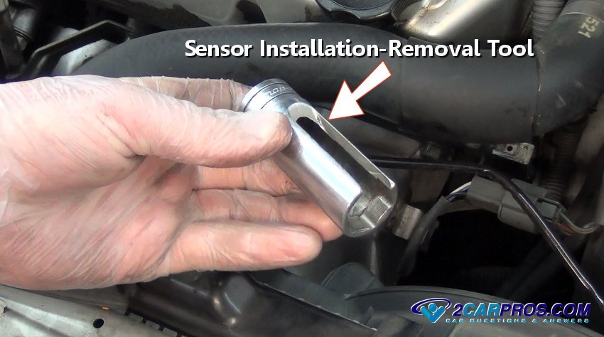

Most sensor installations can be performed by using a normal 7/8 wrench, but when the sensor is obstructed by a heat shield etc. it helps to have the installation-removal tool.
oxygen sensor removal tool

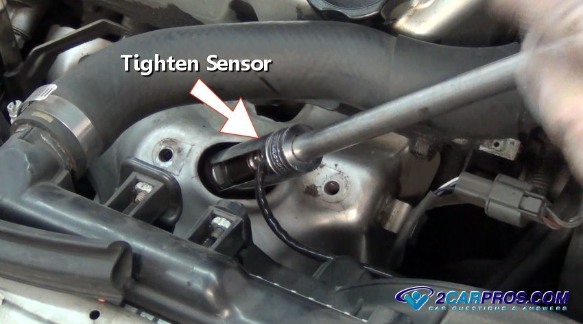

Gently tighten the sensor while keeping wiring free from damage, these sensors need to be fairly snug to avoid leakage.
tighten oxygen sensor

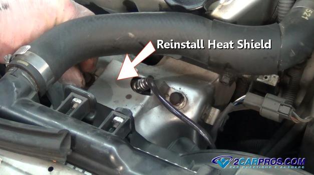

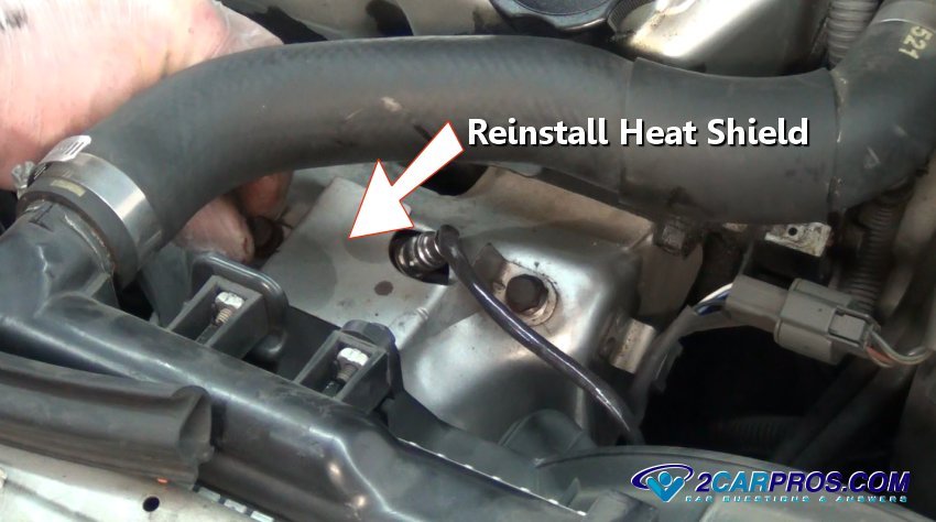

Once the sensor is tightened, reinstall any heat shields or bracing that had to be removed.
heat shield installation

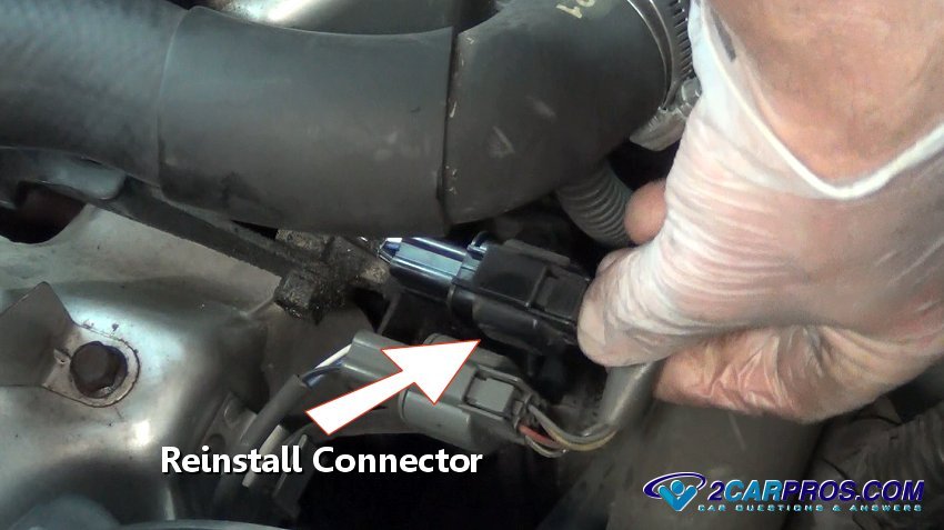

After the heat shield has been reinstalled, mount the connector to it's holder and reattach the connector back onto the wiring harness. If the car has diagnostic trouble codes, they will need to be cleared.
reconnect oxygen sensor wiring connector
