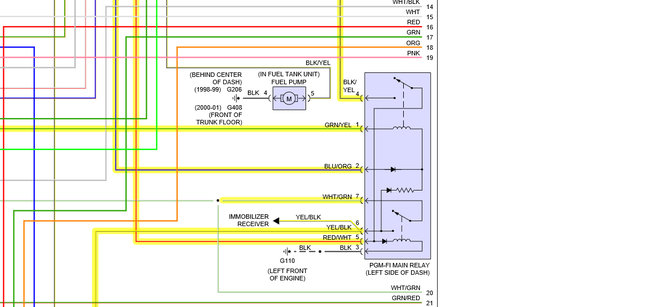

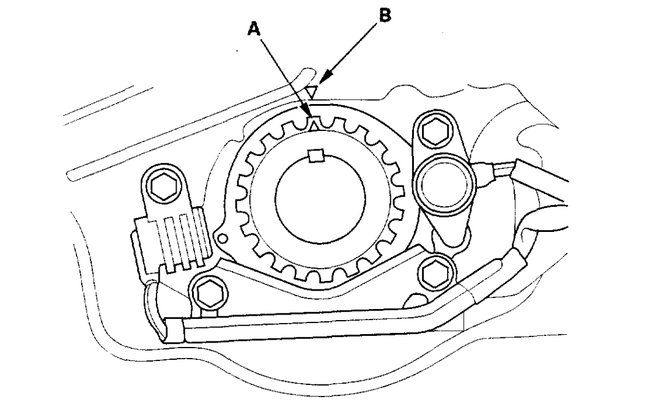

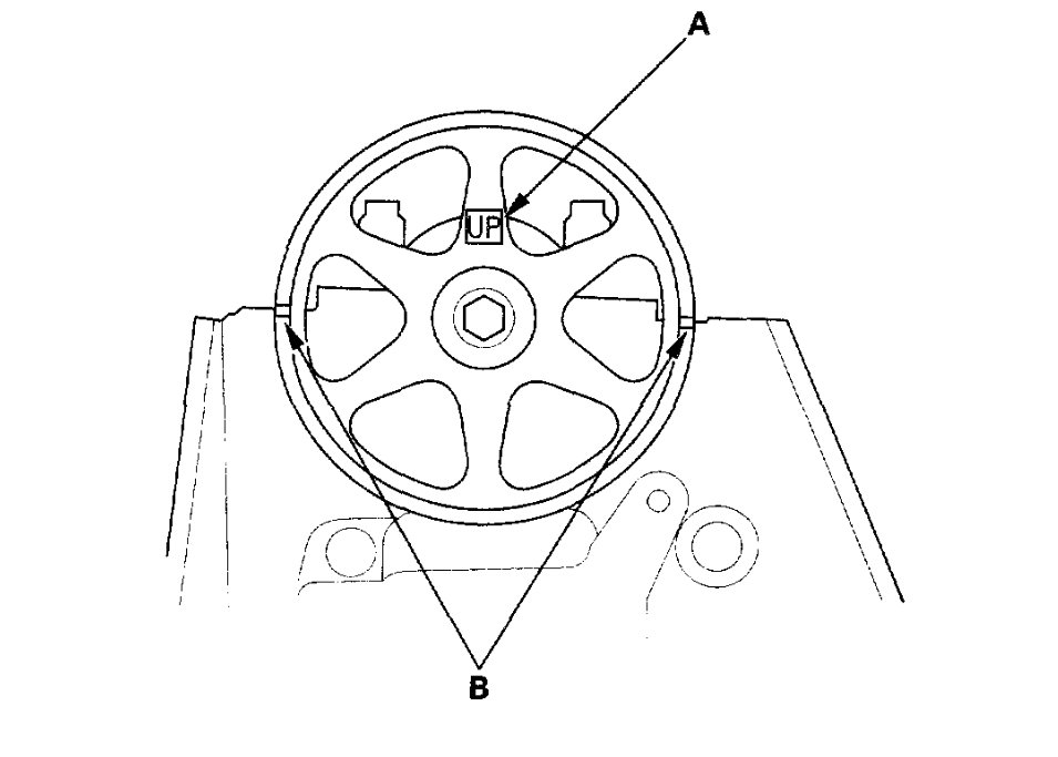

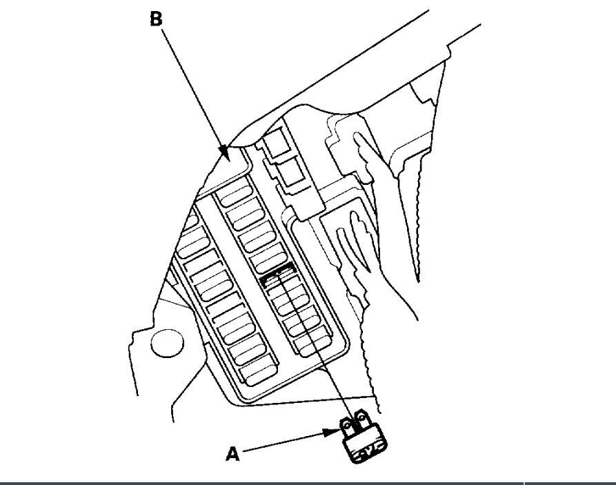

Okay, so i have the car listed above lx model. i can't get it to start. I replaced the battery fuse and battery. And i bought some starter fluid and sprayed it into the air duct and still no start.. it cranks and wants to start but is not starting. What could this be?
Mar 22, 2020 at 7:33 AM
TOUGHDIVER
  • 226 POSTS
This could be the engine timing belt has jumped out 1 or 2 teeth. I'm attaching repair guides and the timing marks below. Let us know if you need more information.
https://www.2carpros.com/diagrams/honda/accord/1999
When you turn the key to the on position without cranking the engine over can you hear the fuel pump run in the tank for 5 seconds?
Mar 22, 2020 at 8:33 AM

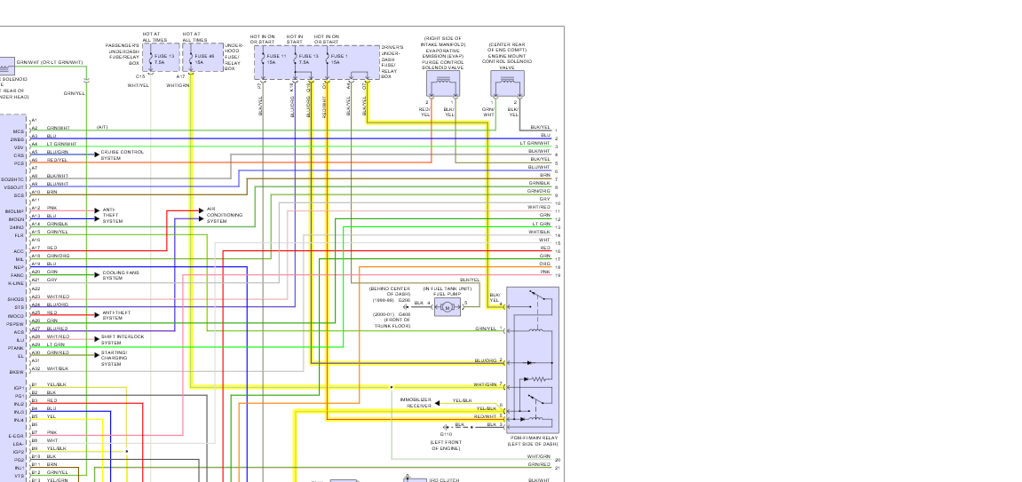

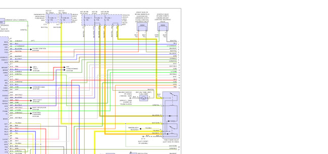

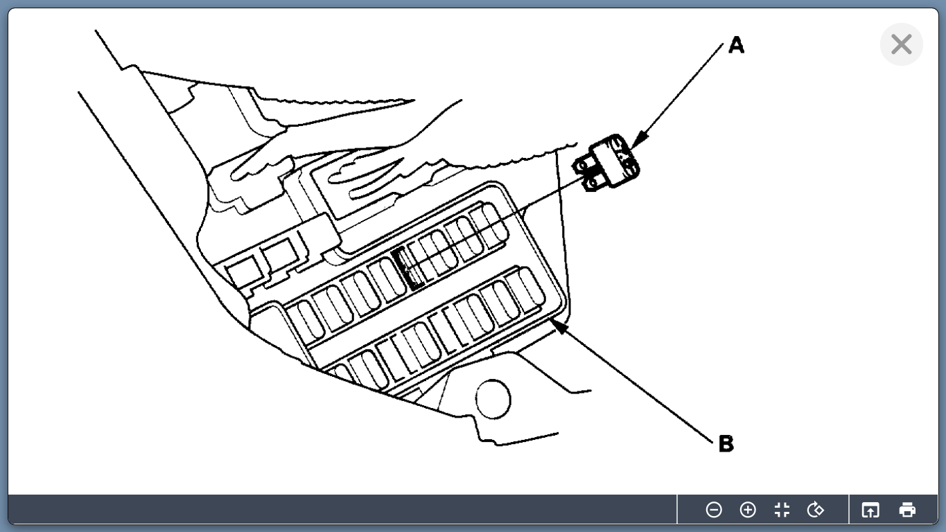

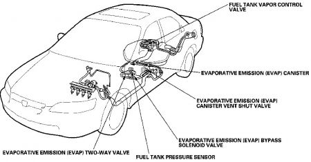

What is the third image of? Or what fuse is that and is it in the car or under the hood?
Mar 24, 2020 at 3:37 AM
TOUGHDIVER
  • 226 POSTS
I attached the third imaged by mistake the fuse is the one you pull to reset the computer.
Remove the back up light fuse 7.5 A (A) from the passenger's under-dash fuse/relay box (B) for 10 seconds. But if you clear the trouble codes you might need them or a repair shop my need them for diagnostic purposes. Let us know if you need more Info.
Thanks
Joe T.
Mar 24, 2020 at 5:51 AM

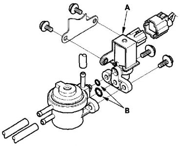

I have an intermittent starting problem and have narrowed it down to a relay. When it does not start, it does get spark but no fuel. If I spray some fuel injector cleaner in the intake, it starts for a few seconds. If I let the car sit, it will eventually start. When it does not start, there is no clicking sound from the relay in the dash. When it does start I can hear the click from the relay. With that said, does it sound like a faulty relay? If so, where exactly is it located? (The car is with my son who is away at school - I need to describe to him where exatly to look). Is there a photo or illustration of it's location?

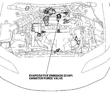

Where is the purge solenoid located and what are the steps to replace it? Thanks.
Sep 28, 2020 at 9:47 AM (Merged)
SERVICE WRITER
  • 9,123 POSTS
https://images.2carpros.com/forum/automotive_pictures/30961_hopub_1.jpg
https://images.2carpros.com/forum/automotive_pictures/30961_hopua_1.jpg
https://images.2carpros.com/forum/automotive_pictures/30961_hopu_1.jpg
This last one I added just cause I was there.
https://images.2carpros.com/forum/automotive_pictures/30961_hopuc_1.jpg
OLDSMAN1728
  • 5 POSTS
Thanks for the diagrams - looks easy ehought to locate and change. Do you know what the symptoms are of a defective purge solenoid?
SERVICE WRITER
  • 9,123 POSTS
Typically from the ones I have seen, is it will set a code, and throw the CEL. Other than that, I don't recall others.

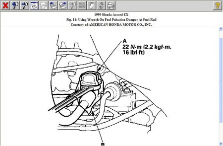

Honda Accord, 130000 - History unknown. Car has driven fine for me for several years. For the past few months, I have the following symptoms:
1. Car is drives fine at all speeds - steady state. However, when slowing to a red light or acclerating from a slow speed it periodically jerks a bit.
2. If the car is not started for a few days. It will not start. It turns over and churns but the car will just not start. If I do this for a few consecutive days (normally 2-3) it will eventually start normally and drive fine (with the exception listed above).
Today, I drove the car. I changed the oil tonight. It had been over 10k since the oil was changed. When I was done the car won't start. It displays symptoms listed in #2 above. I verified oil level, tighness of oil cap, drain plug and filter. During the oil change, the only thing that happened that was 'unusual' was that when i removed the oil filter I spread a good about of oil on all components below the filter when i dropped the filter accidentally.
I am ready to affect whatever repairs I need to restore this car. Your assistance is greatly appreciated.
Sincerely,
Matt
KHLOW2008
  • 41,814 POSTS
Hi Matt, Thank you for the donation. When engine could be cranked but does not fire up, you need to verify if it is fuel or ignition system that is causing the fault. 1. Fuel. Test for fuel pressure at fuel rails by releasing the fuel pulsation damper. Use a wrench on the fuel pulsation damper (A) at the fuel rail. Place a rag or shop towel (B) over the fuel pulsation damper. NOTE: Replace all washers whenever the fuel pulsation damper is loosened or removed. Slowly loosen the fuel pulsation damper one complete turn. If pressure is available, fuel would gush out confirming there is pressure.
https://images.2carpros.com/forum/automotive_pictures/192750_FuelPressureRelieve99Accord_1.jpg
If pressure is not available, next to it you can see the fuel pressure regulator. Remove the hose and attach another hose with a collection at its end. Turn ignition switch ON. If fuel rushes out, fuel pump is ok and the regulator is faulty. If no fuel rushes out, check the PGM-FI main relay and fuel pump.
https://images.2carpros.com/forum/automotive_pictures/192750_PGMFIRelay99Accord_1.jpg
2. Ignition. This would be more complex as it involves many components so the first step is to test for sparks at spark plugs. Remove a plug wire and attach a spark plug to its end and ground it to the engine. DO NOT ground it to battery negative terminal, soarking can cause the battery to blow up. Crank the engine and watch the spark if any, it should be bright blue and if it is dull orange, the ignition coil is weak. Let me know what you find out.

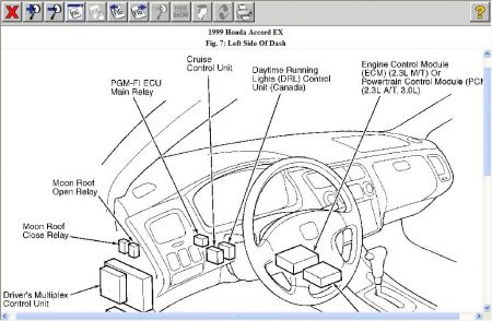

DAVID0217

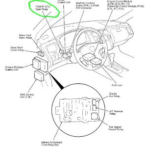

Car will intermittently not start. Could be a year or days between the issue. Turns over but seems like it is not getting gas. I go through the procedures in the manual (50% pedal depression for 10 sec., 15 sec pause, full depression, repeat, etc) but doesn't work. After letting it sit for about 30 minutes or so - starts fine. Used to happen on hot days but just recently happened on a cool day.
Any ideas?
03/23/10 - Found out it is the main relay
Sep 28, 2020 at 9:49 AM (Merged)
KHLOW2008
  • 41,814 POSTS
Hi David0217,

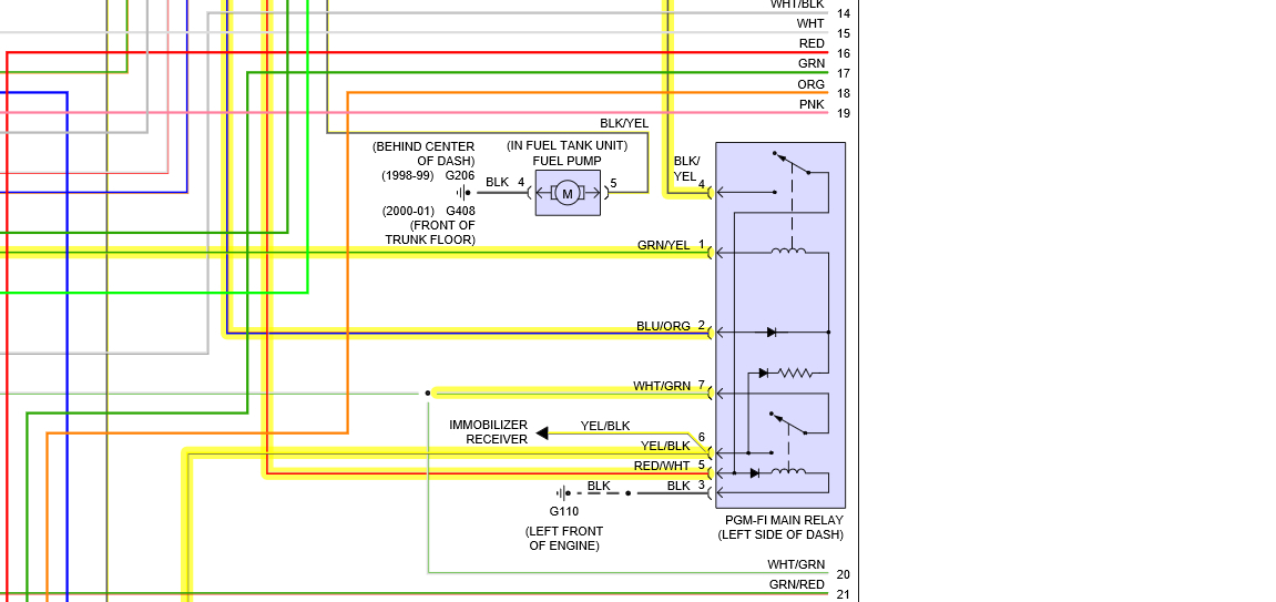

One of the item that would cause intermittent non starting due to lack of fuel is the PGM-FI main relay.
When problem occurs, you need to check if the fuel pump is running at initial ignition on.

I am wondering how to check power supply to the distributor black/yellow wire & fuel pump? (Voltmeter? If so can you give me a few more details. I have used a voltmeter a couple times, but am not that proficient with it.
I tried pulling one of the spark plug wires and putting another spark plug in it to see if it received spark but I couldn't see any.
I have tried to listen and see if the fuel pump engages when the ignition is turned on, but I don't hear anything. I obviously need to follow your instruction and test the power to the both the distributor and fuel pump, but would greatly appreciate a little more instruction.
Thanks Again!! HRJ77
Sep 28, 2020 at 9:50 AM (Merged)
KHLOW2008
  • 41,814 POSTS
Hi HRJ77,
You are welcomed.
So far so good, we are going in the correct direction.
No sparks at plug means the distributor is not providng any, hope you did ground the plug while cranking.
To check for power supply to distributor, unplug the coupler and connect the Black/Yellow wire to a voltmeter or a test lamp to ground and turn ignition switch on. Battery voltage should be present/test lamp lights up means power is available.
If no power supply, you need to check for broken wires, blown fuses, bad or disconnected wire connectors.
We settle this first.
