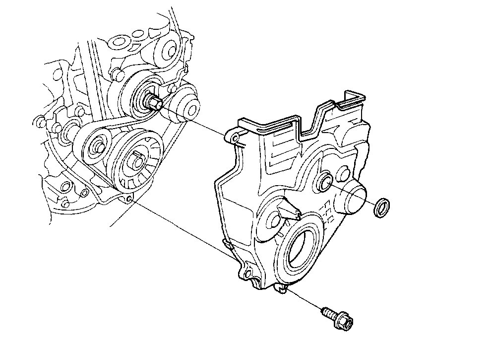

Sep 28, 2020 at 10:04 AM (Merged)
CHRIS W CARNEY

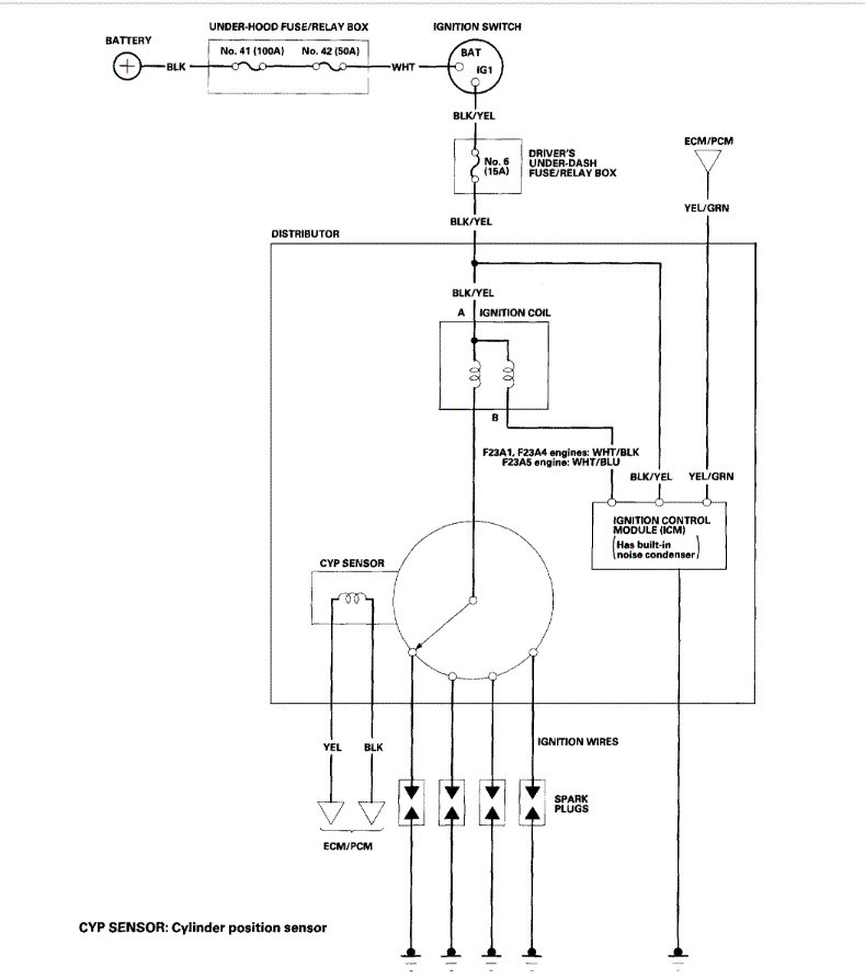

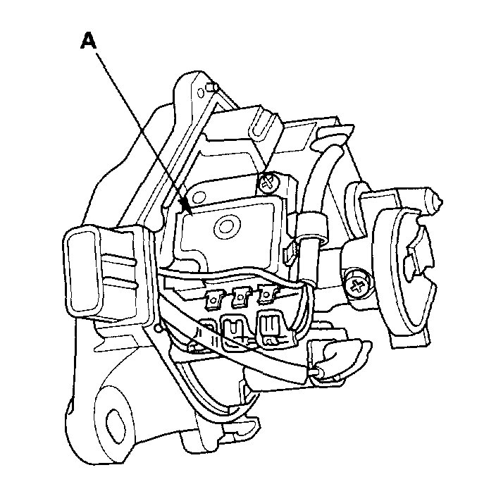

Chances are the ignition control module has failed. That is where I would start checking. Here are the diagnostics related to it. The attached pics correlate with the directions. The very last pic is a schematic for the ignition system.
___________________________________________
1999 Honda Accord LX Sedan L4-2254cc 2.3L SOHC (VTEC) MFI
Component Tests and General Diagnostics
Vehicle Powertrain Management Relays and Modules - Powertrain Management Relays and Modules - Ignition System Ignition Control Module Testing and Inspection Component Tests and General Diagnostics
COMPONENT TESTS AND GENERAL DIAGNOSTICS
NOTE:
- If the malfunction indicator lamp (MIL) comes on, refer to the Fuel and Emission System.

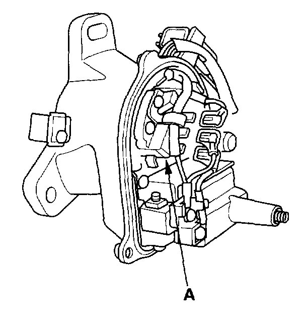

- Perform an input test for the ignition control module (ICM) after finishing the fundamental tests for the ignition system and the fuel and emissions systems.
- The tachometer should operate normally if the ICM is OK.
1. Remove the distributor ignition (DI) cap, the distributor ignition (DI) rotor, and the leak cover.
F23A1 and F23A4 2.3L SOHC VTEC
pic 1
F23A5 2.3L SOHC Non-VTEC
pic 2
2. Disconnect the wires from the ICM (A).
3. Turn the ignition switch ON (II). Check for voltage between the BLK/YEL wire and body ground. There should be battery voltage.
- If there is no battery voltage, check the BLK/YEL wire between the ignition switch and the ICM.
- If there is battery voltage, go to step 4.
4. Turn the ignition switch ON (II). Check for voltage between the WHT/BLK (WHT/BLU for the F23A5 engine) wire and body ground. There should be battery voltage.
- If there is no battery voltage, check:
- ignition coil.
- WHT/BLK (WHT/BLU for the F23A5 engine) wire between the ICM and ignition coil.
- If there is battery voltage, go to step 5.
5. Disconnect the 25P connector from the ECM/PCM, and check for continuity on the YEL/GRN wire between the ICM and ECM/PCM. There should be continuity.
6. Check for continuity on the YEL/GRN wire to body ground. There should be no continuity.
7. If all the tests are normal, reconnect the ECM/PCM 25P connector B, and replace the ICM.

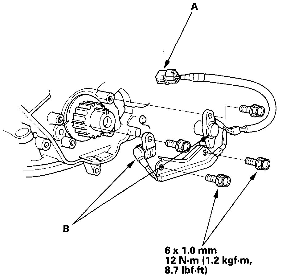

Okay. The last thing I can think of is the crankshaft position sensor and top dead center (TDC) sensor. The TDC controls ignition timing when starting and the crank sensor controls ignition and injection timing when running. Have you replaced that as well? If not, can you get a live data scanner? If so, see if there is an RPM reference on the scan tool when cranking the engine. If there isn't, replace these two items. Here are the directions:
______________________________________________
1999 Honda Accord EX Coupe L4-2254cc 2.3L SOHC (VTEC) MFI
Procedures
Vehicle Powertrain Management Sensors and Switches - Powertrain Management Sensors and Switches - Computers and Control Systems Crankshaft Position Sensor Service and Repair Procedures
PROCEDURES
1. Remove the balancer belt.
2. Remove the balancer belt drive pulley.
pic 1

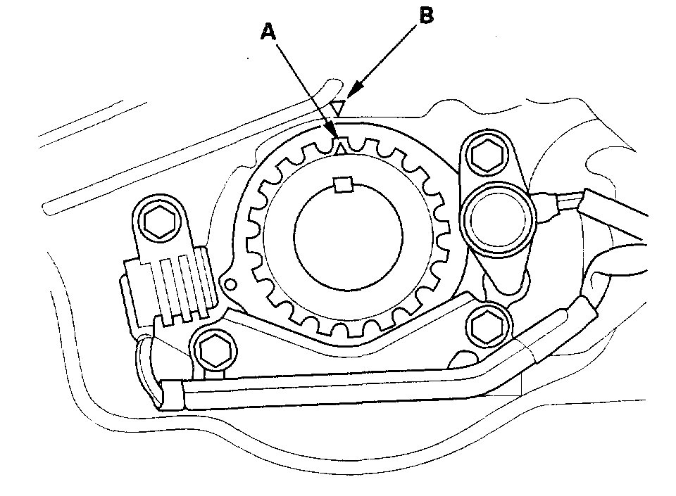

3. Disconnect the CKP/TDC sensors connector (A), then remove the CKP/TDC sensors (B).
4. Install the CKP/TDC sensors in reverse order of removal.
5. Install the balancer belt.

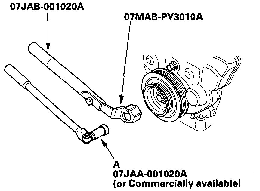

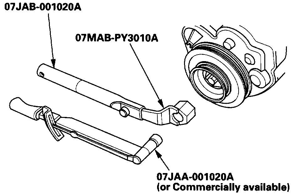

Special Tools Required
- Holder Handle 07JAB-001020A
- Holder Attachment, 50 mm, Offset 07MAB-PY3010A
- Socket, 19 mm 07JAA-001020A or a commercially available 19 mm socket

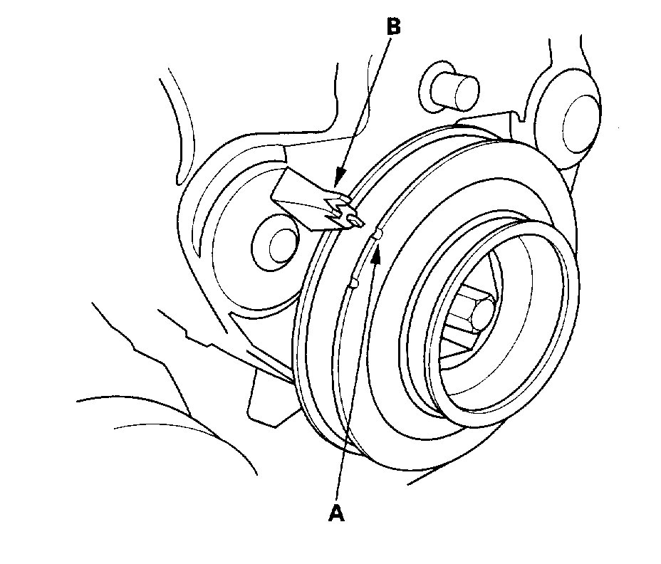

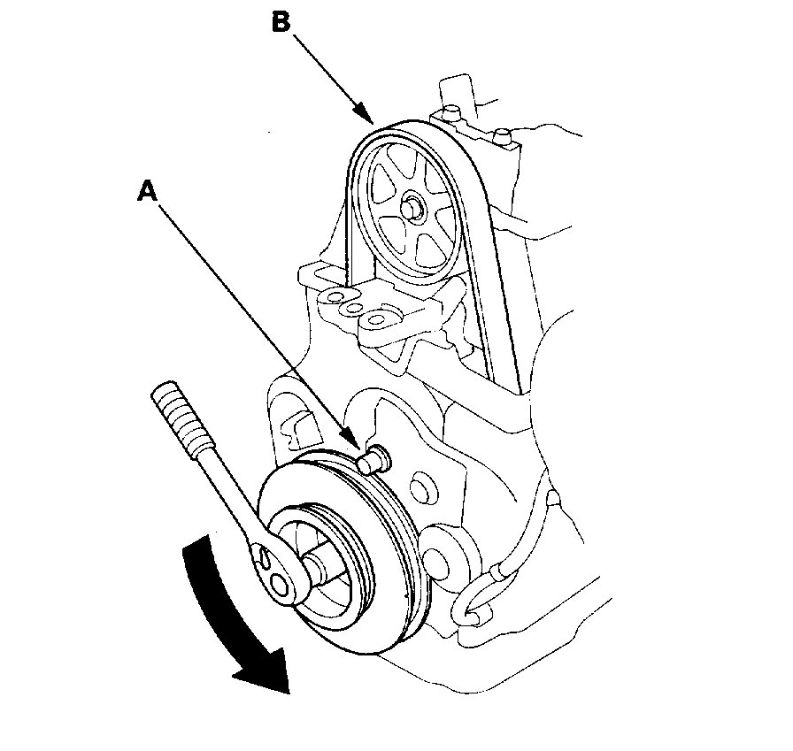

3. Turn the crankshaft pulley so its Top Dead Center (TDC) mark (A) lines up with the pointer (B).

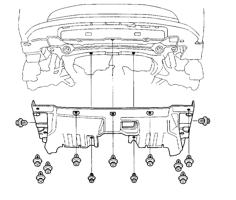

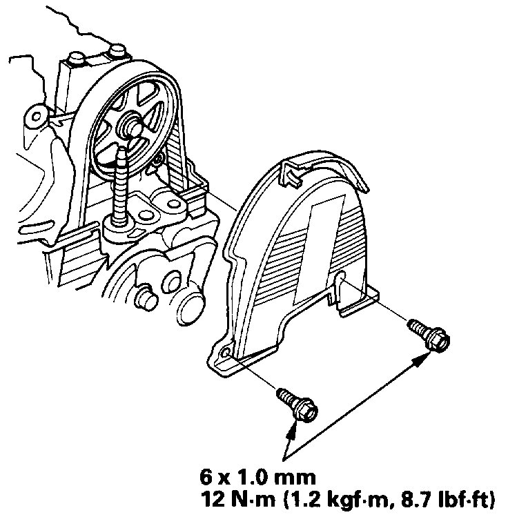

5. Remove the splash shield.
pic 3

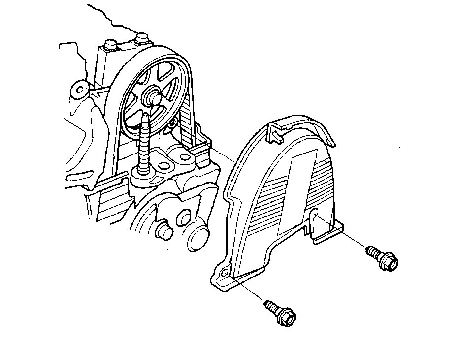

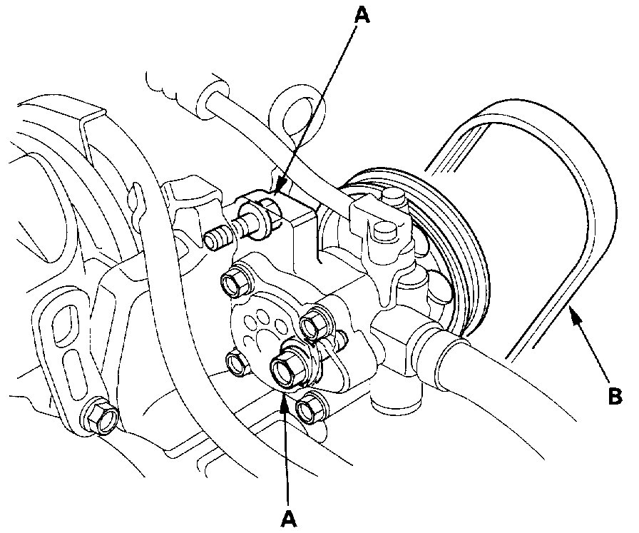

6. Loosen the mounting bolts (A), then remove the Power Steering (P/S) belt (B).
pic 4

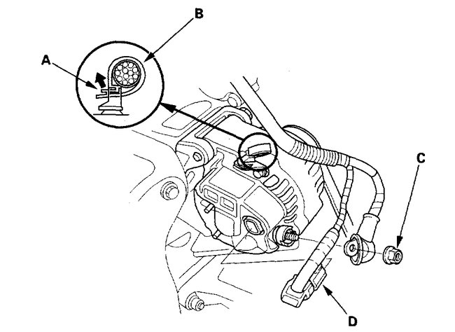

7. Disconnect the alternator wire harness.
-1 Pull up the lock (A), then release the wire harness tie (B).
-2 Pull back the boot and remove the 6 mm nut (C).
-3 Disconnect the connector (D) from the alternator.

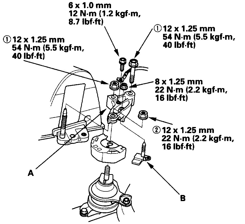

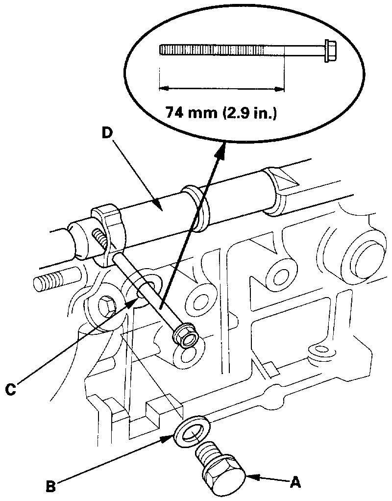

10. Support the engine with a jack and wood block under the oil pan.
pic 5

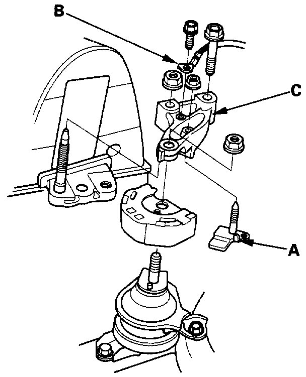

11. Remove the stop (A) and ground cable (B), then remove the upper bracket (C).
12. Remove the cylinder head cover.

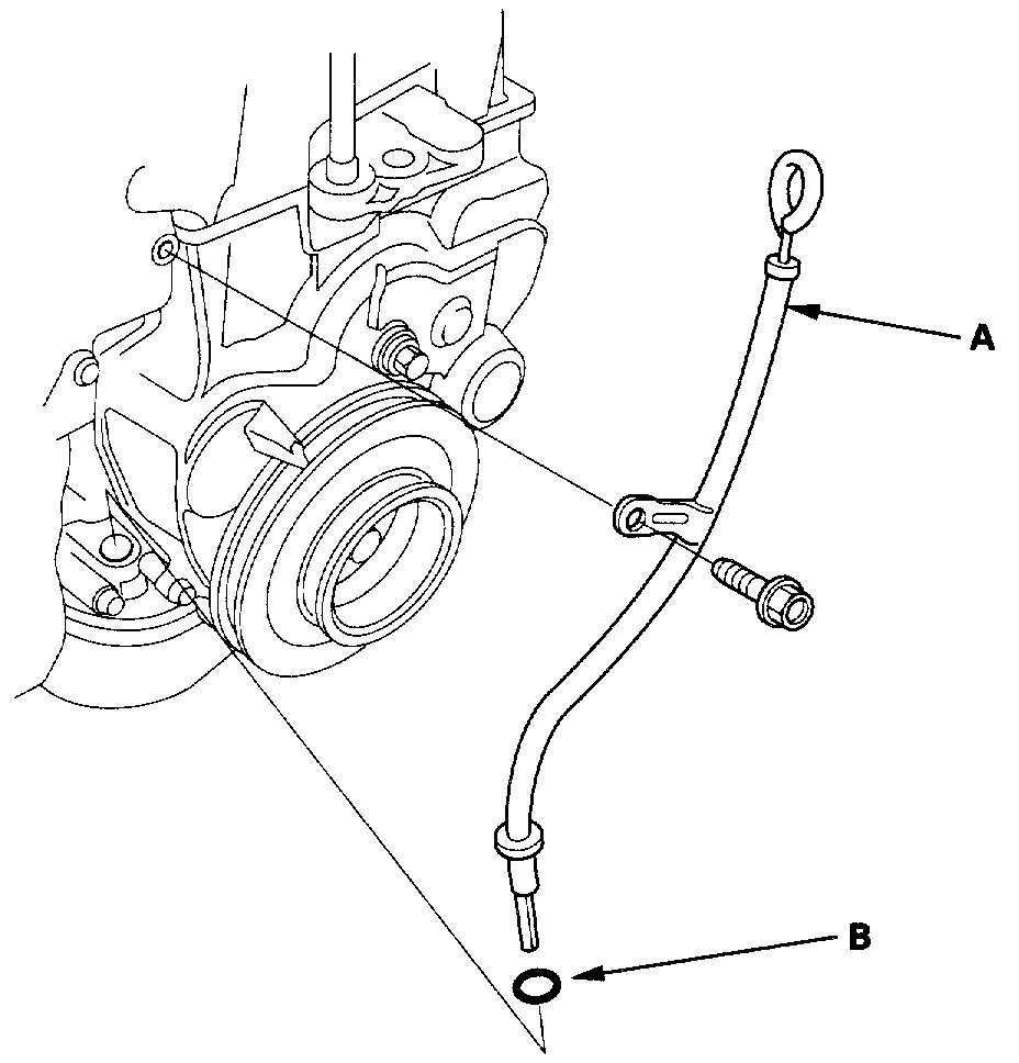

14. Remove the dipstick and tube (A). Discard the O-ring (B).

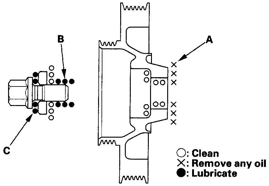

15. Hold the pulley with the special tools.
16. Remove the bolt with a heavy duty 19 mm socket (A) and breaker bar.
pic 9

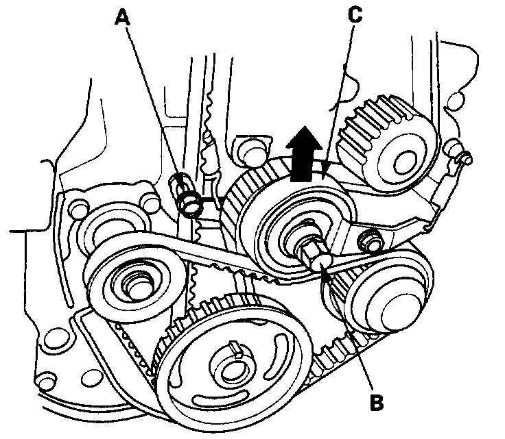

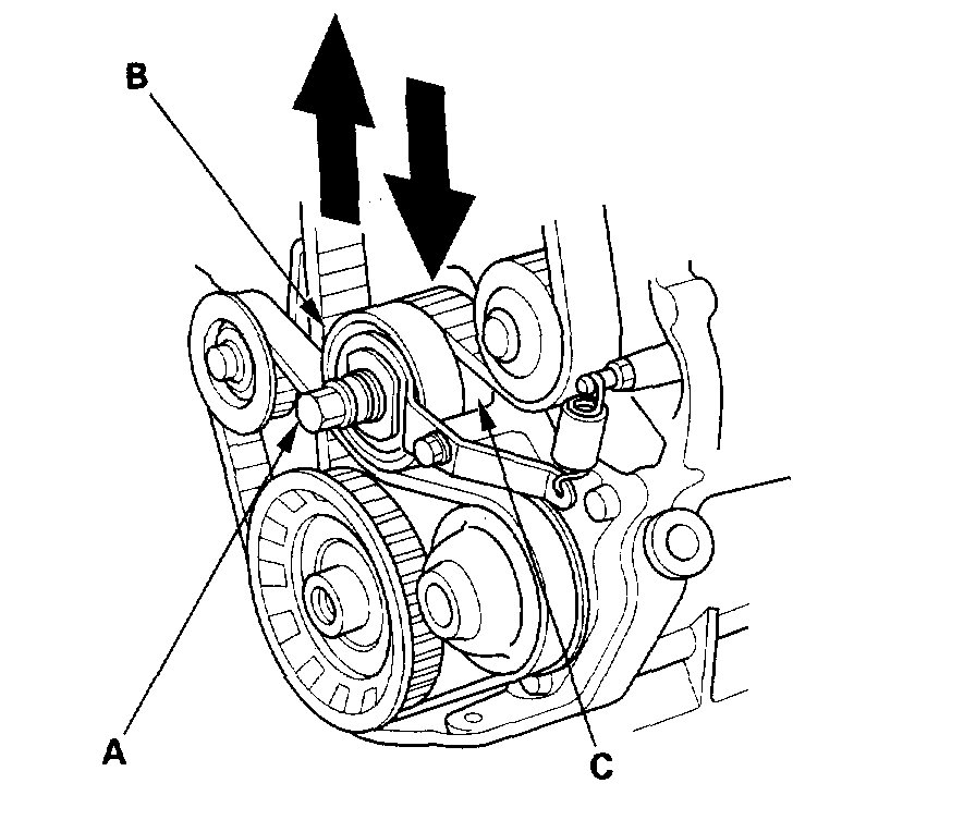

19. Release tension from the balancer belt:
-1 Install a 6 mm bolt (A)(from the timing cover) through the hole in the end of the timing belt adjuster arm to temporarily lock the arm in place.
-2 Loosen the adjusting nut (B) 2/3 - 1 turn.
-3 Push the tensioner (C) up to take tension off the balancer belt.
-4 Retighten the adjusting nut (B).
pic 11
20. Release tension from the balancer belt and the timing belt:
-1 Loosen the adjusting nut (A) 2/3 - 1 turn.
-2 Push the balancer belt tensioner (B) up to take tension off the balancer belt.
-3 Push the timing belt tensioner (C) down to take tension off the timing belt.
-4 Retighten the adjusting nut (A).
21. Remove the balancer belt.
22. Remove the timing belt.

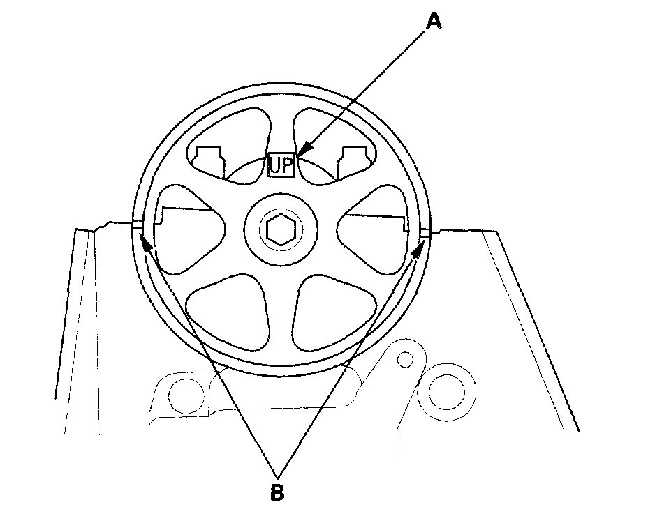

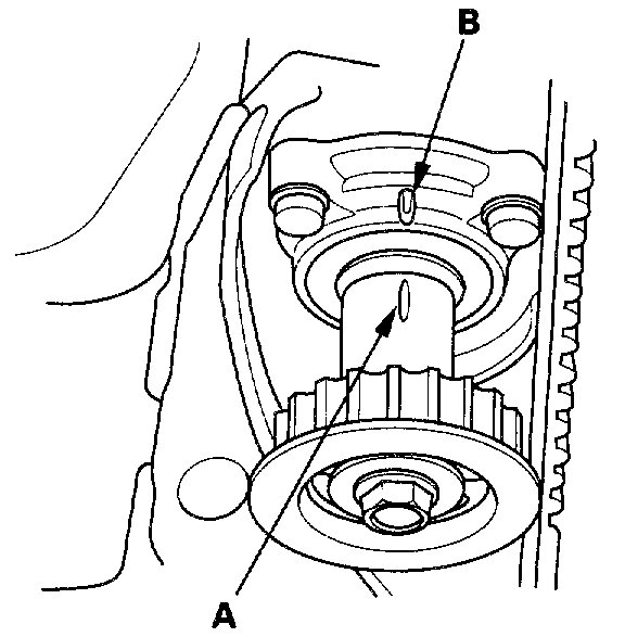

3. Set the crankshaft to Top Dead Center (TDC). Align the dimple (A) on the tooth of the timing belt drive pulley with the pointer (B) on the oil pump.
pic 13

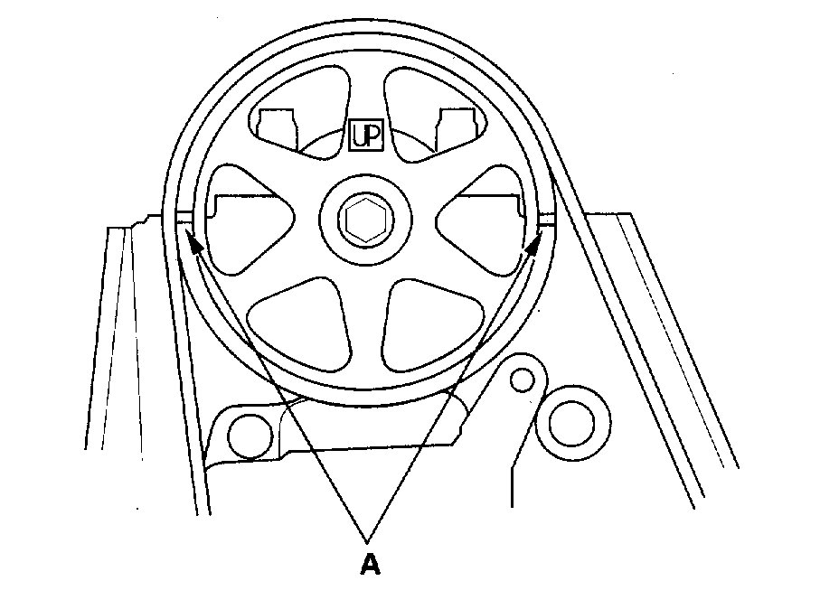

4. Clean the camshaft pulley and set it to TDC.
-1 The "UP" mark (A) on the camshaft pulley should be at the top.
-2 Align the TDC grooves (B) on the pulley with the top edge of the head.
pic 14

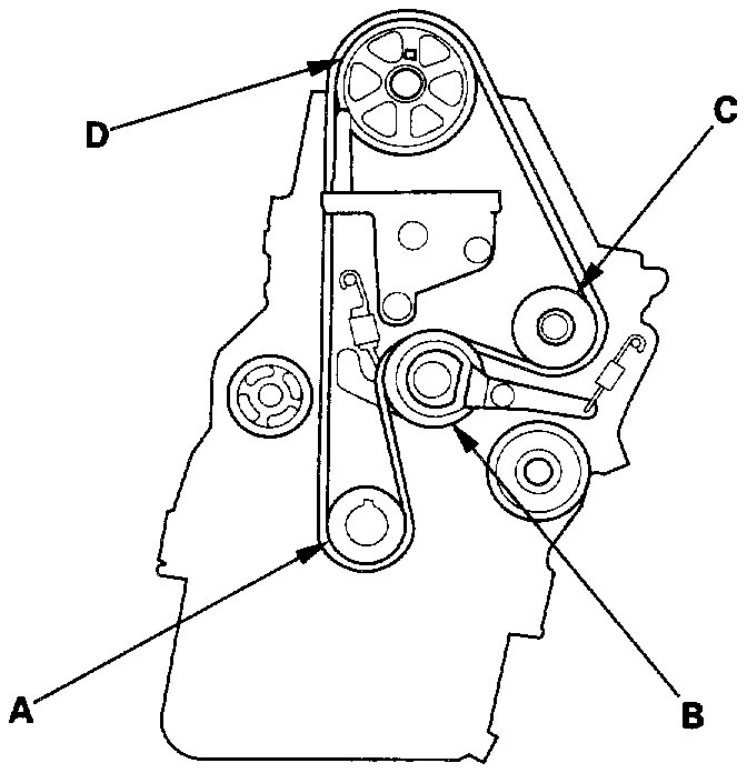

5. Install the timing belt in a counterclockwise sequence, starting with the drive pulley.
-1 Drive pulley (A).
-2 Tensioner pulley (B).
-3 Water pump pulley (C).
-4 Camshaft pulley (D).

11. Rotate the crankshaft pulley five or six turns counterclockwise to seat the timing belt on the pulleys.

13. Turn the crankshaft pulley so its TDC mark (A) lines up with the pointer (B).
pic 17
14. Check the camshaft pulley marks.
- If the camshaft pulley marks are also at TDC, go to step 15.

17. Lock the timing belt adjuster arm in place with one of the 6 mm timing cover bolts.
18. Loosen the adjusting nut 2/3 - 1 turn, and make sure the balancer belt tensioner moves freely. Then push the tensioner up and retighten the adjusting nut.

19. Align the rear balancer shaft pulley with a 6 x 100 mm bolt (or equivalent).
-1 Remove the bolt (A) and washer (B) from the maintenance hole (C).
-2 Scribe a line on a 6 x 100 mm bolt, 74 mm (2.9 in) from the end.
-3 Insert the bolt in the maintenance hole and into the hole in the balancer shaft (D) up to the line you scribed.
pic 19
20. Align the groove (A) on the front balancer shaft with the pointer (B) on the oil pump housing as shown.
21. Install the balancer belt. Loosen the adjusting nut 2/3 - 1 turn to tension the balancer belt. Retighten the bolt.
22. Remove the 6 x 100 mm bolt from the maintenance hole and reinstall the sealing bolt. Tighten the bolt to 29 Nm (3.0 kgf.m, 22 ft. lbs.).
23. Adjust the balancer belt.

26. Remove the crankshaft pulley and reinstall the lower cover.
27. Install the rubber seal around the adjusting nut.
28. Clean the crankshaft pulley bolt and washer.
pic 20
29. Clean all oil off the inside face (A) of the crankshaft pulley, and apply lubricant to the pulley bolt (B) and washer (C).
pic 21
30. Install the crankshaft pulley, and tighten the bolt to 245 Nm (250 kgf.m, 181 ft. lbs.) using the special tools.

31. Install the dipstick and tube (A) with a new O-ring (B).

37. Install and adjust the power steering pump belt.
38. Install and adjust the alternator belt.

39. Install the upper bracket (A), then tighten the bolt and nuts in the numbered sequence shown.
40. Install the stop (B).

have you tried to reset your anti theft? if you have spark at the coil but not at the plugs then it's has to be either a bad wire/connection or bad rotor or dist cap is the power going to coil a light spark or a good one? have you tried replacing pgm relay with a like relay and finally is this an ultra low emission engine or has this been modified in any way.
