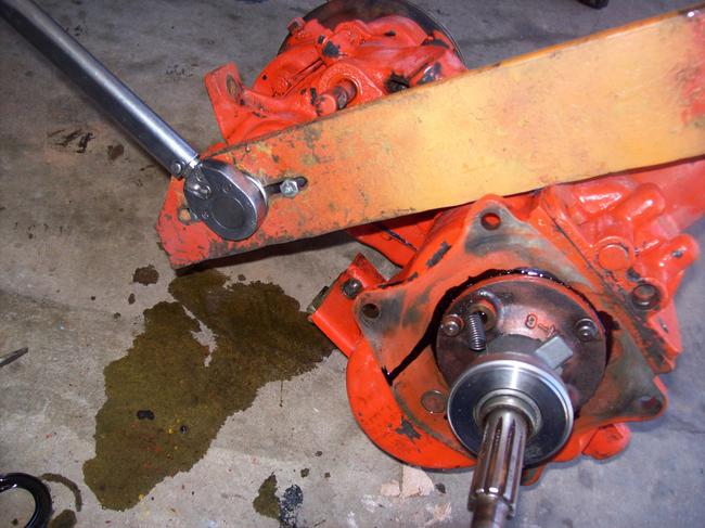

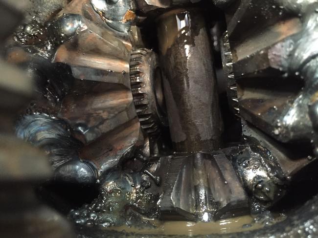

Good Evening,

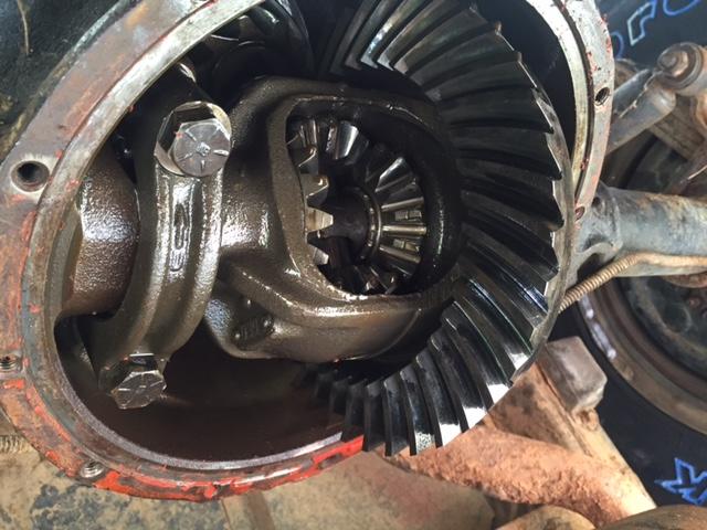

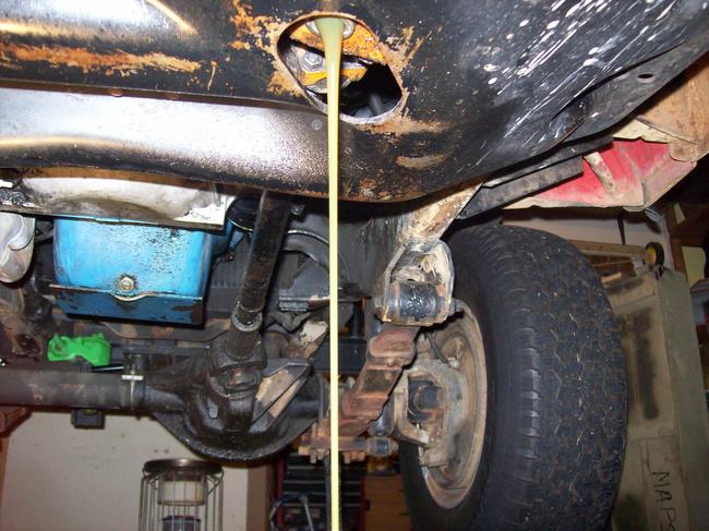

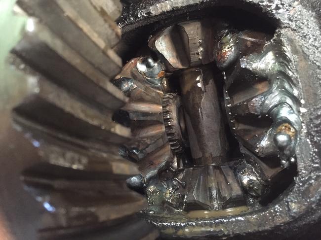

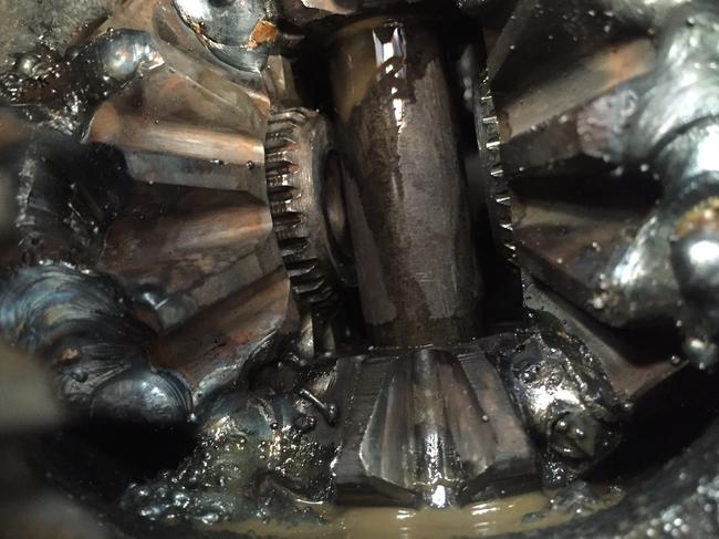

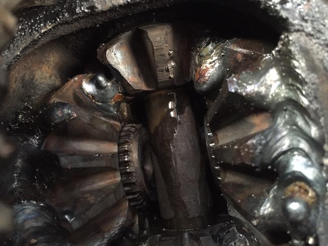

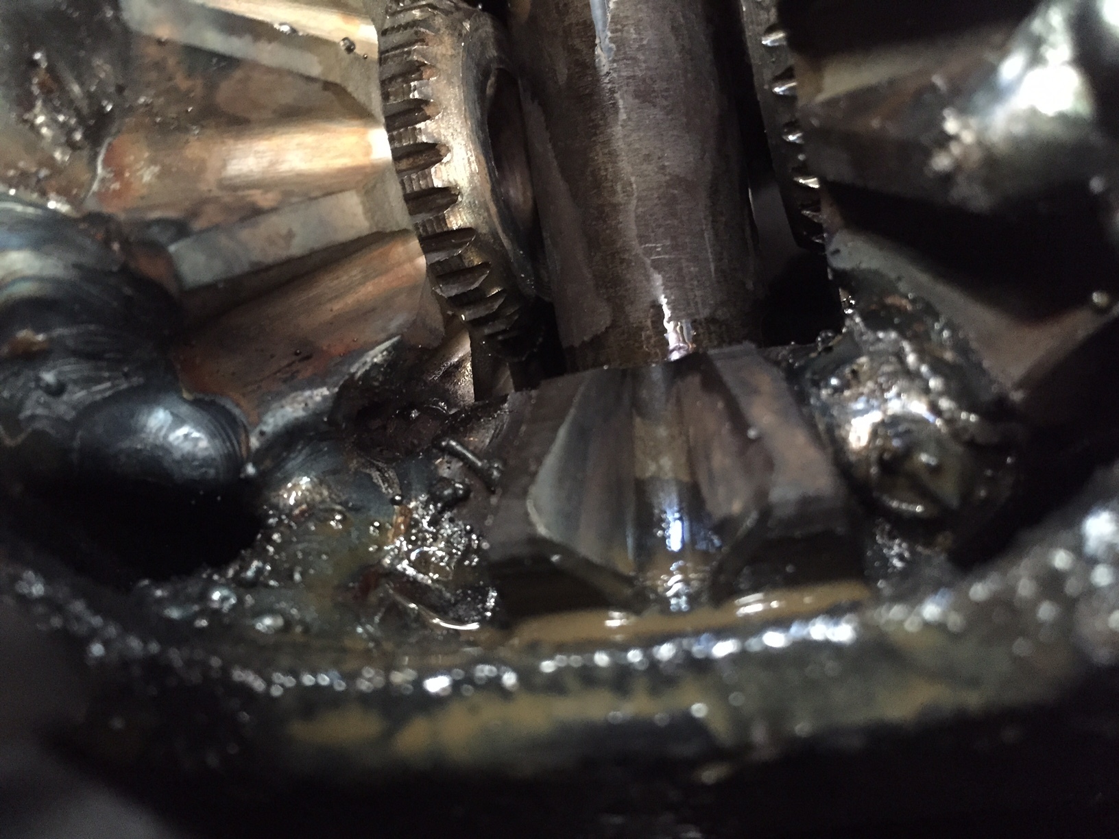

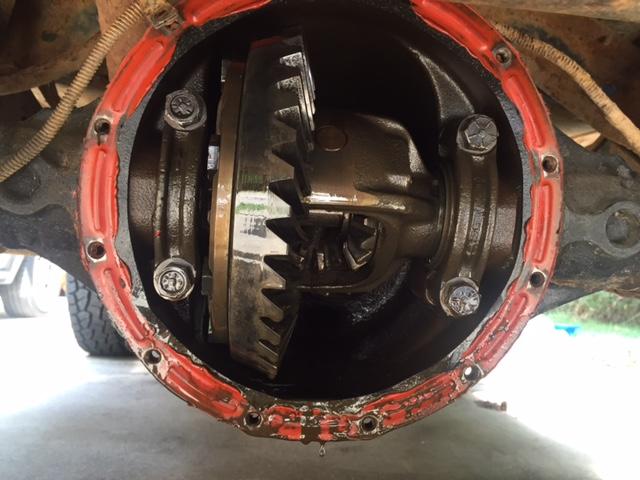

Well I pulled the Diff covers and the rear looked phenomenal! The oil may have had a lil water in it considering it was slightly chocolate like. I included a picture of them which is picture 1 AND 2. I found not metal shaving and everything looked great! whew what a relief.
THEN THE HARDCORE JEEPER PREVIOUS OWNER STRUCK AGAIN..... REFER TO ALL PICTURES BEYOND PICTURE 2!
So as you can tell they welded the front spider gears. Glad I didnt try the 4X4 trick to teach her to drive. Which as long as we are not on asphalt or hard surface we should be fine correct? There was some shavings in the front. You may be able to tell from the picture where it is grinding but, it looked like the top spider gear was wore down a bit. Now singe they are welded if we decided to go out in the snow, would that be ok? What is the limits I can do with this until we decided to replace the gears (remember we are not mudders or rock crawlers, so it should have a pretty easy life from here on out)?
I did put the covers back on and did find there respective gaskets today. I slightly tightened the bolts to allow the lil amount of RTV to set up. I also did that because what is the special additive I should add if not Lucas or something like that. The people at Oreilly and Advance pushed lucas on me for the additive. I did see a 85w-90 limited slip gear oil but it was synthetic and figured that would not work as well.
Well that is basically the latest. I did not attempt the transfer case because we got a late start.
OH GREAT NEWS! Apparently the hardcore jeepers replaced the TORX bolts with hex bolts! Well I guess they did do me one favor! Or really they did themselves a favor probably after there river expeditions.

Aug 16, 2015 at 10:52 AM
www.youtube.com/watch?v=yYAw79386WI
LET'S MAKE SURE YOU KNOW WHAT YOU HAVE UP FRONT
AS LONG AS YOUR HUBS ARE UNLOCKED, EVERYTHING SHOULD BE FINE AND NORMAL, EVEN IN 4WL, YOU WILL HAVE THE "TEACHING" REDUCTION, AS LONG AS YOUR HUBS ARE UNLOCKED!
WHEN YOU DO LOCK IN THE HUBS, YOU WILL HAVE "FULL TIME POSITIVE TRACTION" (ONLY ON THE FRONT)
THIS IS NOT NOT NOT NOT LIMITED SLIP!
THIS IS EXACTLY HOW DIRT TRACK RACE CARS CHEAPLY MAKE THE REAR ENDS FULL POSITIVE TRACTION (KEY WORD HERE IS "DIRT")
"LIMITED SLIP" MEANS THAT "CLUTCH PACKS" OR OTHER MEANS WILL ALLOW THE VEHICLE TO MOVE FORWARD WITH BOTH WHEELS GETTING TRACTION ALL OF THE TIME,
SHOULD ONE FALL IN A MUD PUDDLE (ETC) THE OTHER WILL CONTINUE TO PULL
THE TRICK HERE, WITH "LIMITED SLIP" IS THAT THE CLUTCH PACKS WILL LET ONE WHEEL OR THE OTHER "ROLL" THE LONGER DISTANCE IN A TURN (JUST LIKE A STANDARD DIFF WILL DO). A "FRICTION MODIFIER ADDITIVE" IS NEEDED TO KEEP THOSE CLUTCH PACKS LUBRICATED
YOU DON'T HAVE CLUTCH PACKS!
DON'T ADD THE ADDITIVES, LUCAS WILL THICKEN THE OIL AND IT MAY NOT BE ABLE TO SLING WHERE IT'S NEEDED
YOU ARE GONNA HAVE TO BE CAREFUL IN 4WD!
YOUR FRONT WHEELS (ONE OR THE OTHER) IS GONNA "DRAG" DURING A LEFT OR RIGHT TURNS. SOFTER SURFACES WILL ALLOW IT TO BE A BIT SMOOTHER.
THE WORST PART OF BEING IN 4X4, HUBS LOCKED IS GONNA BE TURNING HARD (MAYBE NOT SO HARD) AND THE WHEEL(S) HOPPING. A STOCK JEEP SORTA DOES THIS A LITTLE ANYWAY, IT IS FELT IN/ WITH THE STEERING WHEEL WANTING TO MOVE CW AND CCW (MAYBE A 1/4 TURN) VERY RAPIDLY.
YOURS "MIGHT" JERK THE WHEEL A LOT MORE!
YOURS ON HARD SURFACES IN 4X4 (WHICH IS A NO NO!), MIGHT TRY TO SORTA "MAKE A TURN DIFFICULT TO PERFORM", AS YOU WILL BE DRAGGING ONE OF THE FRONT WHEELS. IN OTHER WORDS, "PLAYING CHICKEN" MIGHT BE A BAD IDEA! NOT HAVING REALLY DEALT WITH THIS KINDA ISSUE (ESPECIALLY ON THE STEERING AXLE) I WOULD NOT RULE OUT A POSSIBLE ROLLOVER, IF A WHEEL CAN'T SLIP ON THE GROUND!
IT'S YOUR JEEP, MAYBE IN THE FUTURE YOU CAN GET ANOTHER FRONT END, WITH THE SAME GEAR RATIO AS AS THE REAR, AND THIS WON'T BE A POSSIBLE PROBLEM

YOU DO NOT HAVE LIMITED SLIP!
YOU HAVE A "NEVER CAN SLIP AT ALL" FRONT END
YOU SAID THE REAR WHEELS MOVED IN OPPOSING DIRECTIONS (STANDARD DIFF)

Sorry I guess I did misunderstand. Ok so fill it up with 85w-90 and don't look back... Got it.... Ashlee really liked that video. Maybe one day she will be driving like that.
I think I want to do the front diff over the winter because since this project has took time away from rebuilding my boat transom. I decided early spring I have blocked out time to do boat transom. Also since there is presently no top I am fairly certain jeep won't see much action.
So you would think it best to replace the whole front then rebuild? Are they that abundant it is cheaper to replace? Because I found some gears for like $200.

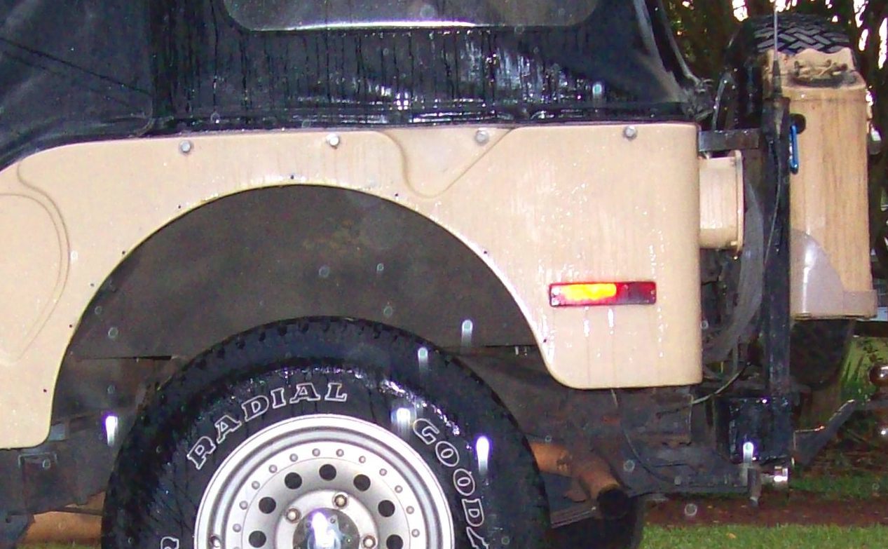

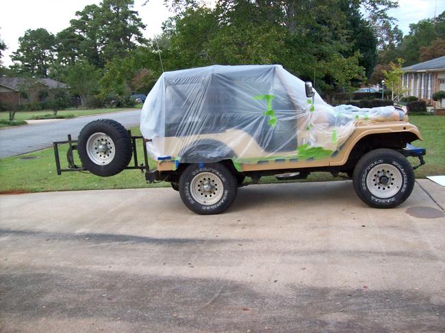

I SORTA PLEDGED THAT I WOULD NOT CLEAN MY WHEELS OR PAINT THE BLACK STUFF (BUMPERS, FRAME, ETC. W/ SPRAY CANS) TILL I GOT THE BODY STUFF PAINTED.
THEN I GOTTA GET THE LOCAL SIGN GUY TO MAKE ME TWO "RENEGADEs" (SOLID BLACK THIS TIME) FOR MR. HOOD. THE LAST SET I HAD MADE HAD THE "CREAM COLOR" IN THE MIDDLE AND WAS OUTLINED WITH A 3/8 BORDER OF BLACK AROUND EACH LETTER.
LOOKED GOOD IN THE BEGINNING, THEN THE INNER COLOR FADED TO ALMOST WHITE, AND THE BORDER STARTED PEELING UP IN PLACES.
SO, THIS TIME IT'S GONNA BE ONE PIECE LETTERS, BUT IN THE SAME FONT AND SIZE AS BEFORE.

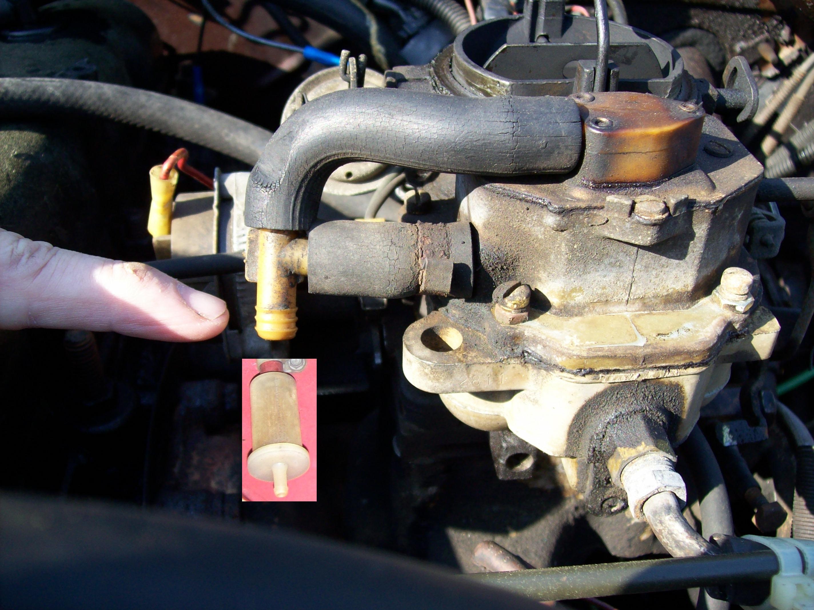

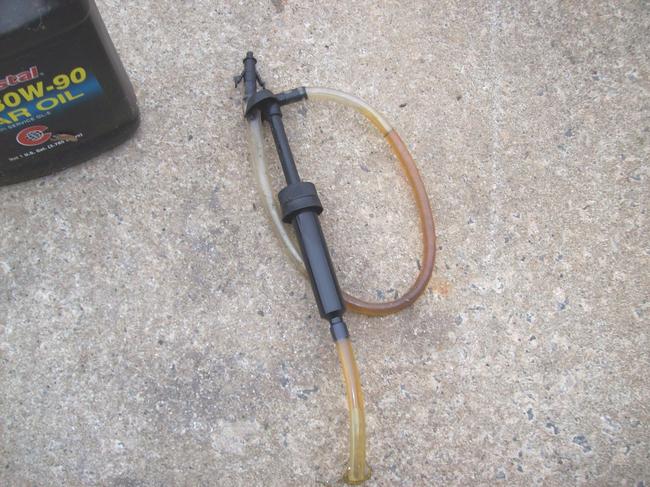

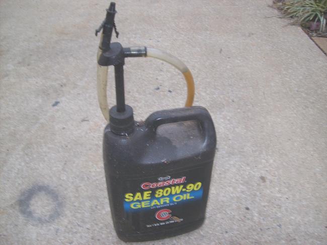

I'LL SHOW YOU SOME OTHER PLACES THAT LUBING WOULD DO IT SOME GOOD (GOTTA FIND THE DARN PICS!)

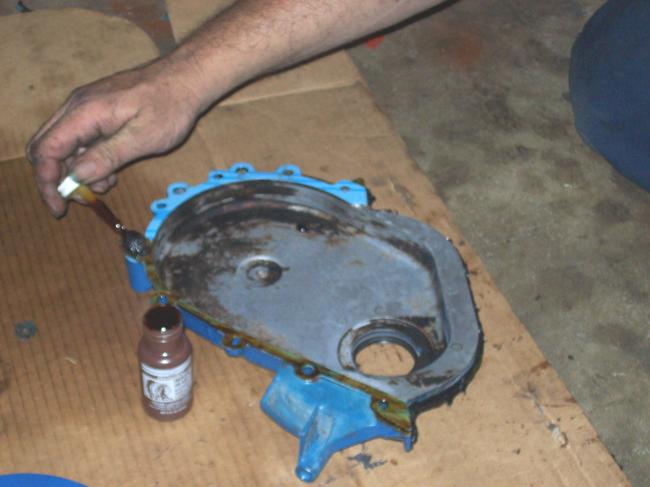

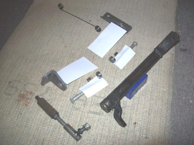

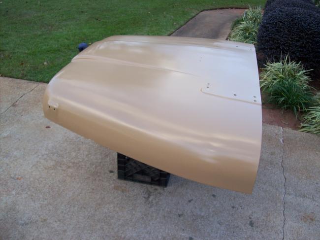

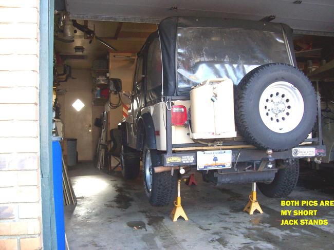

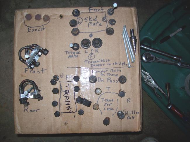

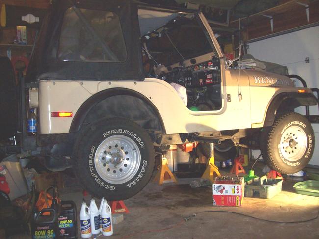

LAST PIC, ALL FASTENERS GO BACK INTO THE SAME EXACT LOCATION AS THEY WERE. I POKE HOLES AND USE NAILS TO HOLD STUFF IN PLACE. ANY PATTERN IS DRAWN AND LABELD.
I DO THE "BOX THING" WITH ANY REPAIR I DO. NO LAYING BOLTS HERE AND THERE ON A FENDER/ ON THE ENGINE. WHEN I GET DONE, THE BOX IS EMPTY AND EVERYTHING HAD A HOME!

AS FAR AS CLEANING THE BOTTOM-DECENT, BORROW/ BUY 4 OF THEM REAL TALL JACK STANDS (I GOT MOST OF MY STANDS REALLY CHEAP AT THE "ROVING TOOL SALE", THAT SHOW UP AT THE FARMERS MARKET EVERY YEAR.
WE STILL HAVE THE SAVE $$$ AT ADVANCE AUTO DEAL! SEE IF THEY HAVE TALL STANDS (LOOK ONLINE-THEN USE THE TECHNIQUE BELOW)

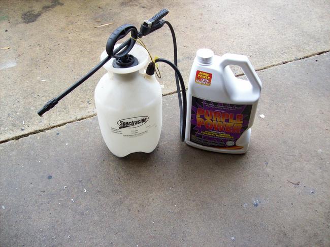

PURPLE POWER IS THE STUFF! A PRESSURE WASHER MIGHT GET MOST OF IT.

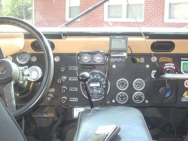

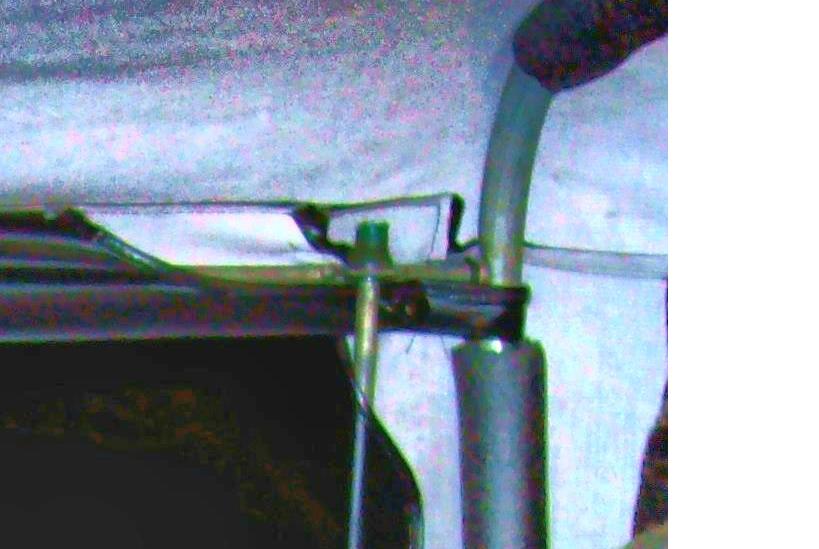

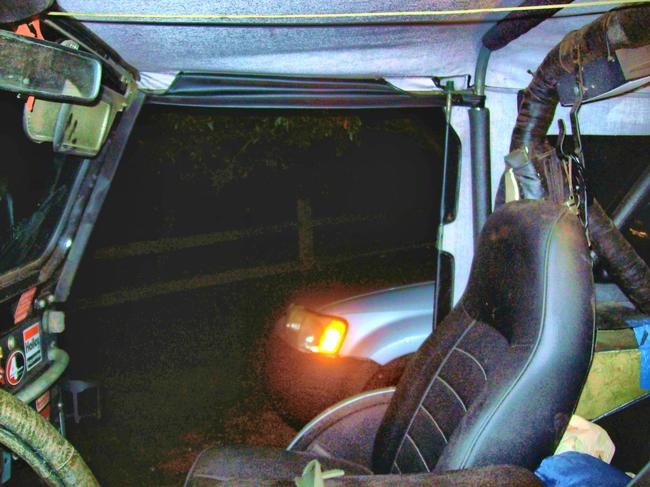

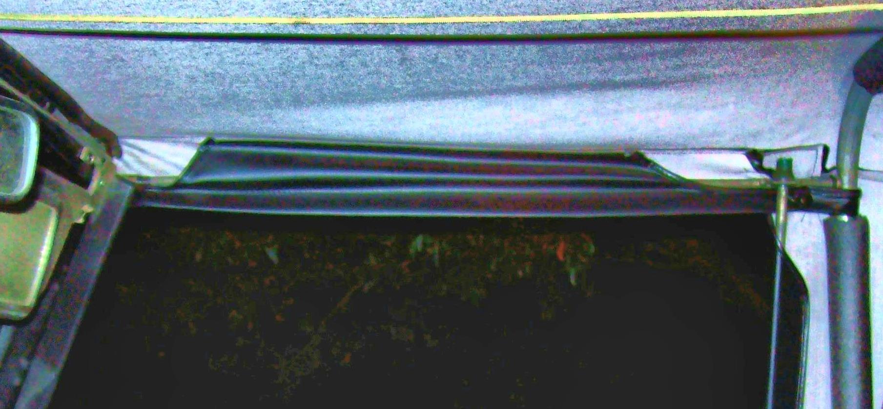

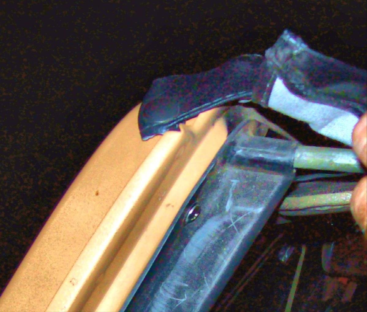

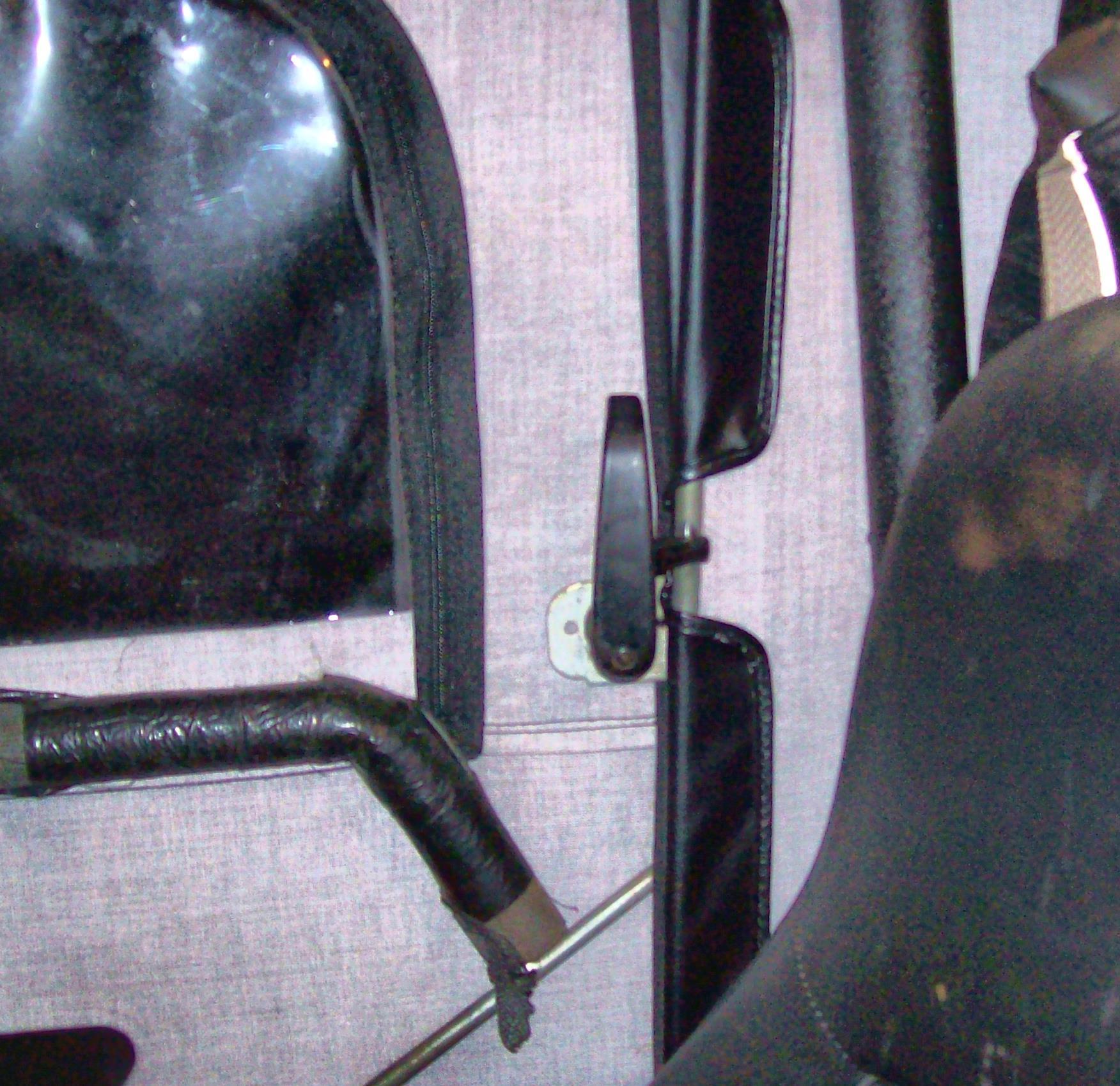

PIC 1) NIGHT PICS, HER RIGS REFLECTOR IS BEAMING W/ THE FLASH!
WE HAVE THE ORIGINAL HARDWARE, 2 BOWS (BY THEMSELVES)
AND 2 RODS FOR ONE SIDE, THEY ARE DIFFERENT, BUT "MIRROR" THE OTHER SIDE (SEPARATE PARTS, WHEN NOT IN USE, BASICALLY, I HAVE 4 METAL STICKS TO STORE, USUALLY BEHIND THE BACK SEAT!
PIC 2) TOP ROD, EXTENDS FROM PLASTIC DOOR STOP (HOLE AT TOP OF IT) (DOOR STOP SEALS DOOR TO WINDSHIELD, CUTS OUT WIND)....EXTENDS TO HOLE IN TOP BOW. THE VERTICAL ROD MUST BE INSERTED AND SHOVED INTO PLASTIC HOLDER OF TOP ROD, AND CONNECTED TO THE TUB, BEFORE THE HORIZONTAL TOP ROD CAN HOOK INTO THE TOP BOW HOLE. OTHERWISE YOU CANNOT GET ANY SLACK TO INSERT THE VERTICAL ROD.
THE TOP, ITSELF, HAS A FLAP LIKE/ SORTA LIKE A STRAP, THAT GOES AROUND THE TOP BOW, THEN DOUBLES BACK FORWARD AND SNAPS ONTO ITSELF. THIS HOLDS THE BOW FROM FALLING REARWARD AND KEEPS THE RODS FIRMLY IN PLACE
PIC 3) THIS IS THE DRIVER'S SIDE ROD HOLE ON THE DOOR STOP
PIC 4) THE RODS AND TOP BOW

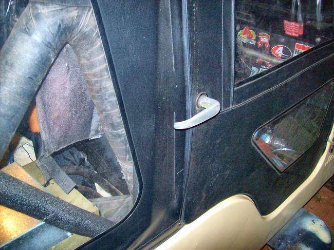

PIC 5) THIS IS THE ORIGINAL "TRADITIONAL" PLASTIC DOOR HANDLE.
SOME AFTERMARKET DOORS USE A PADDLE HANDLE WAY DOWN LOW ON THE DOOR. THAT TYPE IS A PAIN TO ADJUST, AND SOMETIMES DON'T FULLY CLOSE THE DOOR AT THE TOP. THE BIGGEST COMPLAINT I'VE SEEN ON THAT TYPE IS THAT THE TUB PORTION GETS IN THE WAY OF GETTING IN AND OUT, AND GETS BENT (THIS IS MOSTLY ON A CJ-5)
PIC 6) THE OUTSIDE OF THE "TRADITIONAL" DOOR HANDLE (WHICH IS ABOUT HALFWAY UP THE VERTICAL ROD) ORIGINALLY, THE HANDLE "TIP" WAS MEANT TO BE FACING FORWARD. AS MOST SEASONED JEEP FELLERS FOUND OUT, IT BECAME A HOOK (LIKE A U.S.MAIL RETRIEVAL HOOK ON AN OLD STEAM ENGINE TRAIN) THE HANDLE WOULD "ALWAYS" REACH OUT AND GRAB A BIG OLE VINE, A SAPLING, OR A TREE LIMB, IT DIDN'T EVEN HAVE TO BE A "GOOD" ONE, THE STUFF WOULD SORTA RAKE THRU, THEN "GRAB" AND BUST THE HANDLE OFF! TOOK ME TWO HANDLES TO SMARTEN UP!
THE HANDLE IS TWO PIECES, THAT SEPARATE WHEN THE SCREW IS REMOVED, BEINGS THAT IT "INDEXES" ON A HEXAGON IN THE CENTER PORTION, YOU CAN ROTATE THE OUTSIDE HANDLE 180 DEGREES, (IN ALL ACTUALITY, ANY OF SIX POSITIONS-THE OTHER 4 WOULD LOOK STUPID!) NOW ALL YOU GOTTA DO IS "WATCH FOR" THE SNAGS WHEN YOU ARE BACKING UP!

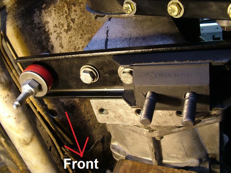

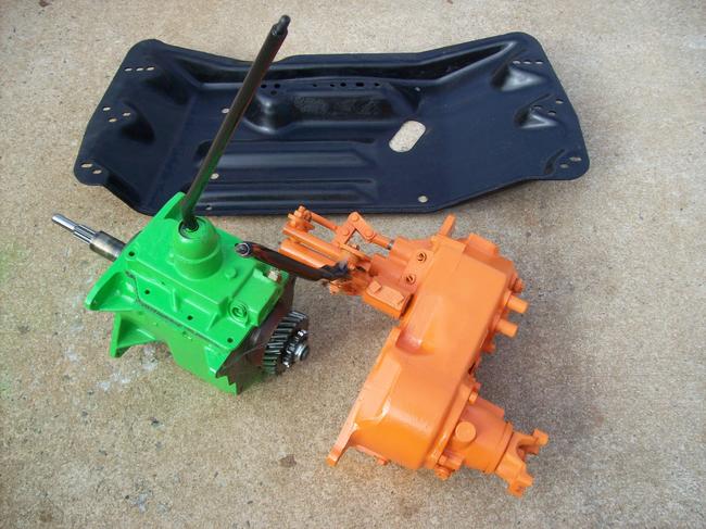

I HAVE SEVERAL PICS IN THE BEGINNING OF THE TORQUE ARM INFO
PIC

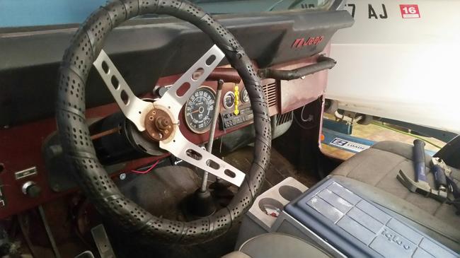

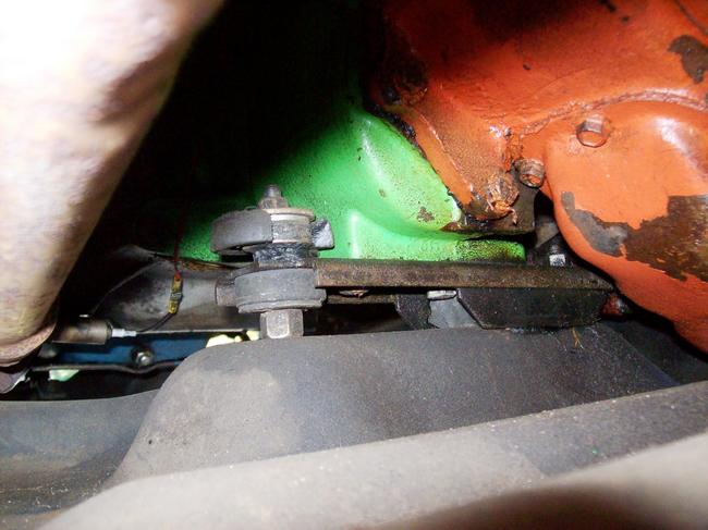

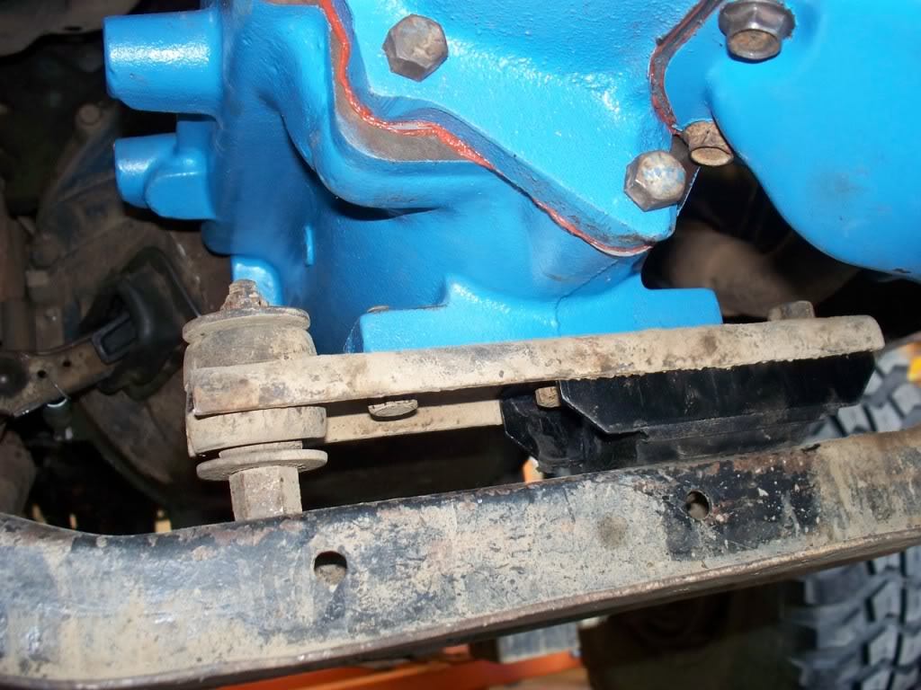

1) MINE/ HARD TO SEE IT WITH THE SKID PLATE ON (NOTE: MY RUBBER DEALEE IS RIPPED UPWARD/ WHAT'S LEFT IS STILL A CUSHION! WILL FIX IT SOON
NOTICE THE TRANSMISSION MOUNT IS NOT CENTERED ON THE TRANNY, IT IS INTENTIONALLY SHIFTED TOWARDS THE PASSENGER SIDE

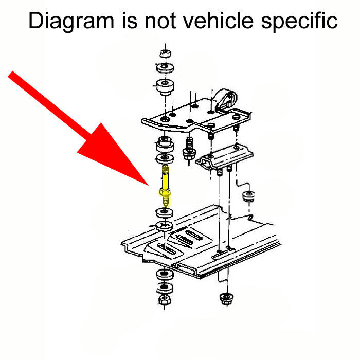

2) THIS IS A "TYPICAL" DIAGRAM, THE RUBBER STUFF AT THE BOTTOM OF THE STUD IS UNNECESSARY, THE STUD IS NORMALLY BOLTED DOWN HARD TO THE SKID PLATE

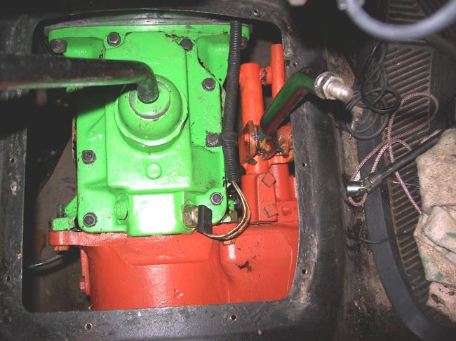

3/ 4) I FOUND THESE ON THE NET, BETTER PICS, (SEE THE TRANNY MOUNT?)
FROM WHAT YOU SAY ABOUT THE GEAR SHIFT STICK SMACKING THE PLATE IN THE FLOOR. GUESSING YOU HAVE A DENT FOR "FORWARD" AND AN OPPOSITE ONE FOR "REVERSE".
WITHOUT EYES ON IT, YOUR MOTOR MOUNTS/ TRANNY MOUNT/ AND TORQUE ARM STUFF MAY ALL NEED REPLACING, SEE IF YOUR TRANNY MOUNT IS "OFFSET" AND IF YOUR TORQUE ARM AND COMPONENTS EVEN EXIST!
PREVIOUS OWNERS MAY HAVE TOOK STUFF OUT.
BAD!
BAD!
PREVIOUS OWNERS!
WHEN THE RUBBER STUFF GETS OLD, IT WILL ALLOW MOVEMENT THAT SHOULDN'T BE!
YES, THE STICK TORQUES A LITTLE WHEN THE DRIVE TRAIN MOVES, BUT IT SHOULD BE SLIGHT. WITHOUT GETTING REAL TECHNICAL, I'D SAY MINE MAY MOVE AN INCH OR SO. IT SHOULD NOT JERK YOUR ARM TO THE OTHER SIDE OF THE JEEP!

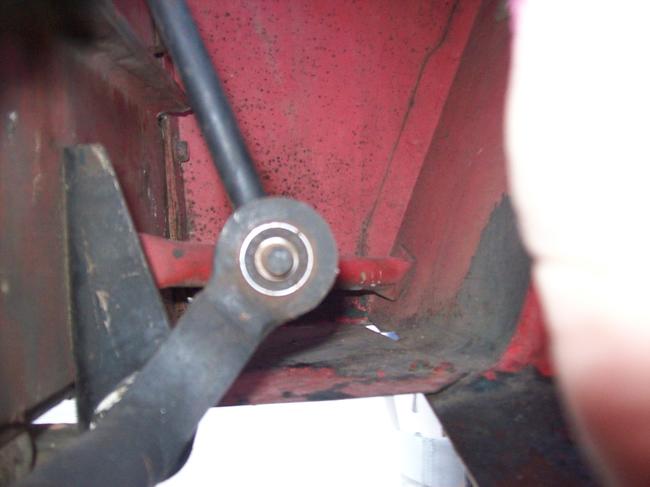

BAD!
BAD!
PREVIOUS OWNERS!

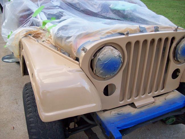

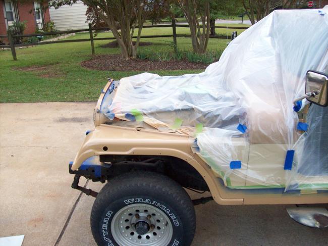

DRIVEWAY 1/2 PAINT JOB
PRETTY MUCH MR. TUB AND THE LIGHT COLOR ON THE FENDER ON MR. JEEP WAS PAINTED LAST YEAR, BEFORE THE COLD SET IN.
THIS TIME/ IN THE NICK OF TIME/ I GOT HIM ALL THE WAY DONE, LESS THE NEW BLACK "RENEGADE" DECALS ON MY HOOD (WILL HAVE THEM IN A WEEK OR SO)
I ALSO PAINTED MY BLACK ACCESSORIES AND CLEANED MY RIMS! (WILL POST 100% DONE PICS SOON AS I CAN)
DON'T IT LOOK A WHOLE BUNCH BETTER THAT IT DID BEFORE?
THE MEDIC
