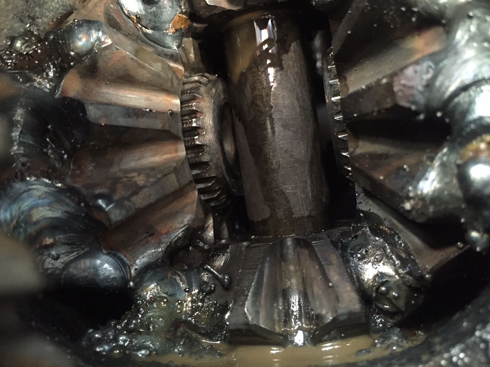

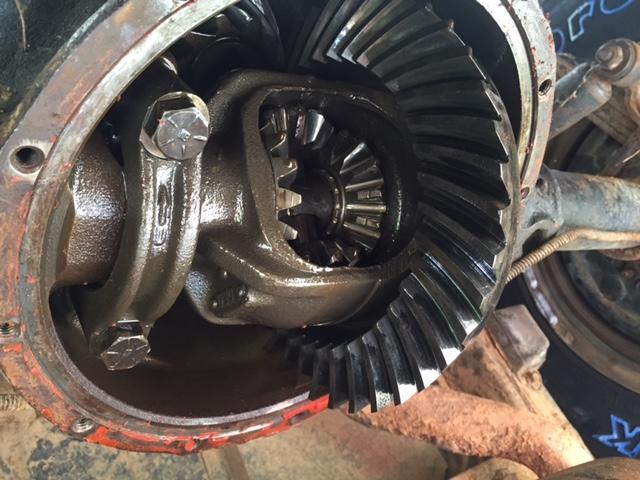

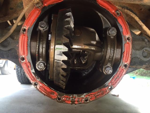

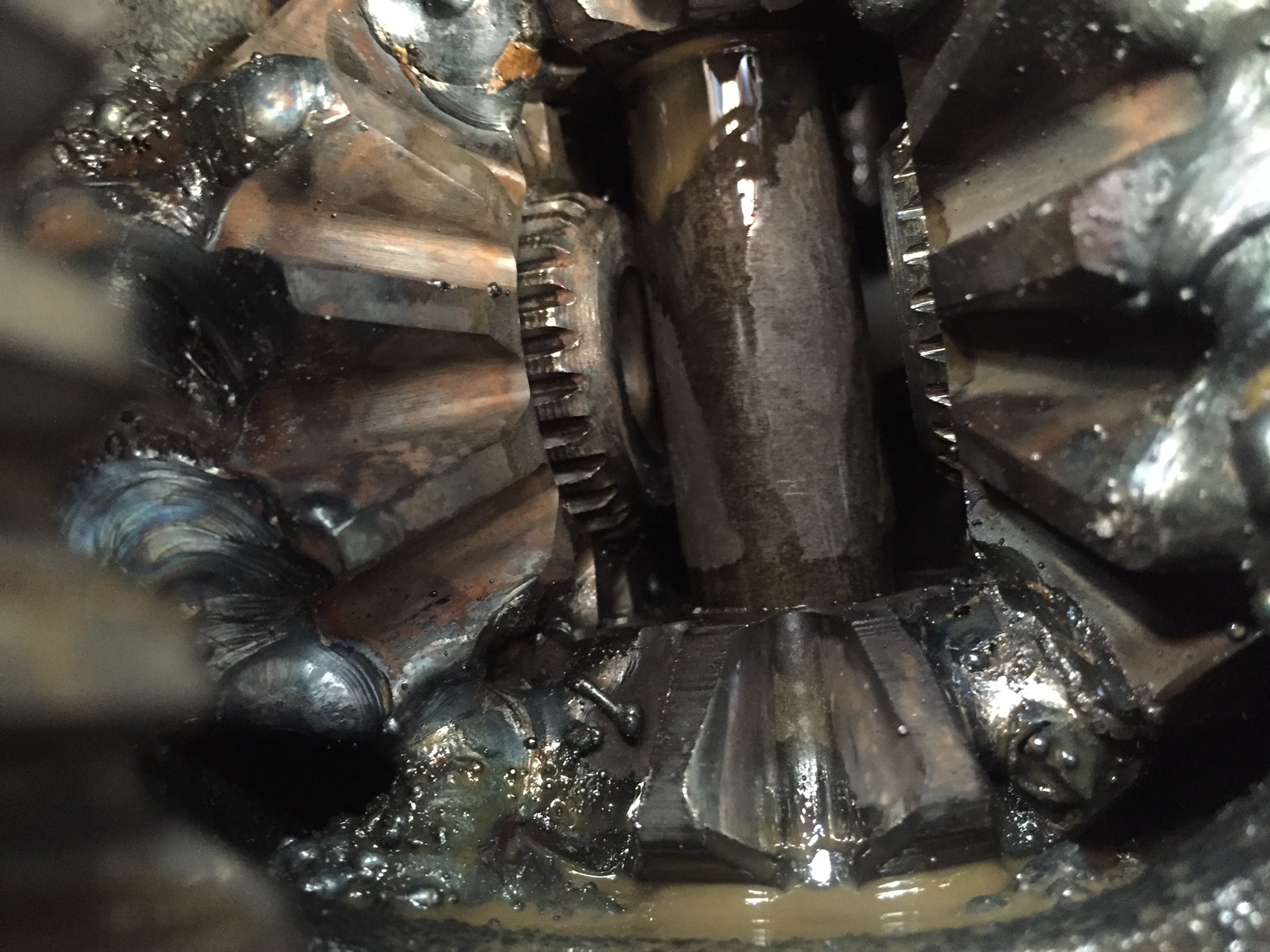

Well I pulled the Diff covers and the rear looked phenomenal! The oil may have had a lil water in it considering it was slightly chocolate like. I included a picture of them which is picture 1 AND 2. I found not metal shaving and everything looked great! Whew what a relief.

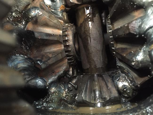

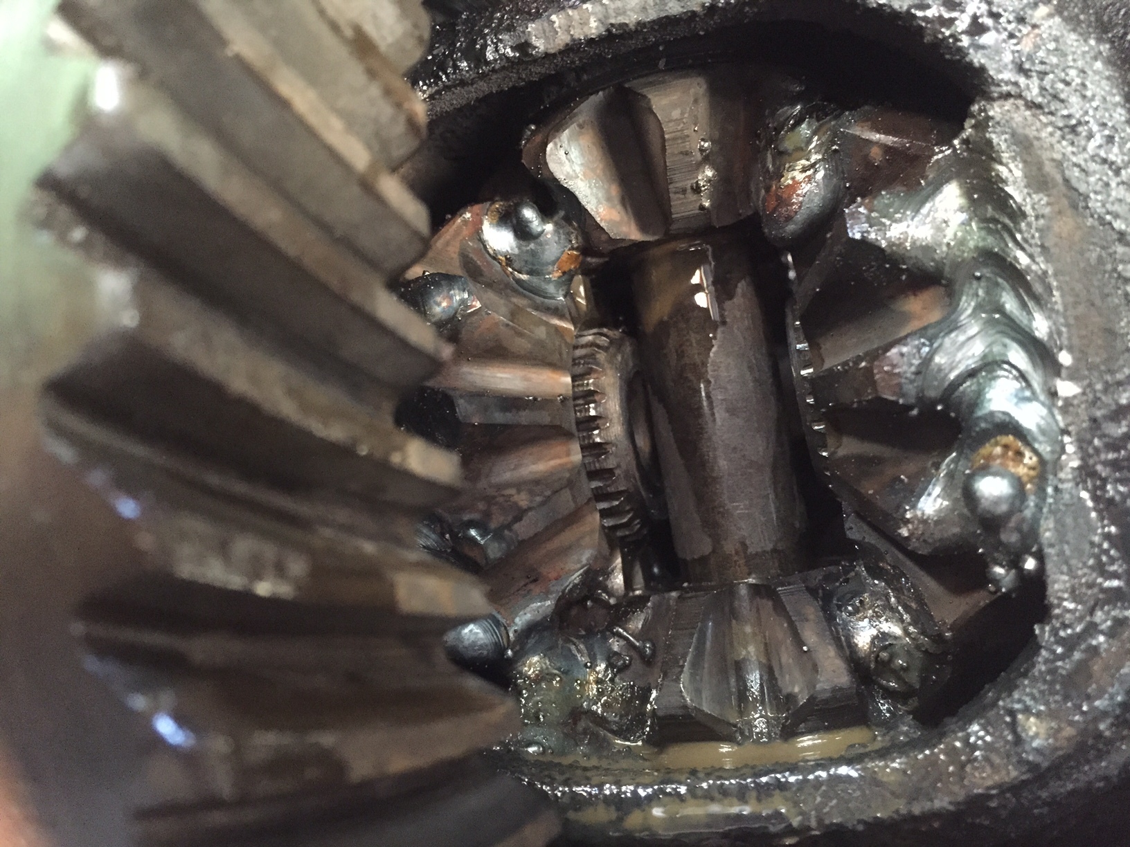

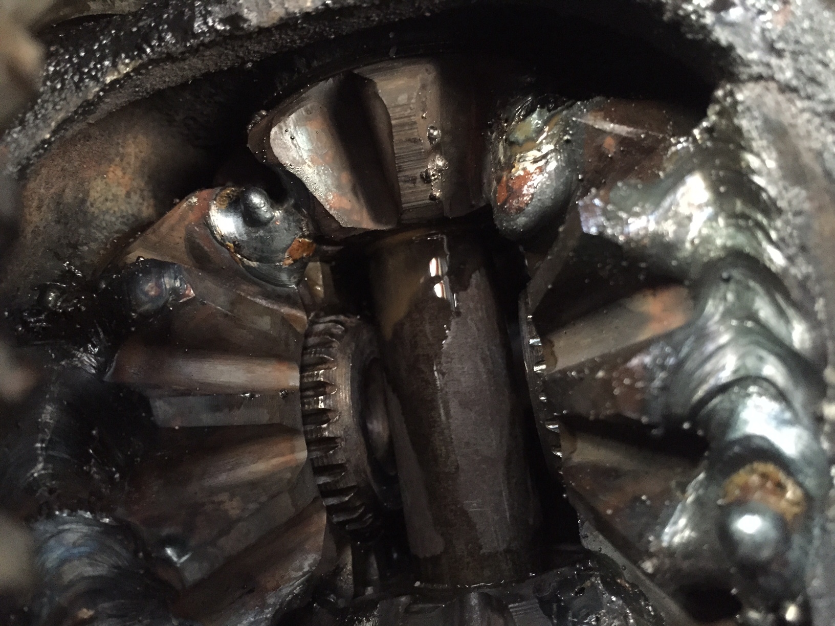

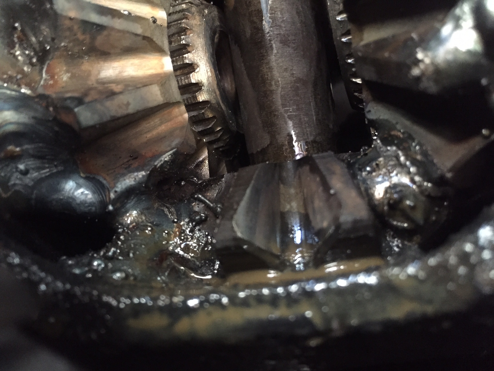

THEN THE HARDCORE JEEPER PREVIOUS OWNER STRUCK AGAIN. REFER TO ALL PICTURES BEYOND PICTURE 2!
So as you can tell they welded the front spider gears. Glad I didnt try the 4X4 trick to teach her to drive. Which as long as we are not on asphalt or hard surface we should be fine correct? There was some shavings in the front. You may be able to tell from the picture where it is grinding but, it looked like the top spider gear was wore down a bit. Now singe they are welded if we decided to go out in the snow, would that be ok? What is the limits I can do with this until we decided to replace the gears (remember we are not mudders or rock crawlers, so it should have a pretty easy life from here on out)?
I did put the covers back on and did find there respective gaskets today. I slightly tightened the bolts to allow the lil amount of RTV to set up. I also did that because what is the special additive I should add if not Lucas or something like that. The people at Oreilly and Advance pushed lucas on me for the additive. I did see a 85w-90 limited slip gear oil but it was synthetic and figured that would not work as well.
Well that is basically the latest. I did not attempt the transfer case because we got a late start.
OH GREAT NEWS! Apparently the hardcore jeepers replaced the TORX bolts with hex bolts! Well I guess they did do me one favor! Or really they did themselves a favor probably after there river expeditions.

LET'S MAKE SURE YOU KNOW WHAT YOU HAVE UP FRONT
AS LONG AS YOUR HUBS ARE UNLOCKED, EVERYTHING SHOULD BE FINE AND NORMAL, EVEN IN 4WL, YOU WILL HAVE THE "TEACHING" REDUCTION, AS LONG AS YOUR HUBS ARE UNLOCKED!
WHEN YOU DO LOCK IN THE HUBS, YOU WILL HAVE "FULL TIME POSITIVE TRACTION" (ONLY ON THE FRONT)
THIS IS NOT NOT NOT NOT LIMITED SLIP!
THIS IS EXACTLY HOW DIRT TRACK RACE CARS CHEAPLY MAKE THE REAR ENDS FULL POSITIVE TRACTION (KEY WORD HERE IS "DIRT")
"LIMITED SLIP" MEANS THAT "CLUTCH PACKS" OR OTHER MEANS WILL ALLOW THE VEHICLE TO MOVE FORWARD WITH BOTH WHEELS GETTING TRACTION ALL OF THE TIME,
SHOULD ONE FALL IN A MUD PUDDLE (ETC) THE OTHER WILL CONTINUE TO PULL
THE TRICK HERE, WITH "LIMITED SLIP" IS THAT THE CLUTCH PACKS WILL LET ONE WHEEL OR THE OTHER "ROLL" THE LONGER DISTANCE IN A TURN (JUST LIKE A STANDARD DIFF WILL DO). A "FRICTION MODIFIER ADDITIVE" IS NEEDED TO KEEP THOSE CLUTCH PACKS LUBRICATED
YOU DON'T HAVE CLUTCH PACKS!
DON'T ADD THE ADDITIVES, LUCAS WILL THICKEN THE OIL AND IT MAY NOT BE ABLE TO SLING WHERE IT'S NEEDED
YOU ARE GONNA HAVE TO BE CAREFUL IN 4WD!
YOUR FRONT WHEELS (ONE OR THE OTHER) IS GONNA "DRAG" DURING A LEFT OR RIGHT TURNS. SOFTER SURFACES WILL ALLOW IT TO BE A BIT SMOOTHER.
THE WORST PART OF BEING IN 4X4, HUBS LOCKED IS GONNA BE TURNING HARD (MAYBE NOT SO HARD) AND THE WHEEL(S) HOPPING. A STOCK JEEP SORTA DOES THIS A LITTLE ANYWAY, IT IS FELT IN/ WITH THE STEERING WHEEL WANTING TO MOVE CW AND CCW (MAYBE A 1/4 TURN) VERY RAPIDLY.
YOURS "MIGHT" JERK THE WHEEL A LOT MORE!
YOURS ON HARD SURFACES IN 4X4 (WHICH IS A NO NO!), MIGHT TRY TO SORTA "MAKE A TURN DIFFICULT TO PERFORM", AS YOU WILL BE DRAGGING ONE OF THE FRONT WHEELS. IN OTHER WORDS, "PLAYING CHICKEN" MIGHT BE A BAD IDEA! NOT HAVING REALLY DEALT WITH THIS KINDA ISSUE (ESPECIALLY ON THE STEERING AXLE) I WOULD NOT RULE OUT A POSSIBLE ROLLOVER, IF A WHEEL CAN'T SLIP ON THE GROUND!
IT'S YOUR JEEP, MAYBE IN THE FUTURE YOU CAN GET ANOTHER FRONT END, WITH THE SAME GEAR RATIO AS AS THE REAR, AND THIS WON'T BE A POSSIBLE PROBLEM

YOU DO NOT HAVE LIMITED SLIP!
YOU HAVE A "NEVER CAN SLIP AT ALL" FRONT END
YOU SAID THE REAR WHEELS MOVED IN OPPOSING DIRECTIONS (STANDARD DIFF)

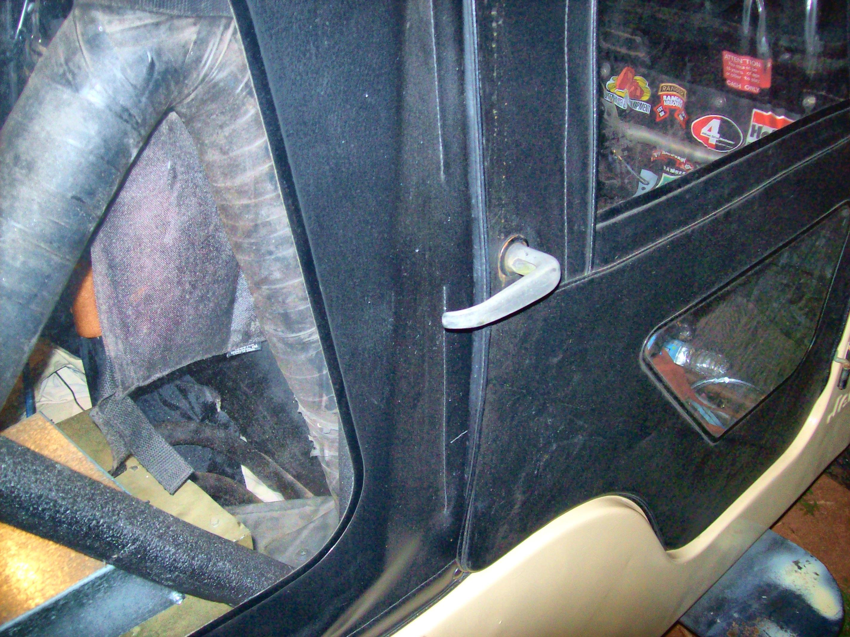

DO YOU HAVE SOFT TOP HARDWARE (BOWS AND SUCH, DOOR FRAMES)?
WOULD LIKE A FEW PICS OF YOUR BABY, KINDA WANNA KNOW WHATS IN MY GARAGE!

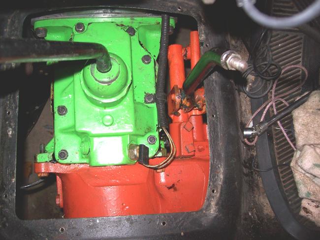

I did today attempt to work on the transfer but wasted several hours of time because I tried to remove the plate not know it was holding up the transmission. I figured it would have been mounted by something else. You should have saw my face when I began to lower the plate with the jack! I figured that would be an issue in the woods if you was to run that plate into something. Well not to much up with me as you see so fill me in on your recent activities.

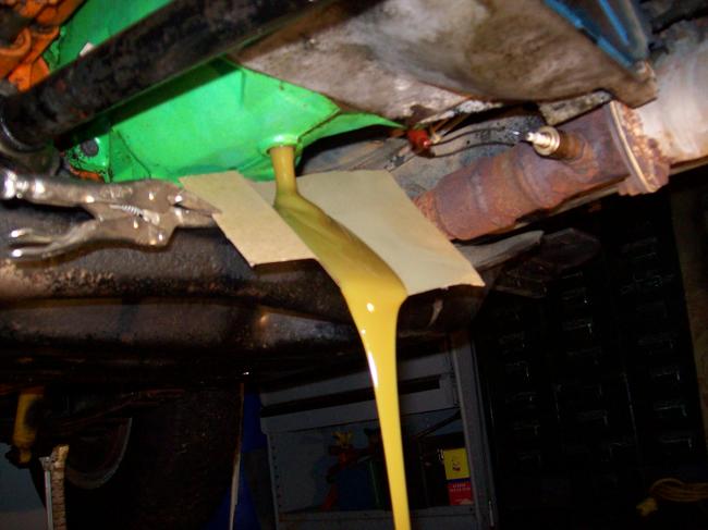

UNLESS YOU GOTTA PUT ON SOME GASKETS OR SEALS, THE DRAINS TO THE TRANNY AND TRANSFER CASE ARE ACCESSIBLE FROM THE FRONT OF THE SKID PLATE AND THRU A HOLE IN THE SKID PLATE. (NO NEED TO DROP THE SKID PLATE)

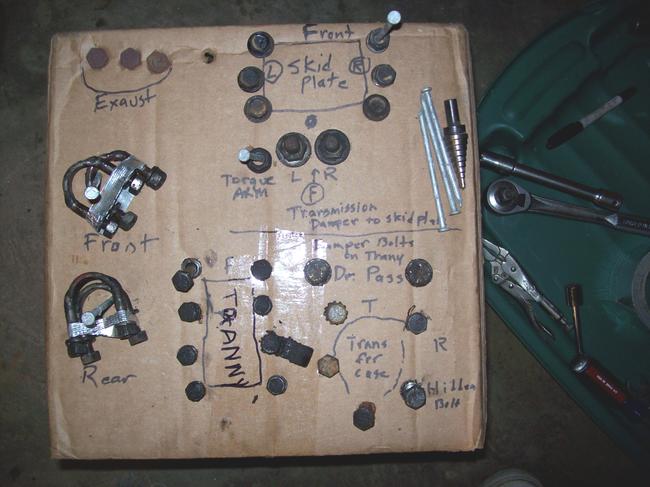

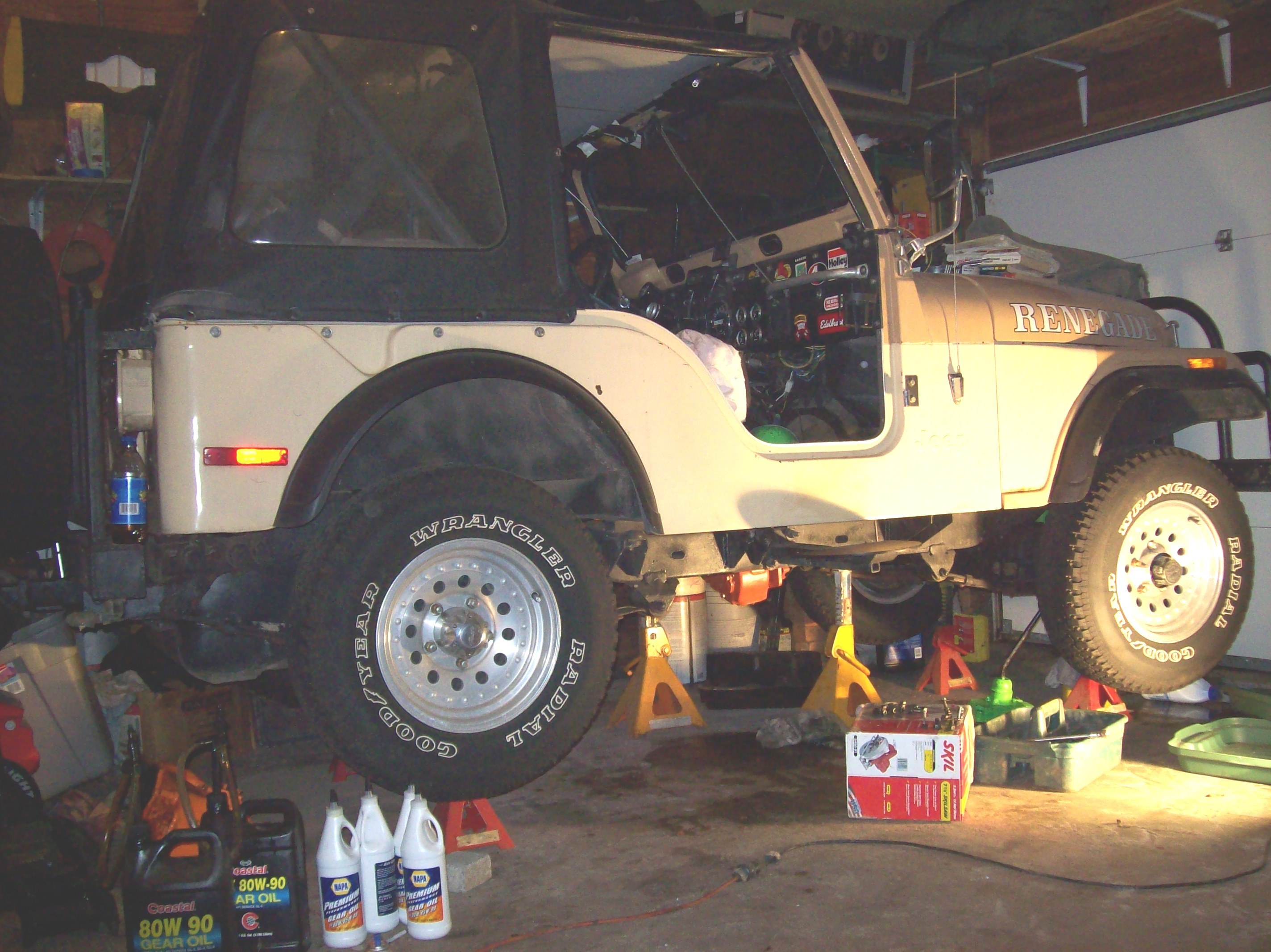

LAST PIC, ALL FASTENERS GO BACK INTO THE SAME EXACT LOCATION AS THEY WERE. I POKE HOLES AND USE NAILS TO HOLD STUFF IN PLACE. ANY PATTERN IS DRAWN AND LABELD.
I DO THE "BOX THING" WITH ANY REPAIR I DO. NO LAYING BOLTS HERE AND THERE ON A FENDER/ ON THE ENGINE. WHEN I GET DONE, THE BOX IS EMPTY AND EVERYTHING HAD A HOME!

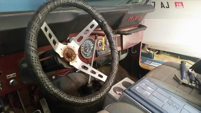

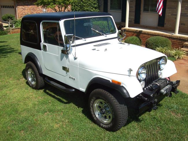

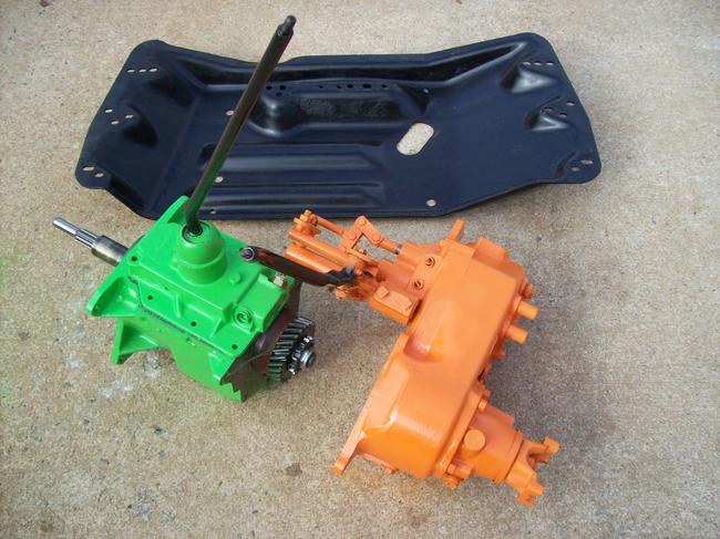

Well two weeks ago the transfer case was leaking out the front where the shaft connects. I did not see any leaks tonight but going to inspect after it sits all night. When it leaked last time, it did so for about an hour then stopped. We drove it tonight to go to my birthday dinner and didnt seem to have any problems but will check in the morning as I said.

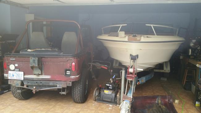

I went ahead and got you one picture so you can see a overall view instead of the parts. I will try to get you some more tomorrow.

CJ MEDEVAC
  • 11,005 POSTS
WHAT?
NO BUMPER?
LOOKS GOOD!
I'M SURE IT'LL IMPROVE OVER A LITTLE TIME, THE BOAT CAN WAIT!
GOT DOORS OR FRAMES? I HAVE MY OLD TOP THAT NEEDS A BOAT UPHOLSTERER TO REPLACE THE WINDOWS (OR AT LEAST THE SPLIT ONES) BETTER'N NUTHIN'!

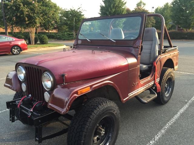

We have the bumper remember in my earlier posts I took it off sanded it down and repainted it. I will send you a picture of it later. I have not put it back on yet because I have been working on the frame as you can tell by the front. I am working on the frame from front to back. I am going to put on my tyvek suit one day and climb under there and purple power the bottom of that thing so I can get all that mud out of there. I have been tempted to take to it to a carwash that does underbody wash and just do that and roll out of it.
I think we decided that we are doing the underneath all in satin black. The body in a close shade of burgandy and the accents in chrome. Chrome will stay on the body and up. Rims, steps, bumper will stay black.
You was talking vinyls. I have a really good guy up here that does vinyls. The truck with vinyls is that they all shrink over time if they are die cut. The vinyl that usually holds up better to sun abuse and shrinkage is metallic color vinyls. If you can stand a vinyl that is glittery it will hold up longer. I know all about vinyls, I have bought enough of them in the past. Also it sounded like you got a printed vinyl. If you do a plain color die cut vinyl it will hold up significantly longer. Downside it will only be one color. If you need any help with vinyls let me know, As a rule of thumb if you got a vinyl and it didnt withstand excellent condition a minimum of 2 years it was shabby material. Also as time goes on it shouldnt have peeled up like that either unless you have an unclean surface when applying. I have vinyls applied 6 years ago that look about the same as the day I bought them.

I WAS A-TALKIN' 'BOUT MR. PREVIOUS TOP OF MINE
IT'S IN PRETTY GOOD SHAPE- LESS A FEW SPLIT/ SUN DISCOLORED WINDOWS
MY QUESTION WAS, DO YOU HAVE HARDWARE AND DOOR FRAMES?

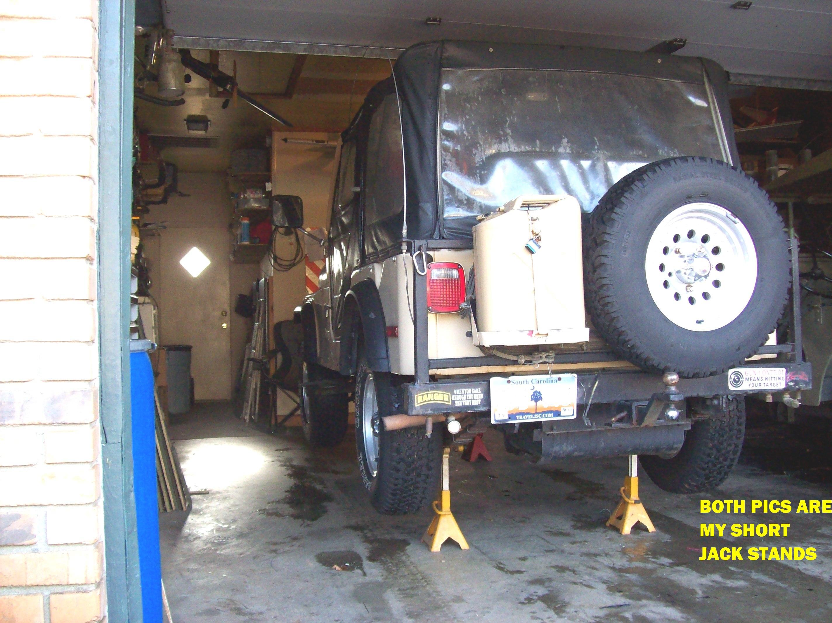

AS FAR AS CLEANING THE BOTTOM-DECENT, BORROW/ BUY 4 OF THEM REAL TALL JACK STANDS (I GOT MOST OF MY STANDS REALLY CHEAP AT THE "ROVING TOOL SALE", THAT SHOW UP AT THE FARMERS MARKET EVERY YEAR.
WE STILL HAVE THE SAVE $$$ AT ADVANCE AUTO DEAL! SEE IF THEY HAVE TALL STANDS (LOOK ONLINE-THEN USE THE TECHNIQUE BELOW)

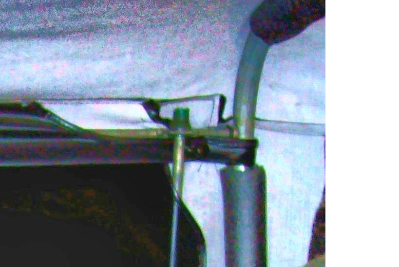

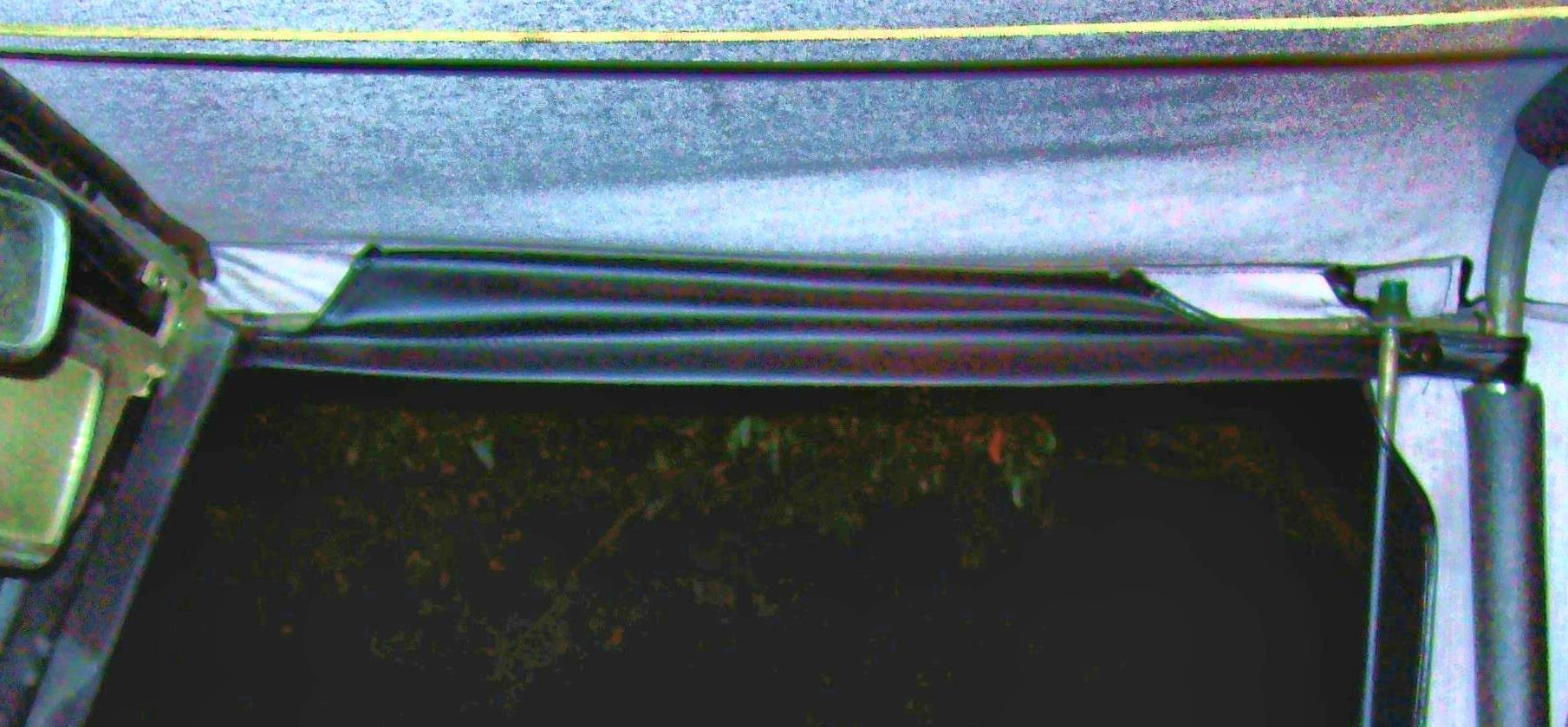

The jeep does have hardware and doors. But from looking at the top hardware it looks backwards and possibly bent. So we may have to take you up on buying yours.

SEND PIC OF YOUR "BENT" TOP PARTS

BOAT FOR SALE!
PIC ON PAGE 6
WALK THRU WINDSHIELD VERSION
WILL THROW IN TRANSPORT TRAILER WITH PURCHASE
WILL SACRIFICE SELF PROPELLED WALK BEHIND LAWN MOWER TO SWEETEN THE DEAL.
MUST MAKE ROOM FOR MAJOR JEEP RESTORATION!
(MAY TRADE FOR SMALLER WATERCRAFT, LIKE ONE SEEN BELOW)
BOAT, LIKE HORSE, HAS TWO BEST DAYS, THE DAY ACQUIRED, THE DAY WE SAID GOODBYE!

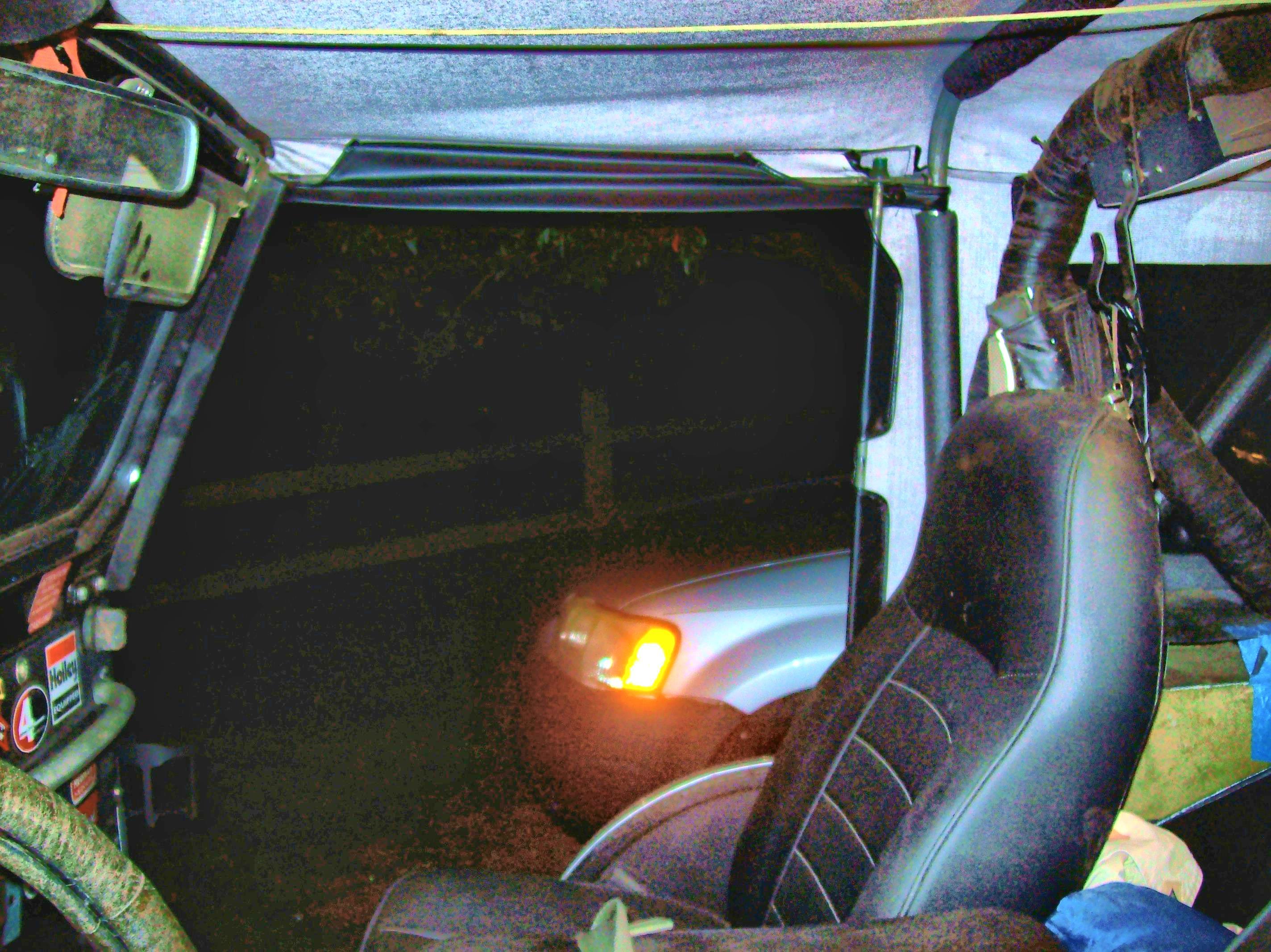

PIC 1) NIGHT PICS, HER RIGS REFLECTOR IS BEAMING W/ THE FLASH!
WE HAVE THE ORIGINAL HARDWARE, 2 BOWS (BY THEMSELVES)
AND 2 RODS FOR ONE SIDE, THEY ARE DIFFERENT, BUT "MIRROR" THE OTHER SIDE (SEPARATE PARTS, WHEN NOT IN USE, BASICALLY, I HAVE 4 METAL STICKS TO STORE, USUALLY BEHIND THE BACK SEAT!

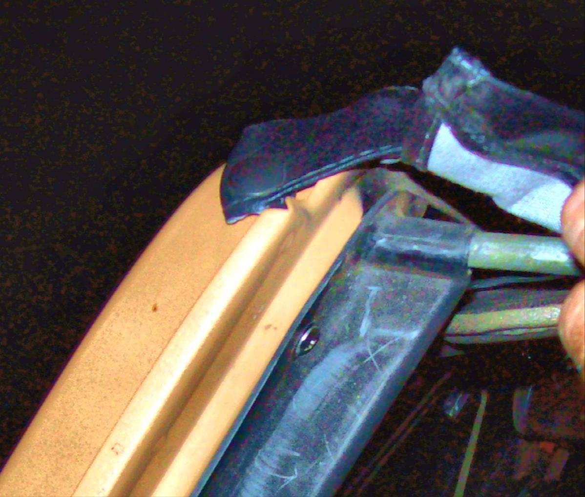

PIC 2) TOP ROD, EXTENDS FROM PLASTIC DOOR STOP (HOLE AT TOP OF IT) (DOOR STOP SEALS DOOR TO WINDSHIELD, CUTS OUT WIND). EXTENDS TO HOLE IN TOP BOW. THE VERTICAL ROD MUST BE INSERTED AND SHOVED INTO PLASTIC HOLDER OF TOP ROD, AND CONNECTED TO THE TUB, BEFORE THE HORIZONTAL TOP ROD CAN HOOK INTO THE TOP BOW HOLE. OTHERWISE YOU CANNOT GET ANY SLACK TO INSERT THE VERTICAL ROD.
THE TOP, ITSELF, HAS A FLAP LIKE/ SORTA LIKE A STRAP, THAT GOES AROUND THE TOP BOW, THEN DOUBLES BACK FORWARD AND SNAPS ONTO ITSELF. THIS HOLDS THE BOW FROM FALLING REARWARD AND KEEPS THE RODS FIRMLY IN PLACE

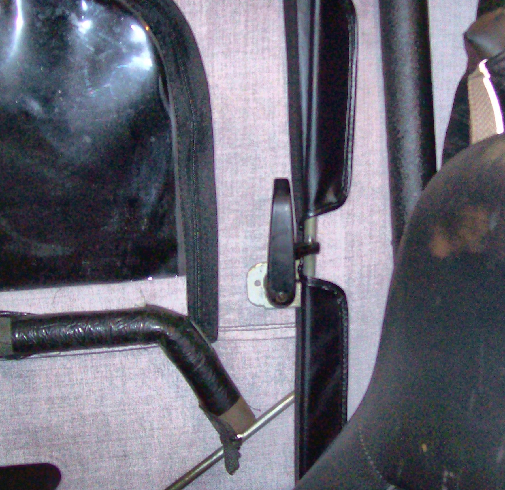

PIC 3) THIS IS THE DRIVER'S SIDE ROD HOLE ON THE DOOR STOP
PIC 4) THE RODS AND TOP BOW
PIC 5) THIS IS THE ORIGINAL "TRADITIONAL" PLASTIC DOOR HANDLE.
SOME AFTERMARKET DOORS USE A PADDLE HANDLE WAY DOWN LOW ON THE DOOR. THAT TYPE IS A PAIN TO ADJUST, AND SOMETIMES DON'T FULLY CLOSE THE DOOR AT THE TOP. THE BIGGEST COMPLAINT I'VE SEEN ON THAT TYPE IS THAT THE TUB PORTION GETS IN THE WAY OF GETTING IN AND OUT, AND GETS BENT (THIS IS MOSTLY ON A CJ-5)
PIC 6) THE OUTSIDE OF THE "TRADITIONAL" DOOR HANDLE (WHICH IS ABOUT HALFWAY UP THE VERTICAL ROD) ORIGINALLY, THE HANDLE "TIP" WAS MEANT TO BE FACING FORWARD. AS MOST SEASONED JEEP FELLERS FOUND OUT, IT BECAME A HOOK (LIKE A U.S. MAIL RETRIEVAL HOOK ON AN OLD STEAM ENGINE TRAIN) THE HANDLE WOULD "ALWAYS" REACH OUT AND GRAB A BIG OLE VINE, A SAPLING, OR A TREE LIMB, IT DIDN'T EVEN HAVE TO BE A "GOOD" ONE, THE STUFF WOULD SORTA RAKE THRU, THEN "GRAB" AND BUST THE HANDLE OFF! TOOK ME TWO HANDLES TO SMARTEN UP!
THE HANDLE IS TWO PIECES, THAT SEPARATE WHEN THE SCREW IS REMOVED, BEINGS THAT IT "INDEXES" ON A HEXAGON IN THE CENTER PORTION, YOU CAN ROTATE THE OUTSIDE HANDLE 180 DEGREES, (IN ALL ACTUALITY, ANY OF SIX POSITIONS-THE OTHER 4 WOULD LOOK STUPID!) NOW ALL YOU GOTTA DO IS "WATCH FOR" THE SNAGS WHEN YOU ARE BACKING UP!
