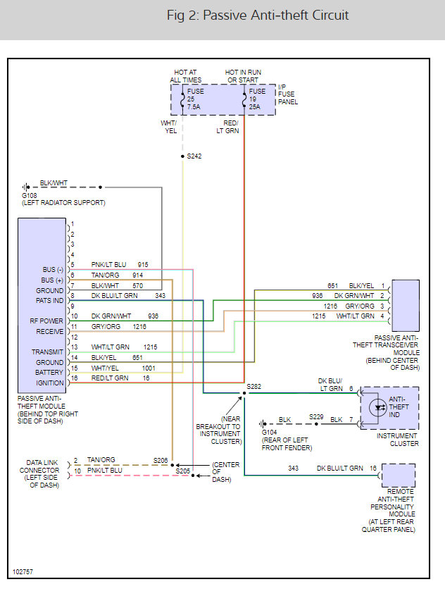

Engine will not start up and run?
198,000 MILES • 4.0L • V6 • 2WD • AUTOMATIC
7452EXPLORER
Changed fuel regulator, crank sensor, relays. turns over gets spark, gets fuel, just will not start. Checked trouble codes nothing comes up. Check engine light on and check gauges light on. please help.

7452EXPLORER
thanks for your suggestions but I seem to think that my problem lies with the ECU. My question now is if I replace the ECU what steps will I need to take to make sure that the key is going to work since it is a PATS key?

7452EXPLORER
If i get a used one from the salvage yard what steps need to be taken to make sure the key is going to work? Is there an instruction video or tutorial on doing this? I want to be sure how to correctly do this so i dont screw it up. Thank you very much.
Feb 21, 2018 at 3:21 PM
  • 55,732 POSTS
You should be fine because the PATS does only one function for the ECM. Here is a security system wiring diagram so you can see how the system works. (BELOW)
