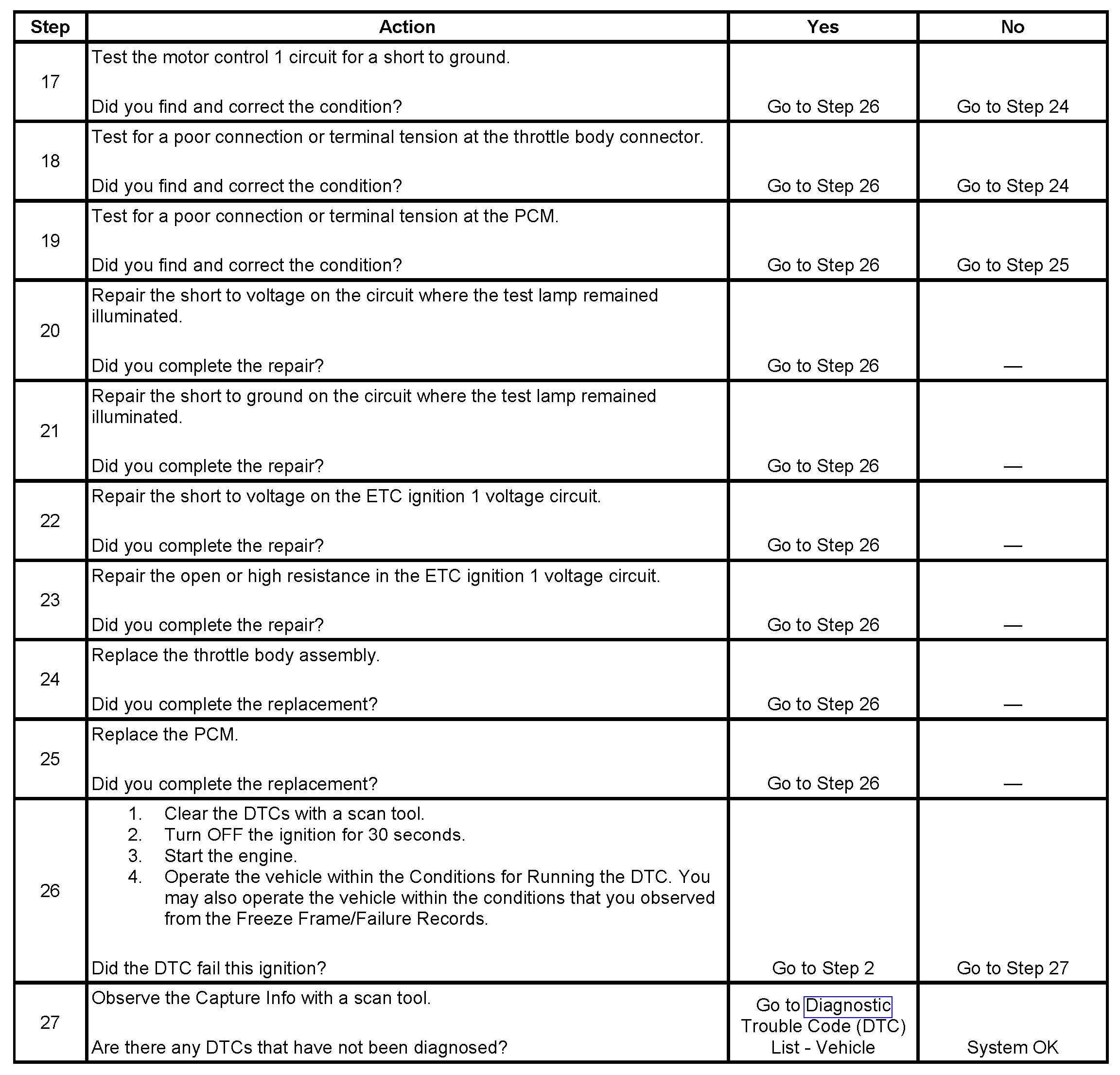

I listed all of the conditions for the codes you listed. The one thing I doubt you have done is the crank relearn, but the engine needs to be running properly to do it. I added it at the end.

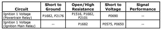

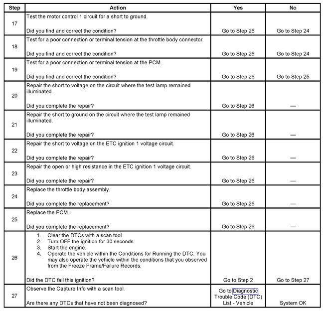

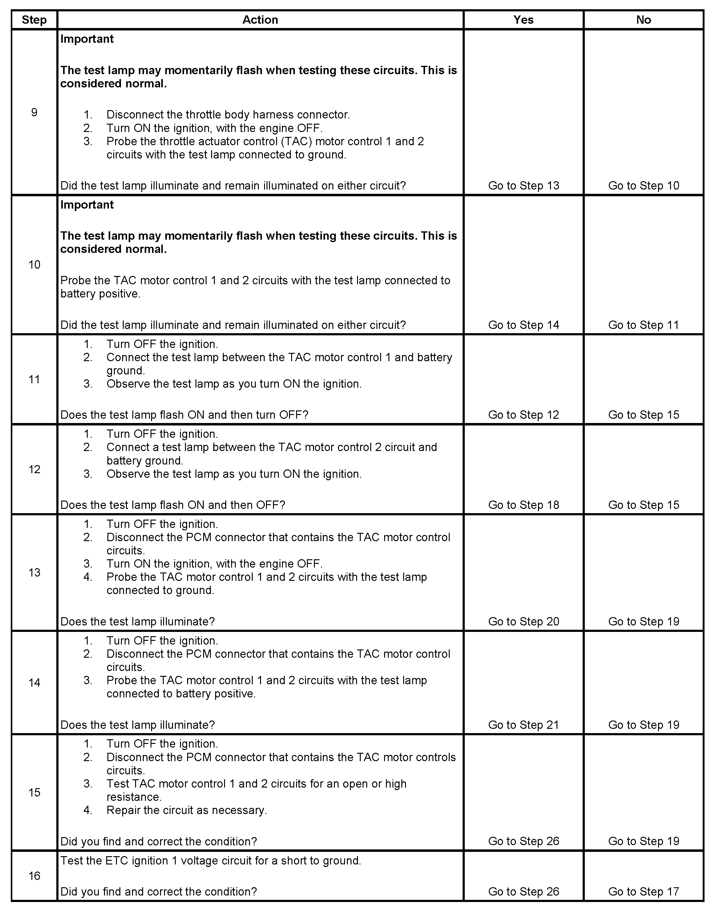

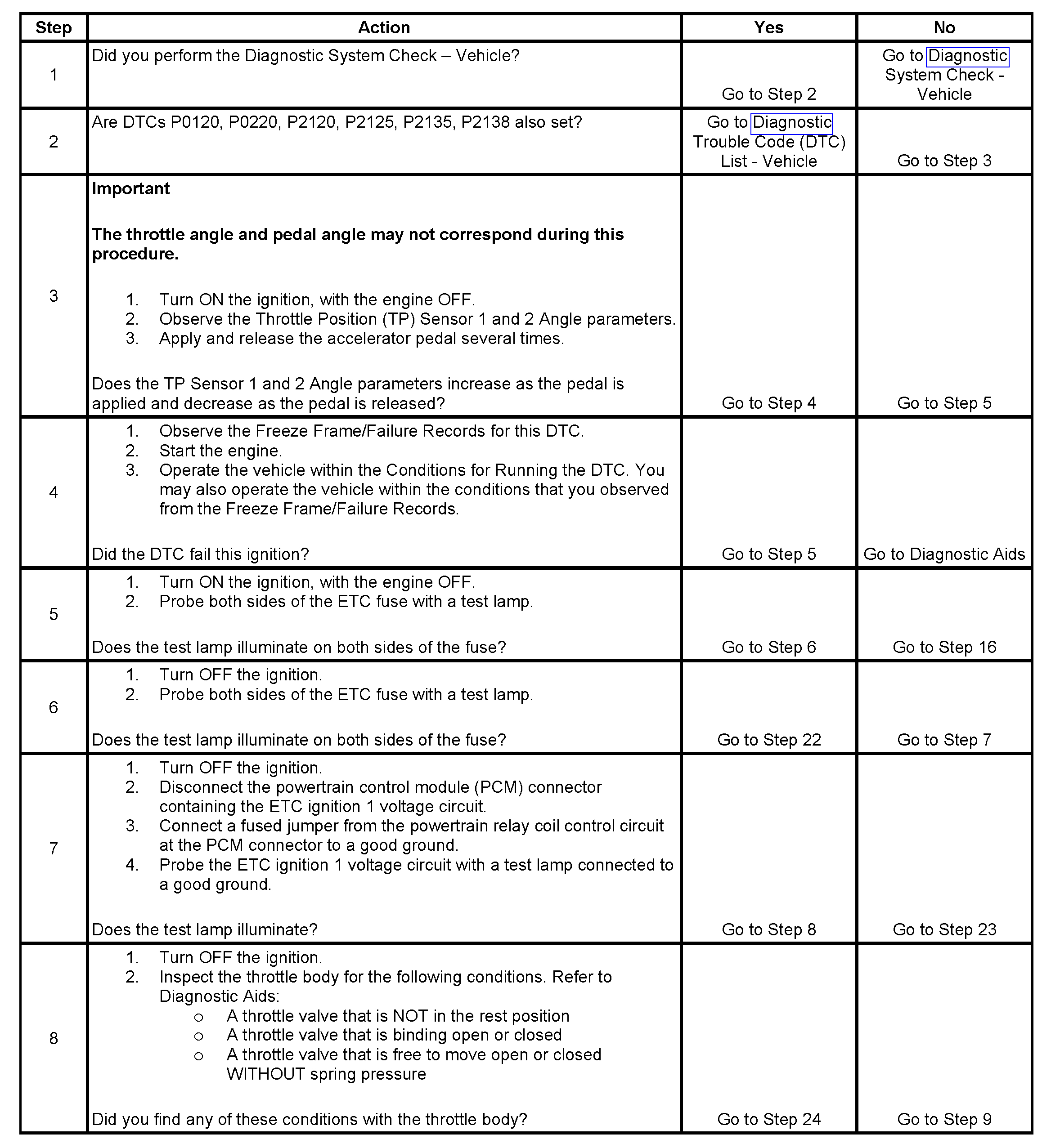

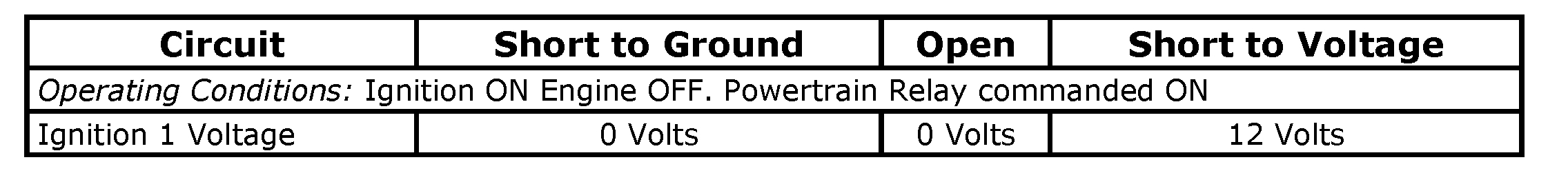

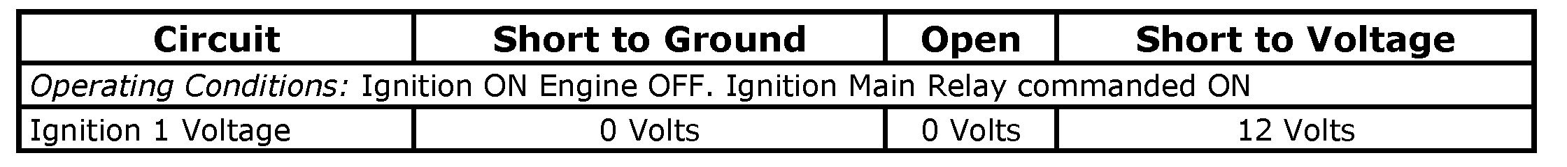

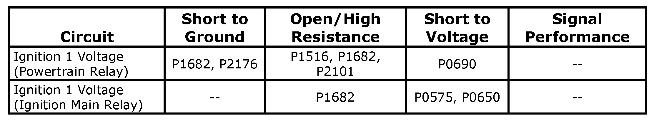

The majority of the things listed deal with the ignition 1 circuit. I'm not gong to lie when I say, I believe you checked all these things. Take a look.
DTC P0315 Crankshaft Position (CKP) System Variation Not Learned
DTC P1516 The commanded throttle position is compared to the actual throttle position based on accelerator pedal position (APP) and possibly other limiting factors. Both values should be within a calibrated range of each other. The powertrain control module (PCM) continuously monitors the commanded and actual throttle positions. This DTC sets if the values are greater than the calibrated range.
DTC 1682 There are two ignition 1 voltage circuits supplied to the engine control module (ECM). The first ignition 1 voltage circuit is provided by the powertrain relay through a fuse. This ignition 1 voltage circuit supplies power to all the internal ECM circuits associated with the throttle actuator control (TAC) operation. The ignition main relay provides the second ignition 1 voltage circuit to the ECM through a fuse. This ignition 1 voltage provides power to other internal ECM circuits, except those associated with TAC operation. The ECM continuously monitors the voltage level difference between the 2 circuits.

Here are the relearn procedures for the crank sensor, but the vehicle needs to be running properly for it to happen.
