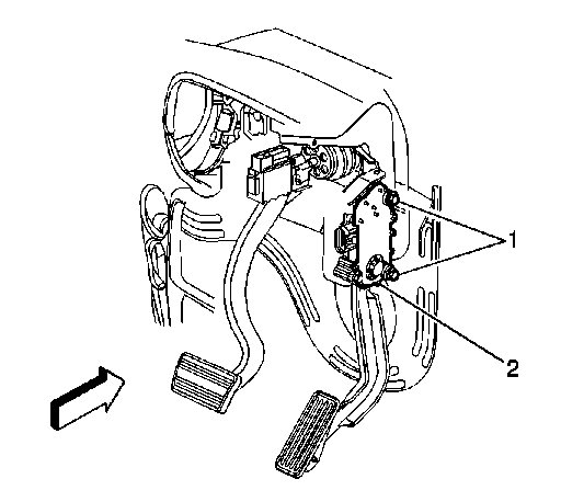

Have you checked the accelerator pedal position sensor? See pic 1. Also, have you checked the throttle position sensor?
The voltage you mention is correct. Here are descriptions of the two things I mentioned. Let me know if they have been replaced as well.

Accelerator Pedal Position (APP) Sensor
The APP sensor is mounted on the accelerator pedal assembly. The APP is actually 2 individual APP sensors within 1 housing. There are 2 separate signal, low reference, and 5-volt reference circuits. APP sensor 1 voltage increases as the accelerator pedal is depressed. APP sensor 2 voltage decreases as the accelerator pedal is depressed.

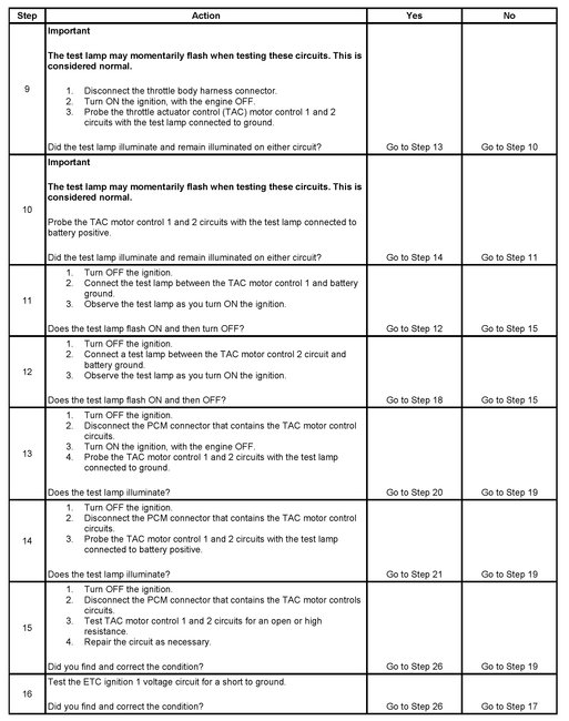

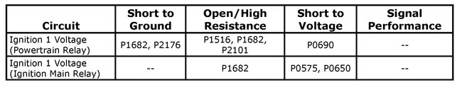

I have to ask, have you checked for diagnostic trouble codes? I am finding quite a few codes related to the TPS. If you have, let me know what they are.
Jan 2, 2020 at 10:19 PM
TRAVELCREW
  • 25 POSTS
Thursday a friend stopped with his scanner codes P1516,andP1682 came up so we replaced the switch
Jan 3, 2020 at 3:31 PM
  • 110,194 POSTS
What switch? Was it the ignition switch? That is the only one I can think of that can be associated with the one code.
Also, the 1516 is specific to the throttle actuator control system. With this code, there should be information stored in "Freeze Frame" data. If the scanner can read that, check to see what was happening when the code was set.
Now the P1682 is related to either related to a short to ground or an open in the power-train relay, or it is an open or high resistance in the ignition main relay. See pic 1.
Did the replacement of the switch take care of the problem?

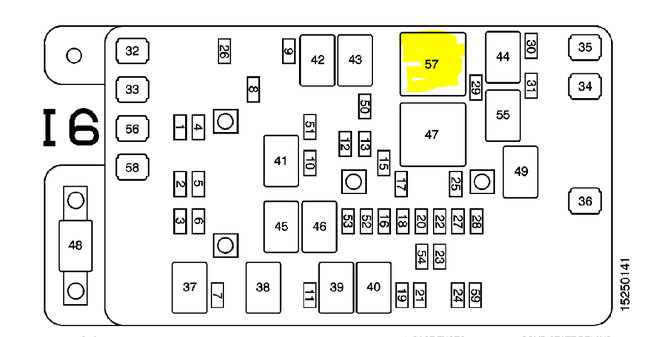

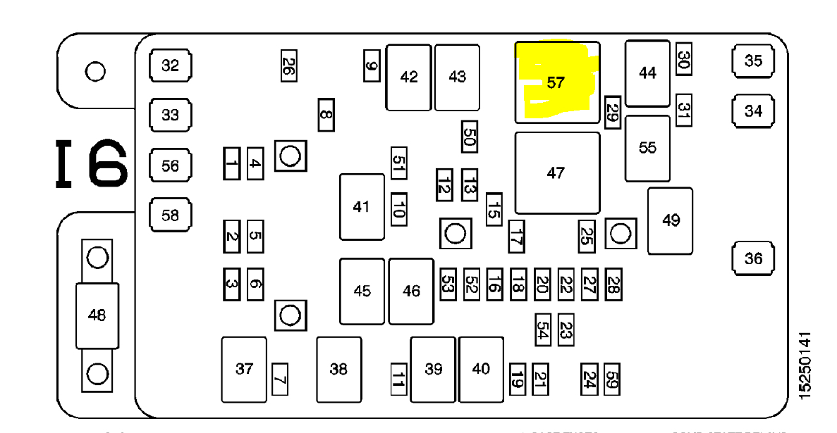

I attached the only pics I have. It is of the power distribution box under the hood, Let me know if it helps.
Jan 4, 2020 at 6:31 PM
TRAVELCREW
  • 25 POSTS
replaced both relays and still same problem.

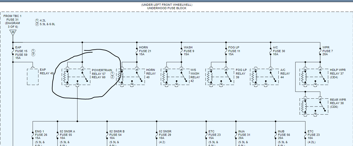

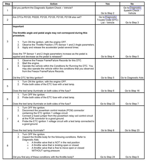

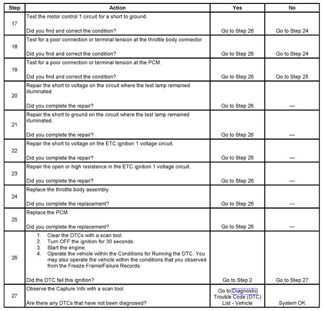

The codes indicated a short or open to the relay. Did you check for that as an issue? Here are the diagnostics. The attached pics correlate with the directions.

Circuit/System Verification
1. If DTCs P0685, P0689, or P0690 are set, diagnose those DTCs first.
2. Ignition ON, engine OFF, observe the Ignition 1 voltage signal and the EC Ignition Relay Feedback signal parameters on the scan tool. Both parameter values should display no more than 3 volts difference between the 2 parameters.
3. Ignition OFF, observe the ignition 1 voltage signal parameter on the scan tool. The parameter value should be 0 volts before the ECM powers down.
Circuit/System Testing
1. Ignition OFF, disconnect the powertrain relay.
2. Ignition ON, verify that a test lamp does not illuminate between the powertrain relay controlled output circuit terminal and ground.
- If the test lamp illuminates, test the powertrain relay controlled output circuit for a short to voltage.
3. Ignition OFF, verify that a test lamp illuminates between the powertrain relay coil voltage supply circuit terminal and ground.
- If the test lamp does not illuminate, test the powertrain relay coil voltage supply circuit for a short to ground or an open/high resistance.
4. Verify that a test lamp illuminates between the powertrain relay switch voltage supply circuit terminal and ground.
- If the test lamp does not illuminate, test the powertrain relay switch voltage supply circuit for an open/high resistance.
5. Disconnect the ECM.
6. Ignition ON, verify that a test lamp illuminates between ECM connector terminal 19 X1 and ground.
- If the test lamp does not illuminate, test the ignition 1 relay controlled output circuit for a short to ground or open/high resistance. If the circuit tests normal and its fuse is open, replace the ECM.
7. Ignition OFF, connect the harness connector at the ECM.
8. Ignition ON, connect a jumper wire between the powertrain relay voltage supply circuit terminal and the powertrain relay controlled output circuit terminal. Verify the EC Ignition Relay Feedback parameter indicates battery positive voltage.
- If not the specified value, test the powertrain relay controlled output circuit for a short to ground or an open/high resistance. If the circuit tests normal and its fuse is open, replace the ECM.
9. If all circuits test normal, replace the powertrain relay.

2007 Chevy Truck TrailBlazer 2WD L6-4.2L
P1516
Vehicle ALL Diagnostic Trouble Codes ( DTC ) Testing and Inspection P Code Charts P1516
P1516
DTC P1516
Circuit Description
The commanded throttle position is compared to the actual throttle position based on accelerator pedal position (APP) and possibly other limiting factors. Both values should be within a calibrated range of each other. The powertrain control module (PCM) continuously monitors the commanded and actual throttle positions. This DTC sets if the values are greater than the calibrated range.
DTC Descriptor
This diagnostic procedure supports the following DTC:
DTC P1516 Throttle Actuator Control (TAC) Module Throttle Actuator Position Performance
Conditions for Running the DTC
* The ignition is ON.
* The ignition voltage is greater than 8 volts.
* The system is not in the battery save mode.
* The engine is running.
* DTC P0068 is not set.
* DTC P1516 runs continuously when the above conditions are met.
Conditions for Setting the DTC
* The difference between the predicted and the actual throttle position is more than a calibrated amount.
* The above condition is present for more than 0.5 second.
Action Taken When the DTC Sets
* The control module illuminates the malfunction indicator lamp (MIL) when the diagnostic runs and fails.
* The control module records the operating conditions at the time the diagnostic fails. The control module stores this information in the Freeze Frame and/or the Failure Records.
* The control module commands the TAC system to operate in the Reduced Engine Power mode.

Test Description
Step 1 - Step 8
pic 4
Step 9 - Step 16
pic 5
Step 17 - Step 27
pic 6
The numbers below refer to the step numbers on the diagnostic table.
8. The throttle valve is spring loaded in a slightly open position and should move in either direction without binding. The throttle valve should always be under spring pressure.
11. When the ignition is turned ON, the PCM operates the throttle control motor to verify the integrity of the system prior to start-up. This can be seen by the momentary flash of the test lamp as the ignition is turned ON.
___________________
Let me know what you find.

we got a different scanner and hooked up. can not read ignition voltage and nothing on gas pedal. did you have any ideas?
Jan 9, 2020 at 6:24 PM
  • 110,194 POSTS
You did check the relay, correct? It was good? No blown fuses? If that is the case, you have an open between the relay and the switch.
Jan 9, 2020 at 7:28 PM
TRAVELCREW
  • 25 POSTS
we replaced both relays.
Jan 10, 2020 at 5:11 AM
  • 110,194 POSTS
I understand. However, did you check for power at the relays? The code indicated there was a problem prior to the relay itself. If there is a problem to the relay, a new relay won't fix a problem.
Jan 10, 2020 at 3:41 PM
TRAVELCREW
  • 25 POSTS
no will test that next. if no power where do we look next?
Jan 10, 2020 at 5:37 PM
  • 110,194 POSTS
At that point, it becomes a wire tracing issue. You have to follow the power supply wire back to locate where power is lost. It can be a nightmare.
Jan 10, 2020 at 7:20 PM
