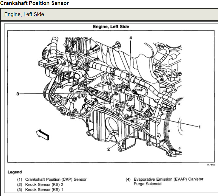

My Trailblazer has no power and will not go over 3000 rpm. I have replaced the spark plug, gas filter, throttle body acceleration pedal sensor and the crank shaft sensor. I am at a loss of where I go from here. Help!

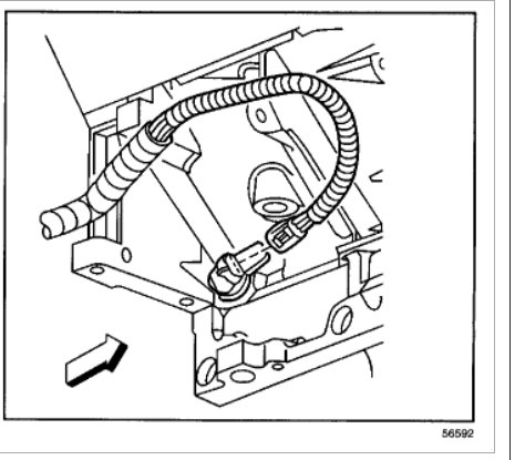

It sounds like it could be the crank angle sensor, are you still having a problem or did you get it fixed?

The trouble shooting guid says that sometimes after replacing the crank shaft position sensor sometimes u have to bring it to the dealer to have it reset is this true
Apr 24, 2016 at 10:09 AM
  • 55,851 POSTS
you have to relearn crank position with a bi-directional scan tool. Have you checked the air filter, could be really dirty and please check the fuel pressure, here is a guide.

Must have been a bad crank sensor.. I tried another one and it runs great now.. thanks for all the help, this site is great.

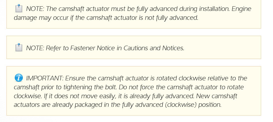

Thank you for your quick response. Do you have any comments on how to fully advance the actuator on the exhaust sprocket? I cant find any good information and I would really like to see a video on this to know I have done it correctly. I am planning to find a shop with the scan tool to do the resync as suggested.

the actuator has to be rotated clockwise prior to tightening the bolt that holds it on.

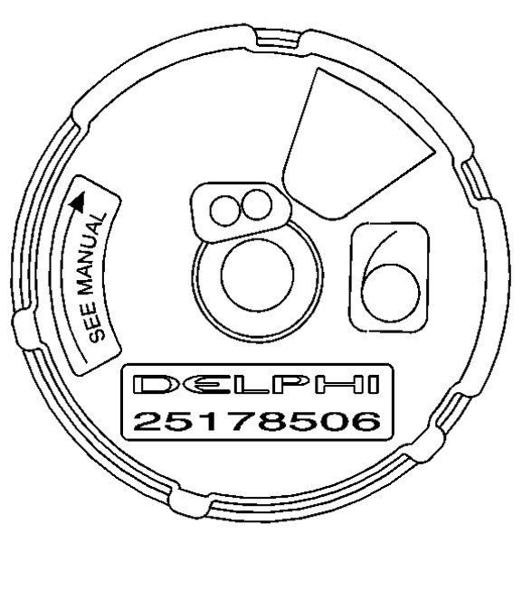

Just so I understand, once you place it on the cam, then it should rotate clockwise? what actually rotates? Is the the round end that rotates or the whole gear?

the round end see pics

As a side note I did check the rotation of the phaser on the end of the exhaust sprocket. I can only get it to move maybe 1/8 inch back and forth by hand. Is this correct?

the phaser doesn't move that far and since we can't see it running it is probably ok.
