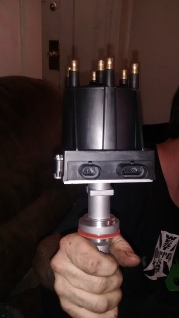

Before you replace distributor check to see if rotor moves, it should not if it does the gear is shot on bottom of distributor.

Yes, the rotor pulls up and down a good centimeter.

How should I set the non obd2 system want to make sure it is in right the first time?

WRENCHTECH
  • 20,761 POSTS
There isn't anything to setting it beyond just dropping it into the right position. It is not adjustable. If it is in the wrong position it will trigger a P1345 code.

PATRICK HAUGER
  • 15 POSTS
My distributor is adjustable it is a two plug vertical post distributor there is no set position it locks in at if I set it with plugs pointed towards cab it still sits in the same way as if it sits with plugs towards motor.

PATRICK HAUGER
  • 15 POSTS
This is what I have there is no marks on it anywhere.
Monday, February 1st, 2021 AT 10:47 AM (Merged)
WRENCHTECH
  • 20,761 POSTS
Okay, on many of them the hold down tab is made onto the distributor. If yours is actually adjustable you will need a professional scan tool and you will have to rotate the distributor until the cam offset reads zero in the scan tool.
