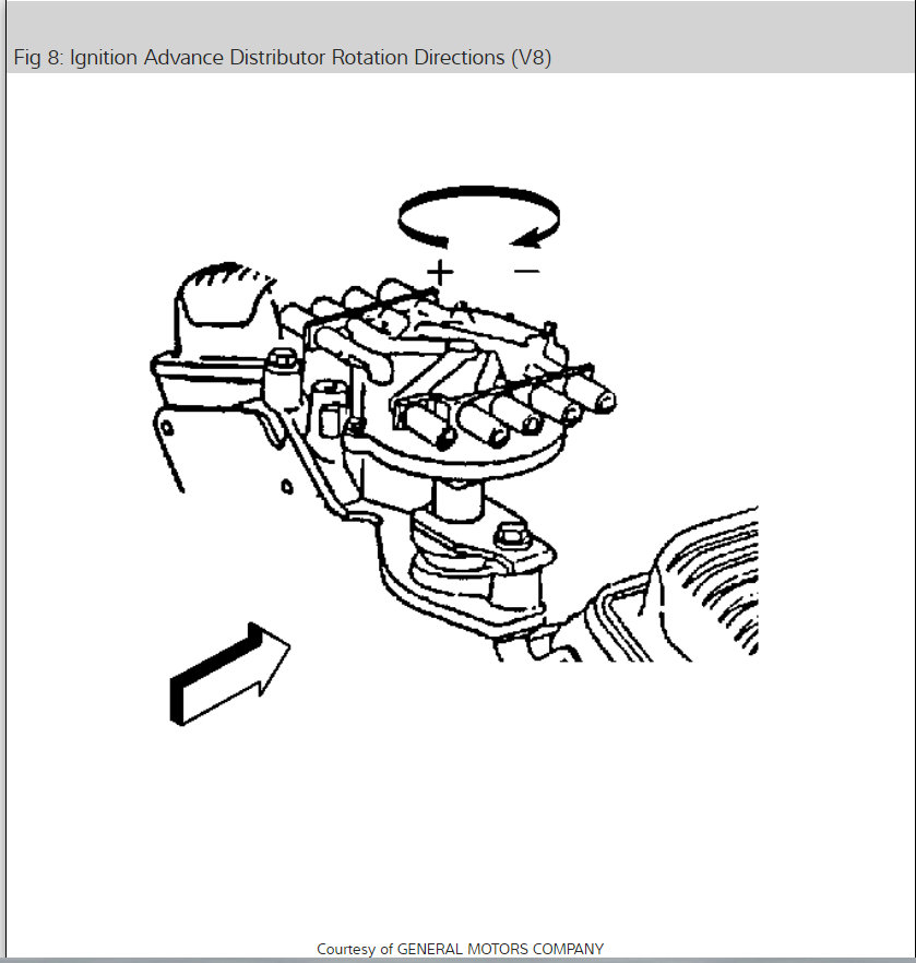

I can't get the motor to start. I re-installed the distributor and can't find top dead center. I have alligned the indicator marks on the damper with the marks on the front of the motor and positioned the rotor to the number one plug after what i thought the compression stroke was and tightened everything down but when I try to start the motor it won't start but will backfire.
Feb 1, 2021 at 10:46 AM (Merged)
  • 75,992 POSTS
Remove the distributor
Your valve and ignition timing are off. You need to put engine no.1 piston on its compression-line the markings at the damper to TDC/0 now install the distributor making sure the rotor is pointing to the no.1 cap tower.

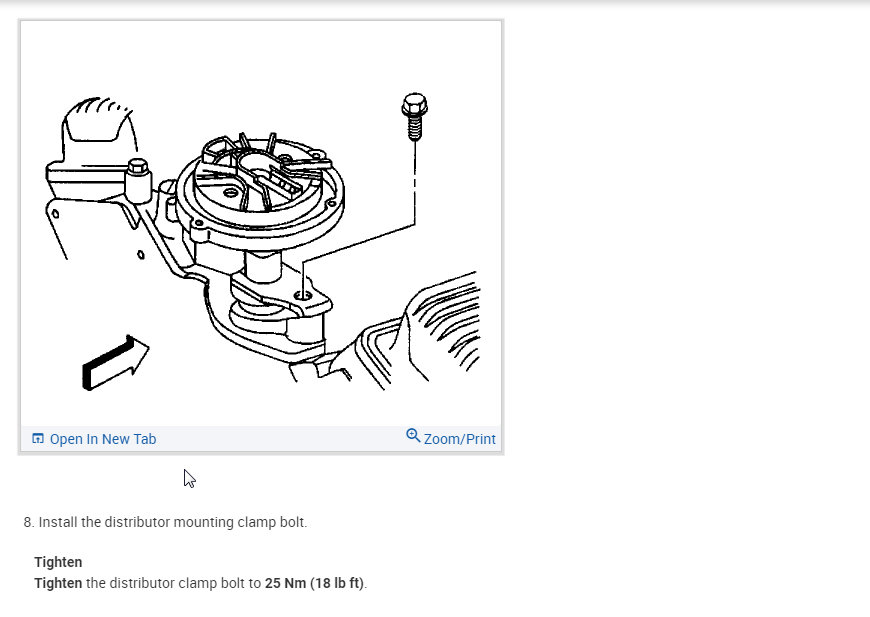

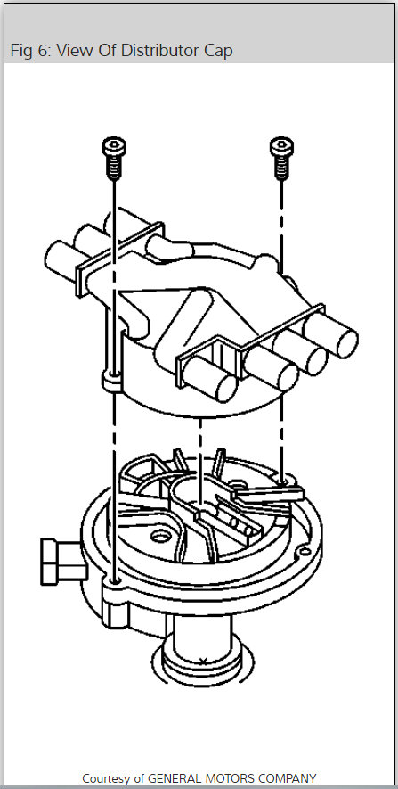

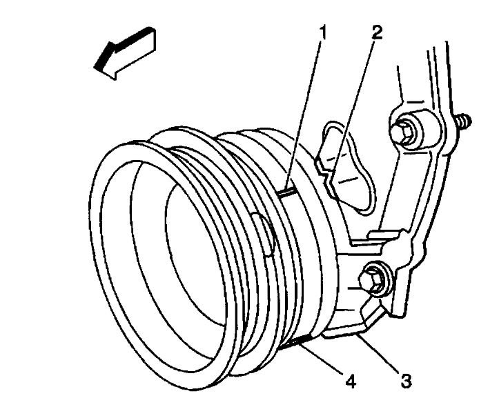

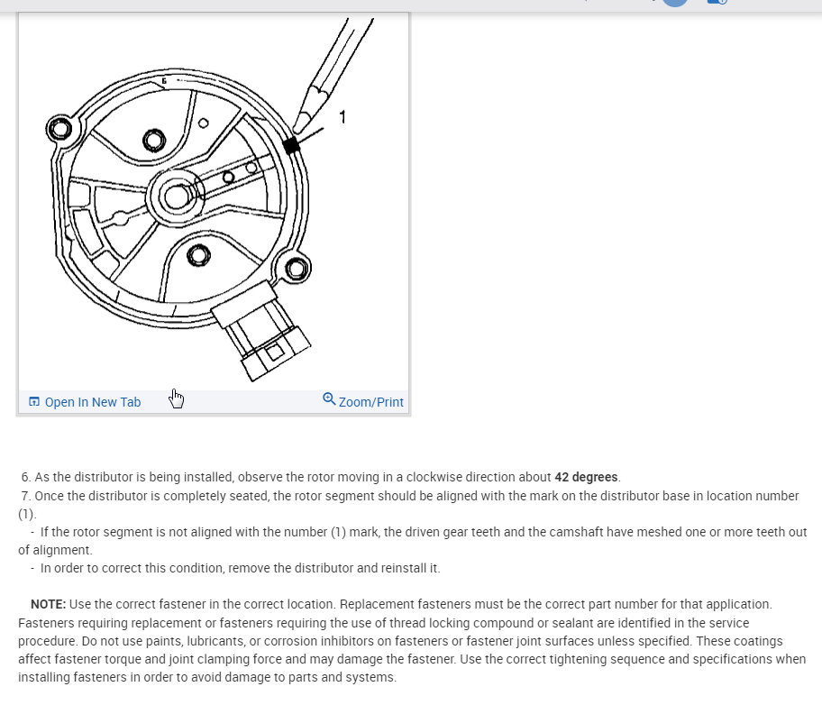

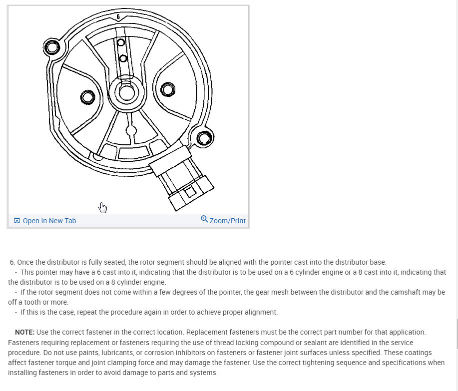

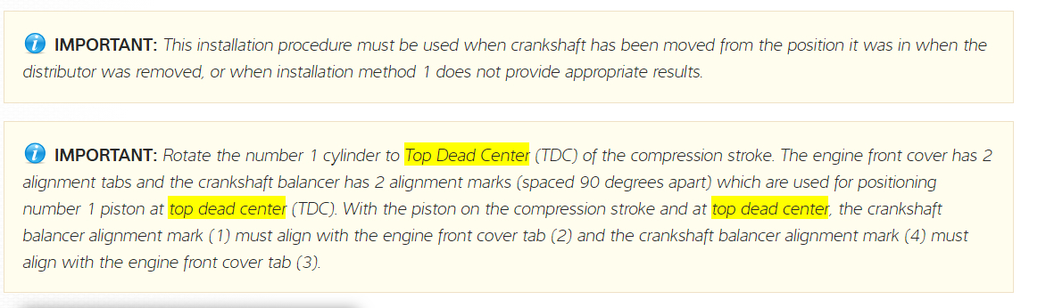

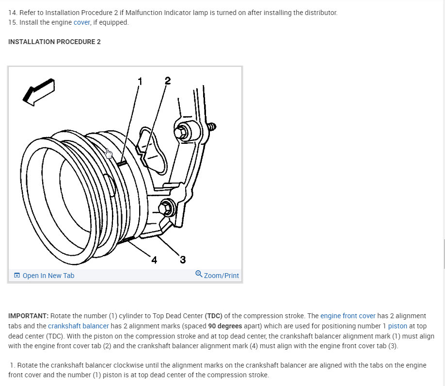

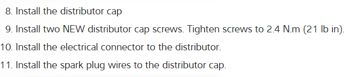

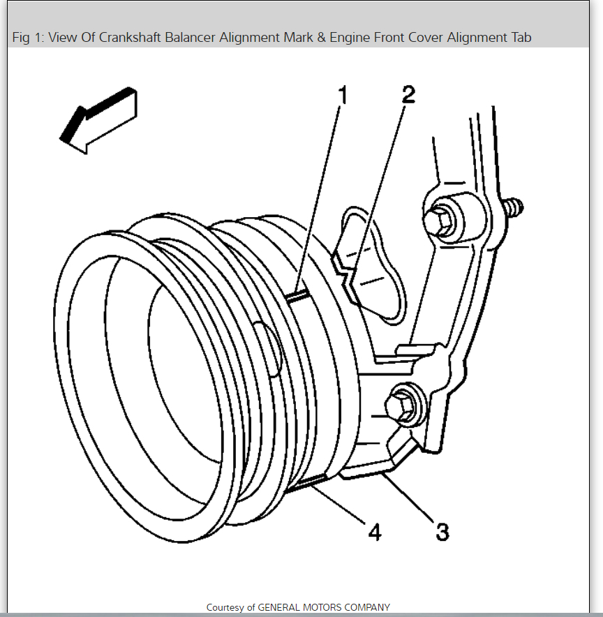

Good morning,
I posted the procedure for you below as well as some pictures for you to view.

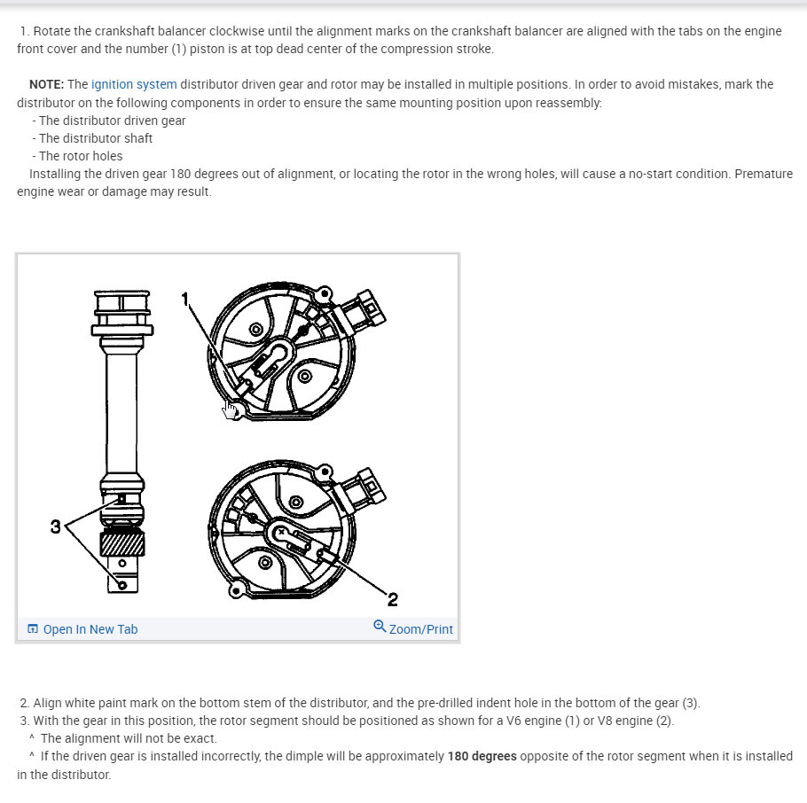

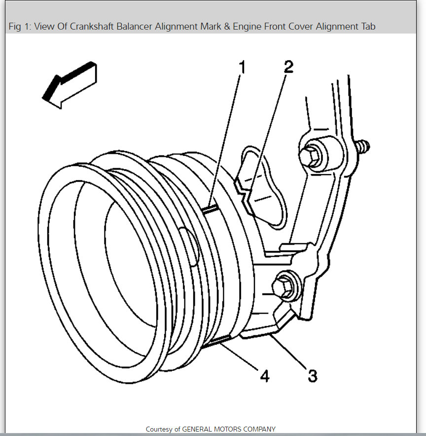

Important: The engine front cover has 2 alignment tabs and the crankshaft balancer has 2 alignment marks (spaced 90 degrees apart) which are used for positioning number 1 piston at top dead center (TDC). With the piston on the compression stroke and at top dead center, the crankshaft balancer alignment mark (1) must align with the engine front cover tab (2) and the crankshaft balancer alignment mark (4) must align with the engine front cover tab (3).
1. Rotate the crankshaft balancer clockwise until the alignment marks on the crankshaft balancer are aligned with the tabs on the engine front cover and the number 1 piston is at top dead center of the compression stroke.

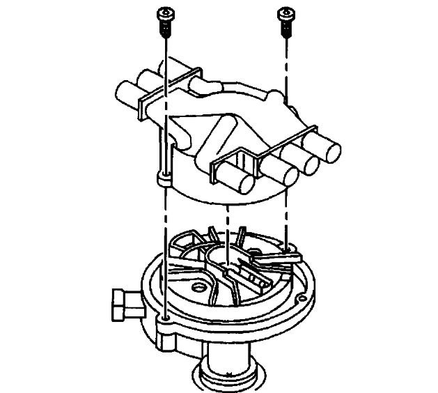

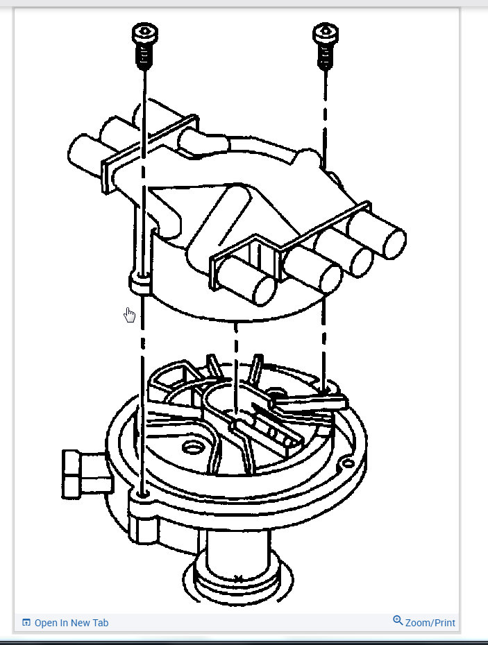

2. Remove the distributor cap bolts and discard.
3. Remove the distributor cap.
4. Install a NEW distributor gasket onto the distributor.

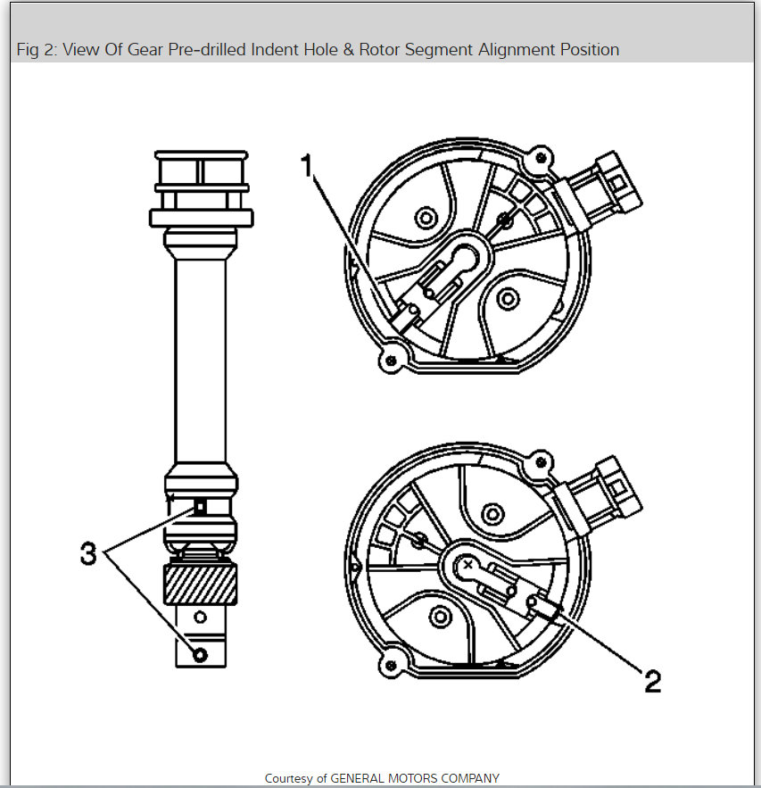

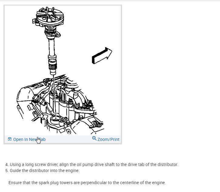

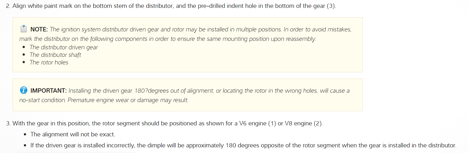

5. Align the indent hole on the driven gear with the paint mark on the distributor housing.
6. Ensure that the distributor rotor segment points to the cap hold area.
7. Align the slotted tang in the oil pump driveshaft with the distributor driveshaft.
Rotate the oil pump driveshaft with a screwdriver if necessary.

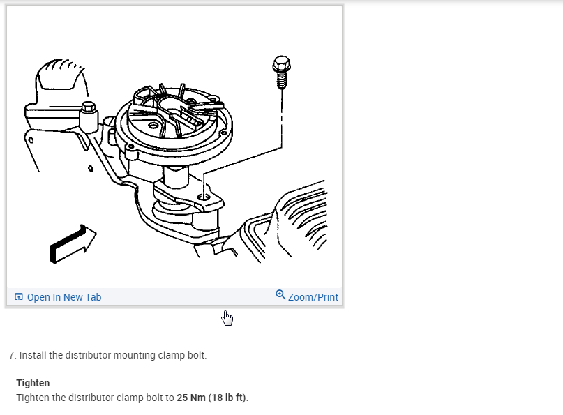

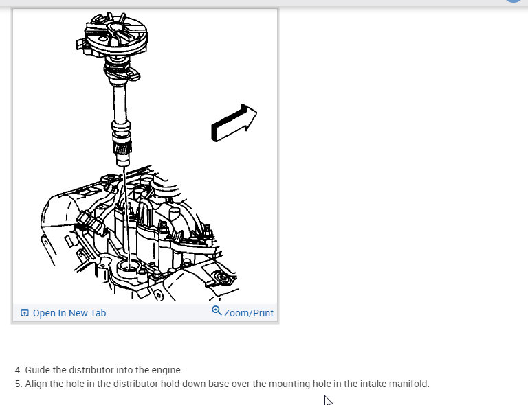

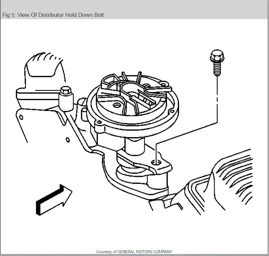

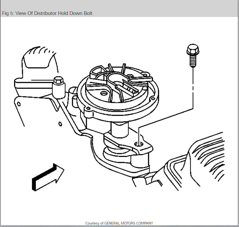

8. Install the distributor and distributor clamp.
The flat in the distributor housing must point toward the front of the engine.

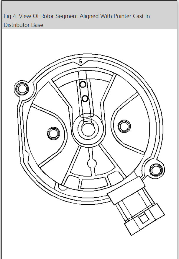

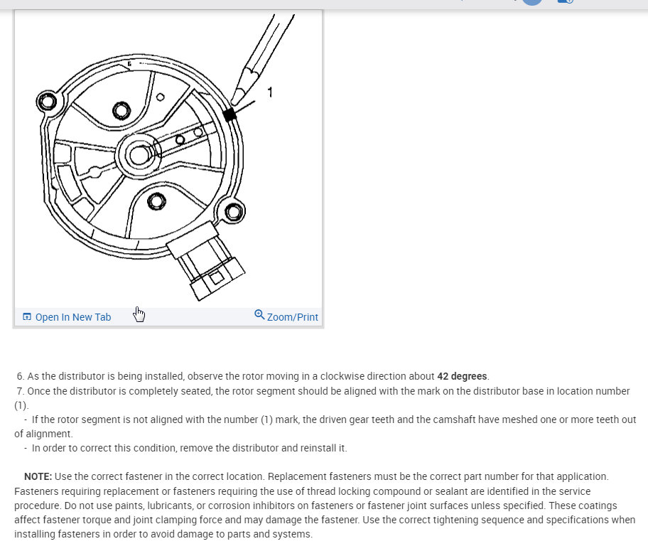

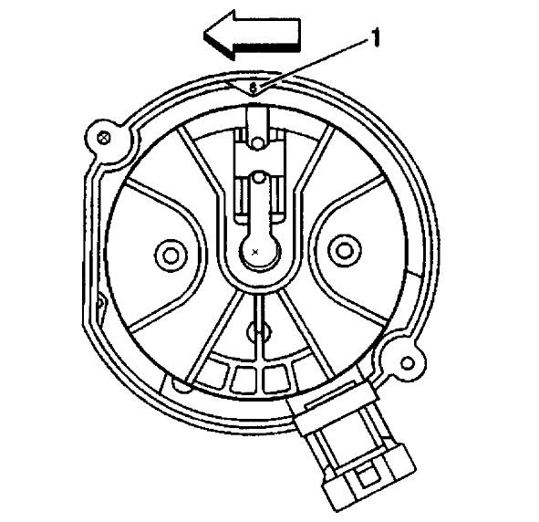

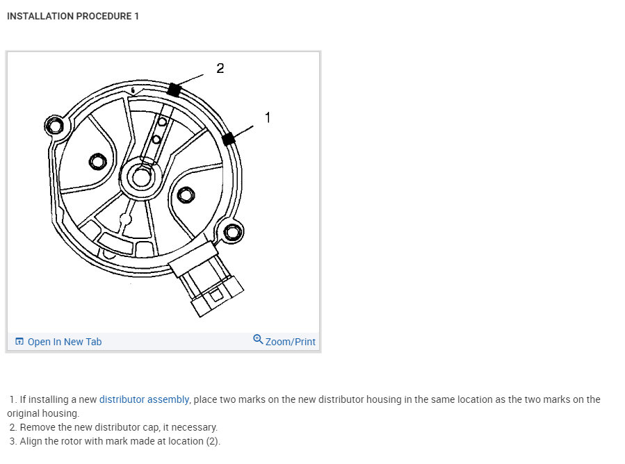

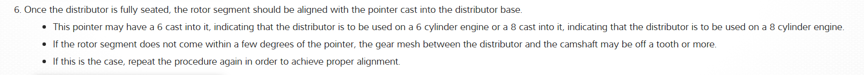

9. Once the distributor is fully seated, align the distributor rotor segment with the number 6 pointer (1) that is cast into the distributor base.
If the distributor rotor segment does not come within a few degrees of the number 6 pointer (1), the gear mesh between the distributor and camshaft may be off a tooth or more. Repeat the procedure again in order to achieve proper alignment.
10. Install the distributor clamp bolt.
^ Tighten the distributor clamp bolt to 25 Nm (18 ft. lbs.).
NOTICE: Refer to Fastener Notice in Service Precautions.

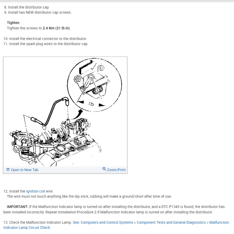

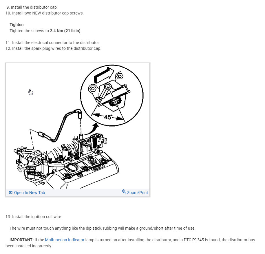

11. Install the distributor cap and NEW distributor cap bolts.
^ Tighten the distributor cap bolts to 2.4 Nm (21 inch lbs.).

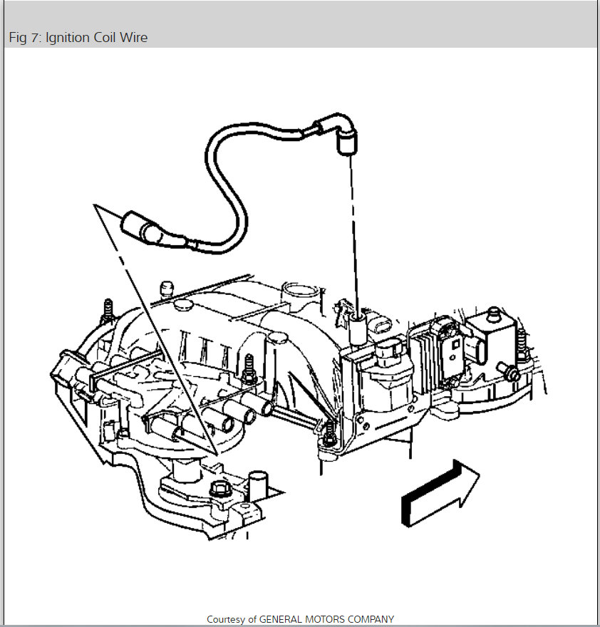

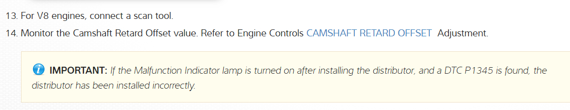

12. Install the ignition coil wire harness.

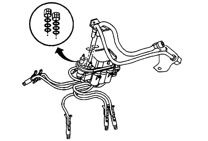

Well it finally stopped raining so I could finish it up and get it started. When I turned the key to on there is a fuel leak from the lines going into the spider assembly. I canned the o-rings going to it and some spacers and washers. Can you give me a diagram of how they go in case I did something wrong? Thank you
I attached a picture for you of the line with spacer and washers.
UP29BALNE1
  • 65 POSTS
It looks like there are three o-rings and the plastic spacer.
There are two o-rings, spacer, and washer.

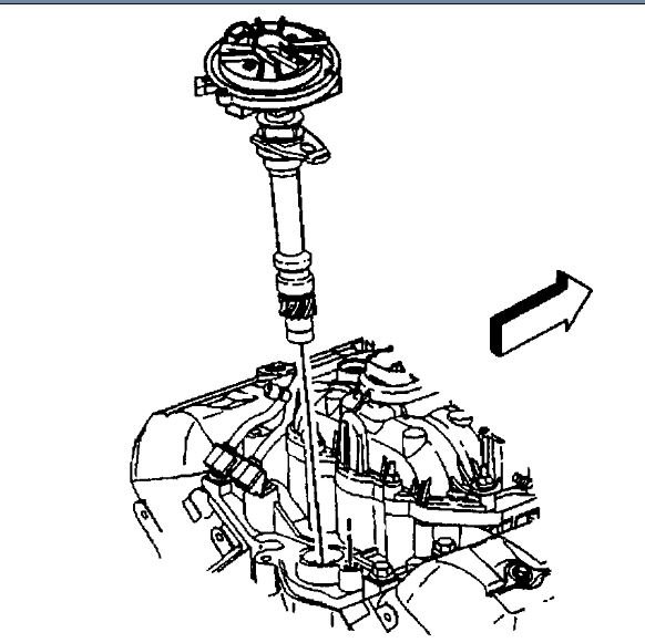

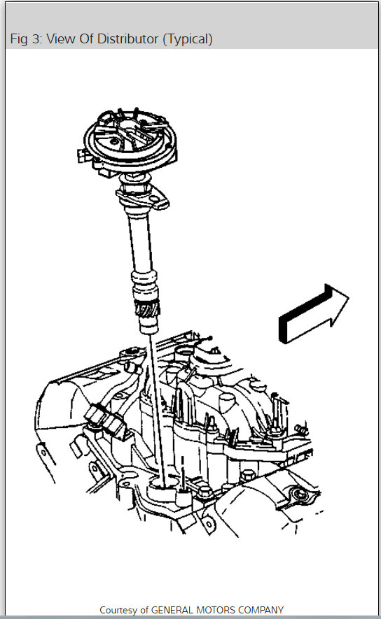

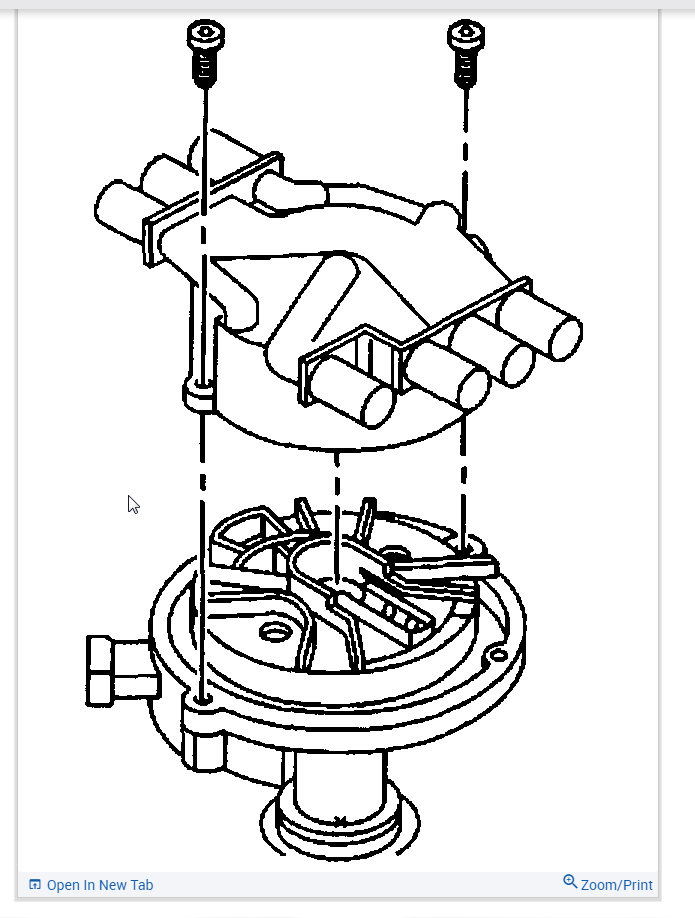

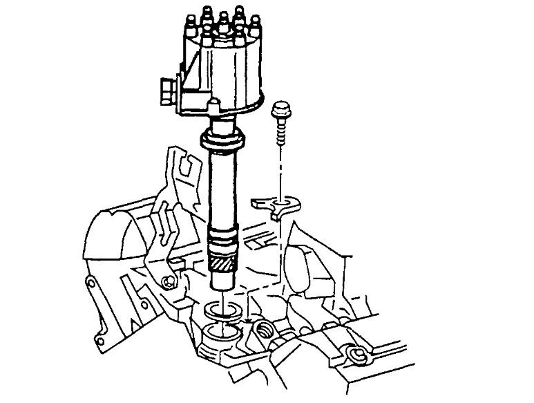

Good morning,

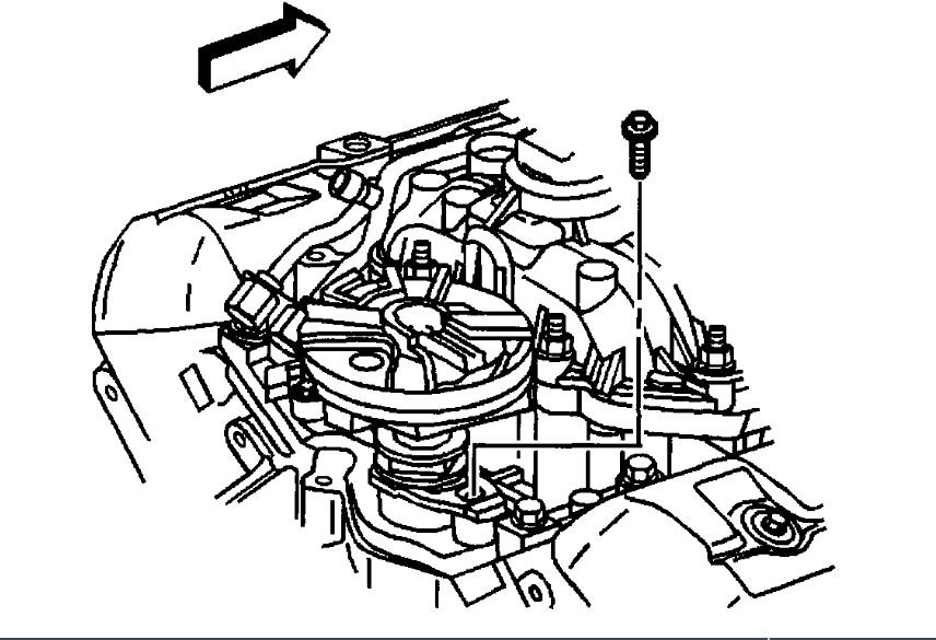

I attached the procedure below. Make sure the engine is at top dead center compression stroke.
Preassembled replacement distributors are not available. Components are available to assemble a new distributor. Some components, such as the air cleaner, may need to be removed to reach the distributor. The distributor has a separate ignition coil that mounts to a bracket on the top of the engine.
REMOVE OR DISCONNECT
Make sure the ignition switch is "OFF."
1. Air cleaner and hoses.
2. Electrical connectors at the side of the distributor cap.
3. Two screws on the sides of the distributor cap.
4. Ignition coil wire and spark plug wires on either the left or right side of the distributor.
5. Distributor cap and move it aside.
A. Use chalk to note the position of the rotor in relation to the engine.
B. Use chalk to note the position of the distributor housing in relation to the engine.
6. Distributor bolt and hold-down clamp.
7. Distributor and gasket, when present.
INSTALL OR CONNECT
1. Distributor and gasket when present.
A. To ensure correct timing of the distributor, it must be installed with the rotor correctly positioned as noted in step 5 of the removal procedure. Line up the rotor to the mark on the engine, and the mark on the housing to the engine. Rotate the distributor shaft 25° to the left from the scribed mark when installing.
B. If the distributor shaft won't drop into the engine, remove the distributor, insert a screwdriver into the hole for the distributor and rotate the oil pump driveshaft so it lines up with the distributor drive gear.
2. Hold-down clamp and bolt.
Tighten
Bolt to 27 Nm (20 lbs. in.).
3. Distributor cap with two screws.
4. Wiring harness connectors to the sealed ICM connectors at the side of the distributor.
5. Spark plug wires and coil wire.
6. Air cleaner and hoses.
^ Check the ignition base timing.

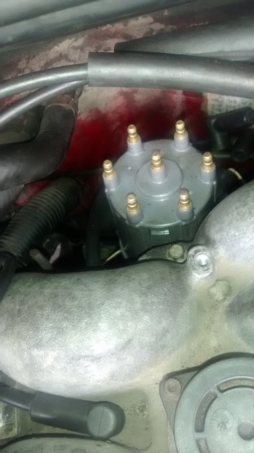

Changed fuel pressure regulator had to remove distributor cause clip that holds fuel lines in flew now truck cranks, but does not fire over, It gets gas got spark. at a loss as to what could be wrong as we have reset the distributor multiple times thinking we did not get in right position, but to no avail.
Feb 1, 2021 at 10:47 AM (Merged)
WRENCHTECH
  • 20,761 POSTS

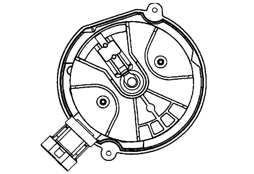

The distributor cap is a little confusing as ti which cylinder the rotor is pointing to. You have to bring the engine up to TDC on #1 on the compression stroke and then align these marks. https://www.2carpros.com/images/external/84852747.gif
PATRICK HAUGER
  • 15 POSTS
My distributor is different then that one and yes we have it tdc. so unless the lines on harmonic is wrong place we did everything by the book.
PATRICK HAUGER
  • 15 POSTS
My distributor also is not stamped with a six like all the videos.
WRENCHTECH
  • 20,761 POSTS
If you have the flat distributor cap, they definitely do not line up on the outside. You have to look at the inside of the cap to find #1.
WRENCHTECH
  • 20,761 POSTS
If you have a non OBD2 system, you will have the old style distributor and that one should be easy to install. https://www.2carpros.com/images/external/42407347.gif
PATRICK HAUGER
  • 15 POSTS
It s the vertical style my buddy who is certified said something about being an adjustable distributor should the fuel regulator needed set before install it came with a bit to do so, but we assumed it should be set close enough to run on out of the package.
PATRICK HAUGER
  • 15 POSTS
The last picture looks like mine. I cannot tell if it has two plugs like mine or not, but the rest seems right.
