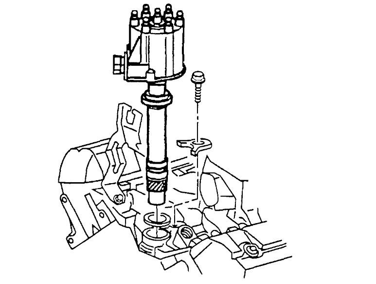

distributor replacement instructions please
2000 CHEVROLET BLAZER
300,000 MILES • 4.3L • 6 CYL • 2WD • AUTOMATIC
HMAC300
  • 48,601 POSTS

How should I set the non obd2 system want to make sure it is in right the first time?
Feb 1, 2021 at 2:47 AM (Merged)
WRENCHTECH
  • 20,761 POSTS
There isn't anything to setting it beyond just dropping it into the right position. It is not adjustable. If it is in the wrong position it will trigger a P1345 code.

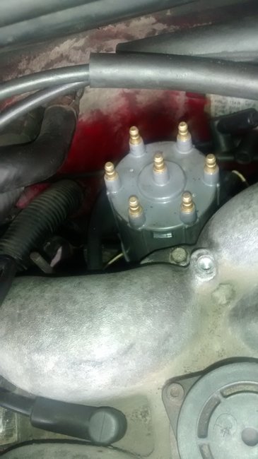

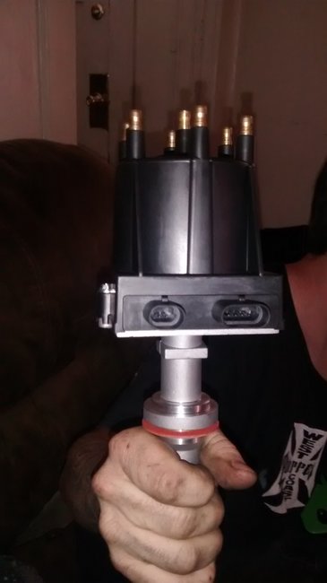

PATRICK HAUGER
  • 15 POSTS
My distributor is adjustable it is a two plug vertical post distributor there is no set position it locks in at if I set it with plugs pointed towards cab it still sits in the same way as if it sits with plugs towards motor.
PATRICK HAUGER
  • 15 POSTS
This is what I have there is no marks on it anywhere.
WRENCHTECH
  • 20,761 POSTS
Okay, on many of them the hold down tab is made onto the distributor. If yours is actually adjustable you will need a professional scan tool and you will have to rotate the distributor until the cam offset reads zero in the scan tool.
