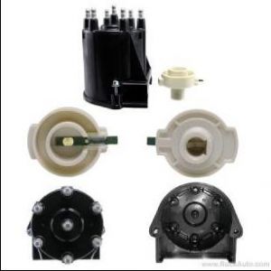

The distributor cap on my 1999 blazer reads 3,1,5 on the driver's side and 2,4,6 on the passenger side. Do these numbers correspond with the spark plug wires?

Hello !!
yes that`s the spark plug/cylinder number for each wire.

JDL
  • 16,098 POSTS
Hi, my partsbook showed two different style caps. the cap in the picture, has hold-down screws, one on eack side of cap. If you don't see anything holding the rotor, just pull up on it. You can number the spark plug towers and plug wires, with tape or something, number 1 through six around the cap. When you go back with new cap, get the plug wires in the same position on the new cap.
