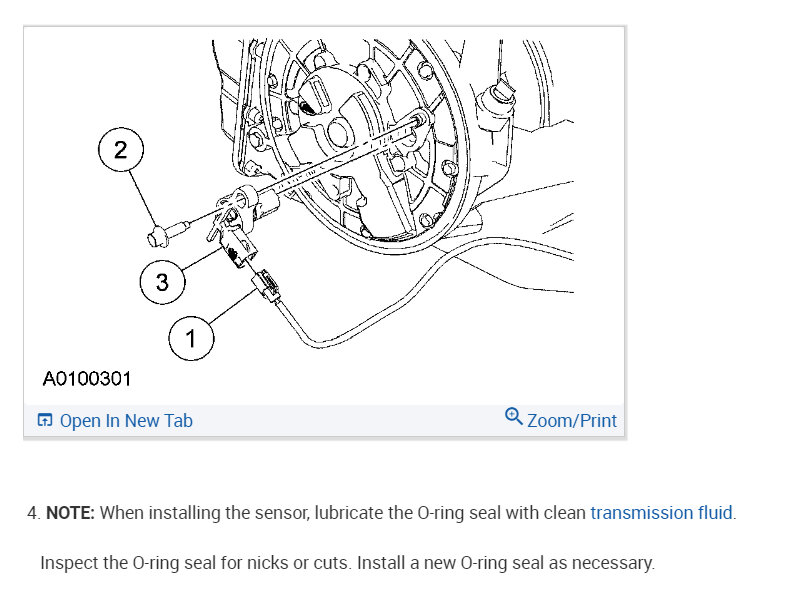

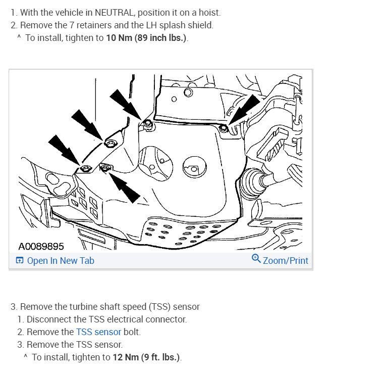

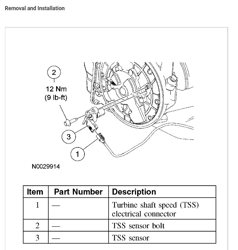

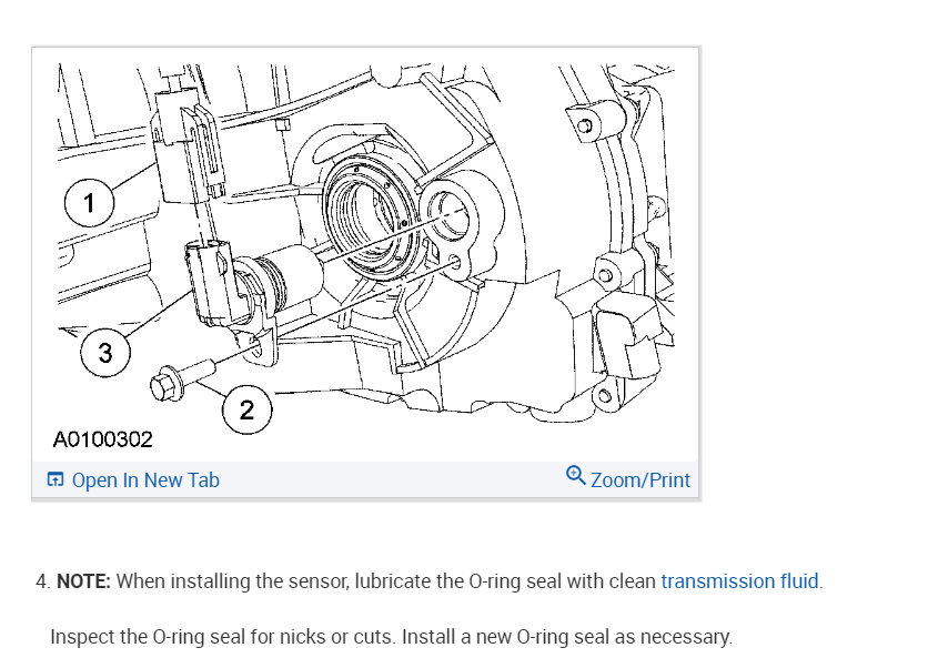

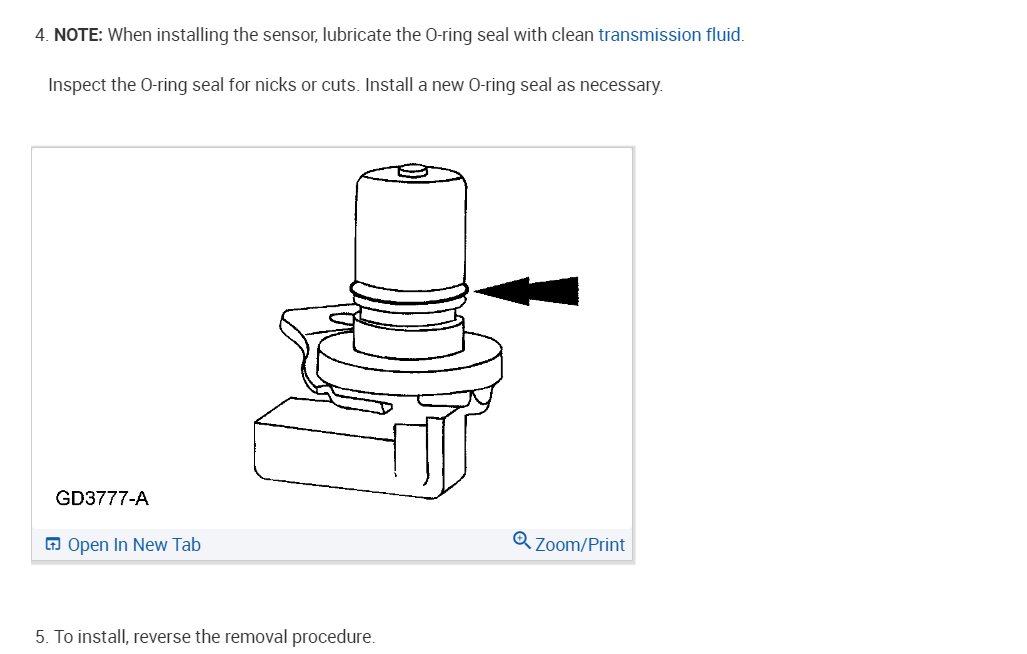

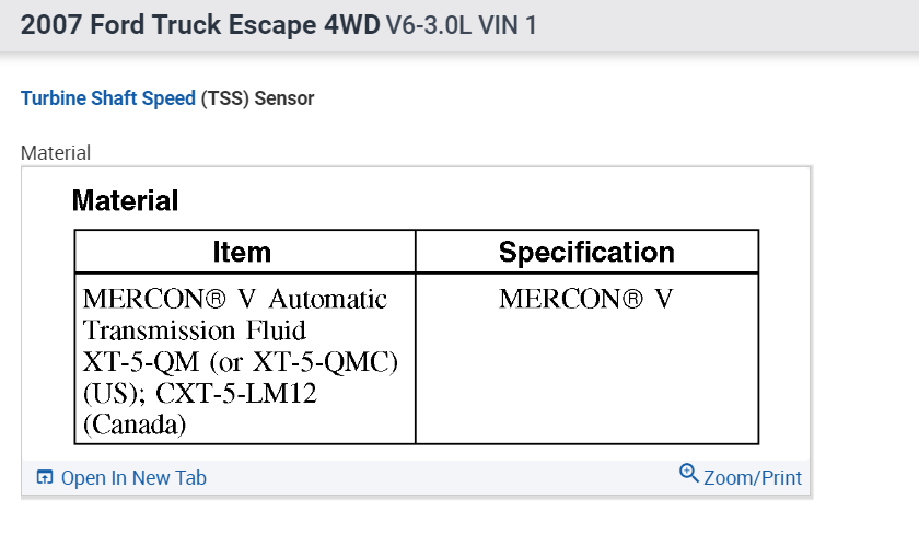

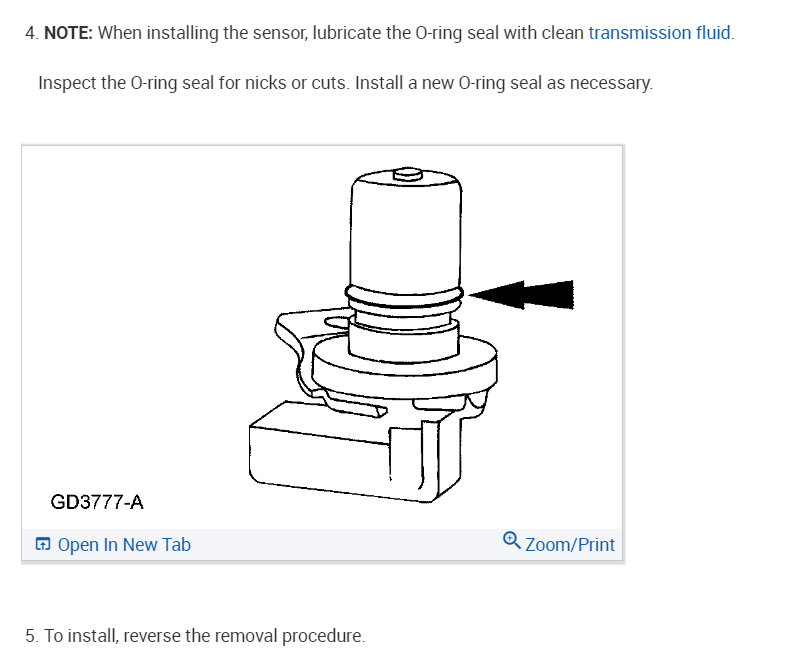

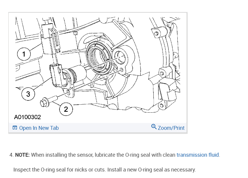

Does the speedometer work? If so, it sounds like the input shaft sensor is unplugged or not working. I would check the fluid level and then run the codes; these guides can help:
https://www.2carpros.com/articles/how-to-check-and-add-transmission-fluid
and
Here is how to replace the input shaft sensor in case you need it. Check out the images (below). Please let us know what happens.
Jul 4, 2023 at 5:38 AM

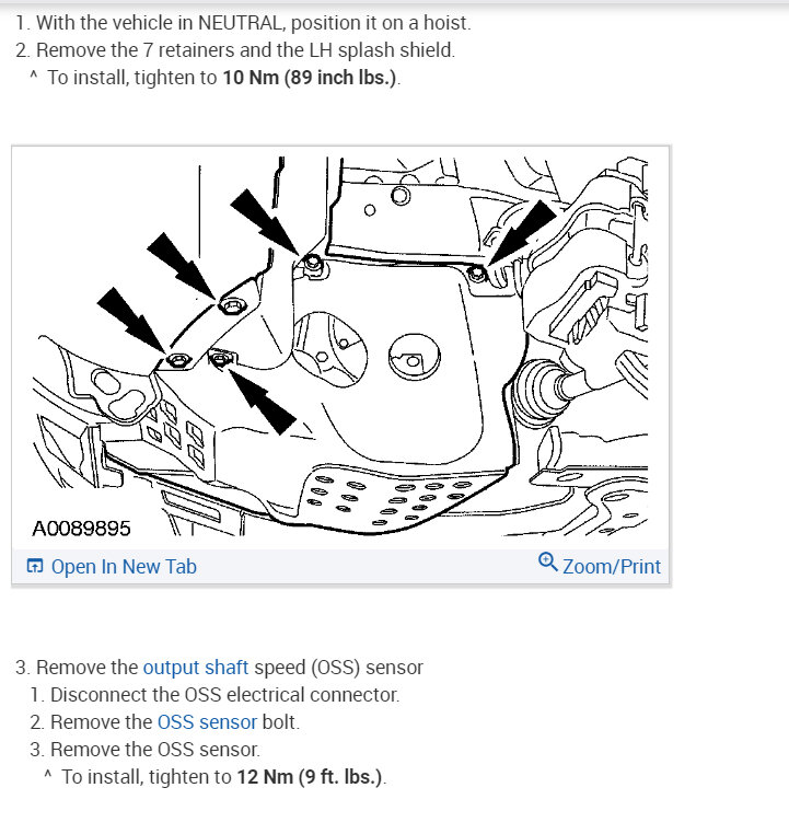

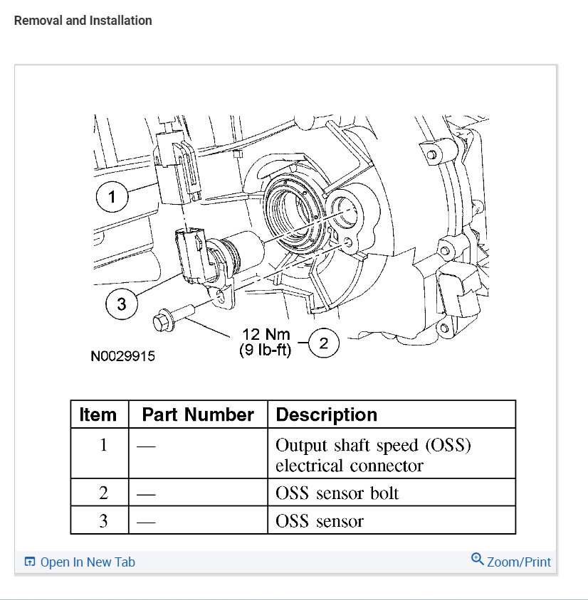

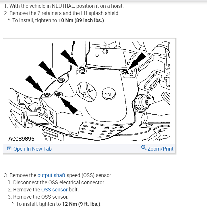

Output shaft, no signal? So does the speedometer work? If not, I would check the output shaft speed sensor to make sure it is connected and if so, I would replace the sensor. Here is the location. Check out the images (below). Please let us know what you find.
