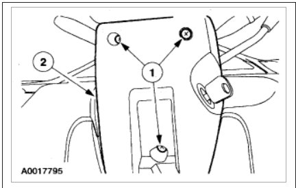

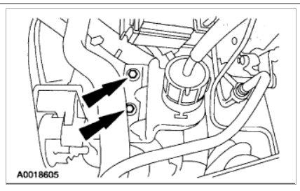

Pulled up to my house and my car would not shift out of drive, unfortunately my husband shut the car off with emergency brake on, now cannot start the car as it thinks it is in drive, reads drive, yet shifter is stuck in park position. Why would this be? Is there any way to start the car while in drive so I do not have to pay for a tow?
Jun 20, 2010 at 1:33 AM
  • 110,248 POSTS

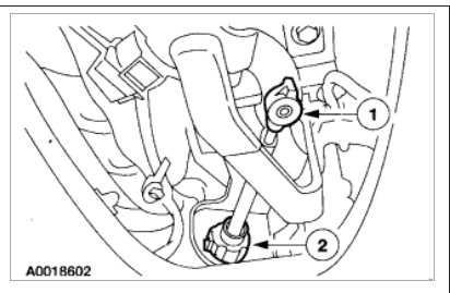

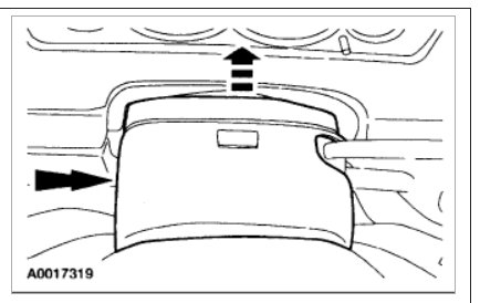

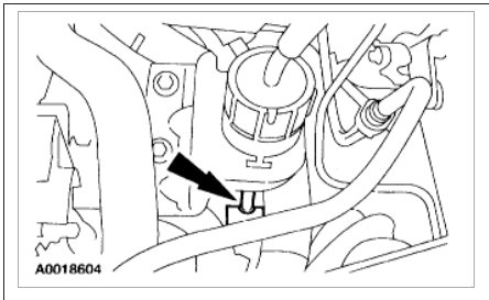

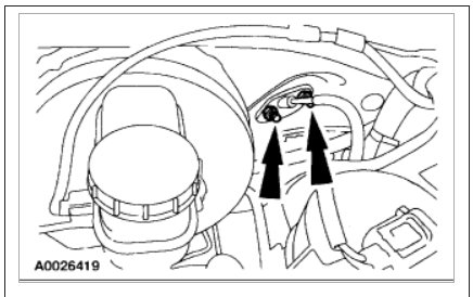

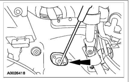

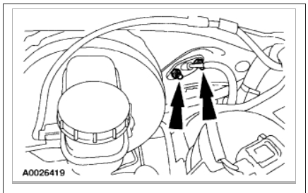

This is a common problem because the shift cable lockup and needs to be replaced. Here are guides to help you get the job done.
Cheers
Jul 2, 2010 at 6:50 AM
MJ1013
Yep that was the problem I had to get the cable from ford but installed it myself not to bad, thanks for your help I love this site.
