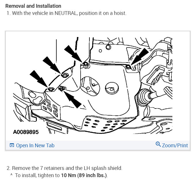

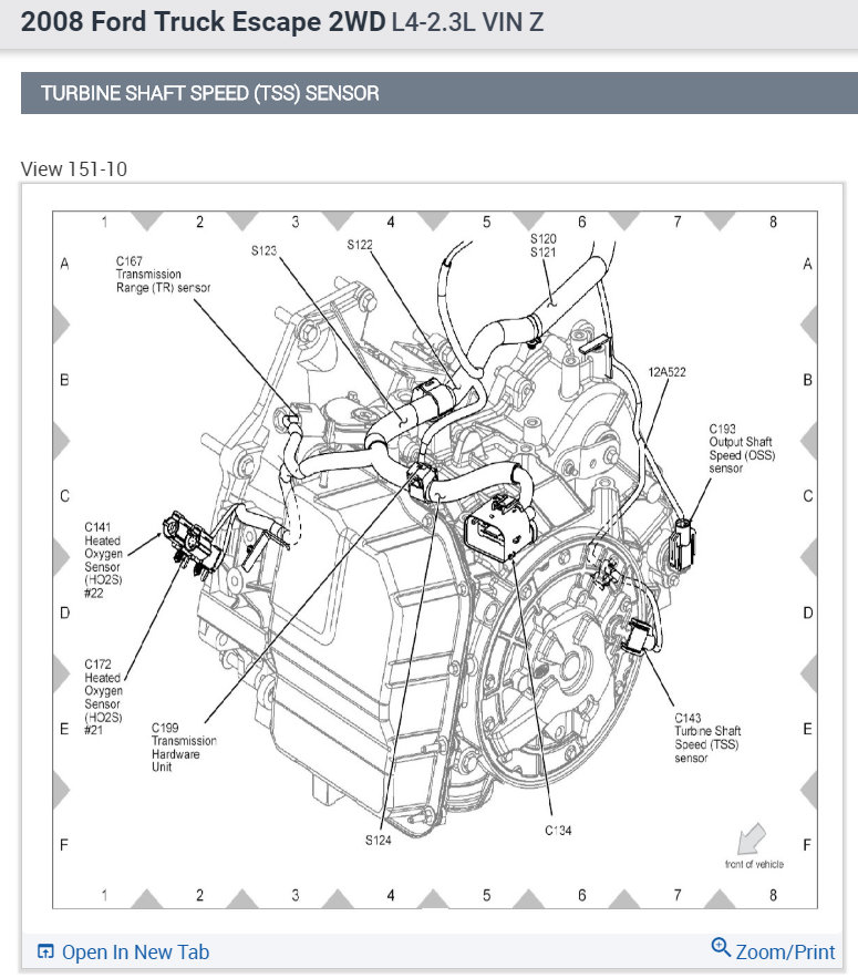

When I am driving and either slow down or speed up, sometimes my vehicle will not shift into gear and then it jerks and shifts. I have checked the transmission fluid and it is good.
Mar 5, 2010 at 4:22 AM
  • 110,251 POSTS

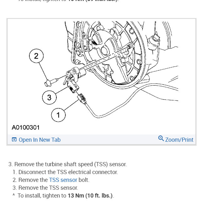

This sounds like a turbine shaft speed sensor has gone out but to be sure lets run the codes
Here is the location of the input shaft speed sensor. Check out the diagrams (Below). Please let us know what you find. We are interested to see what it is.
Cheers
May 5, 2010 at 3:37 AM
KENDRARUSSELL
Thanks you for this post I got a new sensor for $46.00 the car works great! I love this site.
