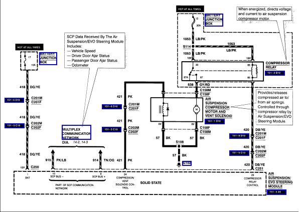

So, this was the question for which I would appreciate your help:
There is a problem with the air spring system on my 1999 Lincoln TC. The back end sat down over night one day last week. Having had lincolns before I felt quite sure it was a leak in the air spring(s). After new air springs were installed, they wouldn't inflate.
Each time the car is started, the compressor starts and runs for a minute or two then shuts off, without any evidence of any air having entered the air springs. As a test, a used compressor that apparently was ok, was connected to the line and the result was the same as when the original pump was run. The compressor ran for a minute or so then shut off. Also, in both cases, the compressor outlet line was disconnected and was replaced by a connector with a stub piece of short hose to sense the air coming out of the compressor. The air stream at the end of this short hose was very weak, both in volume and pressure. When the engine was run for a while, the compressor continued to to cycle on and off in the same manner as described above, producing a weak air discharge. Is it possible that a control device such as a relay or solenoid ahead of the compressor is stuck in a partially open position, preventing a full flow af air to or from the compressor to the system?
As an additional observation, one side of the electrical connector to the pump has two black wires, one pink wire and a gray wire. A mechanic said that the pink wire that connected to the blue wire on the other side of the connector showed no sign of any power. I don't know whether this is significant, but I thought I'd mention it.
I would appreciate your expert analysis of the problem, given the symptoms above as well as a suggested solution. If you have any questions, I will try to respond immediately.

The pink is the vent control. It's not supposed to be powered. There are all kinds of things that could make this system act that way. It has a control module, relays and a data bus that feeds data from various other sensors. It should also have height sensors on the differential. This will not be a simple thing to diagnose if the problem isn't obvious.

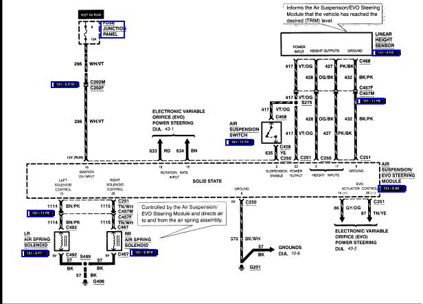

If you have schematics and/or wiring diagrams of the Lincoln Towncar air suspension system I would appreciate it if you could attach them to a reply. That would be a really helpful reply.
Regards,
Bigdennyboy
Feb 15, 2021 at 4:18 AM (Merged)
WRENCHTECH
  • 20,761 POSTS
Here ya go

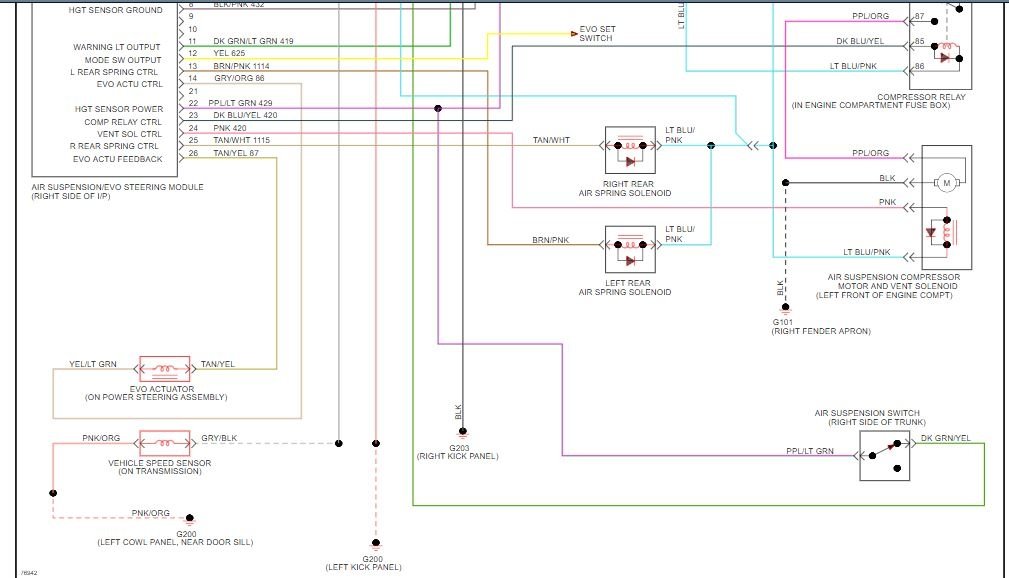

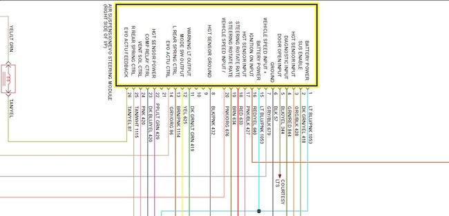

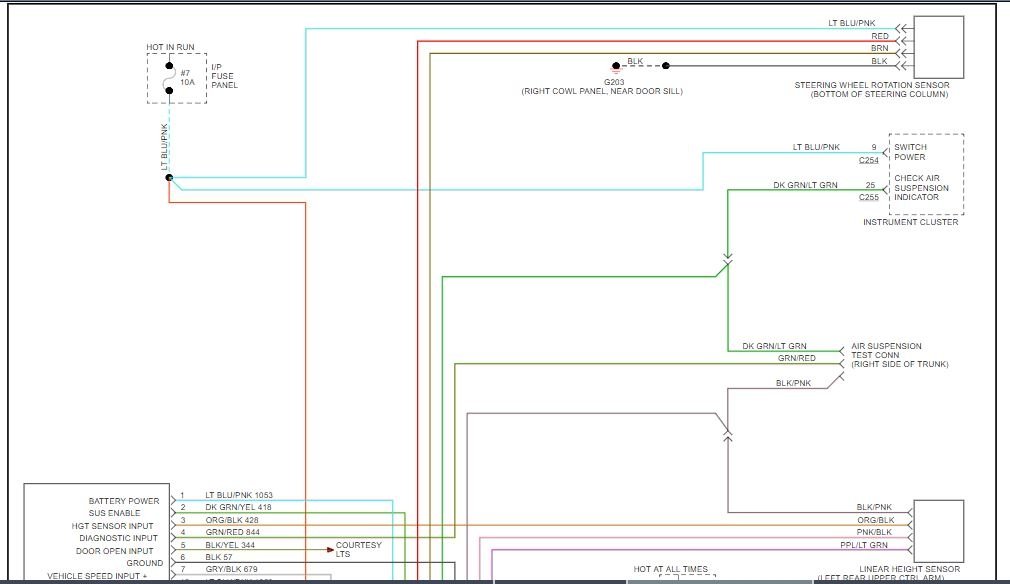

JOHN GRIFFITH
I need a wiring diagram for the air ride.
Feb 15, 2021 at 4:19 AM (Merged)
Good morning,
I attached the diagrams you requested for the air ride system.
Let me know if you have any questions.
What is the issue with the system?

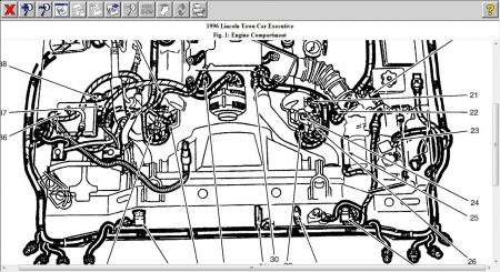

Where is the air compressor for the suspension? Only thing I find that looks it could be the compressor has some lines routed to the brake master clylinder and is located under the engine air filter. I have the air springs out, the height sensor collasped, all fuses good, and suspension switch in trunk on. Trying to test the compressor before ordering parts. None of the air suspension fuses were blown. The right air spring had started leaking down and I have elected to replace both. I don't see any type air dryer near the unit I described above as is pictured in some parts houses.
Thanks Ken
Feb 15, 2021 at 4:22 AM (Merged)
  • 75,992 POSTS
Hi cdbluhog, Welcome to 2carpros and TY for the donation Its on lower left front of engine compartment-see item no. 23 1. Disconnect battery ground cable. 2. Turn air suspension switch to OFF position. 3. Remove air cleaner housing assembly as follows: 1. Loosen air tube to throttle body clamp, then remove air tube end. 2. Unfasten air cleaner lid attaching clips, then remove air cleaner lid. 3. Remove air filter element. 4. Remove 2 outer and 1 inner lower air cleaner assembly attaching nuts. 5. Remove lower air cleaner assembly. 4. Remove air compressor and dryer assembly splash shield and pushpins. 5. Push dryer air line retainer inward, then pull air line outward to remove. 6. Disconnect compressor electrical connectors. 7. Raise and support vehicle. 8. Remove compressor to fender apron attaching nuts. 9. Lower vehicle. 10. Remove compressor and dryer assembly. 11. Reverse to procedure install.[img]
https://images.2carpros.com/forum/automotive_pictures/12900_compressor_2.jpg
