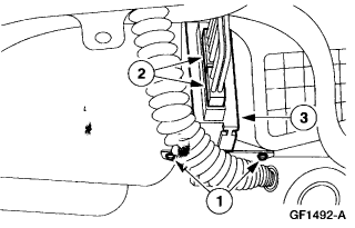

You should be able to totally disconnect the control module. It's located under the dash o the passenger side.
https://www.2carpros.com/forum/automotive_pictures/561653_Suspension_module_98_Town_car_1.gif

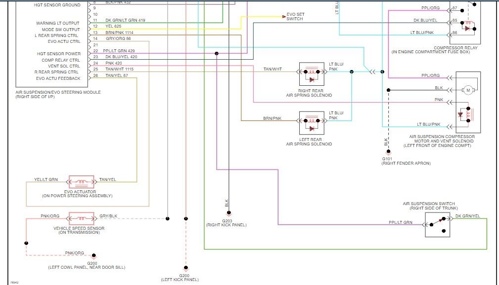

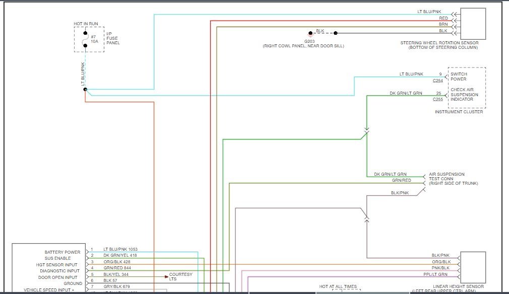

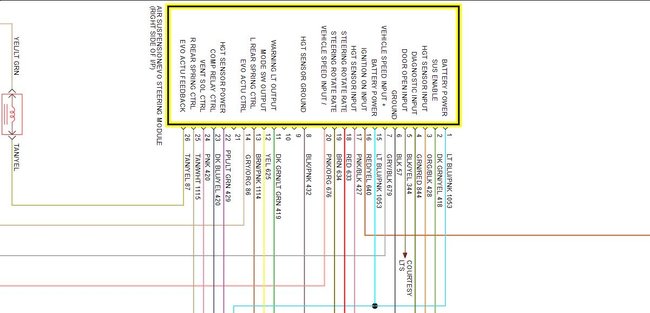

I need a wiring diagram for the air ride.
Monday, February 15th, 2021 AT 12:19 PM (Merged)
  • 52,797 POSTS
Good morning,
I attached the diagrams you requested for the air ride system.
Let me know if you have any questions.
What is the issue with the system?
Monday, February 15th, 2021 AT 12:20 PM (Merged)
