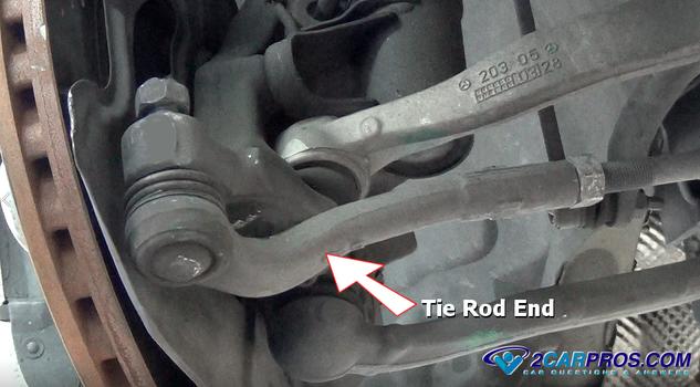

It is easier to replace the tie rod end if the tires have been removed, also the vehicle must be raised and supported on jack stands. In the image below we show you what a tie rod end looks like.
tie rod end

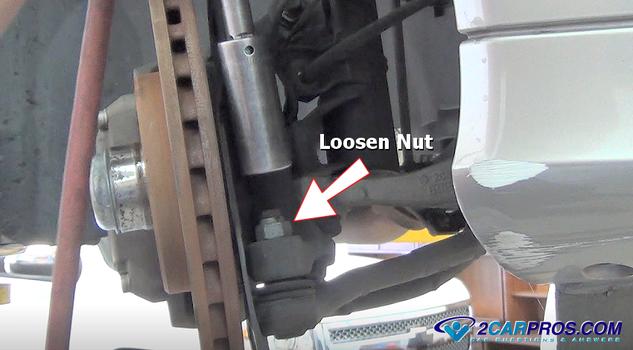

To start, use a wrench or air impact to loosen the tie rod nut at the spindle, leave the nut on about 3 threads to protect the threads and to hold it in place during removal. Because the tie rod is being replaced it doesn't matter if the threads get damaged while removing, but it's good practice while working with steering and suspension parts.
remove tie rod nut

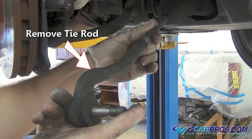

Once the nut has been removed the tie rod will become free and ready for removal, grasp the tie rod and turn either clockwise or counterclockwise depending on right or left hand threads.
removing tie rod end

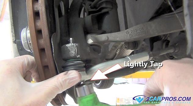

Use a small hammer and tap the tie rod end into place, this will set the tie rod taper which stops the stud from turning while tightening the nut.

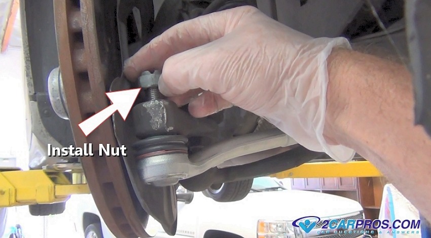

Thread the nut on by hand to avoid cross threading and tighten to spec which in this case is 28 foot pounds of torque. Some nuts will require a cotter pin to be positioned through the nut for additional security.

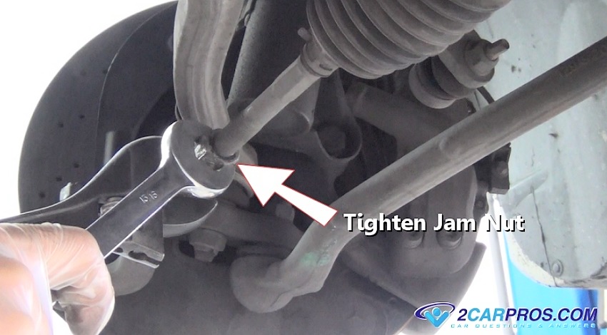

Snug and tighten the jam nut against the tie rod end, there is no torque setting for this nut but we like to say full arm tight, now the vehicle is ready for alignment.
