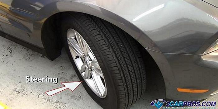

Every vehicle must incorporate a steering mechanism which can direct the front wheels in both right, and left directions. This is achieved using a series of ball joints, tie rods, a steering box or rack, a steering wheel and column which are attached. These steering components and fluid level should be inspected at regular service intervals. In this guide we should show you how the steering system works, a steering system is divided into two separate parts, the power assist portion and its mechanical parts.

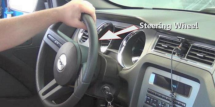

The steering wheel is used by the driver to control the vehicle which can either be connected directly to a steering box or rack and pinion. On some EV's the steering wheel is simply connected to a position sensor which, in turn, tells a computer which way to direct the front wheels and how far to move them via the electronic steering rack.
car steering wheel
Designs include electronic steering controls which enable the computer to manage the control of the vehicle to help avoid accidents by using proximity sensors. This advanced steering system can also limit sudden movements by the driver at high speeds with the help of an YAW sensor to further avoid crashes.

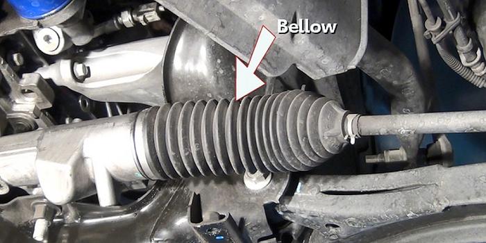

Rubber bellows are used to keep dust and dirt from affecting the steering operation, these items are typically for rack and pinion style of steering units.

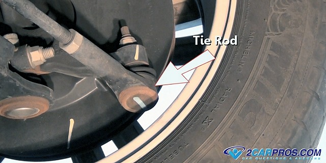

Tie rods are used to connect the spindles (where the tires are mounted) to the steering assembly, this rod end is filled with lubricant which helps the pivot points stay in good working order. A tie rod end is also fitted with a dust cap to keep dirt from getting into the joint.

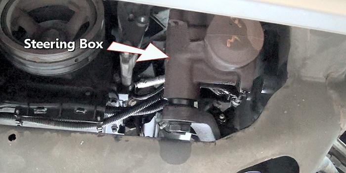

To control the front spindles on heavy duty applications a steering box is used with a series of idler and pitman arms, center links and tie rod ends. A worm gear box style of steering system is constructed of two main parts, worm and selector shaft gears which are attached to a pitman arm. An idler arm is located on the opposite side of the frame from the steering box.

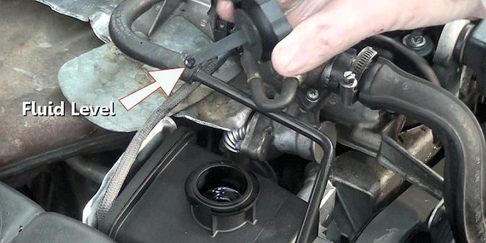

These hydraulic systems must maintain proper fluid levels to operate correctly, if fluid levels fall below minimum requirements the system will howl and moan while air mixes with the fluid, this condition can also lead to hard steering and pump failure. Levels should be checked at each service interval, fluid leaks are common in these systems such as a pressure hose rupture.
