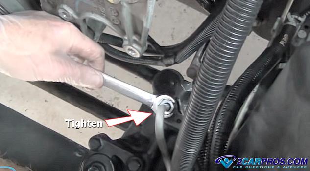

To begin, wear safety eyewear and locate the steering pump and box or rack and pinion. See how the hose is routed and what will need to be removed to gain access to the hose, if any. It does not matter which end of the hose you remove first, we have started at the end of the hose where it connects to the steering box or rack and pinion. It's important to use a line wrench to avoid stripping the flare nut, apply pressure to the wrench to remove the hose. Once the line is loose, fluid will begin to dip out so have a catch basin ready.
remove power steering hose

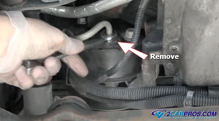

Here we are at the rear of the steering pump using a line wrench to remove the opposite end of the high pressure hose, again note the use of the line wrench. Remove the hose from the vehicle.
remove power steering hose pump

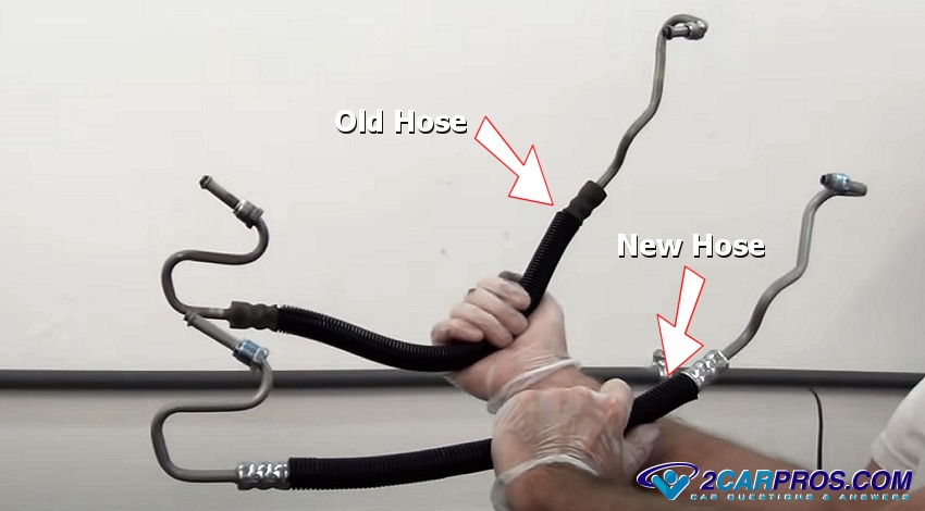

Here is the old hose, which we are matching to the new hose to ensure a proper installation.
old new steering hose
Install new sealing O rings to the replacement hose, one at each end. Also, confirm the old O ring is on the old hose, if not remove the old O rings from the pump, box or rack and pinion because this can cause a leak if the O rings are doubled up.
new O ring seal

Route the new hose into position and start the fittings by hand to avoid cross-threading on both the pump and box or rack and pinion.
install new power steering hose

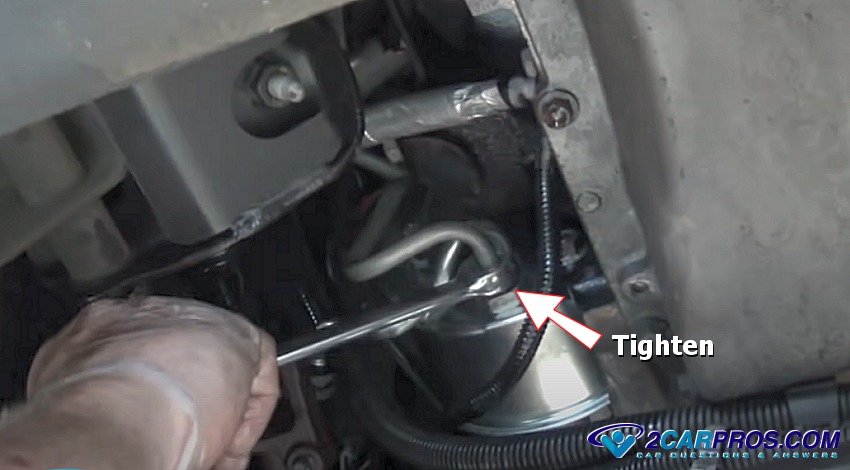

Again use a line wrench to tighten the hose into position, a torque setting for tightening is difficult in this case, so we like to say forearm tight.
tighten high side power steering hose
Finish the installation by tightening the fitting onto the steering pump and reinstall any parts that you had to remove in the process of the repair job.
tighten high side power steering hose pump

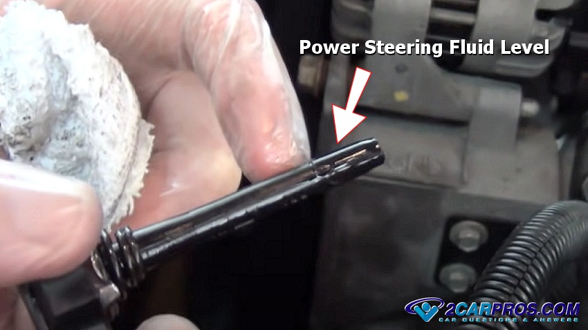

With the engine not running, remove the steering reservoir cap and refill with fluid until full on the dipstick, or on the side of the reservoir and reinstall the cap.
power steering fluid level
Start the engine and gently move the steering wheel back and forth. This will help purge the air from the system, shut the engine off and recheck the fluid level. Recheck the system for leaks and the fluid level in a day or so, you are all set.
