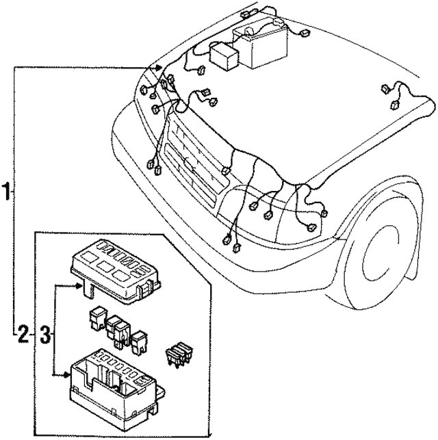

This is a part break out for the fuse box from Kia parts depot. No board shown?
Wednesday, June 29th, 2022 AT 2:44 PM
JIMMY MCPHERSON II
  • 26 POSTS
It appears to have been dismounted before as there is a retaining nut missing.
Wednesday, June 29th, 2022 AT 2:46 PM

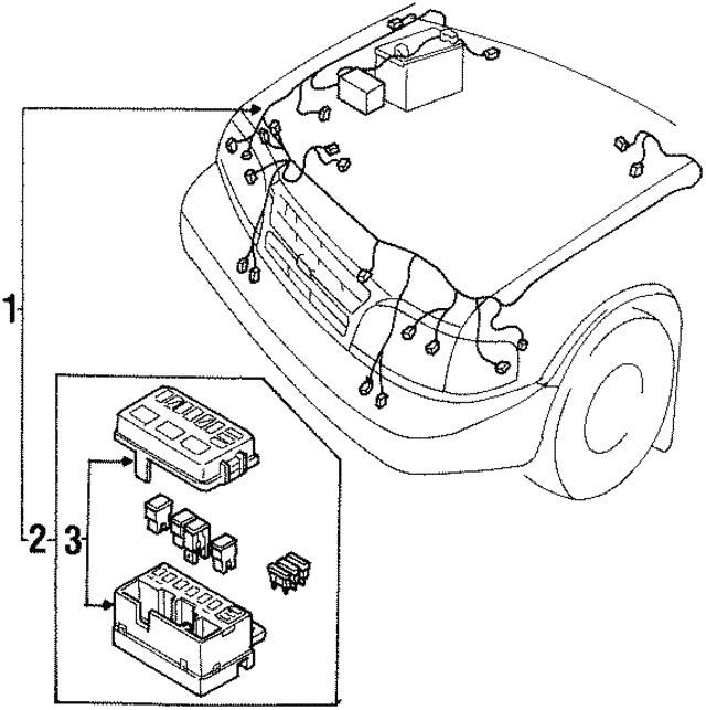

I finally got back from my trip and want to restart working on my car. I bought a supply of 15- and 10-amp fuses. I will try to pick up the troubleshooting looking for the short that is blowing the 15-amp main fuse where I stopped at the engine compartment fuse holder block. The last wiring diagram you sent should have the main relay and this 15-amp main fuse shares the same hot connection. So, I guess I should try to disconnect all other circuits and see if I can determine which circuit has the short. After the main fuse that keeps blowing. I need your advice, please. Thanks, Jimmy
