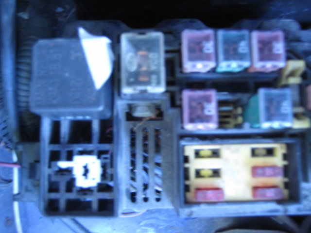

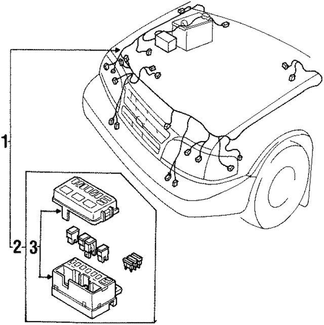

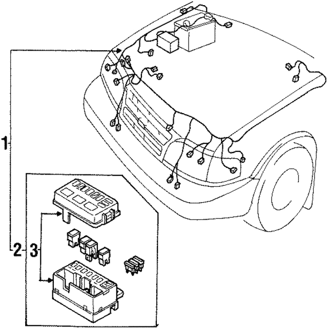

This is a part break out for the fuse box from Kia parts depot. no board shown?
Jun 29, 2022 at 7:44 AM
JIMMY MCPHERSON II
  • 26 POSTS

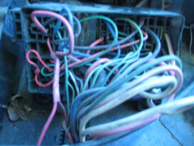

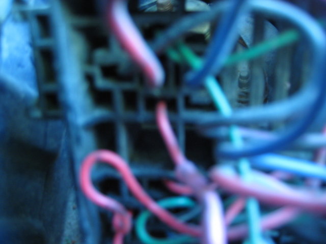

it appears to have been dismounted before as there is a retaining nut missing.
Jun 29, 2022 at 7:46 AM

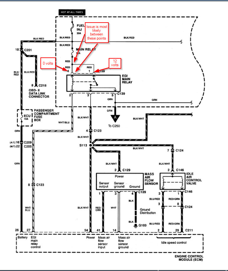

Okay. If these are wires, then can you remove the wire? I would get a really good picture of it so that you don't risk forgetting where the wire was but if you got the pins correct then I would just use these alligator clip wires and hook it up as a test.
Basically, it will allow you quickly find out if the fuse still blows.
Jun 29, 2022 at 10:45 AM

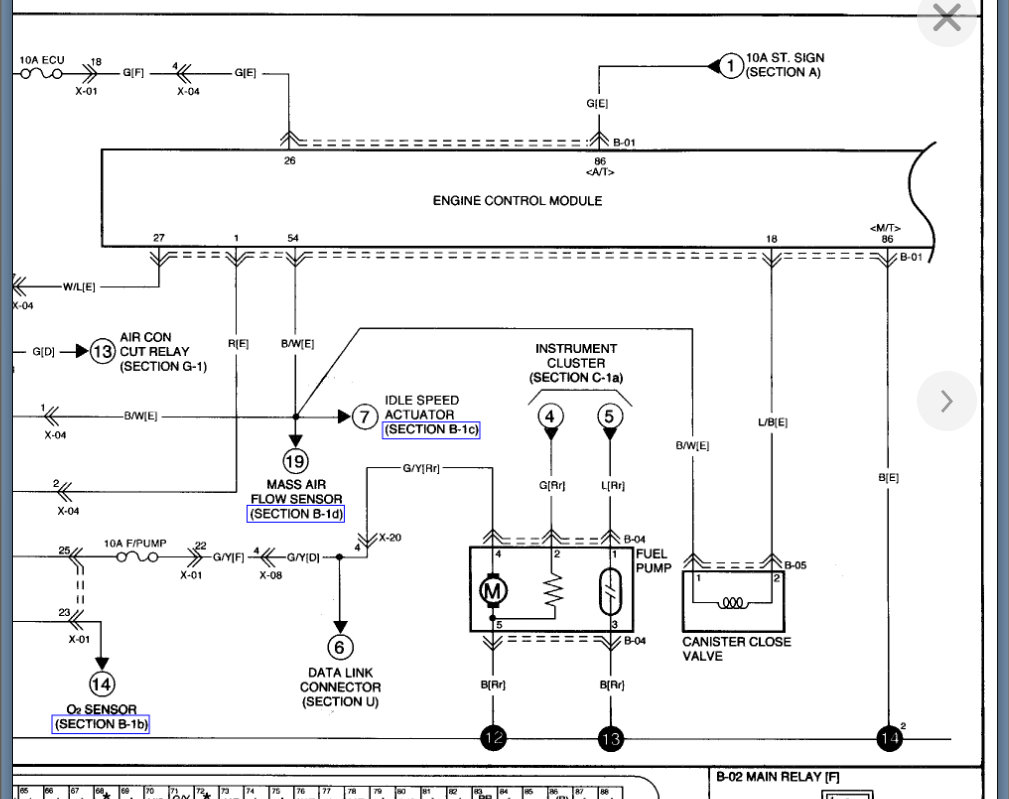

As for why this happened, I can't explain it. All I know is if that fuse is blowing something is shorted to ground and we just have to go where the testing takes us.

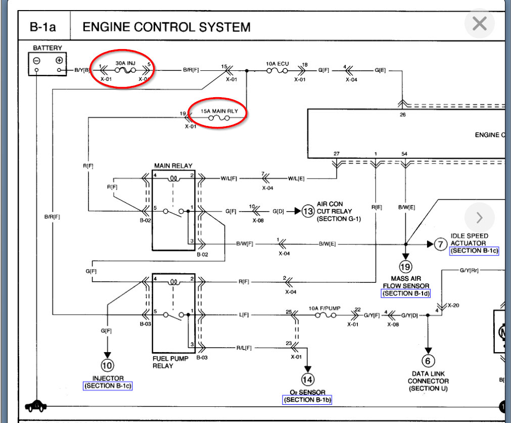

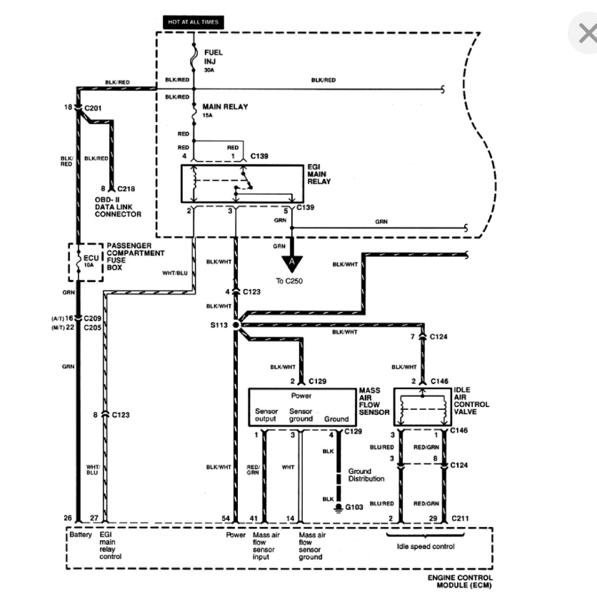

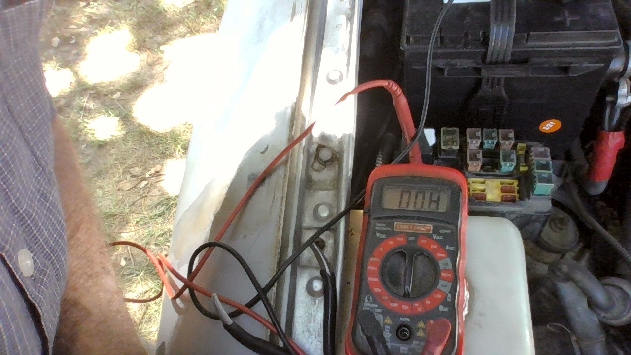

i finally got back from my trip and want to restart working on my car. I bought a supply of 15- and 10-amp fuses. I will try to pick up the troubleshooting looking for the short that is blowing the 15-amp main fuse where i stopped at the engine compartment fuse holder block. The last wiring diagram you sent should have the main relay and this 15-amp main fuse shares the same hot connection. So, I guess i should try to disconnect all other circuits and see if i can determine which circuit has the short. after the main fuse that keeps blowing. i need your advice, please. Thanks, Jimmy
