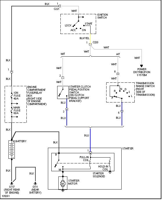

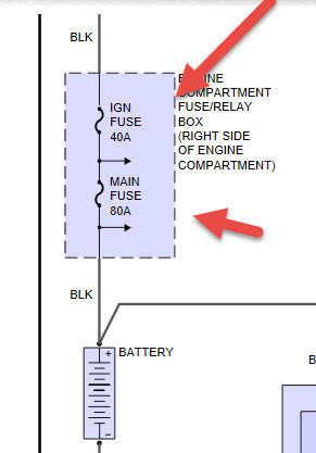

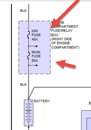

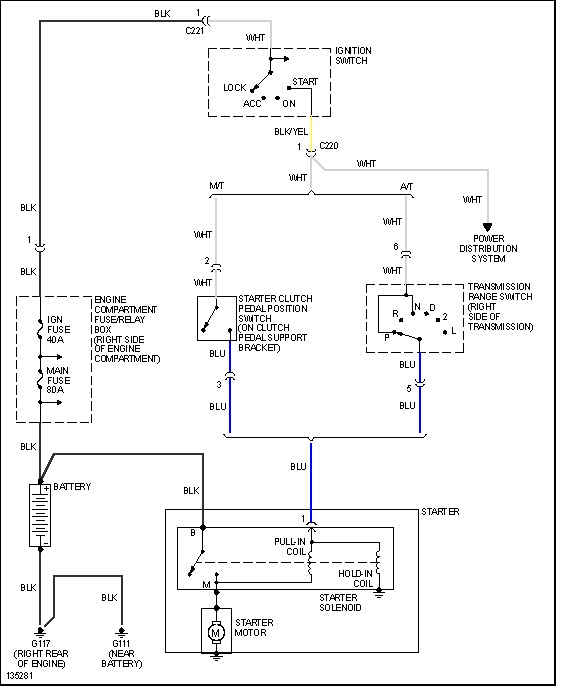

HMAC300
  • 48,601 POSTS
Check battery for condition including load test then check for master fuse blown. See picture and use a test light or volt meter to see if going through it or not. Then try resetting security system see link.
https://www.2carpros.com/articles/how-to-reset-a-security-system
