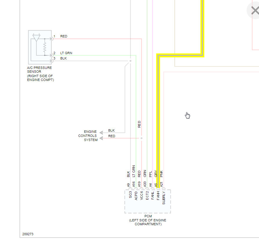

Overheating issue due to no fans running

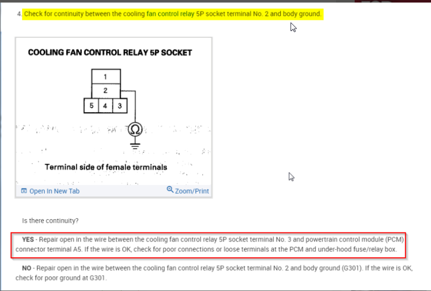

Unless it’s the PCM that you were originally talking about. If the PCM grounds out the coolant temperature switch, then that would make sense.
You could be correct but I am starting to wonder if we have a different issue that is causing the fans to be off. Take a look at this that I just found. I highlighted the two sections we need to check. Basically we need to hook up a gauge set and see what the pressure is on the high and low side.
Let's check the pressures of the A/C system and just make sure they are okay. If they are, check to see if the compressor comes on when you turn it on. if it does then the pressure switches are okay.

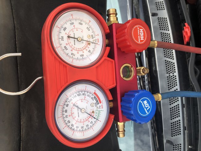

Well, the A/C hasn’t been working well in the last couple years. I never bothered to fix it because I hardly ever use it. I’m in Washington State, and it doesn’t get all that hot here. Anyways, I know that I probably have a leak in the condenser. I could tackle the A/C issue if you believe it is related to the issue I am having though.
Aug 17, 2020 at 3:40 PM
I am not convinced yet so I would not want to point you in that direction until we have a little more proof first. Plus there may be a way to trick it if this proves out if you don't need it.
Let's rent a gauge set from a tool rental just to see what the pressure is even though we can probably assume it is pretty empty.

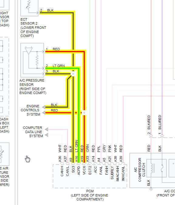

Okay. That is positive news towards the fan issue but the set back is your A/C pressure sensor is a 3 wire sensor that is wired to the PCM. That means it is not an on/off sensor. It actually has a resistor in the PCM and tells the PCM what the pressure is. That means we can't jump the switch and "trick" the PCM that the pressure is above the minimum. If it were a two wire switch then if the pressure is above the minimum threshold then the switch closes and the PCM just senses 12 volts and knows the pressure is not too low.

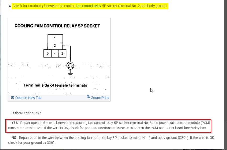

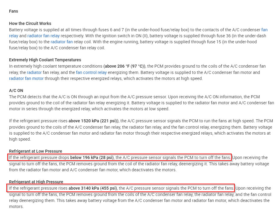

So this is what I would suggest: Get one of those refill cans so that you can get the A/C pressure above 28 PSI so the PCM will allow the fans to run.

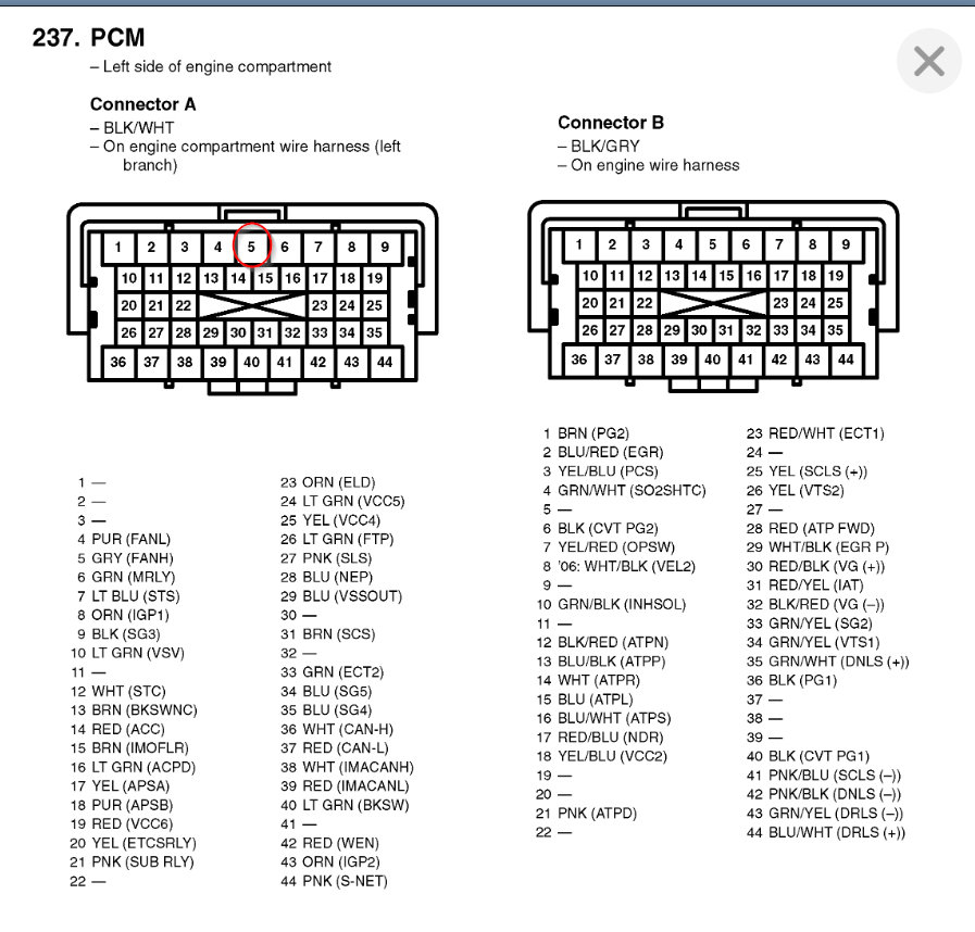

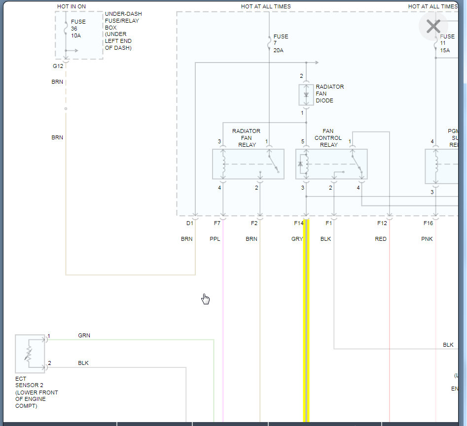

Take a look at the attachment and tell me if you read that the same way I do. The PCM will shut the fans off if the A/C pressure is below 28 PSI. If you agree, let me know what happens.

I decided to test the A/C system for leaks first to see how bad it is using a vacuum pump, and it’s pretty bad. It’s not holding pressure. I’ll have to just replace the condenser. I have it, the manifold gauge, and a pump, so I’ll be able to square away that issue pretty quick. I’ll target this weekend to find a block of time to get it done.

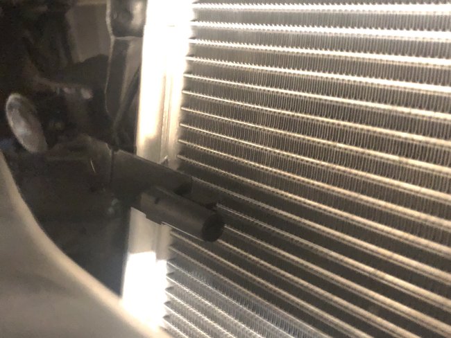

Okay. Replaced the condenser. Recharged the A/C to 35. Everything is holding good. Cold air coming out of the vents. Both fans are spinning. That has got to be an improvement.

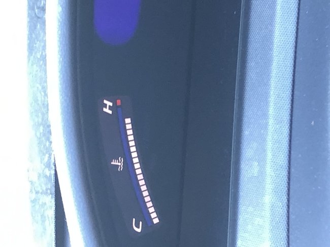

Took it for a drive, and after about 10 minutes, temperature drastically started to rise, and starts to overheat. I pull over, and it slowly goes back down to 1/3. Tried again, and same thing. Did not let it get that hot though. Figured over half, it is going to do it again.

Okay. Just to confirm, because this is a long post, originally your fans did not come on and the vehicle was overheating. Now after this repair to the A/C system the fans are coming on but the vehicle is still overheating?
If this is the case we have made progress. Now let's look at just the cooling system. Let's try something to try and narrow this down. If you start the vehicle after making sure the coolant is full and just let it idle does it overheat? The fans should be on and clearly it should not overheat. However, if it overheats just idling then I suspect we have restriction in the cooling system. Let's do this and go to the next step.

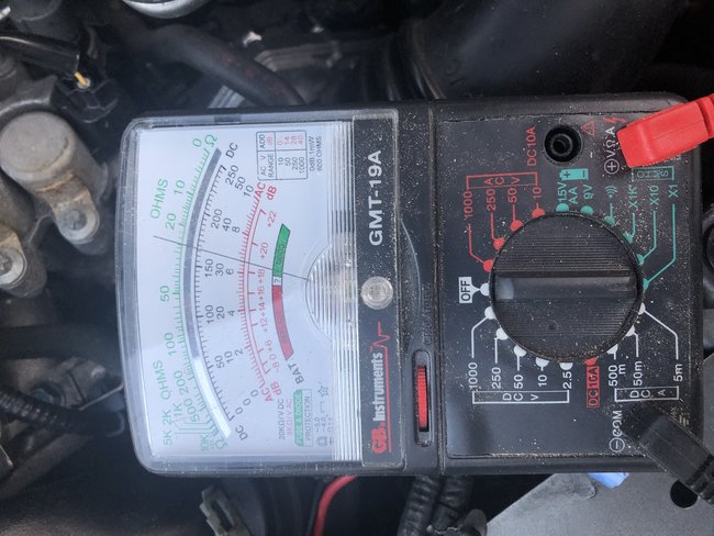

No overheat at idle. I’ll confirm tonight if the fan comes on eventually just by idling. Matter of fact, I’ll try to jumper the temperature fan switch again
Is there anything I can check through again with a meter through the fuse panel?

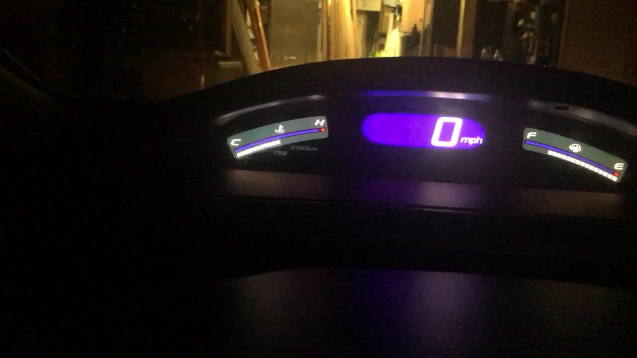

Okay, so it isn’t the thermostat. I replaced it with a fail-safe thermostat, and I am still getting an overheat issue.
This might be interesting and maybe give you more clues. When it overheats, the heater is now getting cold. Got it back home, and used a spill free funnel again, and I notice that when the radiator fluid gets hot, it just keeps expanding and rising the liquid level of the funnel and the heater still blows cold.
Also, after it gets to 3/4 where I have to shut it down, after I let it sit for a few minutes, it’s back to under half and the heater starts to blow hot again. I Just replaced the water pump, so that cannot be it. I’m kinda stuck here.

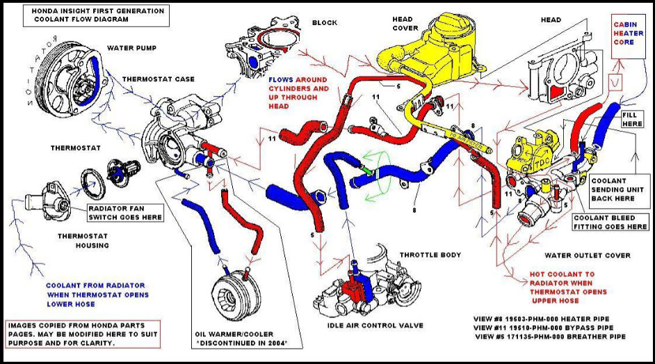

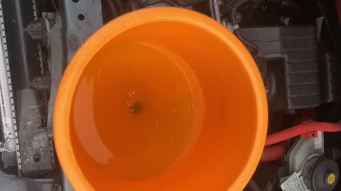

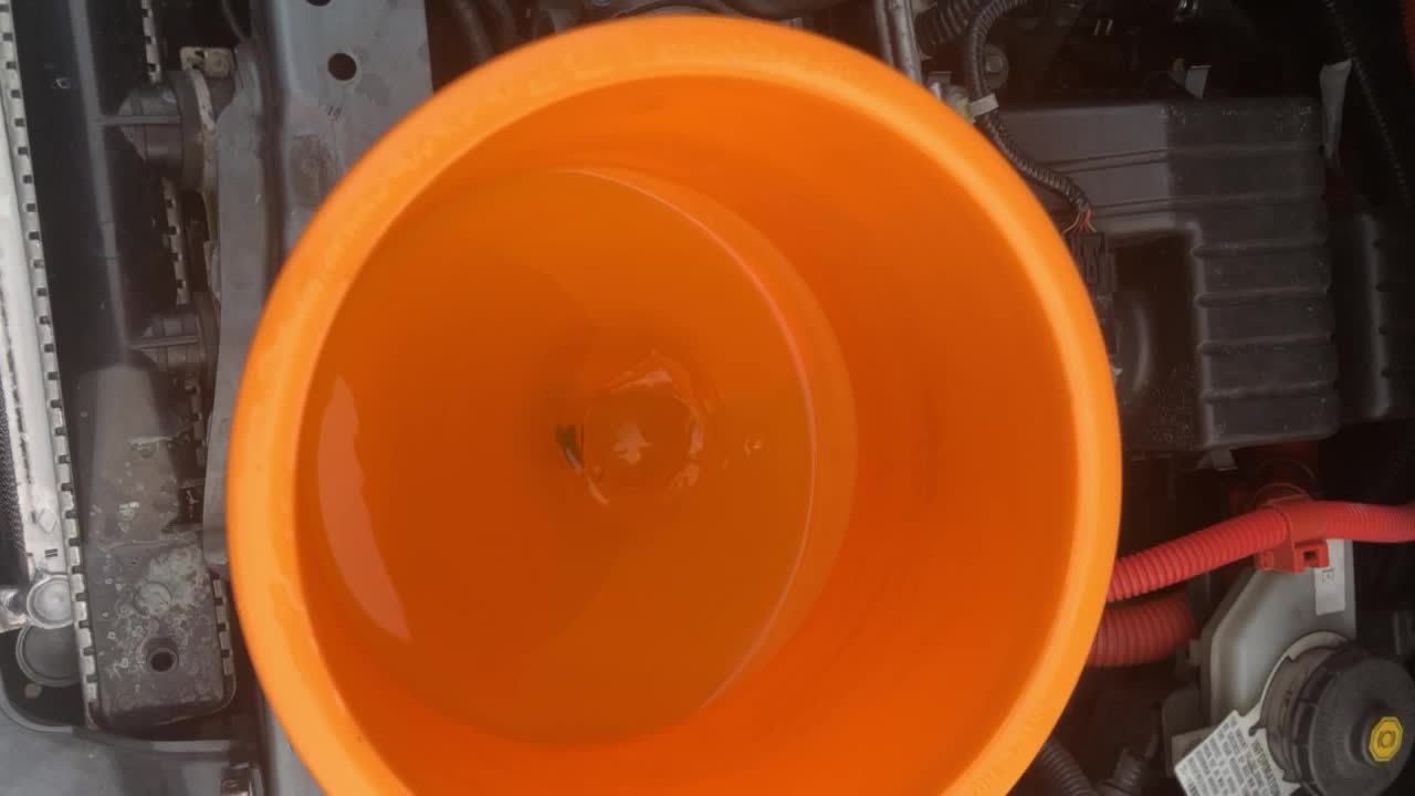

So, that coolant hose that goes from the back of the engine to the firewall is next to impossible to get off. I couldn’t do it. I just ended up splicing it, and will run two clamps and a coupler when I’m done. Anyways, the issue still is there.
Here’s something interesting though. After about 20 min of running, there’s still air in the system. Something else, if you look, it seems like the air coming out isn’t being replaced by coolant. The coolant level isn’t going down.
Unless you have any ideas, I am starting to think there is a small crack or something in one of these hoses that is introducing air. The bumbling isn’t very much. I am wondering if that’s possible without any visible leakage?
Another interesting thing when I put the heater core hoses back into the system, when I turn on the heater, there is a rise in air coming out of the system. When I turn off the heater, it goes down to that level shown in the video, and bubbles slowly just like that.
Here’s something interesting though. After about 20 minutes of running, there’s still air in the system. Something else, if you look, it seems like the air coming out isn’t being replaced by coolant. The coolant level isn’t going down.
Sep 18, 2020 at 8:43 AM
That is interesting. Clearly the air bubbles are air so it is either from compression (head gasket) which I think we did a block test. The fact that the bubbles increase when you put the heat on frankly doesn't help because all you are doing is pushing air over the heater core. Unless this is where the leak it, that doesn't make sense.
Let's confirm that you have done a block test and then did the air bubbles come out when you bypassed the heater core?

Okay, update: I bypassed the heater core again, and ran it for a couple days. It is not overheating, however, the expansion reservoir is overflowing. The top radiator hose is very hot, yet the bottom radiator hose is cold.
I already put the coolant system under pressure, and it held. No discoloration or debris in the coolant. No discoloration or coolant in the oil.
It seems to me that the coolant is getting so hot, it’s expanding and overflowing the reservoir. I’m sure I would overheat eventually if I kept running it for longer periods of time. When I am getting steam under the hood, I stop, even when that happens I am only 1/3 on the temperature gauge. I replaced the water pump already though. I’m stuck.

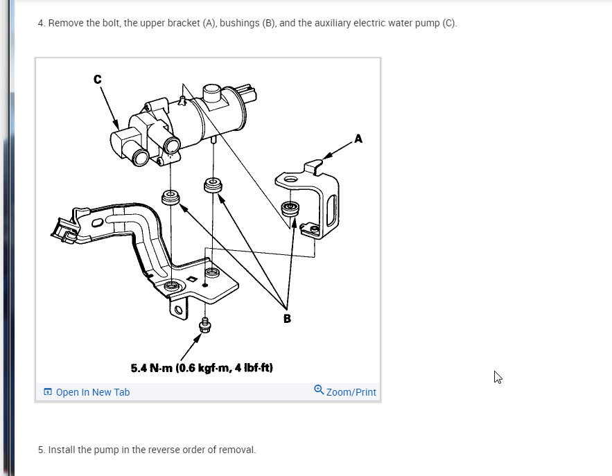

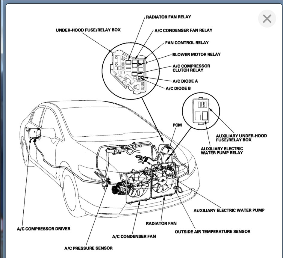

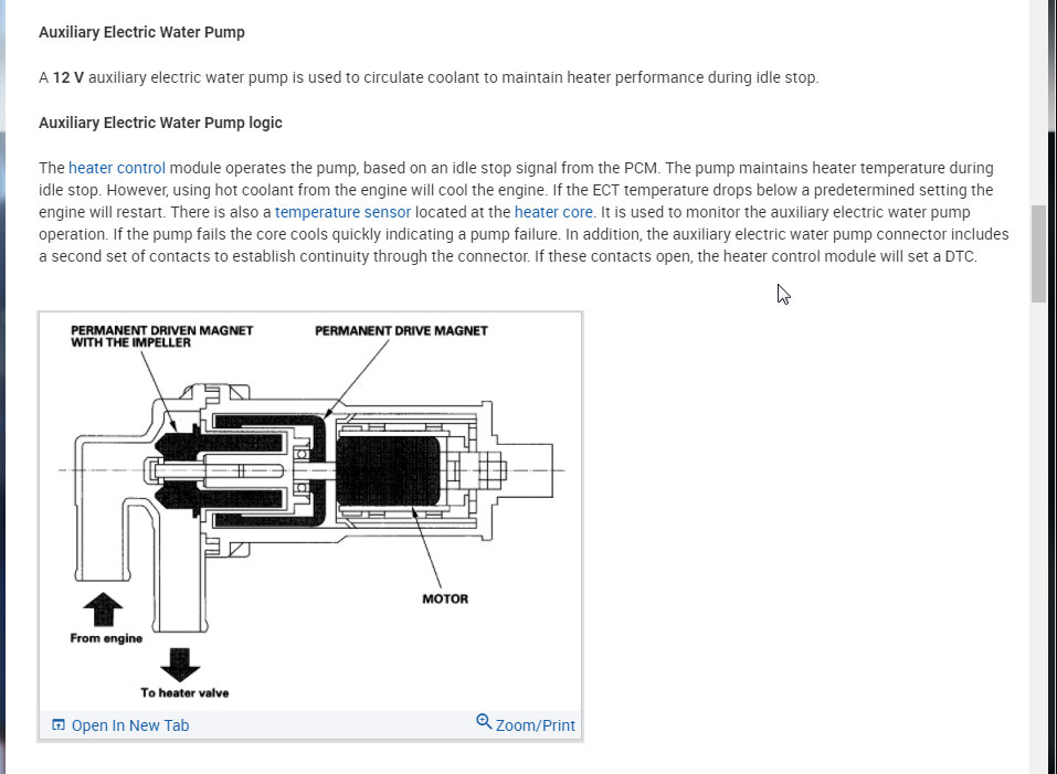

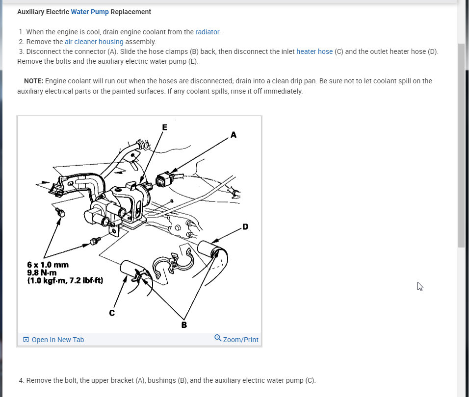

Also, another thought. Is there an “auxiliary water pump” on this car? I had a friend tell me that his Beamer had a coolant flow issue, and thought it was the water pump, but ended up being an auxiliary water pump. Don’t know if that applies to 8th gen 1.3l hybrid motors or not.
Sep 25, 2020 at 8:53 PM
Actually you do. I attached all the info for it. I didn't think that you have to have that due to it being a hybrid and it circulates coolant when at a stop and the engine is off (in hybrid mode).
Also, the coolant does not expand. Air expands when it heats up so that is what is pushing the coolant out so we still have an air issue but I didn't think to focus on the hybrid system. Let me know what you find with this because this may explain why the lower hose is cold.
Sep 27, 2020 at 1:28 AM
So how does the cooling system work on this car? What is the path of flow for the coolant?
