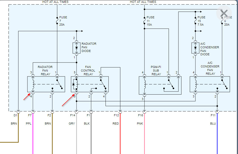

Both fans are not coming on. I have tested both fans directly and they both work. All fuses check okay. I have replaced the fan switch thinking that was it, but it was not. Just a bad conclusion on my part. Relays are good. So, this is where I am at. Switch is good. Fan is good. When I jumped the fan switch connector, I get nothing. The one pin out has connectivity to the blue wire that leads to the fan. The other pin out on the switch connector seems to have continuity when I have the key in the on position. I tested with a meter, negative on the battery, positive on that pin and I did get a reading. I did not get a reading when the key was in the off position.
I have done little testing on the A/C fan side. I have confirmed the fan works. I also jumped the 1 and 2 pins and the A/C fan did come on. That is the extent of my testing.
Jun 28, 2020 at 2:48 PM

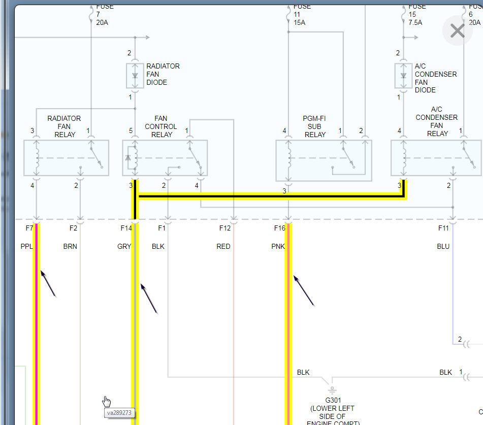

Take a look at the wiring diagram. When you say you jumped pin 1 and 2 and the fan came on, I assume you mean of the radiator fan relay?
Also, when you turn on the A/C does your condenser fan come on at all?
These are only connect or related through the PCM. Basically the PCM grounds both relays to turn the fans on. So we need to turn them all on and test the wiring coming from the PCM. I suspect you don't have power on that wire. Which means either the PCM is not functioning or something is telling the PCM that the fans are not needed. This is why we need to confirm that neither fan is working with the A/C on. This would point away from an ECT issue.
Let us know what you find with this info and we can go from there. Thanks
Jun 29, 2020 at 8:32 AM
MAEMOND
  • 54 POSTS

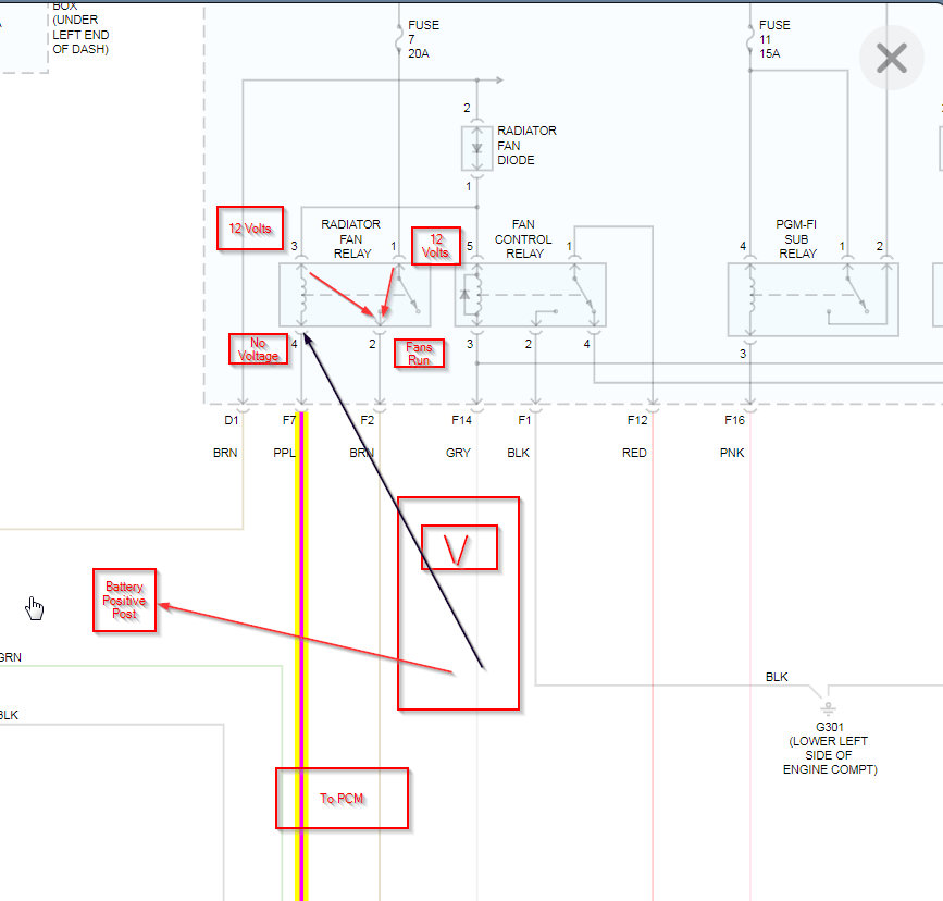

When I turn on the A/C, no fans turn on. When I tested the relay outlet for the radiator fan, pin 1 had power. Pin 2 goes to the fan and runs when I jumper pin 1. Pin 3 has power when key is in the on position. Fan runs when pins 2 and 3 are jumped. Pin 4 no power.
The relay with the A/C and radiator symbols on it, all I have done is jumped pins 1 and 2 to rule out that the fans do work.

Sounds like you already did. However, the way to confirm this is to test to see if the PCM can ground a 12 volt circuit. Remove the relay and put your negative meter lead on the 4 terminal. Then put the red lead on the positive post of the battery for the 12 volt source. Then turn the engine on and AC on so that both fans will come on. You meter should read 12 volts if the PCM is able to ground the circuit. If not, then PCM is suspect.

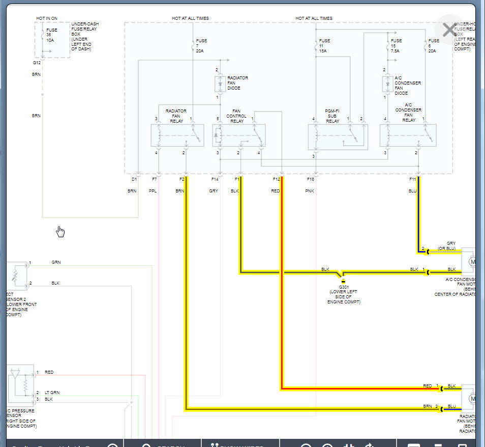

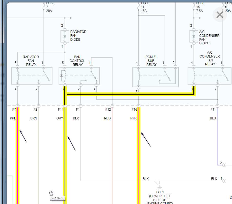

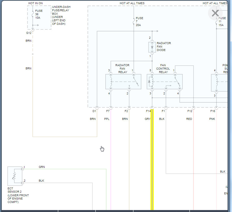

You are correct that you have 3 relays. However, the PCM only actually grounds two of the relays because the Fan Control relay and the AC condenser relay control sides are tied together on the same circuit from the PCM. The third wire coming from the PCM (First wiring diagram with the black arrows) is to ground the PGM relay.

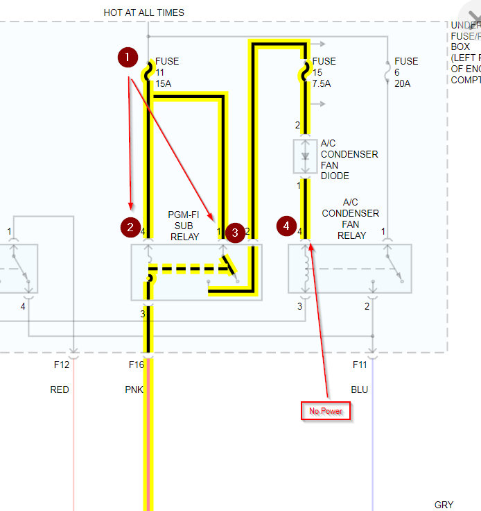

To address what you are seeing with not having voltage on pin 4 of the AC fan relay we need to look at the second wiring diagram.
The power starts at where I added number 1. We need to check fuse 11 to make sure you have power there. Then follow power down to number 2. The PCM grounds this relay on terminal 3 of the PGM relay. When this is grounded, the relay closes and power goes from terminal 1 of the relay to terminal number 2 of the relay (where I added number 3). It then goes to fuse 15 and then through the diode finally to number 4 that I added (also terminal 4 of the AC relay) which is where you are not getting power.
So you need to go backwards through this circuit to find where you have power and where you do not.
Let me know if you have questions. Thanks

I am sorry. I think I misread this. You need to put your red lead on the terminal number 4 of the A/C relay and the black lead of the meter on ground. Let me know what the voltage is with the engine running and A/C on.

I have power.

A/C on, ignition in the on position, no fans are on though, but I do hear the blower motor running. Positive on pin 4 of A/C only relay socket, negative on battery, I have connectivity.
Jul 1, 2020 at 4:34 PM
Okay. Based on this it appears the PCM is the issue. It appears you have proven out the sensors and relays so if the fans are not coming on then I suspect the PCM is not grounding the relays.
Let's try to prove this out. Remove each of these relays that I am pointing to in this diagram and then put your red lead of your meter on the battery positive lead and then put the black lead on the relay terminal the arrow is pointing at one at a time and turn the engine on and A/C on. You should have 12 volts on the meter.

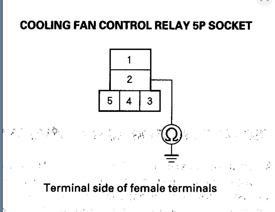

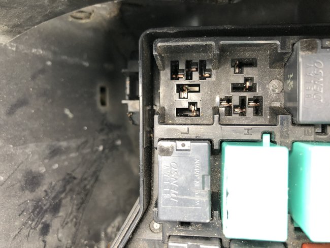

The pin configuration isn’t in the same order as what I am looking at.
Which one would be pin 3?
Jul 3, 2020 at 7:49 AM

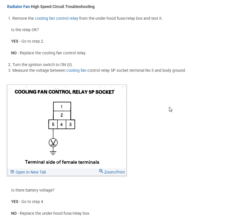

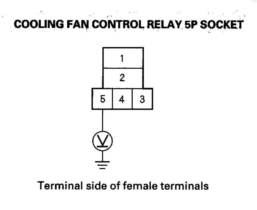

I attached the pin out for the fan control relay. Just test this one and we can go from there.
After you do that, let me know what you get with this info as well. Turn the key on and remove the relay. Test voltage between number 5 and ground (diagram 1 shows this test). Did you get 12 volts? If not, replace the relay box.
If you did get 12 volts check continuity between number 2 and ground (second diagram shows this test). Let me know what you get with these and we can figure this out. Thanks

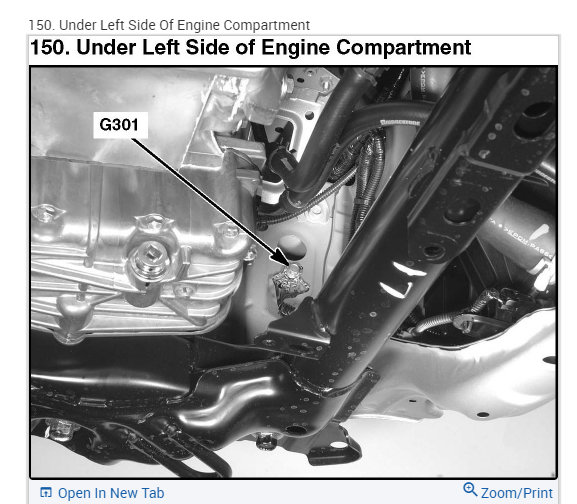

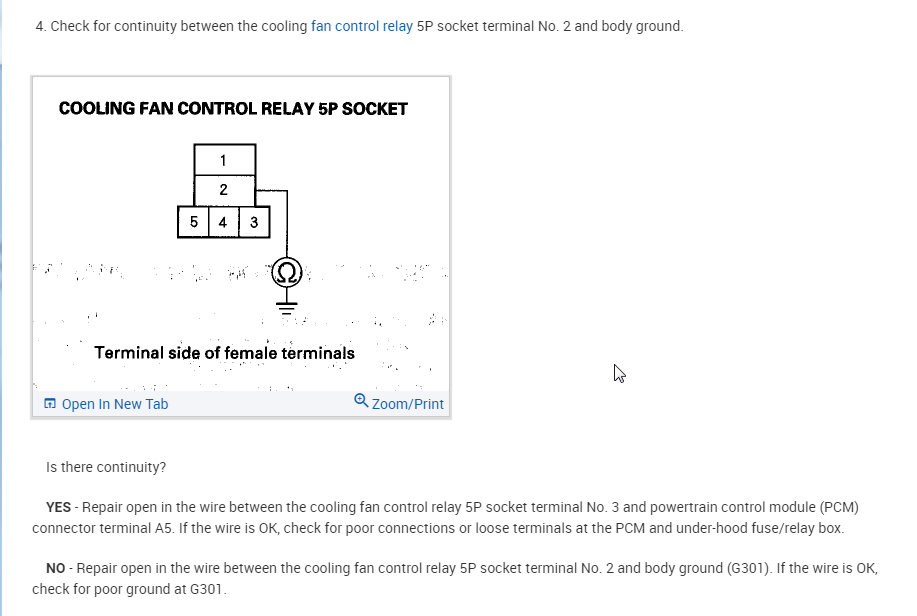

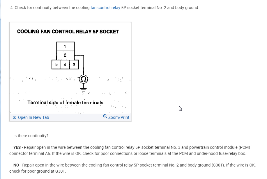

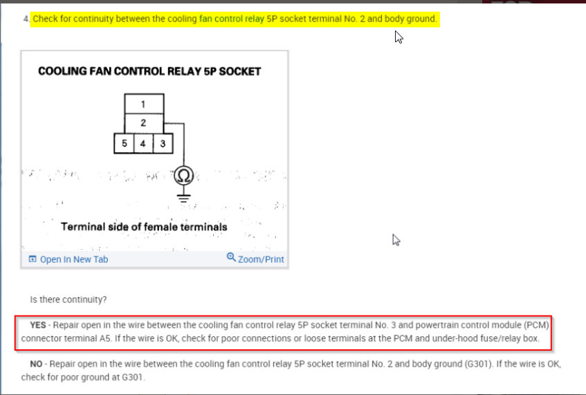

Okay. Now on the second measurement, we need to actually check for continuity (ohms) from Pin 2 to ground. If you have OL or an open circuit on your meter then that is the issue. We need to go to ground G301 and make sure it is good and tight. Then if it is, remove it and ohm out the wire from pin 2 to the connection of the ground wire. I suspect you will have an open circuit if the ground was tight.
I attached the location of G301. Let me know what questions you have. Thanks

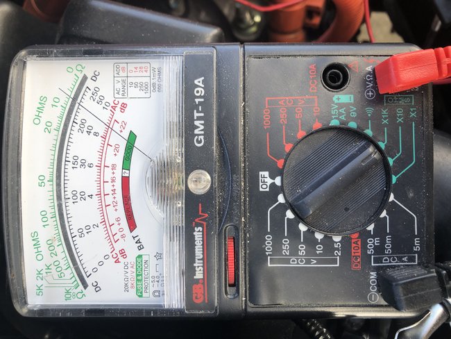

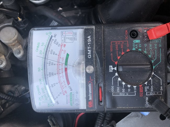

This is the reading I got. Doesn’t seem to matter which setting I use. X1, x10, or x1K.

Everything looked fine with the ground wire. It has many wires that fit into one ring mount fitting to the frame. I cleaned and sanded the frame area where the ground mounts, and cleaned and sanded the connector mount, and re-connected it.
I re-tested with the ignition on, for voltage. Positive lead on positive battery, negative lead on pin 2 of fan relay. I have a voltage reading.

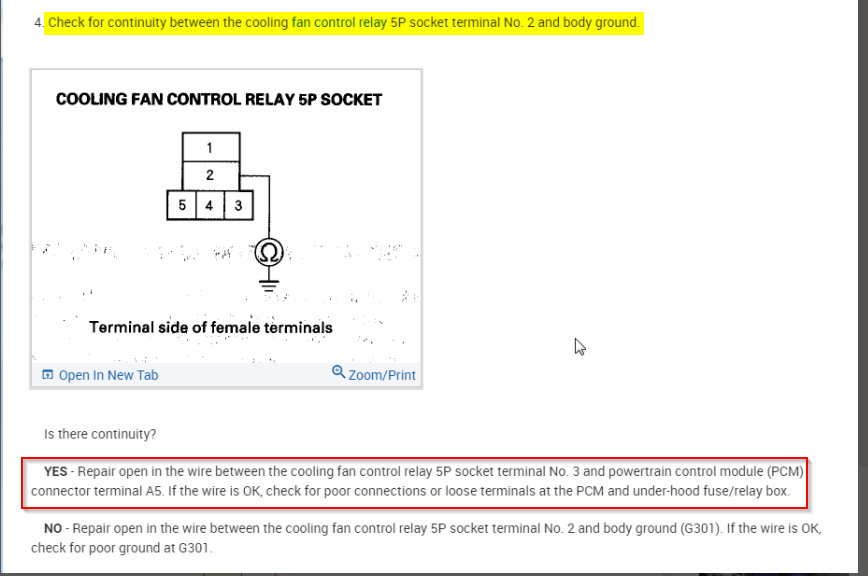

Okay. Based on those resistance readings you have 5 ohms of resistance from terminal 2 to ground. That means on the attachment, you performed the highlighted step and the result would be what I circled in red. That means we need to check for an open wire from this connector terminal 3 to the PCM or a connection issue if the wire is not broken or grounded.
Does that make sense?

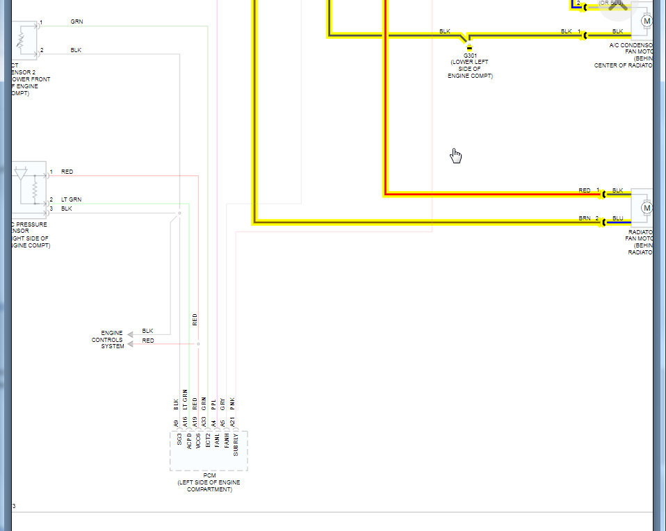

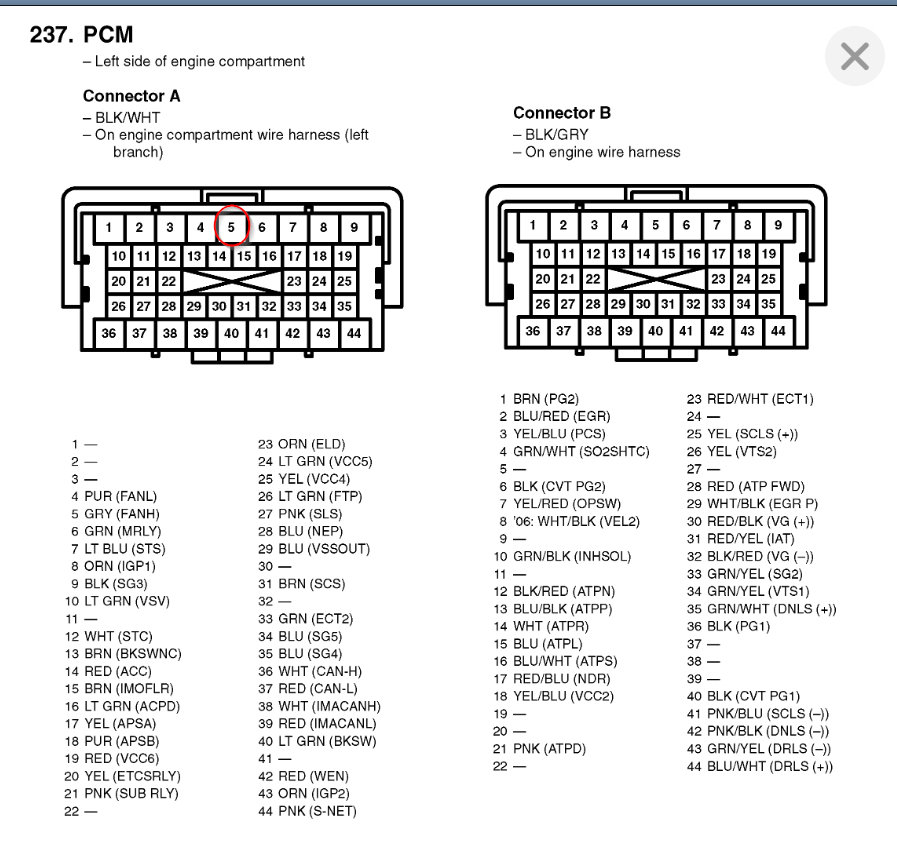

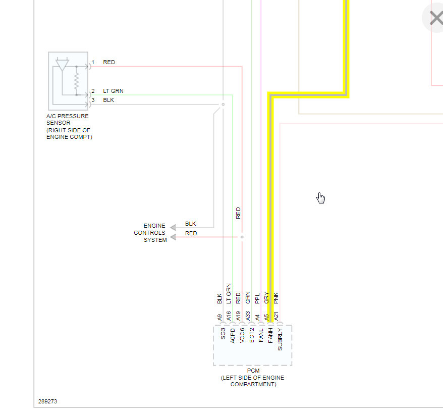

What pin is on the PCM side that I am looking for? Could I do a continuity test from pin 3 of the blower fan relay to that particular pin that goes to the PCM to determine if the wire is okay, broken or grounding out?
Jul 14, 2020 at 4:36 PM
I attached the diagram from the relay to the PCM. Yes, you can do a continuity test on that wire from end to end however, just understand that will only test the wiring and not the connection/terminal ends. So if there is a spread terminal you can have an open circuit. If the wire is okay, then it is surely a terminal issue.

So if you have 5 ohms then you have continuity. That sounds high to me but it says to just check continuity and you have it. This means your issue according to the test, is from the number 3 terminal to the PCM or its terminals. See the attached.

Do you have a better diagram for locating that A5 pin on the PCM plug? I’ve been trying to track it down, and I am having a problem finding it. I think it would be easier for me to trace it back from the plug.
Jul 27, 2020 at 7:24 AM
I attached the connector view. Let me know if you still need help and we can find some more detail but this should help find it.
