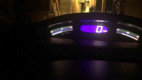

Just to note, I was idling with A/C on. Both fans going. After a while, the temperature got to the middle, and I could hear the fans kick on high for a moment, then shut off. Then come on again. Temperature gauge doesn’t move.

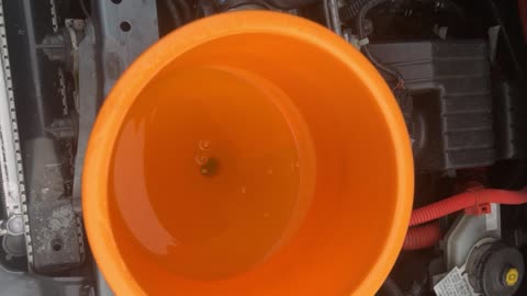

This might be interesting and maybe give you more clues. When it overheats, the heater is now getting cold. Got it back home, and used a spill free funnel again, and I notice that when the radiator fluid gets hot, it just keeps expanding and rising the liquid level of the funnel and the heater still blows cold.

Here’s something interesting though. After about 20 min of running, there’s still air in the system. Something else, if you look, it seems like the air coming out isn’t being replaced by coolant. The coolant level isn’t going down.
Unless you have any ideas, I am starting to think there is a small crack or something in one of these hoses that is introducing air. The bumbling isn’t very much. I am wondering if that’s possible without any visible leakage?

So, here is an update: I found out the constant air bubbles were from the seal of the connector for the funnel. Added an extra rubber washer and no problems there.

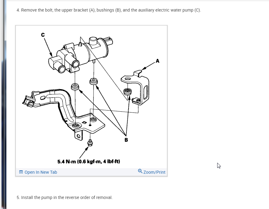

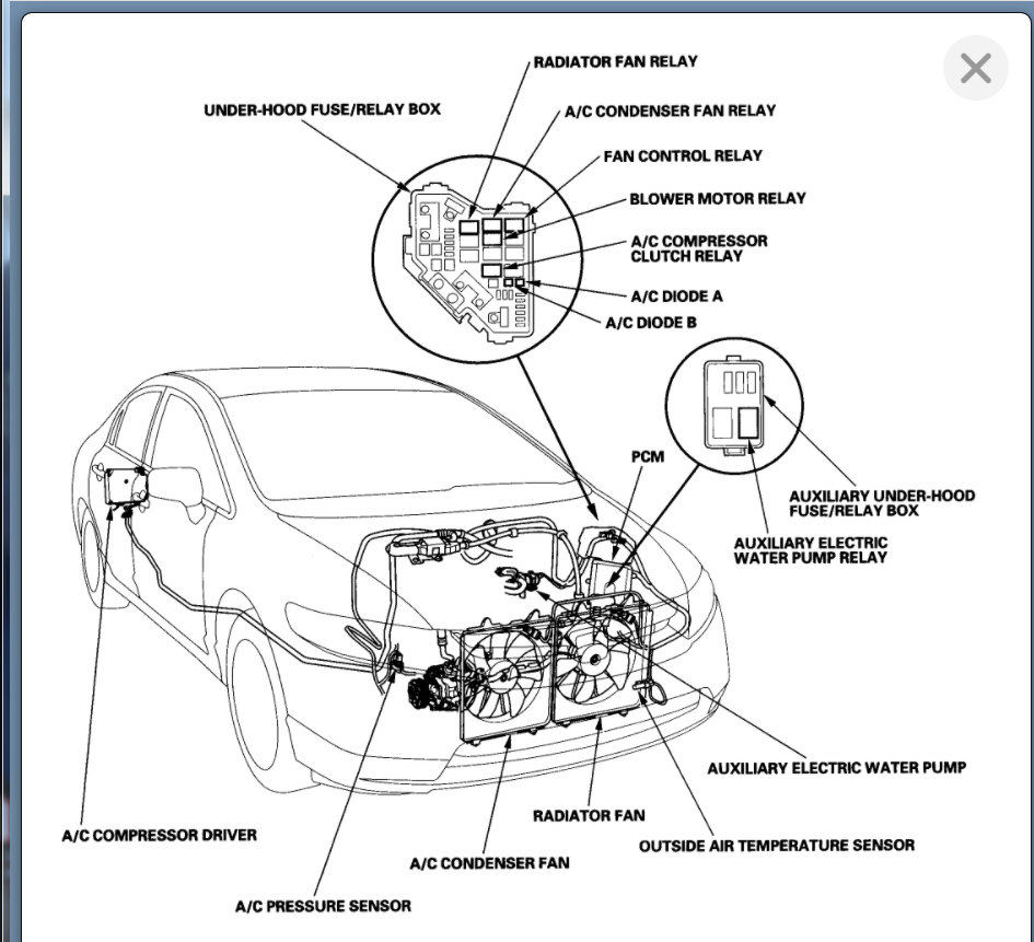

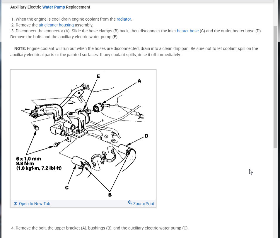

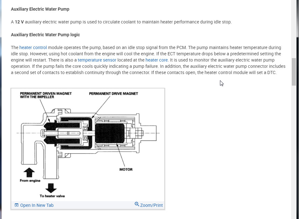

Also, another thought. Is there an “auxiliary water pump” on this car? I had a friend tell me that his Beamer had a coolant flow issue, and thought it was the water pump, but ended up being an auxiliary water pump. Don’t know if that applies to 8th gen 1.3l hybrid motors or not.
Saturday, September 26th, 2020 AT 3:53 AM
Actually you do. I attached all the info for it. I didn't think that you have to have that due to it being a hybrid and it circulates coolant when at a stop and the engine is off (in hybrid mode).
Also, the coolant does not expand. Air expands when it heats up so that is what is pushing the coolant out so we still have an air issue but I didn't think to focus on the hybrid system. Let me know what you find with this because this may explain why the lower hose is cold.

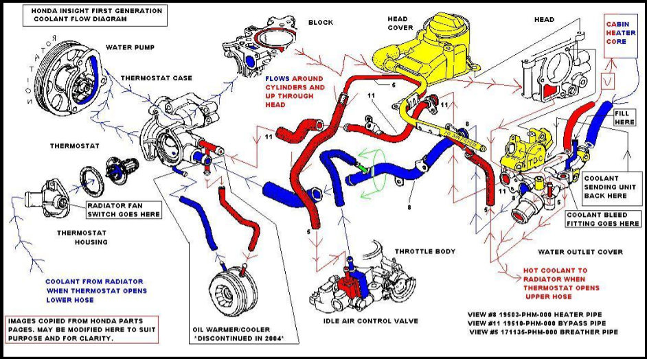

So how does the cooling system work on this car? What is the path of flow for the coolant?
-1
Monday, September 28th, 2020 AT 1:47 AM
It is not any different then other Civics but it just has the addition of the electric pump for when the engine is off. I attached a diagram from another Honda but again, the only difference is the electric pump.
