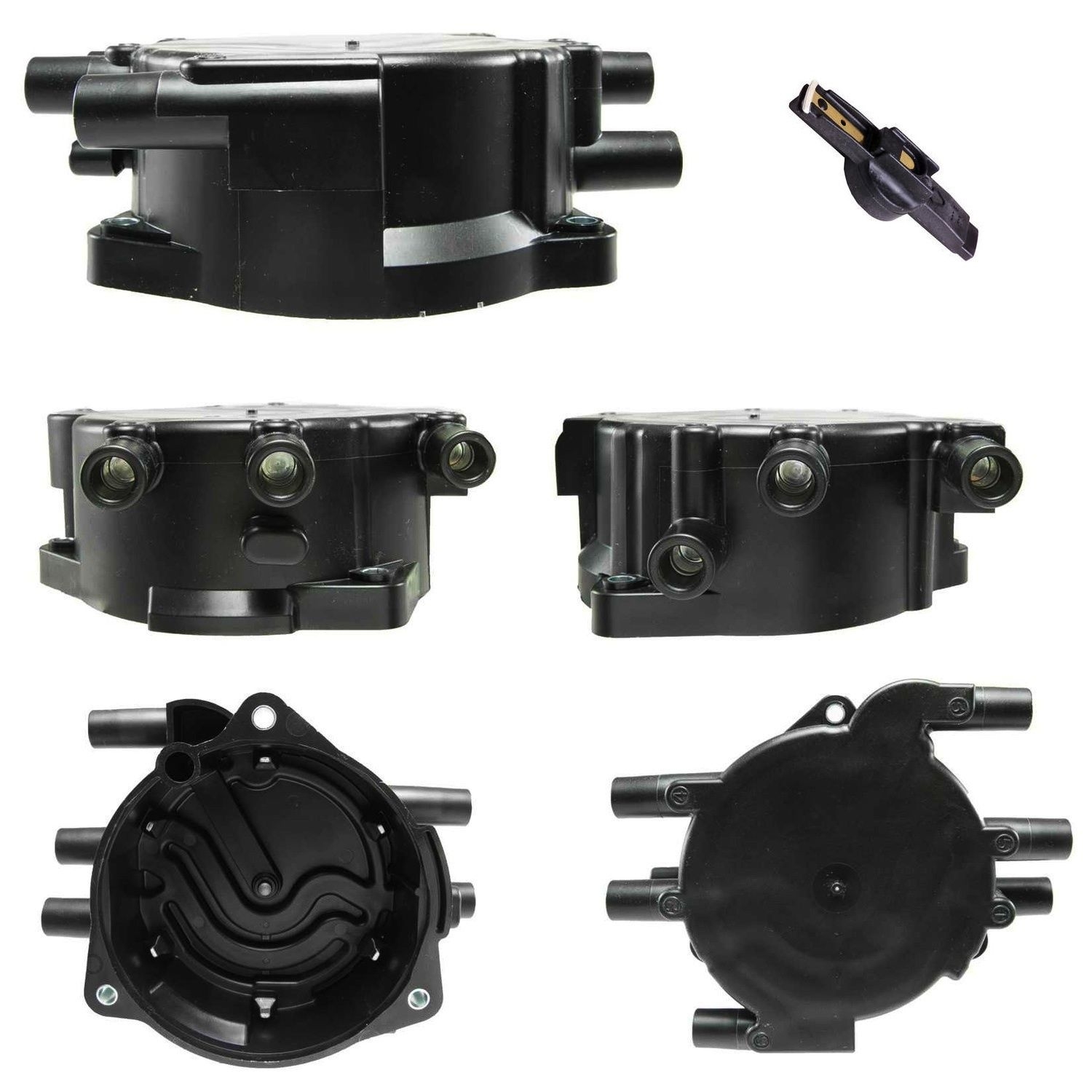

Yeah, with #1 being on the passenger side.
Are you sure the firing order is correct though?

Is the towers on the distributor cap marked with numbers?

I have got to head out here soon, I have got a doctor's appointment, will be back around 5:00 pm eastern, but I have a few minutes before I have to go.
Check that firing order and make sure you have a good spark at all six, no weak sparks.
The firing order is 123456.

This one does in the lower right.

Are you sure the spark plugs are not smelling like gasoline? They can easily foul out again pretty quickly if for some reason you had no spark.
Did you just get done cleaning them when you told me so or did you just say that cause you cleaned them before?
Are these new or old spark plugs, are they gapped correctly and do the spark plug wires snap onto them good? In other words, if they are new, are they the proper distance out of the head so them spark plug wires can reach them, cause I do see a unusual setup with them spark plug wires.
It has to be something with the spark plugs cause you have everything else, spark, compression, fuel (starting fluid) and the correct firing order and a good spark.
Maybe, just maybe you should try some new spark plugs if you haven't already.
Pull 1 anyhow and smell it if it smells like gasoline.
