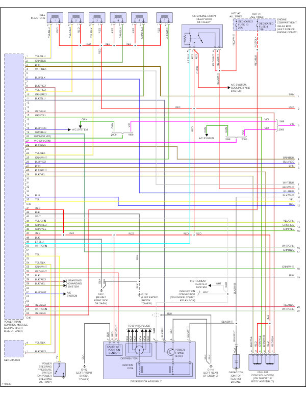

Car was purchased not running. Previous owner said it ran a little hot before being parked a year ago. It has fire on all six cylinders, getting fuel, and has compression.
Timing looks good.
Could it be the alarm? There is no green light at all with key symbol on panel, ever. Could the car get spark and the other two if alarm was triggered?
My machine gets no signal at all when hooked up. Very strange.

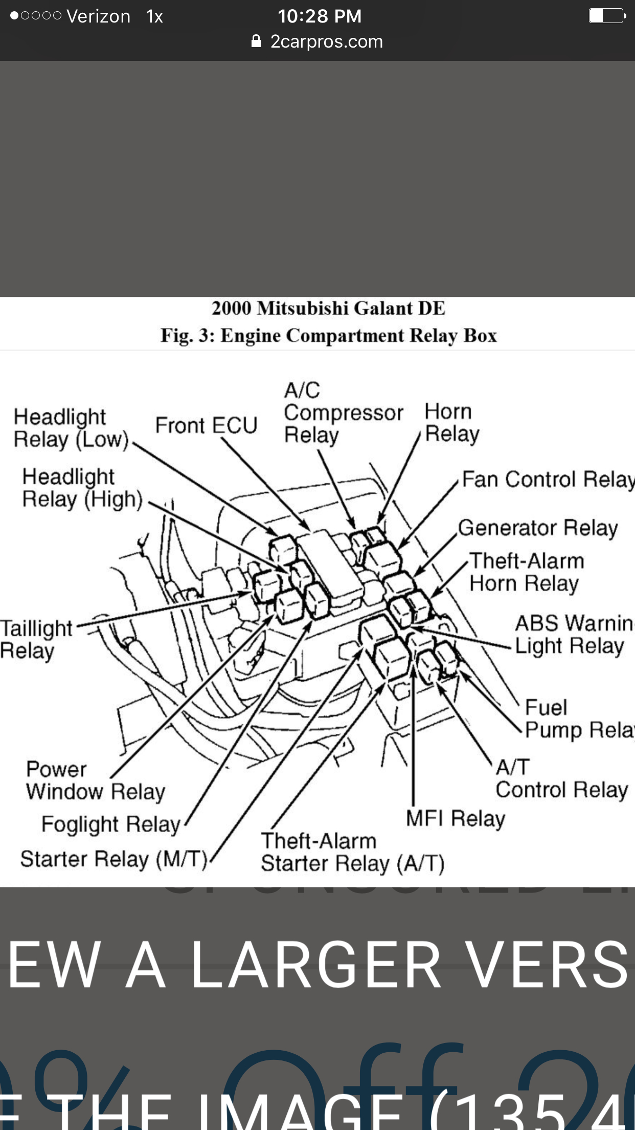

About the only thing you are missing is fuel injector action. So, to begin, check the "dedicated fuse #13" in the engine compartment relay center, left side under hood. It should be hot on both sides of the fuse all the time. If it is, and you have no voltage to the red wires at the fuel injectors with the key on run, try a new MFI relay or swap one in that will fit and the same type. It is located on that engine compartment relay center.
If you do have voltage to the injectors, then you must be missing the pulse, so check the ECM fuses. That may also be why you get a scan tool or code reader error not connecting. Check the "dedicated fuse #4" it powers the ECM. It is also in that engine compartment relay center. The other power feed is the same one as that "dedicated fuse #13" in the engine compartment relay center.

The 13 fuse has no power nor do a few others.
Monday, December 25th, 2017 AT 9:37 PM
RUSSELL MONTAGUE
  • 31 POSTS
I have tried the cleaning spark plugs and the fluid, nothing.
The fuses are not getting enough juice maybe? # 13, 14, 4, 16, and also I pulled the front ECU and it shows a strong glow on the test light for the first and second set of prongs, but the third barely lights up my test light? Each of the injectors are getting power, and the pump relay is getting power. Any idea why those fuses may be getting no power? And not enough power?
Tuesday, December 26th, 2017 AT 5:42 AM
PATENTED_REPAIR_PRO
  • 1,853 POSTS
That sounds like a short circuit within that engine compartment fuse relay box. They are all a direct feed right from the battery positive post. If just a few have no or low voltage and some have 12 volts, then obviously the power is making it to that box, it is just not making it all the fuse socket within the box. Most likely there is some shorted or melted parts inside that box.

No, some fuses only light up when the key is on start, but most of those fuses the key does not have to be on at all.
The ECU or PCM as it is called nowadays has a few power feeds. They are pin 66 a red/black wire, that comes from dedicated fuse #4 in the engine compartment relay box. Then there is pins 41 and 47, 2 red wires which are spliced together and come from that MFI relay and before that dedicated fuse #13.
They all should have 12 volts, with the key on run. Although the fuses are hot all the time with 12 volts.
Some of them you are checking at the PCM might be the ones that are only supposed to have 5 volts, like to power sensors. That may be why they appear low, but that is normal.
Tuesday, December 26th, 2017 AT 6:41 AM

I think we are talking about the wrong fuse #13.
There is a dedicated fuse #13 in the underhood relay center that is for the MFI relay and the fuel injectors, as well as the PCM and numerous sensors.
Then there is the multi-purpose fuse #13 in the junction box, behind left side of dash, that is for the malfunction indicator lamp. Is that the fuse #13 you are referring to or the one under the hood?
Tuesday, December 26th, 2017 AT 7:03 AM
PATENTED_REPAIR_PRO
  • 1,853 POSTS
The fuse feeds the fuel pump relay and then the fuel pump relay feeds the fuel pump. There is no fuse in between the relay and the pump.
