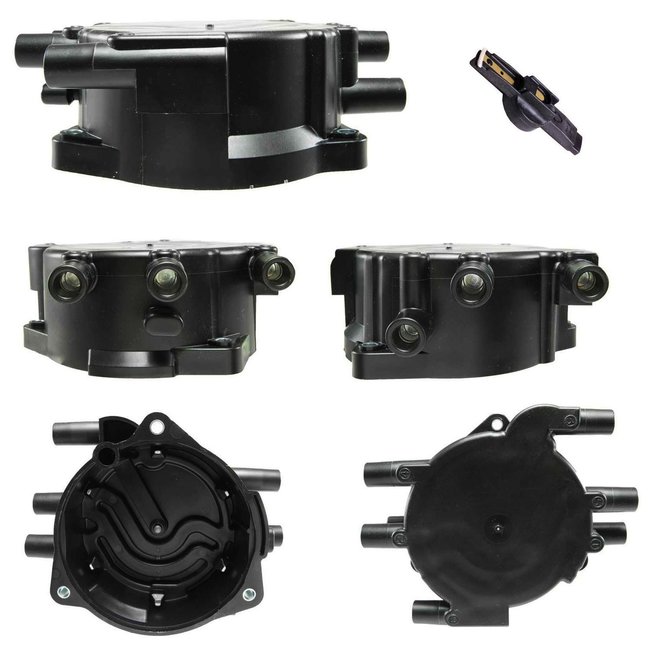

PATENTED_REPAIR_PRO
  • 1,853 POSTS
Is the towers on the distributor cap marked with numbers?
Dec 26, 2017 at 3:11 AM
PATENTED_REPAIR_PRO
  • 1,853 POSTS
I have got to head out here soon, I have got a doctor's appointment, will be back around 5:00 pm eastern, but I have a few minutes before I have to go.
Check that firing order and make sure you have a good spark at all six, no weak sparks.
The firing order is 123456.
Dec 26, 2017 at 3:16 AM
PATENTED_REPAIR_PRO
  • 1,853 POSTS
This one does in the lower right,
Dec 26, 2017 at 3:31 AM
