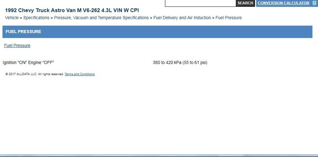

I went to work it quit running on me but started back up. A couple of days later it did it again. I was leaving my friend house and it shut off so I put a fuel pump and fuel filter. It has fuel pressure, and spark. If I spray starting fluid in it then it will run. That is the only way it will start.
Oct 21, 2017 at 12:34 PM
HARRY P
  • 2,292 POSTS
Sounds like the fuel pump is pumping, but not strong enough. If you borrow a gauge from AutoZone, you can check the actual fuel pressure. Your van requires somewhere around 60 psi at a minimum to start the engine. Much less than that and it will struggle to start. This is a very common issue with the S-series trucks and the Astro van.
Oct 21, 2017 at 12:40 PM
SCOTTYB213
  • 5 POSTS
It has fuel pressure.I got spark, it starts with starting fluid.
Oct 21, 2017 at 12:57 PM
HARRY P
  • 2,292 POSTS
I get that, but you probably are not getting enough pressure. If it is less than about 60 psi, then the van will not start. But it could still be enough to idle the engine after starting it with starting fluid. So again I suggest checking your fuel pressure and getting an exact reading of what it is.
Oct 21, 2017 at 10:15 PM
HARRY P
  • 2,292 POSTS
Here is our how-to guide on checking fuel pressure: https://www.2carpros.com/articles/how-to-check-fuel-system-pressure-and-regulator
Check it with the key on, and engine off. You can borrow a fuel pressure tester from AutoZone for free, you just have to put a deposit on it.
Oct 21, 2017 at 10:18 PM
SCOTTYB213
  • 5 POSTS
It takes 50 pounds of pressure to open the injectors I got all most 60.
Oct 21, 2017 at 10:19 PM
HARRY P
  • 2,292 POSTS
The image below is a direct pull from ALLData. Let me ask you this, when you do start it with the starting fluid, does it stay idling on its own, or do you have to keep spraying starting fluid down the intake?
Oct 21, 2017 at 10:29 PM
SCOTTYB213
  • 5 POSTS
I have to spray starting fluid to keep it running. it will not start with out it.
Oct 21, 2017 at 10:40 PM
SCOTTYB213
  • 5 POSTS
I have to spray starting fluid to keep it running it won't start with out it
HARRY P
  • 2,292 POSTS
Okay, Is the service engine light on? If so, you will need to get the codes (can be done without a scanner). If not, then you will have to check your fuses. In particular look at the ones for INJ (injectors), ECM (computer).
Here is a how-to guide for getting those codes: https://www.2carpros.com/articles/buick-cadillac-chevy-gmc-oldsmobile-pontiac-gm-1983-1995-obd1-code-definitions-and-retrieval-method
Try that and let us know what you find.
