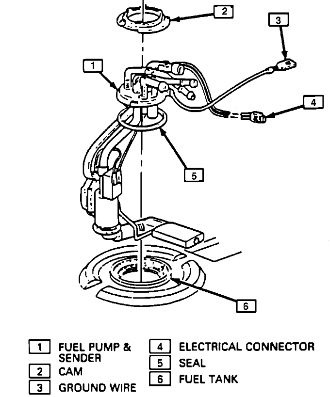

Replaced module, serpentine belt, vehicle started and ran for 1 1/2 days and stopped. Then I replaced rotor, coil, distributor cap, and the engine still won't start. Everything works - headlights, wipers, radio ...
Where might the problem be?

are you getting spark spray starting fluid in the itake when cranking to see if it fuel or electrcal it will run off this if it fuel related
Dec 9, 2007 at 12:10 AM
  • 55,588 POSTS

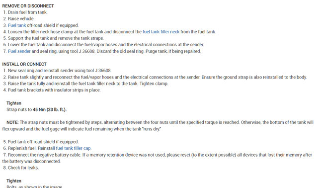

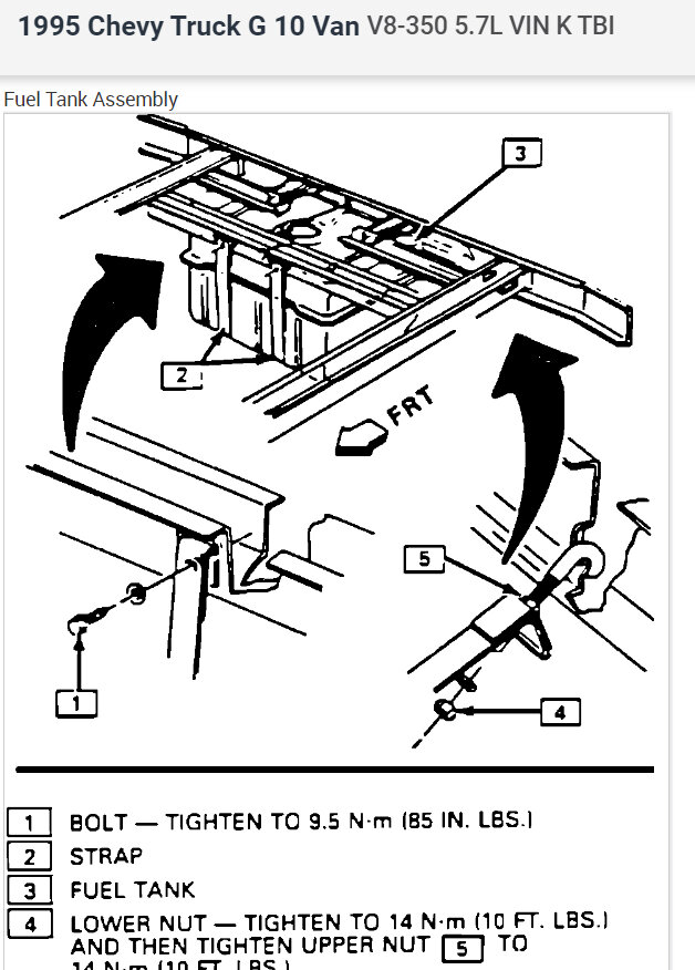

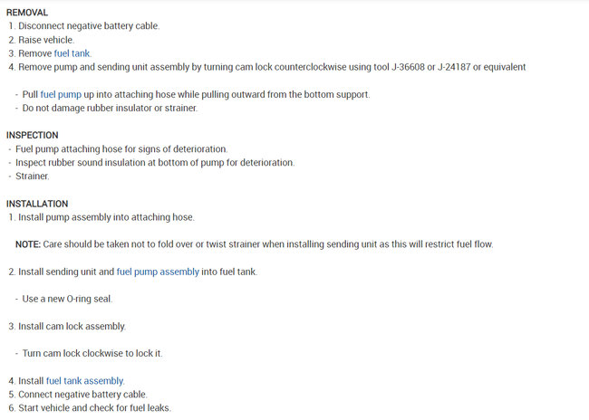

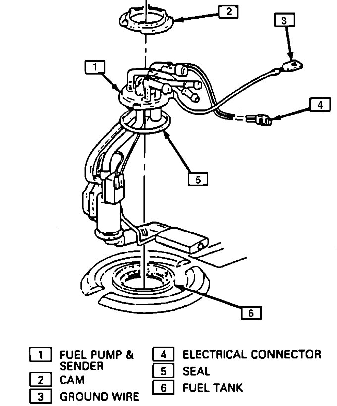

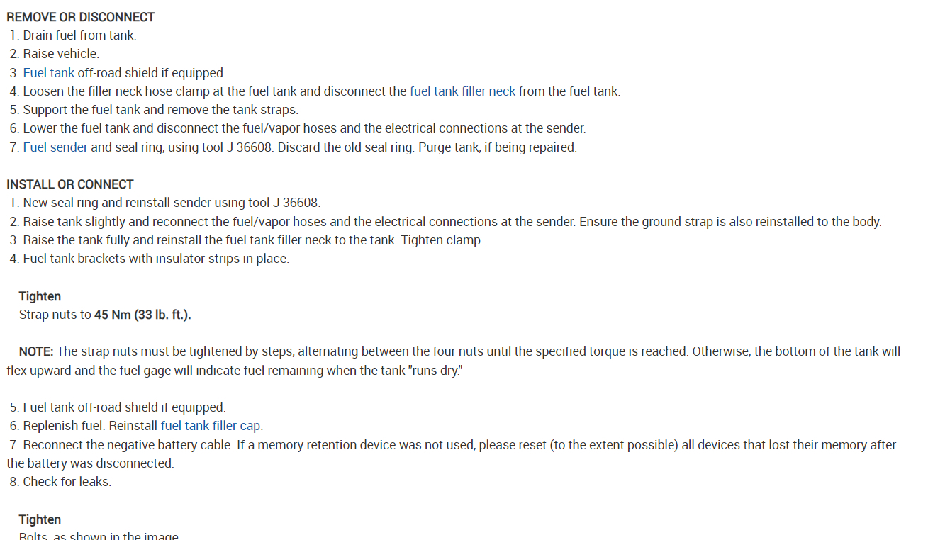

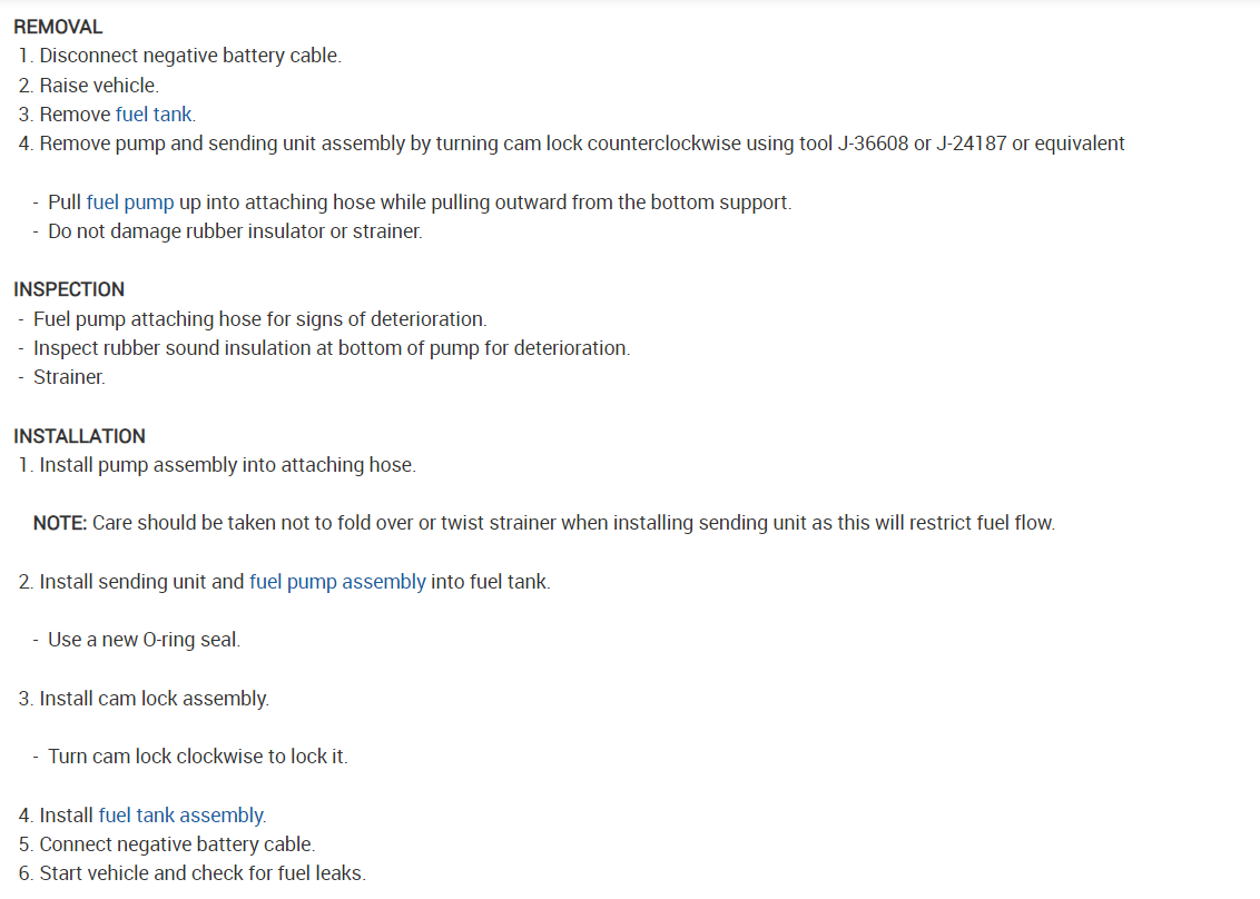

If it runs with starting fluid I have seen the fuel pump go out in these vans, here is how to change it out which should fix the problem. Drain the fuel first this video can help
https://youtu.be/Q5MH2gnyFH0?si=RhICSXMxMgYjUEtw
Check out the images (below). Let us know how it goes
