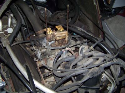

STUDEBAKER14
  • 14 POSTS
Greetings,
I really appreciate your website and making your knowledge and experience available to us shade-tree mechanics.
My problem child is my 1995 Chevy Beauville Van, 5.7 TBI, 4L60E Trans (I think), It’s really in great shape and I plan to repair the rusted lower body panel and make her new again. But she’s currently giving me fits.
I worked on it one evening, installing some fog lights. I ran my fused switch line to the a pin on the fuse block. Job was done, I shut her off, and went in for the night. She would not start the next morning.
The truck has it’s original fuel pump (which I admit still could be the problem if there’s not ENOUGH fuel pressure). However, when I jump the FP Relay, and crack the fittings at the base of the TB, II get a very healthy spray. If I pour raw fuel into the TB, she will light. I don’t have a fuel pressure gage to check, but I believe the pump to be OK.
I have replaced all the fuses and Circuit Breakers. On two occasions the van DID start, but ran very rough. I attribute this to the FP Relay fluttering as I had a test light connected to ground and the relay activation lead. It flashed wildly and pulsed to the engine ignition. Eventually the engine would die, not to start again. This is what leads me to believe that this is an electrical issue.
She turns over freely. No known mechanical issues. I have + power to the injectors but they are not activating that I can tell through my stethoscope (long screwdriver to my ear).
I have swapped the PCM with a known good unit. I have also replaced the FP Relay. If I jump the relay, the pump runs at the same pitch as it always has. Sound just like the one in my 1995 Caprice. Are there any fuseable links or hidden fuses I should be looking for? Everything seems tobe in order under the dash. This has not been all cobbled up like so many old vehicles. It’s all original and in very good shape.
So, assuming there is adequate fuel pressure from the pump, the PCM is good, all the fuses are good, the FP Relay is good, there is good gas in the tank, the battery is strong and connections are clean, what am I missing?
I am hopeful you can help me. My job is depending on this van.

  • CAR REPAIR CONTRIBUTOR
  • 75,992 POSTS
What type of fuel system do you have? TBI/MPFI/CPI Vortec ????? Not to familiar with vans-If its a vortec-you should be able to see the fuel test port when you follow back to the rear from the upper plenum
Jul 24, 2020 at 12:20 PM (Merged)
STUDEBAKER14
  • 14 POSTS
It's the last year of the previous generation of full-sized Chevy Van (boxy), So it is TBI--fuel is fed into base of TB and injected thru the 2 injection over the throttle butterfly.
https://images.2carpros.com/forum/automotive_pictures/277597_100_3140_1.jpg
  • 75,992 POSTS
Get helper to crank her over and look at the injectors are they spraying fuel in a cone looking shape-
The fuel lines is behind the TB follow the feed if there's no test port T the fuel filter
STUDEBAKER14
  • 14 POSTS
Already known. There is no fuel coming out. When I jump the FP relay, the FP runs and sound absoutely normal (I know, not a real indication of performance, but is't a start).
When FP is running, I can crack the fittings at the base of the TB and get a strong spray. What I've narrowed down is that the FP relay is not being activated when KOEO (key on-engine off) position. It should activate for approx 3 seconds as a prime to stat the engine. At this time the engine is supposed to start and the oil pressure sensor tells the PCM to continue pumping fuel. None of that is happening.
Thanks

Hi Ras, Orange wire is hot. Fuse is good. With the test light on the Green wire, it does NOT come on with key.
The problem has to be AFTER the key and BEFORE the fuel pump. I've just come in after checking EVERY electrical connection on the engine harness.
Also, all the connections under the dash, on the steering column appear to be intact and undamged.
Keep in mind, I have the insode engine cover off and a test light connected to the green lead so I can see if power is going to the FP. Plus, I can also hear the pump if it is running. It is almost as though there is not enough current to keep the relay engaged. I don't see that as possible as the Amp meter shows a positive charge when it did start, plus there is a high-power battery charger or other vehicle jumping it.
