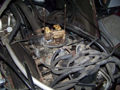

Engine no start, no check engine light on?
1999 CHEVROLET VAN

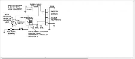

Apply power to the dark green and white wire while relay in place-did the fuel pump come on? if so test the dark green and white wire for an open circuit back to the computer fuel pump relay control
Fuel pump does come on when the activation lead (Grn w/Wht tracer) is jumped.
New development. I do not know what happened or what had changed, but for now, the fuel pump relay IS activating properly when the key goes on. It has done this at time during this process, but seems to be fine for now. However, injector are not activating properly.
There have been a couple more incidents when the van will start briefly, then the injectors cease to let the fuel flow. Hence she stalls soon after. Honestly, its like a circuit breaker pops, then comes back on after a while. Yet, the only CB in for the accessory load, (Power windows, locks etc) as far as my understanding.

Test the injector resistances

Hi guys, Just back into town from an extended funeral trip for a family member. Just now getting back to the old van. Regarding the resistence across the injectors, they read: 1.6 for the drivers side and 1.3 for the passenger side injectors.
Both injectors open when voltage is applied. Is there a fuel pressure sensor on this vehicle?
FYI: The fuel pump relay "appears" to be operating correctly at this time.

I guess I'm completely at a loss then and will have to take her in. I simply cannot find what would cause the van to run absolutely normal and not start the next day. Of all the things we have gone through in this forum, there have been no solutions. Obviously, there's something missing.

It sounds like its an ignition control module problem.

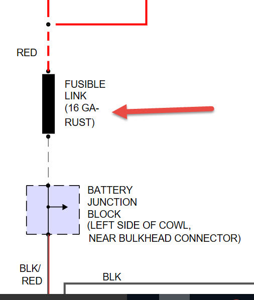

Lights radio works. Put new solenoid turn key nothing happens.
Jul 24, 2020 at 5:33 AM
(Merged)
check for a burnt fusible link. See picture. Should have battery voltage on both sides. assuming battery is in good shape and been load tested as well as clean terminal ends.
